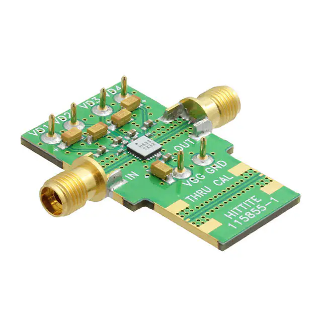

    EVAL BOARD HMC633LC4
115857-HMC633LC4 数据手册
HMC633LC4 v03.0514 DRIVER & GAIN BLOCK AMPLIFIERS - SMT GaAs PHEMT MMIC DRIVER AMPLIFIER, 5.5 - 17 GHz Typical Applications Features The HMC633LC4 is ideal for: Gain: 30 dB • Point-to-Point Radios P1dB: +23 dBm • Point-to-Multi-Point Radios & VSAT Saturated Power: +23.8 dBm @ 24% PAE • LO Driver for Mixers Supply Voltage: +5V @180 mA • Military & Space 50 Ohm Matched Input/Output 24 Lead Ceramic 4x4mm SMT Package: 16mm2 Functional Diagram General Description The HMC633LC4 is a GaAs PHEMT MMIC Driver Amplifier in a leadless 4x4 mm ceramic surface mount package which operates between 5.5 and 17 GHz. The amplifier provides up to 30 dB of gain, +30 dBm Output IP3, and +23 dBm of output power at 1 dB gain compression, while requiring 180 mA from a +5V supply. The HMC633LC4 is an ideal driver amplifier for microwave radio applications from 5.5 to 17 GHz and may be biased at +5V, 130 mA to provide 2 dB lower gain with improved PAE. The amplifier’s I/Os are DC blocked and matched to 50 Ohms with no external matching required. Electrical Specifications, TA = +25° C, Vdd1-4= 5V, Idd= 180mA [1] Parameter Min. Frequency Range Gain 26 Gain Variation Over Temperature Output Third Order Intercept (IP3) Min. 25 0.040 23 Max. 17 18 Units GHz 28 0.030 22 20 Typ. 9 - 17 22 Output Return Loss Saturated Output Power (Psat) Max. 30 0.030 Input Return Loss Output Power for 1 dB Compression (P1dB) Typ. 5.5 - 9 dB 0.040 dB/ °C dB 15 dB 21 dBm 23.8 22 dBm 30 29 dBm Noise Figure 10 7 dB Supply Current (Idd) (Idd = Idd1 + Idd2 + Idd3 + Idd4) 180 180 mA [1] Adjust Vgg between -2 to 0V to achieve Idd= 180 mA typical. 1 Information furnished by Analog Devices is believed to be accurate and reliable. However, no For price,2 delivery, andDrive, to place orders: AnalogMA Devices, For price, delivery andDevices to place orders: Hittite Microwave Elizabeth Chelmsford, 01824Inc., responsibility is assumed by Analog for its use, nor for any infringements of patents orCorporation, other One Technology Way, P.O. Box 9106, Norwood, MA 02062-9106 rights of third parties that may result from its use. Specifications subject to change without notice. No Phone: 978-250-3343 Fax: 978-250-3373 Order at www.hittite.com Phone: On-line 781-329-4700 • Order online at www.analog.com license is granted by implication or otherwise under any patent or patent rights of Analog Devices. Application Support: Phone: 1-800-ANALOG-D Trademarks and registered trademarks are the property of their respective owners. Application Support: Phone: 978-250-3343 or apps@hittite.com HMC633LC4 v03.0514 GaAs PHEMT MMIC DRIVER AMPLIFIER, 5.5 - 17 GHz Gain vs. Temperature 40 35 30 30 25 10 GAIN (dB) RESPONSE (dB) 20 S11 S21 S22 0 -10 20 +25 C +85 C -55 C 15 10 -20 5 -30 -40 0 2 4 6 8 10 12 14 16 18 2 20 4 6 8 FREQUENCY (GHz) 0 -5 -5 +25 C +85 C -40 C -15 -20 -25 14 16 18 20 +25 C +85 C -40 C -10 -15 -20 -25 -30 -30 2 4 6 8 10 12 14 16 18 20 2 4 6 8 FREQUENCY (GHz) 10 12 14 16 18 20 FREQUENCY (GHz) P1dB vs. Temperature Psat vs. Temperature 30 30 +25 C +85 C -40 C 27 Psat (dBm) 26 P1dB (dBm) 12 Output Return Loss vs. Temperature 0 RETURN LOSS (dB) RETURN LOSS (dB) Input Return Loss vs. Temperature -10 10 FREQUENCY (GHz) DRIVER & GAIN BLOCK AMPLIFIERS - SMT Broadband Gain & Return Loss 22 +25 C +85 C -40 C 18 24 21 18 15 14 4 8 12 FREQUENCY (GHz) 16 20 4 6 8 10 12 14 16 18 20 FREQUENCY (GHz) Information furnished by Analog Devices is believed to be accurate and reliable. However, no For price,2 delivery, andDrive, to place orders: AnalogMA Devices, For price, delivery andDevices to place orders: Hittite Microwave Elizabeth Chelmsford, 01824Inc., responsibility is assumed by Analog for its use, nor for any infringements of patents orCorporation, other One Technology Way, P.O. Box 9106, Norwood, MA 02062-9106 rights of third parties that may result from its use. Specifications subject to change without notice. No Phone: 978-250-3343 Fax: 978-250-3373 Order at www.hittite.com Phone: On-line 781-329-4700 • Order online at www.analog.com license is granted by implication or otherwise under any patent or patent rights of Analog Devices. Application Support: Phone: 1-800-ANALOG-D Trademarks and registered trademarks are the property of their respective owners. Application Support: Phone: 978-250-3343 or apps@hittite.com 2 HMC633LC4 v03.0514 GaAs PHEMT MMIC DRIVER AMPLIFIER, 5.5 - 17 GHz Power Compression @ 11 GHz Power Compression @ 17 GHz Pout (dBm), GAIN (dB), PAE (%) Pout (dBm), GAIN (dB), PAE (%) 35 30 25 20 15 10 Pout (dBm) Gain (dB) PAE (%) 5 0 -20 -18 -16 -14 -12 -10 -8 -6 -4 25 Pout (dBm) Gain (dB) PAE (%) 20 15 10 5 0 -20 -2 -18 -16 -14 -12 -10 -8 -6 -4 -2 INPUT POWER (dBm) Output IP3 vs. Temperature Noise Figure vs. Temperature 36 16 14 NOISE FIGURE (dB) 32 28 +25 C +85 C -40 C 24 20 12 10 8 6 4 +25 C +85 C -40 C 2 0 16 2 4 6 8 10 12 14 16 18 20 4 6 8 30 -20 ISOLATION (dB) GAIN (dB), P1dB (dBm), Psat (dBm) 0 25 15 4.5 12 14 16 18 Reverse Isolation vs. Temperature 35 20 10 FREQUENCY (GHz) FREQUENCY (GHz) Gain & Power vs. Supply Voltage @ 11 GHz +25 C +85 C -40 C -40 -60 Gain P1dB Psat -80 4.7 4.9 5.1 Vdd (V) 3 30 INPUT POWER (dBm) IP3 (dBm) DRIVER & GAIN BLOCK AMPLIFIERS - SMT 35 5.3 5.5 2 5 8 11 14 17 20 FREQUENCY (GHz) Information furnished by Analog Devices is believed to be accurate and reliable. However, no For price,2 delivery, andDrive, to place orders: AnalogMA Devices, For price, delivery andDevices to place orders: Hittite Microwave Elizabeth Chelmsford, 01824Inc., responsibility is assumed by Analog for its use, nor for any infringements of patents orCorporation, other One Technology Way, P.O. Box 9106, Norwood, MA 02062-9106 rights of third parties that may result from its use. Specifications subject to change without notice. No Phone: 978-250-3343 Fax: 978-250-3373 Order at www.hittite.com Phone: On-line 781-329-4700 • Order online at www.analog.com license is granted by implication or otherwise under any patent or patent rights of Analog Devices. Application Support: Phone: 1-800-ANALOG-D Trademarks and registered trademarks are the property of their respective owners. Application Support: Phone: 978-250-3343 or apps@hittite.com HMC633LC4 v03.0514 GaAs PHEMT MMIC DRIVER AMPLIFIER, 5.5 - 17 GHz 210 35 Idd 180 30 150 25 20 Gain P1dB Psat IP3 90 15 -0.8 120 -0.78 -0.76 -0.74 -0.72 -0.7 Drain Bias Voltage (Vdd1, Vdd2, Vdd3, Vdd4) +5.5V Gate Bias Voltage (Vgg) -3 to 0V RF Input Power (RFIN)(Vdd = +5 Vdc) +5 dBm Channel Temperature 175 °C Continuous Pdiss (T= 85 °C) (derate 11.08 mW/°C above 85 °C) 0.99 W Thermal Resistance (channel to package bottom) 90.23 °C/W Storage Temperature -65 to +150 °C Operating Temperature -40 to +85 °C -0.68 Vgg (V) ELECTROSTATIC SENSITIVE DEVICE OBSERVE HANDLING PRECAUTIONS Typical Supply Current vs. Vdd Vdd (V) Idd (mA) 4.5 177 5.0 180 5.5 182 Note: Amplifier will operate over full voltage ranges shown above Information furnished by Analog Devices is believed to be accurate and reliable. However, no For price,2 delivery, andDrive, to place orders: AnalogMA Devices, For price, delivery andDevices to place orders: Hittite Microwave Elizabeth Chelmsford, 01824Inc., responsibility is assumed by Analog for its use, nor for any infringements of patents orCorporation, other One Technology Way, P.O. Box 9106, Norwood, MA 02062-9106 rights of third parties that may result from its use. Specifications subject to change without notice. No Phone: 978-250-3343 Fax: 978-250-3373 Order at www.hittite.com Phone: On-line 781-329-4700 • Order online at www.analog.com license is granted by implication or otherwise under any patent or patent rights of Analog Devices. Application Support: Phone: 1-800-ANALOG-D Trademarks and registered trademarks are the property of their respective owners. Application Support: Phone: 978-250-3343 or apps@hittite.com DRIVER & GAIN BLOCK AMPLIFIERS - SMT Absolute Maximum Ratings Idd (mA) GAIN (dB), P1dB (dBm), Psat (dBm), IP3 (dBm) Gain, Power & Output IP3 vs. Gate Voltage @ 11 GHz 4 HMC633LC4 v03.0514 GaAs PHEMT MMIC DRIVER AMPLIFIER, 5.5 - 17 GHz DRIVER & GAIN BLOCK AMPLIFIERS - SMT Outline Drawing NOTES: 1. PACKAGE BODY MATERIAL: ALUMINA 2. LEAD AND GROUND PADDLE PLATING: 30-80 MICROINCHES GOLD OVER 50 MICROINCHES MINIMUM NICKEL. 3. DIMENSIONS ARE IN INCHES [MILLIMETERS]. 4. LEAD SPACING TOLERANCE IS NON-CUMULATIVE. 5. PACKAGE WARP SHALL NOT EXCEED 0.05mm DATUM -C6. ALL GROUND LEADS AND GROUND PADDLE MUST BE SOLDERED TO PCB RF GROUND. Package Information Part Number Package Body Material Lead Finish HMC633LC4 Alumina, White Gold over Nickel MSL Rating MSL3 [1] Package Marking [2] H633 XXXX [1] Max peak reflow temperature of 260 °C [2] 4-Digit lot number XXXX 5 Information furnished by Analog Devices is believed to be accurate and reliable. However, no For price,2 delivery, andDrive, to place orders: AnalogMA Devices, For price, delivery andDevices to place orders: Hittite Microwave Elizabeth Chelmsford, 01824Inc., responsibility is assumed by Analog for its use, nor for any infringements of patents orCorporation, other One Technology Way, P.O. Box 9106, Norwood, MA 02062-9106 rights of third parties that may result from its use. Specifications subject to change without notice. No Phone: 978-250-3343 Fax: 978-250-3373 Order at www.hittite.com Phone: On-line 781-329-4700 • Order online at www.analog.com license is granted by implication or otherwise under any patent or patent rights of Analog Devices. Application Support: Phone: 1-800-ANALOG-D Trademarks and registered trademarks are the property of their respective owners. Application Support: Phone: 978-250-3343 or apps@hittite.com HMC633LC4 v03.0514 GaAs PHEMT MMIC DRIVER AMPLIFIER, 5.5 - 17 GHz Pin Descriptions Pin Number Description N/C No connection. These pins may be connected to DC/RF ground. Performance will not be affected. 2, 4, 15, 17 GND Package Bottom must be connected to RF/DC ground. 3 RFIN This pin is AC coupled and matched to 50 Ohms. 9 Vgg Gate control for amplifier, please follow “MMIC Amplifier Biasing Procedure” Application Note: See application circuit for required external components. 16 RFOUT This pin is AC coupled and matched to 50 Ohms. 24, 22, 20, 19 Vdd1, Vdd2, Vdd3, Vdd4 Power Supply Voltage for the amplifier. See application circuit for required external components. Interface Schematic Application Circuit Component Value C1 - C5 100 pF C6 - C10 1000 pF C11 - C15 2.2 µF Information furnished by Analog Devices is believed to be accurate and reliable. However, no For price,2 delivery, andDrive, to place orders: AnalogMA Devices, For price, delivery andDevices to place orders: Hittite Microwave Elizabeth Chelmsford, 01824Inc., responsibility is assumed by Analog for its use, nor for any infringements of patents orCorporation, other One Technology Way, P.O. Box 9106, Norwood, MA 02062-9106 rights of third parties that may result from its use. Specifications subject to change without notice. No Phone: 978-250-3343 Fax: 978-250-3373 Order at www.hittite.com Phone: On-line 781-329-4700 • Order online at www.analog.com license is granted by implication or otherwise under any patent or patent rights of Analog Devices. Application Support: Phone: 1-800-ANALOG-D Trademarks and registered trademarks are the property of their respective owners. Application Support: Phone: 978-250-3343 or apps@hittite.com DRIVER & GAIN BLOCK AMPLIFIERS - SMT Function 1, 5 - 8, 11 - 14, 18, 21, 23 6 HMC633LC4 v03.0514 GaAs PHEMT MMIC DRIVER AMPLIFIER, 5.5 - 17 GHz DRIVER & GAIN BLOCK AMPLIFIERS - SMT Evaluation PCB List of Materials for Evaluation PCB 115857 Item Description J1 - J2 2.92 mm PC Mount K-Connector VD1 - VD4 DC Pin C1 - C5 100 pF Capacitor, 0402 Pkg. C6 - C10 1000 pF Capacitor, 0603 Pkg. C11 - C15 2.2 µF Capacitor, Tantalum U1 HMC633LC4 Driver Amplifier PCB [2] 115855 Evaluation PCB [1] Reference this number when ordering complete evaluation PCB [2] Circuit Board Material: Rogers 4350 7 [1] The circuit board used in the application should use RF circuit design techniques. Signal lines should have 50 Ohm impedance while the package ground leads and exposed paddle should be connected directly to the ground plane similar to that shown. A sufficient number of via holes should be used to connect the top and bottom ground planes. The evaluation board should be mounted to an appropriate heat sink. The evaluation circuit board shown is available from Hittite upon request. Information furnished by Analog Devices is believed to be accurate and reliable. However, no For price,2 delivery, andDrive, to place orders: AnalogMA Devices, For price, delivery andDevices to place orders: Hittite Microwave Elizabeth Chelmsford, 01824Inc., responsibility is assumed by Analog for its use, nor for any infringements of patents orCorporation, other One Technology Way, P.O. Box 9106, Norwood, MA 02062-9106 rights of third parties that may result from its use. Specifications subject to change without notice. No Phone: 978-250-3343 Fax: 978-250-3373 Order at www.hittite.com Phone: On-line 781-329-4700 • Order online at www.analog.com license is granted by implication or otherwise under any patent or patent rights of Analog Devices. Application Support: Phone: 1-800-ANALOG-D Trademarks and registered trademarks are the property of their respective owners. Application Support: Phone: 978-250-3343 or apps@hittite.com HMC633LC4 v03.0514 DRIVER & GAIN BLOCK AMPLIFIERS - SMT GaAs PHEMT MMIC DRIVER AMPLIFIER, 5.5 - 17 GHz Information furnished by Analog Devices is believed to be accurate and reliable. However, no For price,2 delivery, andDrive, to place orders: AnalogMA Devices, For price, delivery andDevices to place orders: Hittite Microwave Elizabeth Chelmsford, 01824Inc., responsibility is assumed by Analog for its use, nor for any infringements of patents orCorporation, other One Technology Way, P.O. Box 9106, Norwood, MA 02062-9106 rights of third parties that may result from its use. Specifications subject to change without notice. No Phone: 978-250-3343 Fax: 978-250-3373 Order at www.hittite.com Phone: On-line 781-329-4700 • Order online at www.analog.com license is granted by implication or otherwise under any patent or patent rights of Analog Devices. Application Support: Phone: 1-800-ANALOG-D Trademarks and registered trademarks are the property of their respective owners. Application Support: Phone: 978-250-3343 or apps@hittite.com 8
