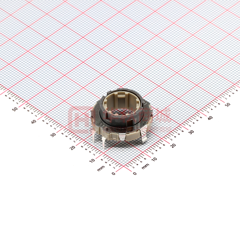

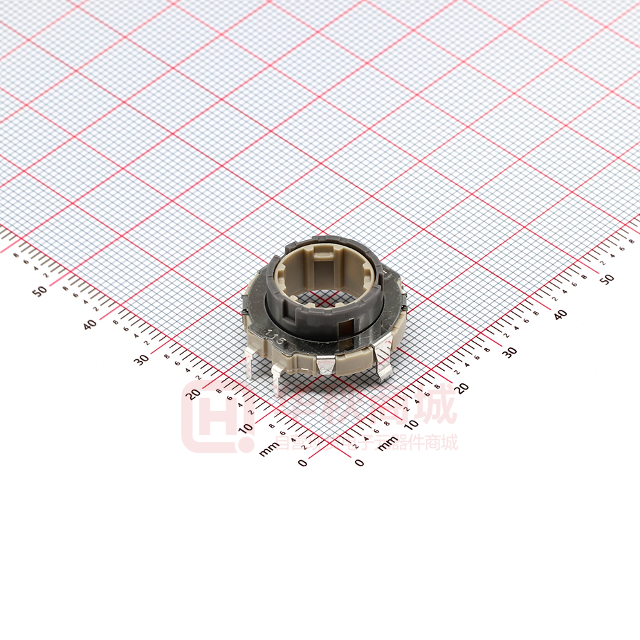

EC21A 21mm Size Ring Type
EC21C
Ring encoder with 4mm height contribute to
space saving and multifunctioning
