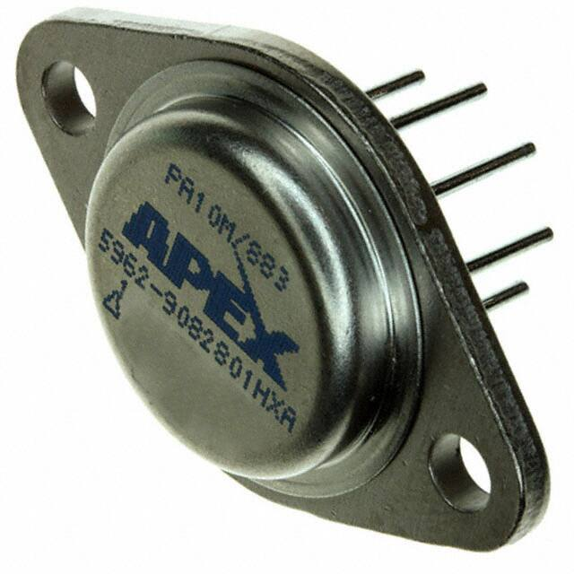

PA10M/883 数据手册
PA10M/883 Table 4 Group A Inspection SG Parameter Symbol Temp. Power Test Conditions Min Max Units IQ 25°C ±40V VIN=0, AV=100, RCL= 0.1 Ω 30 mA Input Offset Voltage VOS 25°C ±40V VIN = 0, AV = 100 ±6 mV 1 Input Offset Voltage VOS 25°C ±10V VIN = 0, AV = 100 ±12 mV 1 Input Offset Voltage VOS 25°C ±45V VIN = 0, AV = 100 ±7 mV 1 Input Bias Current, +IN +IB 25°C ±40V VIN = 0 ±30 pA 1 Input Bias Current, –IN –IB 25°C ±40V VIN = 0 ±30 pA 1 Input Offset Current IOS 25°C ±40V VIN = 0 ±30 pA 3 Quiescent Current IQ –55°C ±40V VIN=0, AV=100, RCL= 0.1 Ω 75 mA 3 Input Offset Voltage VOS –55°C ±40V VIN = 0, AV = 100 ±11.2 mV 3 Input Offset Voltage VOS –55°C ±10V VIN = 0, AV = 100 ±17.2 mV 3 Input Offset Voltage VOS –55°C ±45V VIN = 0, AV = 100 ±12.2 mV 3 Input Bias Current, +IN +IB –55°C ±40V VIN = 0 ±115 pA 3 Input Bias Current, –IN –IB –55°C ±40V VIN = 0 ±115 pA 3 Input Offset Current IOS –55°C ±40V VIN = 0 ±115 pA 2 Quiescent Current IQ 125°C ±40V VIN=0, AV=100, RCL= 0.1 Ω 30 mA 2 Input Offset Voltage VOS 125°C ±40V VIN = 0, AV = 100 ±12.5 mV 2 Input Offset Voltage VOS 125°C ±10V VIN = 0, AV = 100 ±18.5 mV 2 Input Offset Voltage VOS 125°C ±45V VIN = 0, AV = 100 ±13.5 mV 2 Input Bias Current, +IN +IB 125°C ±40V VIN = 0 ±70 nA 2 Input Bias Current, –IN –IB 125°C ±40V VIN = 0 ±70 nA 2 Input Offset Current IOS 125°C ±40V VIN = 0 ±70 nA 4 Output Voltage, IO = 5A VO 25°C ±18V RL = 2.07 Ω 10 V 4 Output Voltage, IO = 80mA VO 25°C ±45V RL = 500 Ω 40 V 4 Output Voltage, IO = 2A VO 25°C ±30V RL = 12 Ω 24 V 4 Current Limits ICL 25°C ±17V RL = 12 Ω, RCL = 1 Ω 0.6 4 Stability/Noise EN 25°C ±40V 4 Slew Rate SR 25°C ±40V RL = 500 Ω 2 4 Open Loop Gain AOL 25°C ±40V RL = 500 Ω, F = 10 Hz 96 dB 4 Common Mode Rejection CMR 25°C ±15V RL=500Ω, F=DC, VCM=±9V 74 dB 1 Quiescent Current 1 www.apexanalog.com RL = 100 Ω, AV = 1, CL = 0.33nF © Apex Microtechnology Inc. All rights reserved 0.89 A 1 mV 10 V/µs Dec 2015 PA10MU Rev O PA10M/883 SG Parameter Symbol Temp. Power Test Conditions 6 Output Voltage, IO = 5A VO –55°C 6 Output Voltage, IO = 80mA VO 6 Output Voltage, IO = 2A 6 Min Max Units 10 V –55°C ±18V RL = 2.07 Ω ±45V RL = 500 Ω 40 V VO –55°C ±30V RL = 12 Ω 24 V Stability/Noise EN –55°C ±40V 6 Slew Rate SR –55°C 6 Open Loop Gain AOL –55°C ±40V RL = 500 Ω ±40V RL = 500 Ω, F = 10 Hz 96 dB 6 Common Mode Rejection CMR –55°C ±15V RL=500Ω, F=DC, VCM=±9V 74 dB 5 Output Voltage, IO = 3A VO 125°C ±14.3V RL = 2.07 Ω 6.3 V 5 Output Voltage, IO = 80mA VO 125°C ±45V RL = 500 Ω 40 V 5 Output Voltage, IO = 2A VO 125°C 24 V 5 Stability/Noise EN 125°C ±30V RL = 12 Ω RL = 100 Ω, AV = 1, CL = ±40V 0.33nF 5 Slew Rate SR 125°C 2 5 Open Loop Gain AOL 125°C ±40V RL = 500 Ω ±40V RL = 500 Ω, F = 10 Hz 96 dB 5 Common Mode Rejection CMR 125°C ±15V RL=500Ω, F=DC, VCM=±9V 74 dB 2 RL = 100 Ω, AV = 1, CL = 0.33nF 2 1 mV 10 V/µs 1 mV 10 V/µs PA10MU Rev O PA10M/883 BURN IN CIRCUIT Figure 1: Burn In Circuit *These components are used to stabilize device due to poor high frequency characteristics of burn in board. **Input signals are calculated to result in internal power dissipation of approximately 2.1W at case tempera‐ ture = 125°C. NEED TECHNICAL HELP? CONTACT APEX SUPPORT! For all Apex Microtechnology product questions and inquiries, call toll free 800-546-2739 in North America. For inquiries via email, please contact apex.support@apexanalog.com. International customers can also request support by contacting their local Apex Microtechnology Sales Representative. To find the one nearest to you, go to www.apexanalog.com IMPORTANT NOTICE Apex Microtechnology, Inc. has made every effort to insure the accuracy of the content contained in this document. However, the information is subject to change without notice and is provided "AS IS" without warranty of any kind (expressed or implied). Apex Microtechnology reserves the right to make changes without further notice to any specifications or products mentioned herein to improve reliability. This document is the property of Apex Microtechnology and by furnishing this information, Apex Microtechnology grants no license, expressed or implied under any patents, mask work rights, copyrights, trademarks, trade secrets or other intellectual property rights. Apex Microtechnology owns the copyrights associated with the information contained herein and gives consent for copies to be made of the information only for use within your organization with respect to Apex Microtechnology integrated circuits or other products of Apex Microtechnology. This consent does not extend to other copying such as copying for general distribution, advertising or promotional purposes, or for creating any work for resale. APEX MICROTECHNOLOGY PRODUCTS ARE NOT DESIGNED, AUTHORIZED OR WARRANTED TO BE SUITABLE FOR USE IN PRODUCTS USED FOR LIFE SUPPORT, AUTOMOTIVE SAFETY, SECURITY DEVICES, OR OTHER CRITICAL APPLICATIONS. PRODUCTS IN SUCH APPLICATIONS ARE UNDERSTOOD TO BE FULLY AT THE CUSTOMER OR THE CUSTOMER’S RISK. Apex Microtechnology, Apex and Apex Precision Power are trademarks of Apex Microtechnology, Inc. All other corporate names noted herein may be trademarks of their respective holders. PA10MU Rev O 3
