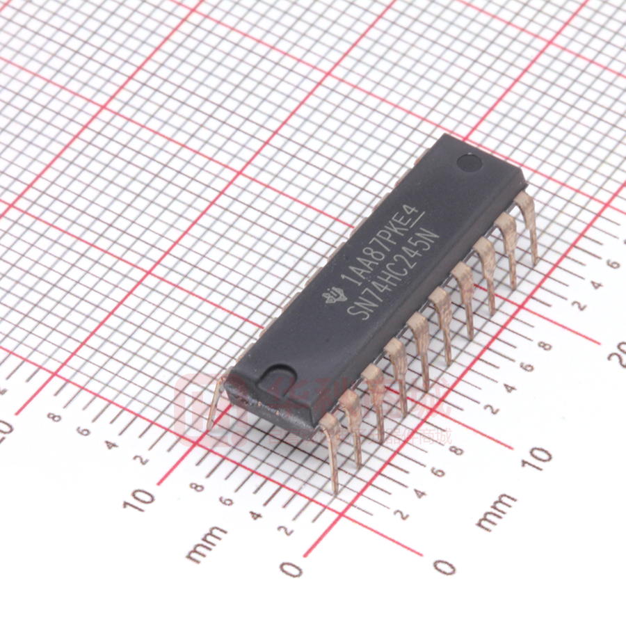

SN74HC245N
SN74HC245N
    BURR-BROWN(德州仪器)
    PDIP-20_25.4X6.35MM
    类型:收发器,非反相 电源电压:2V~6V 输出类型:三态 低电平输出电流(IOL):7.8mA 高电平输出电流(IOH):7.8mA
SN74HC245N 数据手册
SN54HC245, SN74HC245 OCTAL BUS TRANSCEIVERS WITH 3-STATE OUTPUTS SCLS131D − DECEMBER 1982 − REVISED AUGUST 2003 D Wide Operating Voltage Range of 2 V to 6 V D High-Current 3-State Outputs Drive Bus Lines Directly or Up To 15 LSTTL Loads D Low Power Consumption, 80-μA Max ICC D Typical tpd = 12 ns D ±6-mA Output Drive at 5 V D Low Input Current of 1 μA Max SN54HC245 . . . J OR W PACKAGE SN74HC245 . . . DB, DW, N, NS, OR PW PACKAGE (TOP VIEW) 20 2 19 3 18 4 17 5 16 6 15 7 14 8 13 9 12 10 11 A2 A1 DIR VCC OE 1 VCC OE B1 B2 B3 B4 B5 B6 B7 B8 A3 A4 A5 A6 A7 4 3 2 1 20 19 18 5 17 6 16 7 15 8 14 9 10 11 12 13 B1 B2 B3 B4 B5 A8 GND B8 B7 B6 DIR A1 A2 A3 A4 A5 A6 A7 A8 GND SN54HC245 . . . FK PACKAGE (TOP VIEW) description/ordering information These octal bus transceivers are designed for asynchronous two-way communication between data buses. The control-function implementation minimizes external timing requirements. The devices allow data transmission from the A bus to the B bus or from the B bus to the A bus, depending on the logic level at the direction-control (DIR) input. The output-enable (OE) input can be used to disable the device so that the buses are effectively isolated. ORDERING INFORMATION PACKAGE† TA PDIP − N SN74HC245N Tube of 25 SN74HC245DW Reel of 2000 SN74HC245DWR SOP − NS Reel of 2000 SN74HC245NSR HC245 SSOP − DB Reel of 2000 SN74HC245DBR HC245 Tube of 70 SN74HC245PW Reel of 2000 SN74HC245PWR Reel of 250 SN74HC245PWT CDIP − J Tube of 20 SNJ54HC245J SNJ54HC245J CFP − W Tube of 85 SNJ54HC245W SNJ54HC245W LCCC − FK Tube of 55 SNJ54HC245FK SNJ54HC245FK TSSOP − PW −55°C to 125°C † TOP-SIDE MARKING Tube of 20 SOIC − DW 40°C to 85°C −40°C ORDERABLE PART NUMBER SN74HC245N HC245 HC245 Package drawings, standard packing quantities, thermal data, symbolization, and PCB design guidelines are available at www.ti.com/sc/package. Please be aware that an important notice concerning availability, standard warranty, and use in critical applications of Texas Instruments semiconductor products and disclaimers thereto appears at the end of this data sheet. Copyright © 2003, Texas Instruments Incorporated PRODUCTION DATA information is current as of publication date. Products conform to specifications per the terms of Texas Instruments standard warranty. Production processing does not necessarily include testing of all parameters. On products compliant to MIL-PRF-38535, all parameters are tested unless otherwise noted. On all other products, production processing does not necessarily include testing of all parameters. POST OFFICE BOX 655303 • DALLAS, TEXAS 75265 1 SN54HC245, SN74HC245 OCTAL BUS TRANSCEIVERS WITH 3-STATE OUTPUTS SCLS131D − DECEMBER 1982 − REVISED AUGUST 2003 FUNCTION TABLE INPUTS OE DIR OPERATION L L B data to A bus L H A data to B bus H X Isolation logic diagram (positive logic) DIR 1 19 A1 OE 2 18 B1 To Seven Other Channels absolute maximum ratings over operating free-air temperature range (unless otherwise noted)† Supply voltage range, VCC . . . . . . . . . . . . . . . . . . . . . . . . . . . . . . . . . . . . . . . . . . . . . . . . . . . . . . . . . . −0.5 V to 7 V Input clamp current, IIK (VI < 0 or VI > VCC) (see Note 1) . . . . . . . . . . . . . . . . . . . . . . . . . . . . . . . . . . . . . ±20 mA Output clamp current, IOK (VO < 0 or VO > VCC) (see Note 1) . . . . . . . . . . . . . . . . . . . . . . . . . . . . . . . . . ±20 mA Continuous output current, IO (VO = 0 to VCC) . . . . . . . . . . . . . . . . . . . . . . . . . . . . . . . . . . . . . . . . . . . . . . ±35 mA Continuous current through VCC or GND . . . . . . . . . . . . . . . . . . . . . . . . . . . . . . . . . . . . . . . . . . . . . . . . . . . ±70 mA Package thermal impedance, θJA (see Note 2): DB package . . . . . . . . . . . . . . . . . . . . . . . . . . . . . . . . . 70°C/W DW package . . . . . . . . . . . . . . . . . . . . . . . . . . . . . . . . . 58°C/W N package . . . . . . . . . . . . . . . . . . . . . . . . . . . . . . . . . . . 69°C/W NS package . . . . . . . . . . . . . . . . . . . . . . . . . . . . . . . . . 60°C/W PW package . . . . . . . . . . . . . . . . . . . . . . . . . . . . . . . . . 83°C/W Storage temperature range, Tstg . . . . . . . . . . . . . . . . . . . . . . . . . . . . . . . . . . . . . . . . . . . . . . . . . . . −65°C to 150°C † Stresses beyond those listed under “absolute maximum ratings” may cause permanent damage to the device. These are stress ratings only, and functional operation of the device at these or any other conditions beyond those indicated under “recommended operating conditions” is not implied. Exposure to absolute-maximum-rated conditions for extended periods may affect device reliability. NOTES: 1. The input and output voltage ratings may be exceeded if the input and output current ratings are observed. 2. The package thermal impedance is calculated in accordance with JESD 51-7. 2 POST OFFICE BOX 655303 • DALLAS, TEXAS 75265 SN54HC245, SN74HC245 OCTAL BUS TRANSCEIVERS WITH 3-STATE OUTPUTS SCLS131D − DECEMBER 1982 − REVISED AUGUST 2003 recommended operating conditions (see Note 3) SN54HC245 VCC Supply voltage VCC = 2 V VIH VCC = 4.5 V High-level High level input voltage VCC = 6 V MIN NOM MAX 2 5 6 Input voltage VO Output voltage TA 5 6 3.15 4.2 0 0 Input transition rise/fall time 2 4.2 VCC = 2 V Δt/Δv MAX 3.15 VCC = 6 V VI NOM 1.5 VCC = 4.5 V Low-level Low level input voltage MIN 1.5 VCC = 2 V VIL SN74HC245 0.5 1.35 1.35 1.8 1.8 0 VCC 0 V VCC V 1000 VCC = 4.5 V 500 500 VCC = 6 V 400 400 −55 125 −40 V VCC 1000 Operating free-air temperature V V 0.5 VCC UNIT 85 ns °C NOTE 3: All unused inputs of the device must be held at VCC or GND to ensure proper device operation. Refer to the TI application report, Implications of Slow or Floating CMOS Inputs, literature number SCBA004. electrical characteristics over recommended operating free-air temperature range (unless otherwise noted) PARAMETER VOH TEST CONDITIONS TA = 25°C MIN TYP SN54HC245 MAX MIN MAX SN74HC245 MIN 2V 1.9 1.998 1.9 1.9 IOH = −20 20 μA 4.5 V 4.4 4.499 4.4 4.4 6V 5.9 5.999 5.9 5.9 IOH = −6 mA 4.5 V 3.98 4.3 3.7 3.84 6V 5.48 5.8 5.2 5.34 VI = VIH or VIL IOH = −7.8 mA IOL = 20 μA VOL VCC VI = VIH or VIL IOL = 6 mA IOL = 7.8 mA MAX UNIT V 2V 0.002 0.1 0.1 0.1 4.5 V 0.001 0.1 0.1 0.1 6V 0.001 0.1 0.1 0.1 4.5 V 0.17 0.26 0.4 0.33 6V 0.15 0.26 0.4 0.33 V II DIR or OE VI = VCC or 0 6V ±0.1 ±100 ±1000 ±1000 nA IOZ A or B VO = VCC or 0 6V ±0.01 ±0.5 ±10 ±5 μA 8 160 80 μA 10 10 10 pF ICC Ci VI = VCC or 0, DIR or OE IO = 0 6V 2 V to 6 V POST OFFICE BOX 655303 3 • DALLAS, TEXAS 75265 3 SN54HC245, SN74HC245 OCTAL BUS TRANSCEIVERS WITH 3-STATE OUTPUTS SCLS131D − DECEMBER 1982 − REVISED AUGUST 2003 switching characteristics over recommended operating free-air temperature range, CL = 50 pF (unless otherwise noted) (see Figure 1) PARAMETER tpd ten FROM (INPUT) TO (OUTPUT) VCC A or B B or A OE tdis OE tt A or B A or B A or B TA = 25°C MIN SN54HC245 MIN MAX SN74HC245 TYP MAX MIN MAX 2V 40 105 160 130 4.5 V 15 21 32 26 6V 12 18 27 22 2V 125 230 340 290 4.5 V 23 46 68 58 6V 20 39 58 49 2V 74 200 300 250 4.5 V 25 40 60 50 6V 21 34 51 43 2V 20 60 90 75 4.5 V 8 12 18 15 6V 6 10 15 13 UNIT ns ns ns ns switching characteristics over recommended operating free-air temperature range, CL = 150 pF (unless otherwise noted) (see Figure 1) PARAMETER tpd ten tt FROM (INPUT) A or B OE TO (OUTPUT) VCC B or A A or B A or B TA = 25°C MIN SN54HC245 MIN MAX SN74HC245 TYP MAX MIN MAX 2V 54 135 200 170 4.5 V 18 27 40 34 6V 15 23 34 29 2V 150 270 405 335 4.5 V 31 54 81 67 6V 25 46 69 56 2V 45 210 315 265 4.5 V 17 42 63 53 6V 13 36 53 45 UNIT ns ns ns operating characteristics, TA = 25°C PARAMETER Cpd 4 TEST CONDITIONS Power dissipation capacitance per transceiver POST OFFICE BOX 655303 No load • DALLAS, TEXAS 75265 TYP 40 UNIT pF SN54HC245, SN74HC245 OCTAL BUS TRANSCEIVERS WITH 3-STATE OUTPUTS SCLS131D − DECEMBER 1982 − REVISED AUGUST 2003 PARAMETER MEASUREMENT INFORMATION VCC PARAMETER Test Point From Output Under Test S1 ten RL CL (see Note A) RL tPZH tdis S2 1 kΩ tPZL tPHZ tPLZ 1 kΩ tpd or tt −− Output Control (Low-Level Enabling) 50% LOAD CIRCUIT CL S1 S2 50 pF or 150 pF Open Closed Closed Open Open Closed Closed Open Open Open 50 pF 50 pF or 150 pF VCC Input 50% 50% 0V tPLH In-Phase Output 50% 10% tPHL 90% VOH 50% 10% V OL tf 90% tr tPHL Out-of-Phase Output 90% tPLH 50% 10% 50% 10% 90% VOH tr VOLTAGE WAVEFORMS PROPAGATION DELAY AND OUTPUT TRANSITION TIMES 0V tPZL VOL tf VCC 50% Output Waveform 1 (See Note B) tPLZ 10% tPZH Input 50% 10% 90% VCC 90% 50% 10% 0 V tr Output Waveform 2 (See Note B) ≈VCC ≈VCC 50% VOL tPHZ 50% 90% VOH ≈0 V tf VOLTAGE WAVEFORM INPUT RISE AND FALL TIMES VOLTAGE WAVEFORMS ENABLE AND DISABLE TIMES FOR 3-STATE OUTPUTS NOTES: A. CL includes probe and test-fixture capacitance. B. Waveform 1 is for an output with internal conditions such that the output is low except when disabled by the output control. Waveform 2 is for an output with internal conditions such that the output is high except when disabled by the output control. C. Phase relationships between waveforms were chosen arbitrarily. All input pulses are supplied by generators having the following characteristics: PRR ≤ 1 MHz, ZO = 50 Ω, tr = 6 ns, tf = 6 ns. D. The outputs are measured one at a time with one input transition per measurement. E. tPLZ and tPHZ are the same as tdis. F. tPZL and tPZH are the same as ten. G. tPLH and tPHL are the same as tpd. Figure 1. Load Circuit and Voltage Waveforms POST OFFICE BOX 655303 • DALLAS, TEXAS 75265 5 PACKAGE OPTION ADDENDUM www.ti.com 10-Jun-2014 PACKAGING INFORMATION Orderable Device Status (1) Package Type Package Pins Package Drawing Qty Eco Plan Lead/Ball Finish MSL Peak Temp (2) (6) (3) Op Temp (°C) Device Marking (4/5) 5962-8408501VRA ACTIVE CDIP J 20 1 TBD A42 N / A for Pkg Type -55 to 125 5962-8408501VR A SNV54HC245J 5962-8408501VSA ACTIVE CFP W 20 1 TBD A42 N / A for Pkg Type -55 to 125 5962-8408501VS A SNV54HC245W 84085012A ACTIVE LCCC FK 20 1 TBD POST-PLATE N / A for Pkg Type -55 to 125 84085012A SNJ54HC 245FK 8408501RA ACTIVE CDIP J 20 1 TBD A42 N / A for Pkg Type -55 to 125 8408501RA SNJ54HC245J 8408501SA ACTIVE CFP W 20 1 TBD A42 N / A for Pkg Type -55 to 125 8408501SA SNJ54HC245W JM38510/65503BRA ACTIVE CDIP J 20 1 TBD A42 N / A for Pkg Type -55 to 125 JM38510/ 65503BRA JM38510/65503BSA ACTIVE CFP W 20 1 TBD A42 N / A for Pkg Type -55 to 125 JM38510/ 65503BSA M38510/65503BRA ACTIVE CDIP J 20 1 TBD A42 N / A for Pkg Type -55 to 125 JM38510/ 65503BRA M38510/65503BSA ACTIVE CFP W 20 1 TBD A42 N / A for Pkg Type -55 to 125 JM38510/ 65503BSA SN54HC245J ACTIVE CDIP J 20 1 TBD A42 N / A for Pkg Type -55 to 125 SN54HC245J SN74HC245DBLE OBSOLETE SSOP DB 20 TBD Call TI Call TI -40 to 85 SN74HC245DBR ACTIVE SSOP DB 20 2000 Green (RoHS & no Sb/Br) CU NIPDAU Level-1-260C-UNLIM -40 to 85 HC245 SN74HC245DBRG4 ACTIVE SSOP DB 20 2000 Green (RoHS & no Sb/Br) CU NIPDAU Level-1-260C-UNLIM -40 to 85 HC245 SN74HC245DW ACTIVE SOIC DW 20 25 Green (RoHS & no Sb/Br) CU NIPDAU Level-1-260C-UNLIM -40 to 85 HC245 SN74HC245DWE4 ACTIVE SOIC DW 20 25 Green (RoHS & no Sb/Br) CU NIPDAU Level-1-260C-UNLIM -40 to 85 HC245 SN74HC245DWG4 ACTIVE SOIC DW 20 25 Green (RoHS & no Sb/Br) CU NIPDAU Level-1-260C-UNLIM -40 to 85 HC245 Addendum-Page 1 Samples PACKAGE OPTION ADDENDUM www.ti.com Orderable Device 10-Jun-2014 Status (1) Package Type Package Pins Package Drawing Qty Eco Plan Lead/Ball Finish MSL Peak Temp (2) (6) (3) Op Temp (°C) Device Marking (4/5) SN74HC245DWR ACTIVE SOIC DW 20 2000 Green (RoHS & no Sb/Br) CU NIPDAU Level-1-260C-UNLIM -40 to 85 HC245 SN74HC245DWRE4 ACTIVE SOIC DW 20 2000 Green (RoHS & no Sb/Br) CU NIPDAU Level-1-260C-UNLIM -40 to 85 HC245 SN74HC245DWRG4 ACTIVE SOIC DW 20 2000 Green (RoHS & no Sb/Br) CU NIPDAU Level-1-260C-UNLIM -40 to 85 HC245 SN74HC245N ACTIVE PDIP N 20 20 Pb-Free (RoHS) CU NIPDAU N / A for Pkg Type -40 to 85 SN74HC245N SN74HC245N3 OBSOLETE PDIP N 20 TBD Call TI Call TI -40 to 85 SN74HC245NE4 ACTIVE PDIP N 20 20 Pb-Free (RoHS) CU NIPDAU N / A for Pkg Type -40 to 85 SN74HC245N SN74HC245NSR ACTIVE SO NS 20 2000 Green (RoHS & no Sb/Br) CU NIPDAU Level-1-260C-UNLIM -40 to 85 HC245 SN74HC245NSRE4 ACTIVE SO NS 20 2000 Green (RoHS & no Sb/Br) CU NIPDAU Level-1-260C-UNLIM -40 to 85 HC245 SN74HC245PW ACTIVE TSSOP PW 20 70 Green (RoHS & no Sb/Br) CU NIPDAU Level-1-260C-UNLIM -40 to 85 HC245 SN74HC245PWG4 ACTIVE TSSOP PW 20 70 Green (RoHS & no Sb/Br) CU NIPDAU Level-1-260C-UNLIM -40 to 85 HC245 SN74HC245PWLE OBSOLETE TSSOP PW 20 TBD Call TI Call TI -40 to 85 SN74HC245PWR ACTIVE TSSOP PW 20 2000 Green (RoHS & no Sb/Br) CU NIPDAU | CU SN Level-1-260C-UNLIM -40 to 85 HC245 SN74HC245PWRE4 ACTIVE TSSOP PW 20 2000 Green (RoHS & no Sb/Br) CU NIPDAU Level-1-260C-UNLIM -40 to 85 HC245 SN74HC245PWRG4 ACTIVE TSSOP PW 20 2000 Green (RoHS & no Sb/Br) CU NIPDAU Level-1-260C-UNLIM -40 to 85 HC245 SN74HC245PWT ACTIVE TSSOP PW 20 250 Green (RoHS & no Sb/Br) CU NIPDAU Level-1-260C-UNLIM -40 to 85 HC245 SNJ54HC245FK ACTIVE LCCC FK 20 1 TBD POST-PLATE N / A for Pkg Type -55 to 125 84085012A SNJ54HC 245FK SNJ54HC245J ACTIVE CDIP J 20 1 TBD A42 N / A for Pkg Type -55 to 125 8408501RA SNJ54HC245J SNJ54HC245W ACTIVE CFP W 20 1 TBD A42 N / A for Pkg Type -55 to 125 8408501SA SNJ54HC245W Addendum-Page 2 Samples PACKAGE OPTION ADDENDUM www.ti.com 10-Jun-2014 (1) The marketing status values are defined as follows: ACTIVE: Product device recommended for new designs. LIFEBUY: TI has announced that the device will be discontinued, and a lifetime-buy period is in effect. NRND: Not recommended for new designs. Device is in production to support existing customers, but TI does not recommend using this part in a new design. PREVIEW: Device has been announced but is not in production. Samples may or may not be available. OBSOLETE: TI has discontinued the production of the device. (2) Eco Plan - The planned eco-friendly classification: Pb-Free (RoHS), Pb-Free (RoHS Exempt), or Green (RoHS & no Sb/Br) - please check http://www.ti.com/productcontent for the latest availability information and additional product content details. TBD: The Pb-Free/Green conversion plan has not been defined. Pb-Free (RoHS): TI's terms "Lead-Free" or "Pb-Free" mean semiconductor products that are compatible with the current RoHS requirements for all 6 substances, including the requirement that lead not exceed 0.1% by weight in homogeneous materials. Where designed to be soldered at high temperatures, TI Pb-Free products are suitable for use in specified lead-free processes. Pb-Free (RoHS Exempt): This component has a RoHS exemption for either 1) lead-based flip-chip solder bumps used between the die and package, or 2) lead-based die adhesive used between the die and leadframe. The component is otherwise considered Pb-Free (RoHS compatible) as defined above. Green (RoHS & no Sb/Br): TI defines "Green" to mean Pb-Free (RoHS compatible), and free of Bromine (Br) and Antimony (Sb) based flame retardants (Br or Sb do not exceed 0.1% by weight in homogeneous material) (3) MSL, Peak Temp. - The Moisture Sensitivity Level rating according to the JEDEC industry standard classifications, and peak solder temperature. (4) There may be additional marking, which relates to the logo, the lot trace code information, or the environmental category on the device. (5) Multiple Device Markings will be inside parentheses. Only one Device Marking contained in parentheses and separated by a "~" will appear on a device. If a line is indented then it is a continuation of the previous line and the two combined represent the entire Device Marking for that device. (6) Lead/Ball Finish - Orderable Devices may have multiple material finish options. Finish options are separated by a vertical ruled line. Lead/Ball Finish values may wrap to two lines if the finish value exceeds the maximum column width. Important Information and Disclaimer:The information provided on this page represents TI's knowledge and belief as of the date that it is provided. TI bases its knowledge and belief on information provided by third parties, and makes no representation or warranty as to the accuracy of such information. Efforts are underway to better integrate information from third parties. TI has taken and continues to take reasonable steps to provide representative and accurate information but may not have conducted destructive testing or chemical analysis on incoming materials and chemicals. TI and TI suppliers consider certain information to be proprietary, and thus CAS numbers and other limited information may not be available for release. In no event shall TI's liability arising out of such information exceed the total purchase price of the TI part(s) at issue in this document sold by TI to Customer on an annual basis. OTHER QUALIFIED VERSIONS OF SN54HC245, SN54HC245-SP, SN74HC245 : • Catalog: SN74HC245, SN54HC245 • Military: SN54HC245 Addendum-Page 3 PACKAGE OPTION ADDENDUM www.ti.com 10-Jun-2014 • Space: SN54HC245-SP NOTE: Qualified Version Definitions: • Catalog - TI's standard catalog product • Military - QML certified for Military and Defense Applications • Space - Radiation tolerant, ceramic packaging and qualified for use in Space-based application Addendum-Page 4 PACKAGE MATERIALS INFORMATION www.ti.com 27-Dec-2014 TAPE AND REEL INFORMATION *All dimensions are nominal Device Package Package Pins Type Drawing SPQ Reel Reel A0 Diameter Width (mm) (mm) W1 (mm) B0 (mm) K0 (mm) P1 (mm) W Pin1 (mm) Quadrant SN74HC245DBR SSOP DB 20 2000 330.0 16.4 8.2 7.5 2.5 12.0 16.0 Q1 SN74HC245DWR SOIC DW 20 2000 330.0 24.4 10.8 13.3 2.7 12.0 24.0 Q1 SN74HC245NSR SO NS 20 2000 330.0 24.4 9.0 13.0 2.4 4.0 24.0 Q1 SN74HC245PWR TSSOP PW 20 2000 330.0 16.4 6.95 7.1 1.6 8.0 16.0 Q1 SN74HC245PWR TSSOP PW 20 2000 330.0 16.4 6.95 7.1 1.6 8.0 16.0 Q1 SN74HC245PWT TSSOP PW 20 250 330.0 16.4 6.95 7.1 1.6 8.0 16.0 Q1 Pack Materials-Page 1 PACKAGE MATERIALS INFORMATION www.ti.com 27-Dec-2014 *All dimensions are nominal Device Package Type Package Drawing Pins SPQ Length (mm) Width (mm) Height (mm) SN74HC245DBR SN74HC245DWR SSOP DB 20 2000 367.0 367.0 38.0 SOIC DW 20 2000 367.0 367.0 45.0 SN74HC245NSR SO NS 20 2000 367.0 367.0 45.0 SN74HC245PWR TSSOP PW 20 2000 364.0 364.0 27.0 SN74HC245PWR TSSOP PW 20 2000 367.0 367.0 38.0 SN74HC245PWT TSSOP PW 20 250 367.0 367.0 38.0 Pack Materials-Page 2 MECHANICAL DATA MSSO002E – JANUARY 1995 – REVISED DECEMBER 2001 DB (R-PDSO-G**) PLASTIC SMALL-OUTLINE 28 PINS SHOWN 0,38 0,22 0,65 28 0,15 M 15 0,25 0,09 8,20 7,40 5,60 5,00 Gage Plane 1 14 0,25 A 0°–ā8° 0,95 0,55 Seating Plane 2,00 MAX 0,10 0,05 MIN PINS ** 14 16 20 24 28 30 38 A MAX 6,50 6,50 7,50 8,50 10,50 10,50 12,90 A MIN 5,90 5,90 6,90 7,90 9,90 9,90 12,30 DIM 4040065 /E 12/01 NOTES: A. B. C. D. All linear dimensions are in millimeters. This drawing is subject to change without notice. Body dimensions do not include mold flash or protrusion not to exceed 0,15. Falls within JEDEC MO-150 POST OFFICE BOX 655303 • DALLAS, TEXAS 75265 IMPORTANT NOTICE Texas Instruments Incorporated and its subsidiaries (TI) reserve the right to make corrections, enhancements, improvements and other changes to its semiconductor products and services per JESD46, latest issue, and to discontinue any product or service per JESD48, latest issue. Buyers should obtain the latest relevant information before placing orders and should verify that such information is current and complete. All semiconductor products (also referred to herein as “components”) are sold subject to TI’s terms and conditions of sale supplied at the time of order acknowledgment. TI warrants performance of its components to the specifications applicable at the time of sale, in accordance with the warranty in TI’s terms and conditions of sale of semiconductor products. Testing and other quality control techniques are used to the extent TI deems necessary to support this warranty. Except where mandated by applicable law, testing of all parameters of each component is not necessarily performed. TI assumes no liability for applications assistance or the design of Buyers’ products. Buyers are responsible for their products and applications using TI components. To minimize the risks associated with Buyers’ products and applications, Buyers should provide adequate design and operating safeguards. TI does not warrant or represent that any license, either express or implied, is granted under any patent right, copyright, mask work right, or other intellectual property right relating to any combination, machine, or process in which TI components or services are used. Information published by TI regarding third-party products or services does not constitute a license to use such products or services or a warranty or endorsement thereof. Use of such information may require a license from a third party under the patents or other intellectual property of the third party, or a license from TI under the patents or other intellectual property of TI. Reproduction of significant portions of TI information in TI data books or data sheets is permissible only if reproduction is without alteration and is accompanied by all associated warranties, conditions, limitations, and notices. TI is not responsible or liable for such altered documentation. Information of third parties may be subject to additional restrictions. Resale of TI components or services with statements different from or beyond the parameters stated by TI for that component or service voids all express and any implied warranties for the associated TI component or service and is an unfair and deceptive business practice. TI is not responsible or liable for any such statements. Buyer acknowledges and agrees that it is solely responsible for compliance with all legal, regulatory and safety-related requirements concerning its products, and any use of TI components in its applications, notwithstanding any applications-related information or support that may be provided by TI. Buyer represents and agrees that it has all the necessary expertise to create and implement safeguards which anticipate dangerous consequences of failures, monitor failures and their consequences, lessen the likelihood of failures that might cause harm and take appropriate remedial actions. Buyer will fully indemnify TI and its representatives against any damages arising out of the use of any TI components in safety-critical applications. In some cases, TI components may be promoted specifically to facilitate safety-related applications. With such components, TI’s goal is to help enable customers to design and create their own end-product solutions that meet applicable functional safety standards and requirements. Nonetheless, such components are subject to these terms. No TI components are authorized for use in FDA Class III (or similar life-critical medical equipment) unless authorized officers of the parties have executed a special agreement specifically governing such use. Only those TI components which TI has specifically designated as military grade or “enhanced plastic” are designed and intended for use in military/aerospace applications or environments. Buyer acknowledges and agrees that any military or aerospace use of TI components which have not been so designated is solely at the Buyer's risk, and that Buyer is solely responsible for compliance with all legal and regulatory requirements in connection with such use. TI has specifically designated certain components as meeting ISO/TS16949 requirements, mainly for automotive use. In any case of use of non-designated products, TI will not be responsible for any failure to meet ISO/TS16949. Products Applications Audio www.ti.com/audio Automotive and Transportation www.ti.com/automotive Amplifiers amplifier.ti.com Communications and Telecom www.ti.com/communications Data Converters dataconverter.ti.com Computers and Peripherals www.ti.com/computers DLP® Products www.dlp.com Consumer Electronics www.ti.com/consumer-apps DSP dsp.ti.com Energy and Lighting www.ti.com/energy Clocks and Timers www.ti.com/clocks Industrial www.ti.com/industrial Interface interface.ti.com Medical www.ti.com/medical Logic logic.ti.com Security www.ti.com/security Power Mgmt power.ti.com Space, Avionics and Defense www.ti.com/space-avionics-defense Microcontrollers microcontroller.ti.com Video and Imaging www.ti.com/video RFID www.ti-rfid.com OMAP Applications Processors www.ti.com/omap TI E2E Community e2e.ti.com Wireless Connectivity www.ti.com/wirelessconnectivity Mailing Address: Texas Instruments, Post Office Box 655303, Dallas, Texas 75265 Copyright © 2014, Texas Instruments Incorporated
