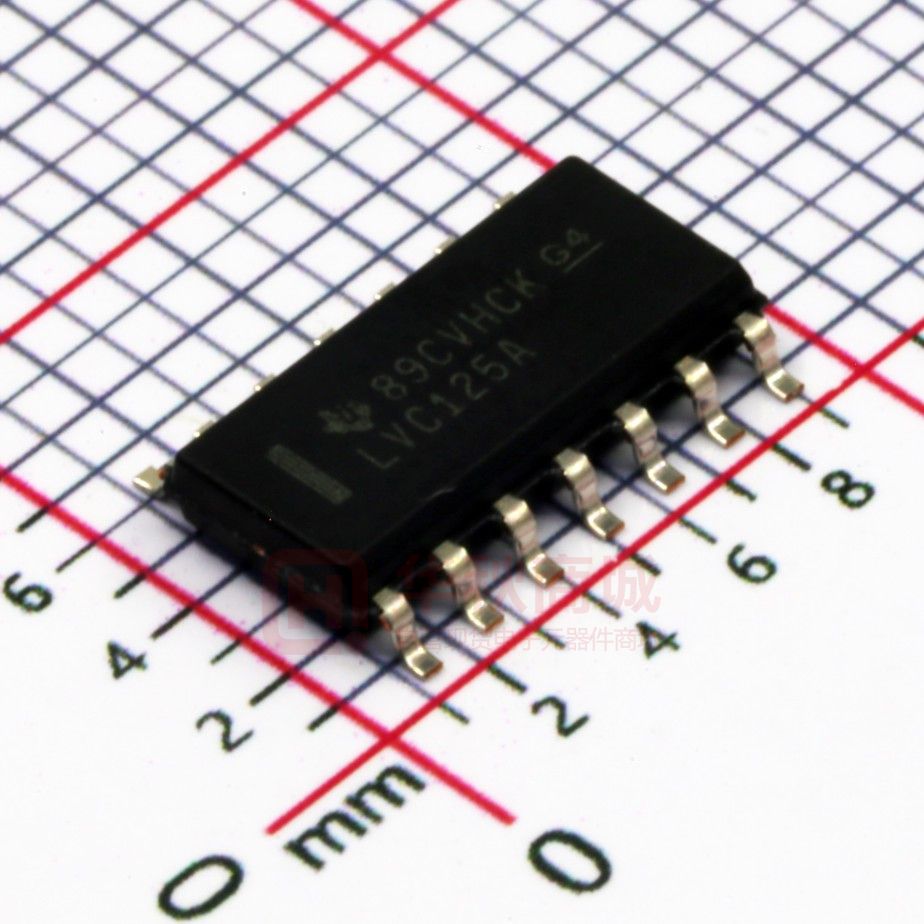

    SN74LVC125A QUADRUPLE BUS BUFFER
SN74LVC125ADR 数据手册
Product Folder Sample & Buy Technical Documents Support & Community Tools & Software SN74LVC125A SCAS290Q – JANUARY 1993 – REVISED JANUARY 2015 SN74LVC125A Quadruple Bus Buffer Gate With 3-State Outputs 1 Features 3 Description • • • • This quadruple bus buffer gate is designed for 1.65-V to 3.6-V VCC operation. 1 • • • • • • 3-State Outputs Separate OE for all 4 buffers Operates From 1.65 V to 3.6 V Specified From –40°C to 85°C and –40°C to 125°C Inputs Accept Voltages to 5.5 V Max tpd of 4.8 ns at 3.3 V Typical VOLP (Output Ground Bounce) < 0.8 V at VCC = 3.3 V, TA = 25°C Typical VOHV (Output VOH Undershoot) > 2 V at VCC = 3.3 V, TA = 25°C Latch-Up Performance Exceeds 250 mA Per JESD 17 ESD Protection Exceeds JESD 22 – 2000-V Human-Body Model – 200-V Machine Model – 1000-V Charged-Device Model The SN74LVC125A device features independent line drivers with 3-state outputs. Each output is disabled when the associated output-enable (OE) input is high. To ensure the high-impedance state during power up or power down, OE should be tied to VCC through a pullup resistor; the minimum value of the resistor is determined by the current-sinking capability of the driver. Inputs can be driven from either 3.3-V or 5-V devices. This feature allows the use of this device as a translator in a mixed 3.3-V/5-V system environment. Device Information(1) PART NUMBER SN74LVC125A 2 Applications • • • • • • • • • • • • • • • Cable Modem Termination Systems IP Phones: Wired and Wireless Optical Modules Optical Networking: – EPON or Video Over Fiber Point-to-Point Microwave Backhaul Power: Telecom DC/DC Modules: – Analog or Digital Private Branch Exchanges (PBX) TETRA Base Stations Telecom Base Band Units Telecom Shelters: – Filter Unit s – Power Distribution Units (PDU) – Power Monitoring Units (PMU) – Wireless Battery Monitoring – Remote Electrical Tilt Units (RET) – Remote Radio Units (RRU) – Tower Mounted Amplifiers (TMA) Vector Signal Analyzers and Generators Video Conferencing: IP-Based HD WiMAX and Wireless Infrastructure Equipment Wireless Communications Testers xDSL Modems and DSLAM PACKAGE (PIN) BODY SIZE SOIC (14) 8.65 mm × 3.91 mm SSOP (14) 6.20 mm × 5.30 mm SOP (14) 10.30 mm × 5.30 mm TSSOP (14) 5.00 mm × 4.40 mm VQFN (14) 3.50 mm × 3.50 mm (1) For all available packages, see the orderable addendum at the end of the data sheet. 4 Simplified Schematic 3OE 1OE 1A 1Y 3Y 4OE 2OE 2A 3A 2Y 4A 4Y 1 An IMPORTANT NOTICE at the end of this data sheet addresses availability, warranty, changes, use in safety-critical applications, intellectual property matters and other important disclaimers. PRODUCTION DATA. SN74LVC125A SCAS290Q – JANUARY 1993 – REVISED JANUARY 2015 www.ti.com Table of Contents 1 2 3 4 5 6 7 8 9 Features .................................................................. Applications ........................................................... Description ............................................................. Simplified Schematic............................................. Revision History..................................................... Pin Configuration and Functions ......................... Specifications......................................................... 1 1 1 1 2 3 4 7.1 7.2 7.3 7.4 7.5 7.6 7.7 7.8 4 4 5 5 6 6 6 7 Absolute Maximum Ratings ..................................... ESD Ratings.............................................................. Recommended Operating Conditions ...................... Thermal Information .................................................. Electrical Characteristics........................................... Switching Characteristics .......................................... Operating Characteristics.......................................... Typical Characteristics .............................................. Parameter Measurement Information .................. 8 Detailed Description .............................................. 9 9.1 9.2 9.3 9.4 Overview ................................................................... Functional Block Diagram ......................................... Feature Description................................................... Device Functional Modes.......................................... 9 9 9 9 10 Application and Implementation........................ 10 10.1 Application Information.......................................... 10 10.2 Typical Application ............................................... 10 11 Power Supply Recommendations ..................... 11 12 Layout................................................................... 11 12.1 Layout Guidelines ................................................. 11 12.2 Layout Example .................................................... 12 13 Device and Documentation Support ................. 13 13.1 Trademarks ........................................................... 13 13.2 Electrostatic Discharge Caution ............................ 13 13.3 Glossary ................................................................ 13 14 Mechanical, Packaging, and Orderable Information ........................................................... 13 5 Revision History Changes from Revision P (October 2010) to Revision Q Page • Added Applications, Device Information table, Pin Functions table, ESD Ratings table, Thermal Information table, Typical Characteristics, Feature Description section, Device Functional Modes, Application and Implementation section, Power Supply Recommendations section, Layout section, Device and Documentation Support section, and Mechanical, Packaging, and Orderable Information section. ................................................................................................. 1 • Deleted Ordering Information table. ....................................................................................................................................... 1 2 Submit Documentation Feedback Copyright © 1993–2015, Texas Instruments Incorporated Product Folder Links: SN74LVC125A SN74LVC125A www.ti.com SCAS290Q – JANUARY 1993 – REVISED JANUARY 2015 6 Pin Configuration and Functions D, DB, NS, OR PW PACKAGE (TOP VIEW) 1OE 1A 1Y 2OE 2A 2Y GND 1 14 2 13 3 12 4 11 5 10 6 9 7 8 VCC 4OE 4A 4Y 3OE 3A 3Y VCC 1 14 2 13 4OE 3 12 4A 4 11 4Y 5 10 3OE 9 3A 7 8 3Y 6 GND 1A 1Y 2OE 2A 2Y 1OE RGY PACKAGE (TOP VIEW) Pin Functions PIN NAME D, DB, NS, PW and RGY TYPE DESCRIPTION 1A 2 I Input 1OE 1 I Output enable 1Y 3 O Output 2A 5 I Input 2OE 4 I Output enable 2Y 6 O Output 3A 9 I Input 3OE 10 I Output enable 3Y 8 O Output 4A 12 I Input 4OE 13 I Output enable 4Y 11 O Output GND 7 — Ground VCC 14 — Power pin Submit Documentation Feedback Copyright © 1993–2015, Texas Instruments Incorporated Product Folder Links: SN74LVC125A 3 SN74LVC125A SCAS290Q – JANUARY 1993 – REVISED JANUARY 2015 www.ti.com 7 Specifications 7.1 Absolute Maximum Ratings over operating free-air temperature range (unless otherwise noted) (1) VCC MIN MAX Supply voltage range –0.5 6.5 UNIT V (2) –0.5 6.5 V –0.5 VCC + 0.5 VI Input voltage range VO Output voltage range (2) (3) IIK Input clamp current VI < 0 –50 mA IOK Output clamp current VO < 0 –50 mA IO Continuous output current ±50 mA ±100 mA 500 mW 150 °C Continuous current through VCC or GND Ptot Power dissipation Tstg Storage temperature range (1) (2) (3) (4) (5) TA = –40°C to 125°C (4) (5) –65 V Stresses beyond those listed under Absolute Maximum Ratings may cause permanent damage to the device. These are stress ratings only, and functional operation of the device at these or any other conditions beyond those indicated under Recommended Operating Conditions is not implied. Exposure to absolute-maximum-rated conditions for extended periods may affect device reliability. The input and output negative-voltage ratings may be exceeded if the input and output current ratings are observed. The value of VCC is provided in the Recommended Operating Conditions table. For the D package: above 70°C, the value of Ptot derates linearly with 8 mW/K. For the DB, NS, and PW packages: above 60°C, the value of Ptot derates linearly with 5.5 mW/K. 7.2 ESD Ratings PARAMETER V(ESD) (1) (2) 4 Electrostatic discharge DEFINITION VALUE Human body model (HBM), per ANSI/ESDA/JEDEC JS-001, all pins (1) 2000 Charged device model (CDM), per JEDEC specification JESD22-C101, all pins (2) 1000 UNIT V JEDEC document JEP155 states that 500-V HBM allows safe manufacturing with a standard ESD control process. JEDEC document JEP157 states that 250-V CDM allows safe manufacturing with a standard ESD control process. Submit Documentation Feedback Copyright © 1993–2015, Texas Instruments Incorporated Product Folder Links: SN74LVC125A SN74LVC125A www.ti.com SCAS290Q – JANUARY 1993 – REVISED JANUARY 2015 7.3 Recommended Operating Conditions over operating free-air temperature range (unless otherwise noted) (1) TA = 25°C VCC Supply voltage VIH High-level input voltage Operating Data retention only MIN MAX MIN MAX MIN MAX 1.65 3.6 1.65 3.6 1.65 3.6 1.5 1.5 0.65 × VCC 0.65 × VCC 0.65 × VCC VCC = 2.3 V to 2.7 V 1.7 1.7 1.7 VCC = 2.7 V to 3.6 V 2 2 2 VCC = 1.65 V to 1.95 V VIL VI Input voltage VO Output voltage High-level output current 0.35 × VCC 0.35 × VCC VCC = 2.3 V to 2.7 V 0.7 0.7 0.7 VCC = 2.7 V to 3.6 V 0.8 0.8 0.8 0 5.5 0 5.5 V 0 VCC 0 VCC 0 VCC V –4 –4 –8 –8 –8 –12 –12 VCC = 3 V –24 –24 –24 VCC = 1.65 V 4 4 4 VCC = 2.3 V 8 8 8 VCC = 2.7 V 12 12 12 VCC = 3 V 24 24 24 8 8 8 Input transition rise or fall rate (1) –4 –12 Δt/Δv V 5.5 VCC = 2.7 V Low-level output current V 0 VCC = 2.3 V IOL UNIT V 0.35 × VCC VCC = 1.65 V IOH –40°C to 125°C 1.5 VCC = 1.65 V to 1.95 V Low-level input voltage –40°C to 85°C mA mA ns/V All unused inputs of the device must be held at VCC or GND to ensure proper device operation. Refer to the TI application report, Implications of Slow or Floating CMOS Inputs, literature number SCBA004. 7.4 Thermal Information THERMAL METRIC (1) RθJA (1) (2) (3) Junction-to-ambient thermal resistance D (2) DB (2) NS (2) PW (2) RGY (3) 113 47 14 PINS 86 96 76 UNIT °C/W For more information about traditional and new thermal metrics, see the IC Package Thermal Metrics application report, SPRA953. The package thermal impedance is calculated in accordance with JESD 51-7. The package thermal impedance is calculated in accordance with JESD 51-5. Submit Documentation Feedback Copyright © 1993–2015, Texas Instruments Incorporated Product Folder Links: SN74LVC125A 5 SN74LVC125A SCAS290Q – JANUARY 1993 – REVISED JANUARY 2015 www.ti.com 7.5 Electrical Characteristics over recommended operating free-air temperature range (unless otherwise noted) PARAMETER TEST CONDITIONS 1.65 V to 3.6 V IOH = –100 μA VOH VCC MIN TYP –40°C to 85°C MAX MIN –40°C to 125°C MAX MIN MAX VCC – 0.2 VCC – 0.2 VCC – 0.3 IOH = –4 mA 1.65 V 1.29 1.2 1.05 IOH = –8 mA 2.3 V 1.9 1.7 1.55 2.7 V 2.2 2.2 2.05 3V 2.4 2.4 2.25 IOH = –24 mA 3V 2.3 2.2 2 IOL = 100 μA 1.65 V to 3.6 V 0.1 0.2 0.3 IOL = 4 mA 1.65 V 0.24 0.45 0.6 IOL = 8 mA 2.3 V 0.3 0.7 0.75 IOL = 12 mA 2.7 V 0.4 0.4 0.6 IOL = 24 mA 3V 0.55 0.55 0.8 IOH = –12 mA VOL TA = 25°C UNIT V V II VI = 5.5 V or GND 3.6 V ±1 ±5 ±20 μA IOZ VO = VCC or GND 3.6 V ±1 ±10 ±20 μA ICC VI = VCC or GND, IO = 0 3.6 V 1 10 40 μA 500 500 5000 μA ΔICC Ci One input at VCC – 0.6 V, Other inputs at VCC or GND 2.7 V to 3.6 V VI = VCC or GND 3.3 V 5 pF 7.6 Switching Characteristics over recommended operating free-air temperature range (unless otherwise noted) (see Figure 3) PARAMETER tpd ten tdis FROM (INPUT) TO (OUTPUT) A Y OE Y OE Y tsk(o) VCC TA = 25°C –40°C to 85°C –40°C to 125°C MIN TYP MAX MIN MAX MIN MAX 1.8 V ± 0.15 V 1 4.5 11.8 1 12.3 1 13.8 2.5 V ± 0.2 V 1 2.7 5.8 1 6.3 1 8.4 2.7 V 1 3 5.3 1 5.5 1 7 3.3 V ± 0.3 V 1 2.5 4.6 1 4.8 1 6 1.8 V ± 0.15 V 1 4.3 13.8 1 14.3 1 15.8 2.5 V ± 0.2 V 1 2.7 6.9 1 7.4 1 9.5 2.7 V 1 3.3 6.4 1 6.6 1 8.5 3.3 V ± 0.3 V 1 2.4 5.2 1 5.4 1 7 1.8 V ± 0.15 V 1 4.3 10.6 1 11.1 1 12.6 2.5 V ± 0.2 V 1 2.2 5.1 1 5.6 1 7.7 2.7 V 1 2.5 4.8 1 5 1 6.5 3.3 V ± 0.3 V 1 2.4 4.4 1 4.6 1 3.3 V ± 0.3 V 1 UNIT ns ns ns 6 1.5 ns 7.7 Operating Characteristics TA = 25°C PARAMETER Cpd 6 Power dissipation capacitance per gate TEST CONDITIONS f = 10 MHz Submit Documentation Feedback VCC TYP 1.8 V 7.4 2.5 V 11.3 3.3 V 15 UNIT pF Copyright © 1993–2015, Texas Instruments Incorporated Product Folder Links: SN74LVC125A SN74LVC125A www.ti.com SCAS290Q – JANUARY 1993 – REVISED JANUARY 2015 7.8 Typical Characteristics 10 14 12 VCC = 3 V, TA = 25°C tpd – Propagation Delay Time – ns tpd – Propagation Delay Time – ns VCC = 3 V, TA = 25°C One Output Switching Four Outputs Switching 10 8 6 4 One Output Switching Four Outputs Switching 8 6 4 2 2 0 50 100 150 200 250 300 CL – Load Capacitance – pF Figure 1. Propagation Delay (Low to High Transition) vs Load Capacitance 0 50 100 150 200 250 300 CL – Load Capacitance – pF Figure 2. Propagation Delay (High to Low Transition) vs Load Capacitance Submit Documentation Feedback Copyright © 1993–2015, Texas Instruments Incorporated Product Folder Links: SN74LVC125A 7 SN74LVC125A SCAS290Q – JANUARY 1993 – REVISED JANUARY 2015 www.ti.com 8 Parameter Measurement Information VLOAD S1 RL From Output Under Test CL (see Note A) Open GND RL TEST S1 tPLH/tPHL tPLZ/tPZL tPHZ/tPZH Open VLOAD GND LOAD CIRCUIT INPUTS VCC 1.8 V ± 0.15 V 2.5 V ± 0.2 V 2.7 V 3.3 V ± 0.3 V VI tr/tf VCC VCC 2.7 V 2.7 V ≤2 ns ≤2 ns ≤2.5 ns ≤2.5 ns VM VLOAD CL RL V∆ VCC/2 VCC/2 1.5 V 1.5 V 2 × VCC 2 × VCC 6V 6V 30 pF 30 pF 50 pF 50 pF 1 kΩ 500 Ω 500 Ω 500 Ω 0.15 V 0.15 V 0.3 V 0.3 V VI Timing Input VM 0V tw tsu VI Input VM VM th VI Data Input VM VM 0V 0V VOLTAGE WAVEFORMS SETUP AND HOLD TIMES VOLTAGE WAVEFORMS PULSE DURATION VI VM Input VM 0V VOH VM Output VM VOL VM tPLZ VLOAD/2 VM tPZH VOH Output VM 0V Output Waveform 1 S1 at VLOAD (see Note B) tPLH tPHL VM tPZL tPHL tPLH VI Output Control VM VOL VOLTAGE WAVEFORMS PROPAGATION DELAY TIMES INVERTING AND NONINVERTING OUTPUTS Output Waveform 2 S1 at GND (see Note B) VOL + V∆ VOL tPHZ VM VOH - V∆ VOH ≈0 V VOLTAGE WAVEFORMS ENABLE AND DISABLE TIMES LOW- AND HIGH-LEVEL ENABLING NOTES: A. CL includes probe and jig capacitance. B. Waveform 1 is for an output with internal conditions such that the output is low, except when disabled by the output control. Waveform 2 is for an output with internal conditions such that the output is high, except when disabled by the output control. C. All input pulses are supplied by generators having the following characteristics: PRR≤ 10 MHz, ZO = 50 Ω. D. The outputs are measured one at a time, with one transition per measurement. E. tPLZ and tPHZ are the same as tdis. F. t PZL and tPZH are the same as ten. G. tPLH and tPHL are the same as tpd. H. All parameters and waveforms are not applicable to all devices. Figure 3. Load Circuit and Voltage Waveforms 8 Submit Documentation Feedback Copyright © 1993–2015, Texas Instruments Incorporated Product Folder Links: SN74LVC125A SN74LVC125A www.ti.com SCAS290Q – JANUARY 1993 – REVISED JANUARY 2015 9 Detailed Description 9.1 Overview The SN74LVC125A device is a quadruple bus buffer gate featuring independent line drivers with 3-state outputs. Each output is disabled when the associated output-enable (OE) input is high. When OE is low, the respective gate passes the data from the A input to its Y output. To ensure the high-impedance state during power up or power down, OE should be tied to VCC through a pull-up resistor; the minimum value of the resistor is determined by the current-sourcing capability of the driver. 9.2 Functional Block Diagram 3OE 1OE 1A 1Y 3A 3Y 4OE 2OE 2A 2Y 4A 4Y 9.3 Feature Description • • • Wide operating voltage range – Operates from 1.65 V to 5.5 V Allows down voltage translation Inputs accept voltages to 5.5 V 9.4 Device Functional Modes Table 1. Function Table INPUTS OE A OUTPUT Y L H H L L L H X Z Submit Documentation Feedback Copyright © 1993–2015, Texas Instruments Incorporated Product Folder Links: SN74LVC125A 9 SN74LVC125A SCAS290Q – JANUARY 1993 – REVISED JANUARY 2015 www.ti.com 10 Application and Implementation NOTE Information in the following applications sections is not part of the TI component specification, and TI does not warrant its accuracy or completeness. TI’s customers are responsible for determining suitability of components for their purposes. Customers should validate and test their design implementation to confirm system functionality. 10.1 Application Information SN74LVC125A is a high drive CMOS device that can be used for a multitude of bus interface type applications where output drive or PCB trace length is a concern. The inputs can accept voltages to 5.5 V at any valid VCC making it ideal for down translation. 10.2 Typical Application 3V 5V 1OE VCC 1Y C/System Logic/LEDs 4OE C or System Logic 4Y 1A 4A GND Figure 4. Typical Application Schematic 10.2.1 Design Requirements This device uses CMOS technology and has balanced output drive. Care should be taken to avoid bus contention because it can drive currents that would exceed maximum limits. The high drive will also create fast edges into light loads so routing and load conditions should be considered to prevent ringing. 10.2.2 Detailed Design Procedure 1. Recommended Input Conditions: – For rise time and fall time specifcations, see (Δt/ΔV) in the Recommended Operating Conditions table. – For specified high and low levels, see (VIH and VIL) in the Recommended Operating Conditions table. – Inputs are overvoltage tolerant allowing them to go as high as (VI max) in the Recommended Operating Conditions table at any valid VCC. 2. Recommend Output Conditions: – Load currents should not exceed (IO max) per output and should not exceed (Continuous current through VCC or GND) total current for the part. These limits are located in the Absolute Maximum Ratings table. 10 Submit Documentation Feedback Copyright © 1993–2015, Texas Instruments Incorporated Product Folder Links: SN74LVC125A SN74LVC125A www.ti.com SCAS290Q – JANUARY 1993 – REVISED JANUARY 2015 Typical Application (continued) – Outputs should not be pulled above VCC. – Series resistors on the output may be used if the user desires to slow the output edge signal or limit the output current. 10.2.3 Application Curves 100 80 60 TA = 25°C, VCC = 3 V, VIH = 3 V, VIL = 0 V, All Outputs Switching 40 TA = 25°C, VCC = 3 V, VIH = 3 V, VIL = 0 V, All Outputs Switching 20 I OH – mA I OL – mA 60 40 0 –20 –40 20 –60 0 –80 –20 –0.2 0.0 0.2 0.4 0.6 0.8 1.0 1.2 1.4 1.6 –100 –1 –0.5 0.0 VOL – V 0.5 1.0 1.5 2.0 2.5 3.0 3.5 4.0 VOH – V Figure 5. Output Drive Current (IOL) vs LOW-level Output Voltage (VOL) Figure 6. Output Drive Current (IOH) vs HIGH-level Output Voltage (VOH) 11 Power Supply Recommendations The power supply can be any voltage between the MIN and MAX supply voltage rating located in the Recommended Operating Conditions table. Each VCC terminal should have a good bypass capacitor to prevent power disturbance. For devices with a single supply, a 0.1 μF capacitor is recommended. If there are multiple VCC terminals then 0.01 μF or 0.022 μF capacitors are recommended for each power terminal. It is ok to parallel multiple bypass capacitors to reject different frequencies of noise. Multiple bypass capacitors may be paralleled to reject different frequencies of noise. The bypass capacitor should be installed as close to the power terminal as possible for the best results. 12 Layout 12.1 Layout Guidelines When using multiple bit logic devices, inputs should not float. In many cases, functions or parts of functions of digital logic devices are unused. Some examples are when only two inputs of a triple-input AND gate are used, or when only 3 of the 4-buffer gates are used. Such input pins should not be left unconnected because the undefined voltages at the outside connections result in undefined operational states. Specified in Figure 7 are rules that must be observed under all circumstances. All unused inputs of digital logic devices must be connected to a high or low bias to prevent them from floating. The logic level that should be applied to any particular unused input depends on the function of the device. Generally they will be tied to GND or VCC, whichever makes more sense or is more convenient. Submit Documentation Feedback Copyright © 1993–2015, Texas Instruments Incorporated Product Folder Links: SN74LVC125A 11 SN74LVC125A SCAS290Q – JANUARY 1993 – REVISED JANUARY 2015 www.ti.com 12.2 Layout Example VCC Unused Input Input Output Unused Input Output Input Figure 7. Layout Diagram 12 Submit Documentation Feedback Copyright © 1993–2015, Texas Instruments Incorporated Product Folder Links: SN74LVC125A SN74LVC125A www.ti.com SCAS290Q – JANUARY 1993 – REVISED JANUARY 2015 13 Device and Documentation Support 13.1 Trademarks All trademarks are the property of their respective owners. 13.2 Electrostatic Discharge Caution These devices have limited built-in ESD protection. The leads should be shorted together or the device placed in conductive foam during storage or handling to prevent electrostatic damage to the MOS gates. 13.3 Glossary SLYZ022 — TI Glossary. This glossary lists and explains terms, acronyms and definitions. 14 Mechanical, Packaging, and Orderable Information The following pages include mechanical packaging and orderable information. This information is the most current data available for the designated devices. This data is subject to change without notice and revision of this document. For browser based versions of this data sheet, refer to the left hand navigation. Submit Documentation Feedback Copyright © 1993–2015, Texas Instruments Incorporated Product Folder Links: SN74LVC125A 13 PACKAGE OPTION ADDENDUM www.ti.com 24-Aug-2018 PACKAGING INFORMATION Orderable Device Status (1) Package Type Package Pins Package Drawing Qty Eco Plan Lead/Ball Finish MSL Peak Temp (2) (6) (3) Op Temp (°C) Device Marking (4/5) SN74LVC125AD ACTIVE SOIC D 14 50 Green (RoHS & no Sb/Br) CU NIPDAU Level-1-260C-UNLIM -40 to 125 LVC125A SN74LVC125ADBR ACTIVE SSOP DB 14 2000 Green (RoHS & no Sb/Br) CU NIPDAU Level-1-260C-UNLIM -40 to 125 LC125A SN74LVC125ADBRG4 ACTIVE SSOP DB 14 2000 Green (RoHS & no Sb/Br) CU NIPDAU Level-1-260C-UNLIM -40 to 125 LC125A SN74LVC125ADE4 ACTIVE SOIC D 14 50 Green (RoHS & no Sb/Br) CU NIPDAU Level-1-260C-UNLIM -40 to 125 LVC125A SN74LVC125ADG4 ACTIVE SOIC D 14 50 Green (RoHS & no Sb/Br) CU NIPDAU Level-1-260C-UNLIM -40 to 125 LVC125A SN74LVC125ADR ACTIVE SOIC D 14 2500 Green (RoHS & no Sb/Br) CU NIPDAU | CU SN Level-1-260C-UNLIM -40 to 125 LVC125A SN74LVC125ADRE4 ACTIVE SOIC D 14 2500 Green (RoHS & no Sb/Br) CU NIPDAU Level-1-260C-UNLIM -40 to 125 LVC125A SN74LVC125ADRG3 ACTIVE SOIC D 14 2500 Green (RoHS & no Sb/Br) CU SN Level-1-260C-UNLIM -40 to 125 LVC125A SN74LVC125ADRG4 ACTIVE SOIC D 14 2500 Green (RoHS & no Sb/Br) CU NIPDAU Level-1-260C-UNLIM -40 to 125 LVC125A SN74LVC125ADT ACTIVE SOIC D 14 250 Green (RoHS & no Sb/Br) CU NIPDAU Level-1-260C-UNLIM -40 to 125 LVC125A SN74LVC125ADTG4 ACTIVE SOIC D 14 250 Green (RoHS & no Sb/Br) CU NIPDAU Level-1-260C-UNLIM -40 to 125 LVC125A SN74LVC125ANSR ACTIVE SO NS 14 2000 Green (RoHS & no Sb/Br) CU NIPDAU Level-1-260C-UNLIM -40 to 125 LVC125A SN74LVC125APW ACTIVE TSSOP PW 14 90 Green (RoHS & no Sb/Br) CU NIPDAU Level-1-260C-UNLIM -40 to 125 LC125A SN74LVC125APWE4 ACTIVE TSSOP PW 14 90 Green (RoHS & no Sb/Br) CU NIPDAU Level-1-260C-UNLIM -40 to 125 LC125A SN74LVC125APWG4 ACTIVE TSSOP PW 14 90 Green (RoHS & no Sb/Br) CU NIPDAU Level-1-260C-UNLIM -40 to 125 LC125A SN74LVC125APWR ACTIVE TSSOP PW 14 2000 Green (RoHS & no Sb/Br) CU NIPDAU | CU SN Level-1-260C-UNLIM -40 to 125 LC125A SN74LVC125APWRE4 ACTIVE TSSOP PW 14 2000 Green (RoHS & no Sb/Br) CU NIPDAU Level-1-260C-UNLIM -40 to 125 LC125A Addendum-Page 1 Samples PACKAGE OPTION ADDENDUM www.ti.com Orderable Device 24-Aug-2018 Status (1) Package Type Package Pins Package Drawing Qty Eco Plan Lead/Ball Finish MSL Peak Temp (2) (6) (3) Op Temp (°C) Device Marking (4/5) SN74LVC125APWRG3 ACTIVE TSSOP PW 14 2000 Green (RoHS & no Sb/Br) CU SN Level-1-260C-UNLIM LC125A SN74LVC125APWRG4 ACTIVE TSSOP PW 14 2000 Green (RoHS & no Sb/Br) CU NIPDAU Level-1-260C-UNLIM -40 to 125 LC125A SN74LVC125APWT ACTIVE TSSOP PW 14 250 Green (RoHS & no Sb/Br) CU NIPDAU Level-1-260C-UNLIM -40 to 125 LC125A SN74LVC125APWTE4 ACTIVE TSSOP PW 14 250 Green (RoHS & no Sb/Br) CU NIPDAU Level-1-260C-UNLIM -40 to 125 LC125A SN74LVC125APWTG4 ACTIVE TSSOP PW 14 250 Green (RoHS & no Sb/Br) CU NIPDAU Level-1-260C-UNLIM -40 to 125 LC125A SN74LVC125ARGYR ACTIVE VQFN RGY 14 3000 Green (RoHS & no Sb/Br) CU NIPDAU Level-2-260C-1 YEAR -40 to 125 LC125A (1) The marketing status values are defined as follows: ACTIVE: Product device recommended for new designs. LIFEBUY: TI has announced that the device will be discontinued, and a lifetime-buy period is in effect. NRND: Not recommended for new designs. Device is in production to support existing customers, but TI does not recommend using this part in a new design. PREVIEW: Device has been announced but is not in production. Samples may or may not be available. OBSOLETE: TI has discontinued the production of the device. (2) RoHS: TI defines "RoHS" to mean semiconductor products that are compliant with the current EU RoHS requirements for all 10 RoHS substances, including the requirement that RoHS substance do not exceed 0.1% by weight in homogeneous materials. Where designed to be soldered at high temperatures, "RoHS" products are suitable for use in specified lead-free processes. TI may reference these types of products as "Pb-Free". RoHS Exempt: TI defines "RoHS Exempt" to mean products that contain lead but are compliant with EU RoHS pursuant to a specific EU RoHS exemption. Green: TI defines "Green" to mean the content of Chlorine (Cl) and Bromine (Br) based flame retardants meet JS709B low halogen requirements of
