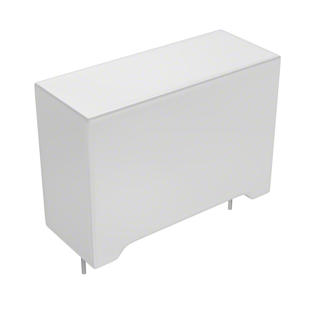

    薄膜电容 径向 680nF ±10% 32.00 x 13.00mm
171684K400Q-F 数据手册
Type 171 Radial Leaded Metallized Polypropylene Radial Box Metallized Polypropylene Capacitors Type 171 radial leaded, box, metallized polypropylene capacitors are available in five pitch sizes and have a flame retardant case and epoxy encapsulant that meets UL94V-0. The Type 171 is an excellent choice for applications requiring low dielectric losses, high insulation resistance in an AC or DC environment. The polypropylene direlectric gives this capacitor excellent pulse rise time (dv/dt) performance. Highlights • • • • High dv/dt Low leakage Radial leaded (7.5, 10, 15, 22.5, 27.5 mm pitch) Flame retardant case and encapsulant meets UL94V-0 Non-inductively wound Specifications Capacitance Range: Voltage Range: Capacitance Tolerance: Operating Temperature Range: Dielectric Withstand Voltage: Dissipation Factor (DF): • RoHS Compliant 0.0022 to 3.3 µF 160 to 630 Vdc (90 to 250 Vac, 60 Hz) ±5%, ±10%, ±20% –55 ºC to +105 ºC (derate linearly to 50% rated 1.6 x rated voltage for 2 s @ +25 ºC ±5 ºC tgδ x 10–4 at +25 ºC ±5 ºC kHz 1 10 100 C ≤0.1 µF 0.1 µF 1 µF ≤6 — — voltage from 85 ºC to 105 ºC) Insulation Resistance: 100,000 MΩ x µF, 200,000 MΩ Min. Self Inductance: 2 mm lead length - total self inductance Pitch (mm) L (nH) ≈ 7.5 8 10 9 15 22.5 18 27.5 18 Life Test: Damp Heat Test: Soldering: Long Term Storage Stability: Maximum Pulse Rise Time dv/dt (V/µ): 10 2000 hrs @ 85 ºC 1.25 x Vn 95% RH @ +40 ºC for 56 days 260 ºC ±5 ºC for 10 s ±1 s ΔC/C ≤ ±0.5% after 2 years Lead Spacing (Pitch) Vn 160 250 400 630 7.5 5.5 15 35 55 10 4 11 20 30 15 2 7 10 15 22.5 1.5 4 5.5 8 27.5 1 3 5 7 If the working voltage (V) is less than the nominal voltage (Vn), the capacitor can work at higher dv/dt . In this case, the maximum value allowed is obtained by multiplying the above value (See table dv/dt) with the ratio Vn/V CDE Cornell Dubilier • 1605 E. Rodney French Blvd. • New Bedford, MA 02744 • Phone: (508)996-8561 • Fax: (508)996-3830 • www.cde.com Type 171 Radial Leaded Metallized Polypropylene Outline Drawing Ratings Cap (µF) Inches (mm) Catolog Part Number L Max 0.413 (10.5) 0.413 (10.5) 0.512 (13.0) 0.512 (13.0) 0.512 (13.0) 0.512 (13.0) 0.709 (18.0) 0.709 (18.0) 0.709 (18.0) 1.043 (26.5) 1.043 (26.5) 1.043 (26.5) 1.26 (32.0) 1.26 (32.0) 0.413 (10.5) 0.413 (10.5) 0.512 (13.0) 0.512 (13.0) 0.512 (13.0) 0.512 (13.0) T Max 0.157 (4.0) 0.157 (4.0) 0.157 (4.0) 0.197 (5.0) 0.197 (5.0) 0.197 (5.0) 0.236 (6.0) 0.236 (6.0) 0.236 (6.0) 0.197 (5.0) 0.236 (6.0) 0.295 (7.5) 0.236 (6.0) 0.335 (8.5) H Max 0.374 (9.5) 0.374 (9.5) 0.374 (9.5) 0.433 (11.0) 0.433 (11.0) 0.433 (11.0) 0.472 (12.0) 0.472 (12.0) 0.472 (12.0) 0.433 (11.0) 0.472 (12.0) 0.531 (13.5) 0.591 (15.0) 0.669 (17.0) S (Pitch) 0.295 (7.5) 0.295 (7.5) 0.394 (10) 0.295 (7.5) 0.394 (10.0) 0.295 (7.5) 0.394 (10.0) 0.295 (7.5) 0.394 (10) 0.591 (15.0) 0.591 (15.0) 0.591 (15.0) 0.886 (22.5) 0.886 (22.5) 0.886 (22.5) 1.083 (27.5) 1.083 (27.5) 0.295 (7.5) 0.295 (7.5) 0.394 (10) 0.394 (10) 0.394 (10) 0.394 (10) Ød 0.024 (0.6) 0.024 (0.6) 0.024 (0.6) 0.024 (0.6) RoHS Compliant ESR (mΩ) IRMS (Amps) 20 kHz to 100 kHz 25 ºC 45 ºC 85 ºC 160 Vdc / 90 Vac 60 Hz 0.033 171333*160B-F 0.047 171473*160B-F 0.047 171473*160C-F 0.068 171683*160D-F 0.1 0.1 0.15 0.15 0.22 0.33 0.47 0.68 1.0 1.5 2.2 3.3 171104*160E-F 171154*160E-F 171224*160F-F 171334*160G-F 171474*160H-F 171684*160L -F 171105*160N-F 171155*160O-F 171225*160P-F 171335*160Q-F 0.068 171683*160C7-F 0.413 (10.5) 171104*160C7-F 0.413 (10.5) 171154*160D7-F 0.413 (10.5) Not applicable. These capacitance values are not 0.024 (0.6) customarily used in switchedmode power supplies 0.024 (0.6) 0.024 (0.6) 0.024 (0.6) 0.024 (0.6) 0.031 (0.8) 0.031 (0.8) 0.031 (0.8) 0.031 (0.8) 0.031 (0.8) 0.031 (0.8) 0.031 (0.8) 0.031 (0.8) 0.024 (0.6) 0.024 (0.6) 0.024 (0.6) Not applicable. These capacitance values are not 0.024 (0.6) customarily used in switchedmode power supplies 0.024 (0.6) 0.024 (0.6) 37 33 26 20 18 16 3.7 4.1 5.5 6.1 6.3 7.4 3.1 3.5 4.7 5.1 5.7 6.4 1.4 1.6 2.6 3.1 3.3 3.6 0.394 (10.0) 0.748 (19.0) 0.433 (11.0) 0.787 (20.0) 0.512 (13.0) 0.886 (22.5) 0.157 (4.0) 0.157 (4.0) 0.157 (4.0) 0.157 (4.0) 0.197 (5.0) 0.236 (6.0) 0.374 (9.5) 0.374 (9.5) 0.374 (9.5) 0.374 (9.5) 0.433 (11.0) 0.472 (12.0) 250 Vdc / 90 Vac 60 Hz 0.015 171153*250B-F 0.022 171223*250B-F 0.022 171223*250C-F 0.033 171333*250C-F 0.047 171473*250D-F 0.068 171683*250E-F * indicates capacitance tolereance, J = ±5%, K = ±10%, M = ±20% CDE Cornell Dubilier • 1605 E. Rodney French Blvd. • New Bedford, MA 02744 • Phone: (508)996-8561 • Fax: (508)996-3830 • www.cde.com Type 171 Radial Leaded Metallized Polypropylene Ratings Cap (µF) 0.10 0.15 0.22 0.33 0.47 0.68 1.0 1.5 0.0068 0.010 0.010 0.015 0.022 0.033 0.047 0.068 0.10 0.15 0.22 0.33 0.47 0.68 0.0022 0.0022 0.0033 0.0033 0.0047 0.0047 0.0068 0.010 0.015 0.022 0.033 0.047 0.068 0.10 0.15 0.22 0.33 Catolog Part Number 171104*250F-F 171154*250G-F 171224*250H-F 171334*250L-F 171474*250M-F 171684*250Q-F 171105*250P-F 171155*250Q-F 171682*400B-F 171103*400B-F 171103*400C-F 171153*400D-F 171223*400D-F 171333*400E-F 171473*400F-F 171683*400G-F 171104*400H-F 171154*400I-F 171224*400N-F 171334*400O-F 171474*400P-F 171684*400Q-F 171222*630B-F 171222*630C-F 171332*630B-F 171332*630C-F 171472*630B-F 171472*630C-F 171682*630D-F 171103*630D-F 171153*630E-F 171223*630F-F 171333*630G-F 171473*630H-F 171683*630I-F 171104*630N-F 171154*630O-F 171224*630P-F 171334*630Q-F Inches (mm) L Max 0.709 (18.0) 0.709 (18.0) 0.709 (18.0) 1.043 (26.5) 1.043 (26.5) 1.26 (32.0) 1.26 (32.0) 1.26 (32.0) 0.413 (10.5) 0.413 (10.5) 0.512 (13.0) 0.512 (13.0) 0.512 (13.0) 0.512 (13.0) 0.709 (18.0) 0.709 (18.0) 0.709 (18.0) 0.709 (18.0) 1.043 (26.5) 1.043 (26.5) 1.26 (32.0) 1.26 (32.0) 0.413 (10.5) 0.512 (13.0) 0.413 (10.5) 0.512 (13.0) 0.413 (10.5) 0.512 (13.0) 0.512 (13.0) 0.512 (13.0) 0.512 (13.0) 0.709 (18.0) 0.709 (18.0) 0.709 (18.0) 0.709 (18.0) 1.043 (26.5) 1.043 (26.5) 1.26 (32.0) 1.26 (32.0) H Max S (Pitch) 250 Vdc / 90 Vac 60 Hz 0.197 (5.0) 0.433 (11.0) 0.591 (15.0) 0.236 (6.0) 0.472 (12.0) 0.591 (15.0) 0.295 (7.5) 0.531 (13.5) 0.591 (15.0) 0.236 (6.0) 0.591 (15.0) 0.886 (22.5) 0.276 (7.0) 0.650 (16.5) 0.886 (22.5) 0.512 (13.0) 0.886 (22.5) 1.083 (27.5) 0.433 (11.0) 0.787 (20.0) 1.083 (27.5) 0.512 (13.0) 0.886 (22.5) 1.083 (27.5) 400 Vdc / 220 Vac 60 Hz 0.157 (4.0) 0.374 (9.5) 0.295 (7.5) 0.157 (4.0) 0.374 (9.5) 0.295 (7.5) 0.157 (4.0) 0.374 (9.5) 0.394 (10.0) 0.197 (5.0) 0.433 (11.0) 0.394 (10.0) 0.197 (5.0) 0.433 (11.0) 0.394 (10.0) 0.236 (6.0) 0.472 (12.0) 0.394 (10.0) 0.197 (5.0) 0.433 (11.0) 0.591 (15.0) 0.236 (6.0) 0.472 (12.0) 0.591 (15.0) 0.295 (7.5) 0.531 (13.5) 0.591 (15.0) 0.335 (8.5) 0.571 (14.5) 0.591 (15.0) 0.335 (8.5) 0.669 (17.0) 0.886 (22.5) 0.394 (10.0) 0.748 (19.0) 0.886 (22.5) 0.433 (11.0) 0.787 (20.0) 1.083 (27.5) 0.512 (13.0) 0.886 (22.5) 1.083 (27.5) 630 Vdc / 250 Vac 60 Hz 0.157 (4.0) 0.374 (9.5) 0.295 (7.5) 0.157 (4.0) 0.374 (9.5) 0.394 (10.0) 0.157 (4.0) 0.374 (9.5) 0.295 (7.5) 0.157 (4.0) 0.374 (9.5) 0.394 (10.0) 0.157 (4.0) 0.374 (9.5) 0.295 (7.5) 0.157 (4.0) 0.374 (9.5) 0.394 (10.0) 0.197 (5.0) 0.433 (11.0) 0.394 (10.0) 0.197 (5.0) 0.433 (11.0) 0.394 (10.0) 0.236 (6.0) 0.472 (12.0) 0.394 (10.0) 0.197 (5.0) 0.433 (11.0) 0.591 (15.0) 0.236 (6.0) 0.472 (12.0) 0.591 (15.0) 0.295 (7.5) 0.531 (13.5) 0.591 (15.0) 0.335 (8.5) 0.571 (14.5) 0.591 (15.0) 0.335 (8.5) 0.669 (17.0) 0.886 (22.5) 0.394 (10.0) 0.748 (19.0) 0.886 (22.5) 0.433 (11.0) 0.787 (20.0) 1.083 (27.5) 0.512 (13.0) 0.886 (22.5) 1.083 (27.5) T Max Ød 0.031 (0.8) 0.031 (0.8) 0.031 (0.8) 0.031 (0.8) 0.031 (0.8) 0.031 (0.8) 0.031 (0.8) 0.031 (0.8) 0.024 (0.6) 0.024 (0.6) 0.024 (0.6) 0.024 (0.6) 0.024 (0.6) 0.024 (0.6) 0.031 (0.8) 0.031 (0.8) 0.031 (0.8) 0.031 (0.8) 0.031 (0.8) 0.031 (0.8) 0.031 (0.8) 0.031 (0.8) 0.024 (0.6) 0.024 (0.6) 0.024 (0.6) 0.024 (0.6) 0.024 (0.6) 0.024 (0.6) 0.024 (0.6) 0.024 (0.6) 0.024 (0.6) 0.031 (0.8) 0.031 (0.8) 0.031 (0.8) 0.031 (0.8) 0.031 (0.8) 0.031 (0.8) 0.031 (0.8) 0.031 (0.8) RoHS Compliant ESR (mΩ) IRMS (Amps) 20 kHz to 100 kHz 25 ºC 45 ºC 85 ºC Not applicable 35 32 28 26 3.8 4 4.4 5.1 3.6 3.8 4.4 4.9 1.7 1.9 3.2 3.5 Not applicable. These capacitance values are not customarily used in switched-mode power supplies 32 30 5.7 5.7 5 5.5 2.2 2.4 Not applicable. These capacitance values are not customarily used in switched-mode power supplies * indicates capacitance tolereance, J = ±5%, K = ±10%, M = ±20% CDE Cornell Dubilier • 1605 E. Rodney French Blvd. • New Bedford, MA 02744 • Phone: (508)996-8561 • Fax: (508)996-3830 • www.cde.com
