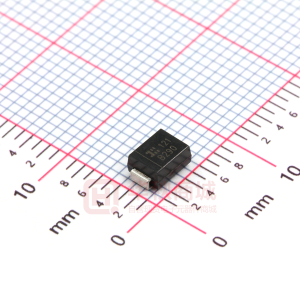

SPICE MODEL: B270 B280 B290 B2100 B270 - B2100 2.0A HIGH VOLTAGE SCHOTTKY BARRIER RECTIFIER Features • • • • • • • Schottky Barrier Chip Guard Ring Die Construction for Transient Protection Low Power Loss, High Efficiency Surge Overload Rating to 50A Peak For Use in Low Voltage, High Frequency Inverters, Free Wheeling, and Polarity Protection Application High Temperature Soldering: 260°C/10 Second at Terminal Lead Free Finish/RoHS Compliant (Note 3) SMB Dim A B C D E G H J Min 3.30 4.06 1.96 0.15 5.00 0.10 0.76 2.00 Max 3.94 4.57 2.21 0.31 5.59 0.20 1.52 2.62 Mechanical Data • • • • • • • • Case: SMB Case Material: Molded Plastic. UL Flammability Classification Rating 94V-0 Moisture Sensitivity: Level 1 per J-STD-020C Terminals: Lead Free Plating (Matte Tin Finish). Solderable per MIL-STD-202, Method 208 Polarity: Cathode Band or Cathode Notch Marking Information: See Page 3 Ordering Information: See Page 3 Weight: 0.093 grams (approximate) All Dimensions in mm Maximum Ratings and Electrical Characteristics Single phase, half wave, 60Hz, resistive or inductive load. For capacitive load, derate current by 20%. Characteristic Peak Repetitive Reverse Voltage Working Peak Reverse Voltage DC Blocking Voltage RMS Reverse Voltage Average Rectified Output Current @ TT = 125°C Non-Repetitive Peak Forward Surge Current 8.3ms single half sine-wave superimposed on rated load Forward Voltage @ IF = 2.0A @ TA = 25°C @ TA = 100°C Peak Reverse Current @ TA = 25°C at Rated DC Blocking Voltage @ TA = 100°C Typical Total Capacitance (Note 2) Typical Thermal Resistance Junction to Terminal (Note 1) Operating and Storage Temperature Range Notes: 1. 2. 3 @TA = 25°C unless otherwise specified Symbol VRRM VRWM VR VR(RMS) IO IFSM VFM IRM CT RθJT Tj, TSTG B270 70 49 B280 80 56 2.0 50 0.79 0.69 0.5 15 75 15 B290 90 63 B2100 100 70 Unit V V A A V mA pF °C/W °C -65 to +150 Valid provided that terminals are kept at ambient temperature. Measured at 1.0 MHz and applied reverse voltage of 4.0V DC. RoHS revision 13.2.2003. Glass and high temperature solder exemptions applied, see EU Directive Annex Notes 5 and 7. DS30021 Rev. 6 - 2 1 of 3 www.diodes.com B270-B2100 © Diodes Incorporated DS30021 Rev. 6 - 2 2 of 3 www.diodes.com B270-B2100 © Diodes Incorporated Ordering Information Device* B2xxx-13-F * Notes: 4. (Note 4) Packaging SMB Shipping 3000/Tape & Reel x = Device type, e.g. B270-13-F For Packaging Details, go to our website at http://www.diodes.com/datasheets/ap02007.pdf. Marking Information IMPORTANT NOTICE Diodes Incorporated and its subsidiaries reserve the right to make modifications, enhancements, improvements, corrections or other changes without further notice to any product herein. Diodes Incorporated does not assume any liability arising out of the application or use of any product described herein; neither does it convey any license under its patent rights, nor the rights of others. The user of products in such applications shall assume all risks of such use and will agree to hold Diodes Incorporated and all the companies whose products are represented on our website, harmless against all damages. LIFE SUPPORT Diodes Incorporated products are not authorized for use as critical components in life support devices or systems without the expressed written approval of the President of Diodes Incorporated. DS30021 Rev. 6 - 2 3 of 3 www.diodes.com B270-B2100 © Diodes Incorporated
