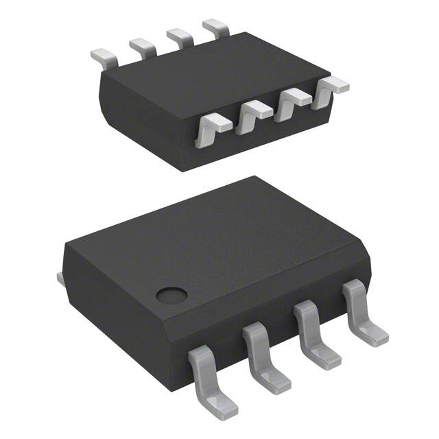

OPTIREG™ Linear TLE4263 5 V low drop fixed voltage regulator Features • Output voltage tolerance ≤ ±2% • 200 mA output current capability • Low-drop voltage • Very low standby current consumption • Overtemperature protection • Reverse polarity protection • Short-circuit proof • Adjustable reset threshold • Watchdog • Wide temperature range • Suitable for use in automotive electronics • Green Product (RoHS compliant) Potential applications General automotive applications. Product validation Qualified for automotive applications. Product validation according to AEC-Q100/101. Description The OPTIREG™ Linear TLE4263 is a 5 V low drop voltage regulator in a SMD package PG-DSO-14, PG-DSO-20, or PG-DSO-8. The maximum input voltage is 45 V. The maximum output current is 200 mA. The IC is short-circuit proof and incorporates temperature protection which turns off the IC at overtemperature. Data Sheet www.infineon.com/OPTIREG-Linear 1 Rev. 3.0 2018-10-04 OPTIREG™ Linear TLE4263 5 V low drop fixed voltage regulator The IC regulates an input voltage VI in the range between 6 V and 45 V to an output voltage to VQ,nom = 5.0 V. A reset signal is generated for an output voltage of VQ,rt < 4.5 V. This voltage threshold can be decreased to 3.5 V by external connection of a voltage divider. The reset delay can be set externally by a capacitor. The integrated watchdog logic supervises the connected microcontroller. The IC can be switched off via the inhibit input, which causes the current consumption to drop from 900 µA to typical 0 µA. Type Package Marking TLE4263GS PG-DSO-8 TLE4263 TLE4263GM PG-DSO-14 TLE4263 TLE4263G PG-DSO-20 TLE4263 Data Sheet 2 Rev. 3.0 2018-10-04 OPTIREG™ Linear TLE4263 5 V low drop fixed voltage regulator Table of contents Features . . . . . . . . . . . . . . . . . . . . . . . . . . . . . . . . . . . . . . . . . . . . . . . . . . . . . . . . . . . . . . . . . . . . . . . . 1 Potential applications . . . . . . . . . . . . . . . . . . . . . . . . . . . . . . . . . . . . . . . . . . . . . . . . . . . . . . . . . . . . . 1 Product validation . . . . . . . . . . . . . . . . . . . . . . . . . . . . . . . . . . . . . . . . . . . . . . . . . . . . . . . . . . . . . . . . 1 Description . . . . . . . . . . . . . . . . . . . . . . . . . . . . . . . . . . . . . . . . . . . . . . . . . . . . . . . . . . . . . . . . . . . . . . 1 Table of contents . . . . . . . . . . . . . . . . . . . . . . . . . . . . . . . . . . . . . . . . . . . . . . . . . . . . . . . . . . . . . . . . . 3 1 Block diagram . . . . . . . . . . . . . . . . . . . . . . . . . . . . . . . . . . . . . . . . . . . . . . . . . . . . . . . . . . . . . . . . . . . 4 2 Pin configuration . . . . . . . . . . . . . . . . . . . . . . . . . . . . . . . . . . . . . . . . . . . . . . . . . . . . . . . . . . . . . . . . . 5 3 3.1 General product characteristics . . . . . . . . . . . . . . . . . . . . . . . . . . . . . . . . . . . . . . . . . . . . . . . . . . . . 6 Absolute maximum ratings . . . . . . . . . . . . . . . . . . . . . . . . . . . . . . . . . . . . . . . . . . . . . . . . . . . . . . . . . . . . . . . . 6 4 4.1 4.2 4.3 Functional description . . . . . . . . . . . . . . . . . . . . . . . . . . . . . . . . . . . . . . . . . . . . . . . . . . . . . . . . . . . . 8 Choosing external components . . . . . . . . . . . . . . . . . . . . . . . . . . . . . . . . . . . . . . . . . . . . . . . . . . . . . . . . . . . . 8 Electrical characteristics . . . . . . . . . . . . . . . . . . . . . . . . . . . . . . . . . . . . . . . . . . . . . . . . . . . . . . . . . . . . . . . . . . 8 Typical performance characteristics . . . . . . . . . . . . . . . . . . . . . . . . . . . . . . . . . . . . . . . . . . . . . . . . . . . . . . . 10 5 5.1 5.2 5.3 Application information . . . . . . . . . . . . . . . . . . . . . . . . . . . . . . . . . . . . . . . . . . . . . . . . . . . . . . . . . . Reset timing . . . . . . . . . . . . . . . . . . . . . . . . . . . . . . . . . . . . . . . . . . . . . . . . . . . . . . . . . . . . . . . . . . . . . . . . . . . . Reset switching threshold . . . . . . . . . . . . . . . . . . . . . . . . . . . . . . . . . . . . . . . . . . . . . . . . . . . . . . . . . . . . . . . . Watchdog timing . . . . . . . . . . . . . . . . . . . . . . . . . . . . . . . . . . . . . . . . . . . . . . . . . . . . . . . . . . . . . . . . . . . . . . . . 6 Package information . . . . . . . . . . . . . . . . . . . . . . . . . . . . . . . . . . . . . . . . . . . . . . . . . . . . . . . . . . . . . 16 7 Revision history . . . . . . . . . . . . . . . . . . . . . . . . . . . . . . . . . . . . . . . . . . . . . . . . . . . . . . . . . . . . . . . . . 18 Data Sheet 3 13 14 15 15 Rev. 3.0 2018-10-04 OPTIREG™ Linear TLE4263 5 V low drop fixed voltage regulator Block diagram 1 Block diagram W Saturation Control and Protection Circuit Temperature Sensor Input Watchdog Ι Q Control Amplifier Buffer Bandgap Reference Reset Generator Output D Reset Delay RO Reset Output RADJ Reset Threshold Adjustment INH Inhibit Figure 1 Data Sheet GND GND AEB03068 Block diagram 4 Rev. 3.0 2018-10-04 OPTIREG™ Linear TLE4263 5 V low drop fixed voltage regulator Pin configuration 2 Pin configuration TLE 4263 G N.C. N.C. RO GND GND GND GND N.C. D RADJ 1 2 3 4 5 6 7 8 9 10 20 19 18 17 16 15 14 13 12 11 TLE 4263 GM INH N.C. VI GND GND GND GND N.C. VQ W 14 13 12 11 10 9 8 1 2 3 4 5 6 7 RO N.C. GND GND GND D RADJ TLE 4263 GS INH I GND GND GND Q W I INH RO GND 1 2 3 4 8 7 6 5 Q W RADJ D AEP01668_4263 AEP03067 AEP01099_4263 Figure 2 Pin configuration (top view) Table 1 Pin definitions and functions Pin PG-DSO-14 Pin PG-DSO-20 Pin PG-DSO-8 Symbol Function 1 3 3 RO Reset output; open-collector output connected to the output via a resistor of 30 kΩ. 2 1, 2, 19, 13 – N.C. Not connected. 3 - 5, 10 - 12 4-7, 14-17 4 GND Ground. 6 9 5 D Reset delay; connected to ground with a capacitor. 7 10 6 RADJ Reset threshold; to adjust the switching threshold connect a voltage divider (output to GND) to the pin. If this input is connected to GND, reset is triggered at an output voltage of 4.5 V. 8 11 7 W Watchdog; rising edge triggered input for monitoring a microcontroller. 9 12 8 Q 5 V output voltage; block to ground with a capacitor, C ≥ 22 µF, ESR ≤ 3 Ω at 10 kHz. 13 18 1 I Input voltage; block to ground directly at the IC with a ceramic capacitor. 14 20 2 INH Inhibit; TTL-compatible, low-active input. Data Sheet 5 Rev. 3.0 2018-10-04 OPTIREG™ Linear TLE4263 5 V low drop fixed voltage regulator General product characteristics 3 General product characteristics 3.1 Absolute maximum ratings Table 2 Absolute maximum ratings Parameter Symbol Values Unit Note or Test Condition Min. Typ. Max. VI II -42 – – – 45 – V – – Internally limited VR IR -0.3 – – – 42 – V – – Internally limited VRADJ -0.3 – 6 V – VD ID -0.3 – – – 42 – V – – Internally limited VQ IQ -0.3 – – – 7 – V – – Internally limited VINH -42 – 45 V – VW -0.3 – 6 V – IGND -0.5 – – A – Tj Tstg – -50 – – 150 150 °C °C – – Input voltage VI – – 45 V – Junction temperature Tj -40 – 150 °C – Input I Input voltage Input current Reset output RO Voltage Current Reset threshold RADJ Voltage Reset delay D Voltage Current Output Q Voltage Current Inhibit INH Voltage Watchdog W Voltage Ground GND Current Temperature Junction temperature Storage temperature Operating range Data Sheet 6 Rev. 3.0 2018-10-04 OPTIREG™ Linear TLE4263 5 V low drop fixed voltage regulator General product characteristics Table 2 Absolute maximum ratings (cont’d) Parameter Symbol Values Unit Note or Test Condition Min. Typ. Max. – – 112 K/W – – 92 K/W – – 185 K/W – – 164 K/W – – 84 K/W – – 66 K/W – – 32 K/W Thermal resistance Junction-ambient Junction-pin Rthj-a Rthj-p PG-DSO-141); Footprint only PG-DSO-141); 300 mm2 Heat sink PG-DSO-81); Footprint only PG-DSO-81); 300 mm2 Heat sink PG-DSO-201); Footprint only PG-DSO-201); 300 mm2 Heat sink PG-DSO-142) 3 1) Worst case; package mounted on PCB 80 × 80 × 1.5 mm ; 35 µm Cu; 5 µm Sn; zero airflow. 2) Measured to pin 4. Data Sheet 7 Rev. 3.0 2018-10-04 OPTIREG™ Linear TLE4263 5 V low drop fixed voltage regulator Functional description 4 Functional description The control amplifier compares a reference voltage, which is kept highly accurate by resistance adjustment, to a voltage that is proportional to the output voltage and drives the base of the series transistor via a buffer. Saturation control as a function of the load current prevents any over-saturation of the power element. If the externally scaled down output voltage at the reset threshold input drops below 1.35 V, the external reset delay capacitor is discharged by the reset generator. When the voltage of the capacitor reaches the lower threshold VDRL, a reset signal occurs at the reset output and is held until the upper threshold VDU is exceeded. If the reset threshold input is connected to GND, reset is triggered at an output voltage of typ. 4.65 V. A connected microcontroller will be monitored through the watchdog logic. In case of missing pulses at pin W, the reset output is set to “low”. The pulse sequence time can be set in a wide range with the reset delay capacitor. The IC can be switched at the TTL-compatible, low-active inhibit input. The IC also incorporates a number of internal circuits for protection against: • Overload • Overtemperature • Reverse polarity 4.1 Choosing external components The input capacitor CI is necessary for compensation of line influences. Using a resistor of approx. 1 Ω in series with CI, the oscillating circuit consisting of input inductivity and input capacitance can be damped. The output capacitor is necessary for the stability of the regulating circuit. Stability is ensured at values CQ ≥ 22 µF and an ESR of ≤ 3 Ω within the operating temperature range. For small tolerances of the reset delay the spread of the capacitance of the delay capacitor and its temperature coefficient should be noted. 4.2 Electrical characteristics Table 3 Electrical characteristics VI = 13.5 V; -40°C < Tj < 125°C; VINH > 3.5 V; (unless specified otherwise) Parameter Symbol Values Min. Typ. Max. Unit Note or Test Condition Normal Operation Output voltage VQ 4.90 5.00 5.10 V 5 mA ≤ IQ ≤ 150 mA; 6 V ≤ VI ≤ 28 V Output voltage VQ 4.90 5.00 5.10 V 6 V ≤ VI ≤ 32 V; IQ = 100 mA; Tj = 100°C Output current limitation IQ,max 201 250 400 mA VQ = 4.8V Current consumption; Iq = II - IQ Iq – 0 50 µA VINH = 0 Iq Iq Iq – – – 900 10 15 1300 18 23 µA mA mA IQ = 0 mA IQ = 150 mA IQ = 150 mA; VI = 4.5 V Drop voltage Vdr – 0.35 0.50 V IQ = 150 mA1) Load regulation ∆VQ,lo – – 25 mV IQ = 5 mA to 150 mA Line regulation ∆VQ.li – 3 25 mV VI = 6 V to 28 V; IQ = 150 mA Data Sheet 8 Rev. 3.0 2018-10-04 OPTIREG™ Linear TLE4263 5 V low drop fixed voltage regulator Functional description Table 3 Electrical characteristics (cont’d) VI = 13.5 V; -40°C < Tj < 125°C; VINH > 3.5 V; (unless specified otherwise) Parameter Symbol Values Unit Note or Test Condition Min. Typ. Max. PSRR – 54 – dB fr = 100 Hz; Vr = 0.5 Vpp Switching threshold VQ,rt 4.5 4.65 4.8 V VRADJ = 0 V Reset adjust threshold VRADJ,th 1.26 1.35 1.44 V VQ > 3.5 V Reset low voltage VRO,l – 0.10 0.40 V IRO = 1 mA Saturation voltage VD,sat – 50 100 mV VQ < VR,th Upper timing threshold VDU 1.45 1.70 2.05 V – Lower reset timing threshold VDRL 0.20 0.35 0.55 V – Charge current ID,ch 40 60 85 µA – Reset delay time trd 1.3 2.8 4.1 ms CD = 100 nF Reset reaction time trr 0.5 1.2 4 µs CD = 100 nF Discharge current ID,wd 4.40 6.25 9.10 µA VD = 1.0 V Upper timing threshold VDU 1.45 1.70 2.05 V – Lower timing threshold VDWL 0.20 0.35 0.55 V – Watchdog trigger time TWI,tr 16 22.5 27 ms CD = 100 nF Switching voltage VINH,ON 3.6 – – V IC turned on Turn-OFF voltage VINH,OFF – – 0.8 V IC turned off Input current IINH 5 10 25 µA VINH = 5 V Power supply ripple rejection Reset Generator Watchdog Inhibit 1) Drop voltage = Vi - VQ (measured when the output voltage has dropped 100 mV from the nominal value obtained at 6 V input). Note: Data Sheet The reset output is “low” within the range VQ = 1 V to VQ,rt. 9 Rev. 3.0 2018-10-04 OPTIREG™ Linear TLE4263 5 V low drop fixed voltage regulator Functional description 4.3 Typical performance characteristics Timing threshold voltage VDU and VDRL versus junction temperature Reset switching threshold versus output voltage AED01098_4263 1.6 V RADJ V 1.4 AED03062 3.2 V V 2.8 1.2 VI = 13.5 V 2.4 1.0 2.0 VDU V Ι = 13.5 V 0.8 1.6 0.6 1.2 0.4 0.8 0.2 0.4 0 0 1 2 3 0 -40 4 V 5 VQ Reset switching threshold versus junction temperature 1.0 10 0.8 8 0.6 6 0.4 4 0.2 2 40 80 0 -40 120 ˚C 160 Tj Data Sheet 80 120 ˚C 160 AED03063 16 µA IINH 14 12 0 40 Current consumption of inhibit versus junction temperature 1.2 0 -40 0 Tj AED01088 1.6 VRADJ V 1.4 VDRL VINH = 5 V 0 40 80 120 ˚C 160 Tj 10 Rev. 3.0 2018-10-04 OPTIREG™ Linear TLE4263 5 V low drop fixed voltage regulator Functional description Drop voltage versus output current Vdr Current consumption versus output current AED03060_4263 800 mV 700 600 AED03061 32 Iq mA 28 24 T j = 125 ˚C 25 ˚C 500 20 VI = 13.5 V 400 16 300 12 200 8 100 4 0 0 50 100 150 200 mA 0 300 0 50 100 150 200 mA IQ Current consumption versus input voltage Output voltage versus input voltage AED01096 30 Ιq Data Sheet 300 IQ AED01097 12 mA VQ V 25 10 20 8 R L = 25 Ω 15 6 10 4 5 2 0 0 0 10 20 30 40 V 50 VΙ R L = 25 Ω 0 2 4 6 8 V 10 VΙ 11 Rev. 3.0 2018-10-04 OPTIREG™ Linear TLE4263 5 V low drop fixed voltage regulator Functional description Charge current and discharge current versus junction temperature Ι Output voltage versus junction temperature AED03064 80 μA 70 VQ 60 50 Ι D, ch 5.1 V Ι = 13.5 V V D = 1.5 V 5.0 40 AED01090 5.2 V VI = 13.5 V 4.9 30 4.8 20 0 -40 4.7 Ι D, dis 10 0 80 40 4.6 -40 120 C 160 Tj Pulse time versus junction temperature 0 40 80 120 ˚C 160 Tj Output current versus input voltage AED03065_4263 40 ms TWI,tr 35 AED01091 300 ΙQ mA T j = 25 C 250 30 200 V Ι = 13.5 V C D = 100 nF 25 20 150 15 100 10 50 5 0 -40 Data Sheet 0 40 80 0 120 C 160 Tj 12 0 10 20 30 40 V 50 VΙ Rev. 3.0 2018-10-04 OPTIREG™ Linear TLE4263 5 V low drop fixed voltage regulator Application information 5 Application information Ι Input Q Output 470 nF 6 V...45 V KL 15 INH Reset To MC RO D TLE 4263G 100 k Ω 100 nF 22 μF RADJ GND 56 k Ω W Watchdog from MC Figure 3 AES03069 Application circuit ΙΙ Ι 1000 μF 470 nF ΙE VΙ + Vr VE PSRR = 20 log Q 22 μF TLE 4263G INH VC ΙQ RO D Ι D, ch CD GND Ι GND W RADJ VW VRADJ 5.6 k Ω Ι RD VQ VRO 100 nF Vr ΔVQ, r AES03070_4263 Figure 4 Data Sheet Test circuit 13 Rev. 3.0 2018-10-04 OPTIREG™ Linear TLE4263 5 V low drop fixed voltage regulator Application information 5.1 Reset timing The power-on reset delay time is defined by the charging time of an external capacitor CD which can be calculated as follows: CD = (trd × ID,ch)/∆V (5.1) Definitions: • CD = delay capacitor • trd = reset delay time • ID,ch = charge current, typical 60 µA • ∆V = VDU, typical 1.70 V • VDU = upper delay switching threshold at CD for reset delay time VI < trr t VQ VQ, rt dV ID, ch = dt CD VD t VDU VDRL trd trr t VRO t Power-ON Reset Figure 5 Data Sheet Overtemperature Voltage Drop at Input Undervoltage Secondary Load Bounce Spike AET03066 Time response, watchdog with high-frequency clock 14 Rev. 3.0 2018-10-04 OPTIREG™ Linear TLE4263 5 V low drop fixed voltage regulator Application information 5.2 Reset switching threshold The present default value is typ. 4.65 V. When using the TLE4263 the reset threshold can be set to 3.5 V < VQ,rt < 4.6 V by connecting an external voltage divider to pin RADJ. The calculation can be easily done since the reset adjust input current can be neglected. If this feature is not needed, the pin must be connected to GND. VQ,rt = (1 + R1/R2) × VRADJ,th (5.2) Definitions: • VQ,rt = reset threshold • VRADJ,th = comparator reference voltage, typical 1.35 V 5.3 Watchdog timing The frequency of the watchdog pulses must be higher than the minimum pulse sequence which is set by the external reset delay capacitor CD. Calculation can be done according to the formula given in Figure 6. VW t VΙ VQ T WD, p VD T WI, tr t t VDU VDWL VRO T WI, tr = t WD, L (VDU - VDWL ) Ι D, wd t t CD AED03099_4263 Figure 6 Data Sheet Timing of the watchdog function reset 15 Rev. 3.0 2018-10-04 OPTIREG™ Linear TLE4263 5 V low drop fixed voltage regulator Package information 6 Package information 1.27 0.1 0.41 +0.1 -0.06 0.19 +0.0 6 B 0.64 ±0.25 0.2 M A B 8x 8 5 Index Marking 1 4 5 -0.21) 8° MAX. 4 -0.21) 1.75 MAX. 0.175 ±0.07 (1.45) 0.35 x 45° 6 ±0.2 A 1) Does not include plastic or metal protrusion of 0.15 max. per side 2) Lead width can be 0.61 max. in dambar area GPS01229 Figure 7 PG-DSO-8 (Plastic Dual Small Outline)1) Figure 8 PG-DSO-14 (Plastic Dual Small Outline)1) 1) Dimension in mm Data Sheet 16 Rev. 3.0 2018-10-04 OPTIREG™ Linear TLE4263 5 V low drop fixed voltage regulator 1.27 0.35 7.6 -0.2 1) 8˚ MAX. 0.35 x 45˚ 0.23 +0.09 2.65 MAX. 0.2 -0.1 2.45 -0.2 Package information 0.4 +0.8 0.1 +0.15 2) 0.2 20x 20 10.3 ±0.3 11 10 1 12.8 -0.2 1) Index Marking 1) 2) Does not include plastic or metal protrusion of 0.15 max. per side Does not include dambar protrusion of 0.05 max. per side GPS05094 Figure 9 PG-DSO-20 (Plastic Dual Small Outline)1) Green Product (RoHS compliant) To meet the world-wide customer requirements for environmentally friendly products and to be compliant with government regulations the device is available as a green product. Green products are RoHS-Compliant (i.e Pb-free finish on leads and suitable for Pb-free soldering according to IPC/JEDEC J-STD-020). Further information on packages https://www.infineon.com/packages Data Sheet 17 Rev. 3.0 2018-10-04 OPTIREG™ Linear TLE4263 5 V low drop fixed voltage regulator Revision history 7 Revision history Revision Date Changes 3.0 2018-10-04 Updated layout and structure Page 8: output current changed to output current limitation, add note VQ = 4.8V Drop voltage: added footnote Updated package drawing “PG-DSO-14” Editorial changes 2.9 2013-11-25 Package version changed: - PG-DSO-20-35 to PG-DSO-20 Package naming harmonized according to Infineon standards: - PG-DSO-8-16 to PG-DSO-8 - PG-DSO-14-30 to PG-DSO-14 2.8 2007-03-20 Initial version of RoHS-compliant derivate of TLE4263 Page 1: AEC certified statement added Page 1 and Page 16 ff: RoHS compliance statement and Green product feature added Page 1 and Page 16 ff: Package changed to RoHS compliant version Legal Disclaimer updated Data Sheet 18 Rev. 3.0 2018-10-04 Trademarks All referenced product or service names and trademarks are the property of their respective owners. Edition 2018-10-04 Published by Infineon Technologies AG 81726 Munich, Germany © 2018 Infineon Technologies AG. All Rights Reserved. Do you have a question about any aspect of this document? Email: erratum@infineon.com Document reference Z8F52231383 IMPORTANT NOTICE The information given in this document shall in no event be regarded as a guarantee of conditions or characteristics ("Beschaffenheitsgarantie"). With respect to any examples, hints or any typical values stated herein and/or any information regarding the application of the product, Infineon Technologies hereby disclaims any and all warranties and liabilities of any kind, including without limitation warranties of non-infringement of intellectual property rights of any third party. In addition, any information given in this document is subject to customer's compliance with its obligations stated in this document and any applicable legal requirements, norms and standards concerning customer's products and any use of the product of Infineon Technologies in customer's applications. The data contained in this document is exclusively intended for technically trained staff. It is the responsibility of customer's technical departments to evaluate the suitability of the product for the intended application and the completeness of the product information given in this document with respect to such application. For further information on technology, delivery terms and conditions and prices, please contact the nearest Infineon Technologies Office (www.infineon.com). WARNINGS Due to technical requirements products may contain dangerous substances. For information on the types in question please contact your nearest Infineon Technologies office. Except as otherwise explicitly approved by Infineon Technologies in a written document signed by authorized representatives of Infineon Technologies, Infineon Technologies’ products may not be used in any applications where a failure of the product or any consequences of the use thereof can reasonably be expected to result in personal injury.
