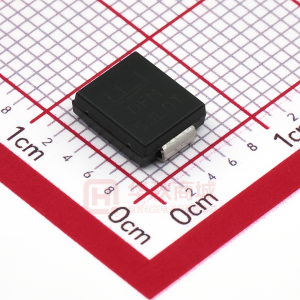

Physical Specifications
Weight Case Polarity Terminal 0.007 ounce, 0.21 grams JEDEC DO214AB. Molded plastic body over glass passivated junction Color band denotes positive end (cathode) except Bidirectional. Matte Tin-plated leads, Solderable per JESD22-B102D
