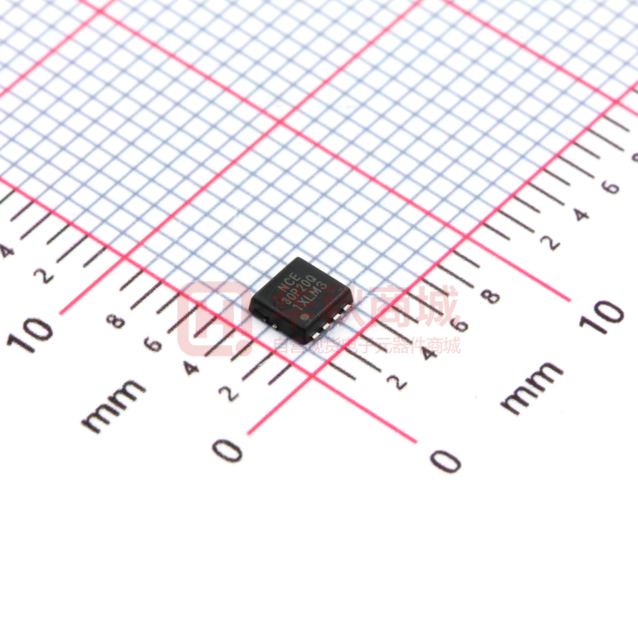

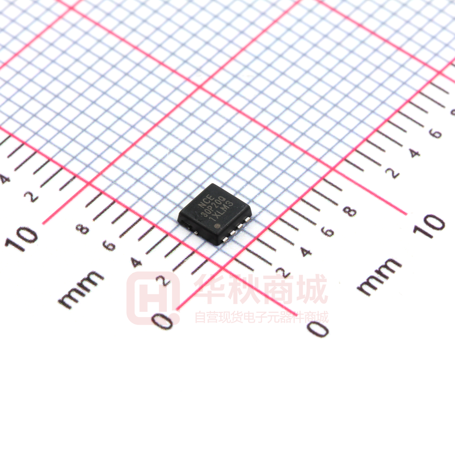

NCE30P20Q http://www.ncepower.com NCE P-Channel Enhancement Mode Power MOSFET Description The NCE30P20Q uses advanced trench technology to provide excellent RDS(ON), low gate charge . This device is suitable for use as a load switch or in PWM applications. General Features Schematic diagram ● VDS = -30V,ID = -20A RDS(ON) < 25mΩ @ VGS=-4.5V RDS(ON) < 15mΩ @ VGS=-10V ● High Power and current handing capability ● Lead free product is acquired ● Surface mount package pin assignment Application ● PWM applications ● Load switch ● Power management 100% UIS TESTED! 100% ∆Vds TESTED! Top View Bottom View Package Marking and Ordering Information Device Marking Device Device Package Reel Size Tape width Quantity NCE30P20Q NCE30P20Q DFN3.3X3.3-8L Ø330mm 12mm 5000 units Absolute Maximum Ratings (TA=25℃unless otherwise noted) Parameter Symbol Limit Unit Drain-Source Voltage VDS -30 V Gate-Source Voltage VGS ±20 V ID -20 A Drain Current-Continuous Drain Current-Continuous(TC=100℃) ID (100℃) -14.1 A (Note 1) IDM -80 A Maximum Power Dissipation PD 35 W TJ,TSTG -55 To 150 ℃ RθJC 3.57 ℃/W Drain Current-Pulsed Operating Junction and Storage Temperature Range Thermal Characteristic Thermal Resistance,Junction-to-Case (Note 2) Wuxi NCE Power Co., Ltd Page 1 V3.0 NCE30P20Q http://www.ncepower.com Electrical Characteristics (TA=25℃unless otherwise noted) Parameter Symbol Condition Min Typ Max Unit Drain-Source Breakdown Voltage BVDSS VGS=0V ID=-250μA -30 -33 - V Zero Gate Voltage Drain Current IDSS VDS=-30V,VGS=0V - - -1 μA Gate-Body Leakage Current IGSS VGS=±20V,VDS=0V - - ±100 nA Gate Threshold Voltage VGS(th) VDS=VGS,ID=-250μA -1 -1.5 -1.9 V Drain-Source On-State Resistance RDS(ON) VGS=-10V, ID=-15A - 11.5 15 mΩ VGS=-4.5V, ID=-15A - 18 25 mΩ - 5.2 - Ω 15 - - S - 2130 - PF - 302 - PF - 227 - PF - 12 - nS On Characteristics (Note 3) Gate resistance RG Forward Transconductance Dynamic Characteristics gFS VDS=-5V,ID=-15A (Note4) Input Capacitance Clss Output Capacitance Coss Reverse Transfer Capacitance Switching Characteristics Crss VDS=-25V,VGS=0V, F=1.0MHz (Note 4) Turn-on Delay Time td(on) Turn-on Rise Time tr VDD=-15V, ID=-15A, - 10 - nS td(off) VGS=-10V,RGEN=1Ω - 25 - nS Turn-Off Delay Time Turn-Off Fall Time tf - 13 - nS Total Gate Charge Qg - 45.6 - nC Gate-Source Charge Qgs - 4.6 - nC Gate-Drain Charge Qgd - 11.1 - nC - - -1.2 V VDS=-15V,ID=-20A,VGS=-10V Drain-Source Diode Characteristics Diode Forward Voltage (Note 3) VSD VGS=0V,IS=-20A Notes: 1. Repetitive Rating: Pulse width limited by maximum junction temperature. 2. Surface Mounted on FR4 Board, t ≤ 10 sec. 3. Pulse Test: Pulse Width ≤ 300μs, Duty Cycle ≤ 2%. 4. Guaranteed by design, not subject to production Wuxi NCE Power Co., Ltd Page 2 V3.0 NCE30P20Q http://www.ncepower.com Typical Electrical and Thermal Characteristics ton tr td(on) toff tf td(off) 90% VOUT 90% INVERTED 10% 10% 90% VIN 50% 50% 10% PULSE WIDTH Figure 2:Switching Waveforms PD Power(W) ID- Drain Current (A) Figure 1:Switching Test Circuit TJ-Junction Temperature(℃) TJ-Junction Temperature(℃) Figure 4 Drain Current ID- Drain Current (A) Rdson On-Resistance(mΩ) Figure 3 Power Dissipation ID- Drain Current (A) Vds Drain-Source Voltage (V) Figure 5 Output Characteristics Wuxi NCE Power Co., Ltd Figure 6 Drain-Source On-Resistance Page 3 V3.0 NCE30P20Q ID- Drain Current (A) Normalized On-Resistance http://www.ncepower.com TJ-Junction Temperature(℃) Vgs Gate-Source Voltage (V) Figure 8 Drain-Source On-Resistance C Capacitance (pF) Rdson On-Resistance(mΩ) Figure 7 Transfer Characteristics Vgs Gate-Source Voltage (V) Vds Drain-Source Voltage (V) Figure 10 Capacitance vs Vds Vgs Gate-Source Voltage (V) Is- Reverse Drain Current (A) Figure 9 Rdson vs Vgs Vsd Source-Drain Voltage (V) Qg Gate Charge (nC) Figure 11 Gate Charge Wuxi NCE Power Co., Ltd Figure 12 Source- Drain Diode Forward Page 4 V3.0 NCE30P20Q Normalized BVdss ID- Drain Current (A) http://www.ncepower.com Vds Drain-Source Voltage (V) TJ-Junction Temperature(℃) Figure 14 BVDSS vs Junction Temperature r(t),Normalized Effective Transient Thermal Impedance Figure 13 Safe Operation Area Square Wave Pluse Duration(sec) Figure 15 Normalized Maximum Transient Thermal Impedance Wuxi NCE Power Co., Ltd Page 5 V3.0 NCE30P20Q http://www.ncepower.com DFN3.3X3.3-8L Package Information DFN3.3X3.3-8L Package Information Dimensions In Millimeters Symbol Min. Nom. Max. A 0.70 0.75 0.80 b 0.25 0.30 0.35 c 0.10 0.15 0.25 D 3.25 3.35 3.45 D1 3.00 3.10 3.20 D2 1.48 1.58 1.68 D3 - 0.13 - E 3.20 3.30 3.40 E1 3.00 3.15 3.20 E2 2.39 2.49 2.59 e 0.65BSC H 0.30 0.39 0.50 L 0.30 0.40 0.50 L1 - 0.13 - M * * 0.15 。 10 。 12 θ Wuxi NCE Power Co., Ltd Page 6 V3.0 http://www.ncepower.com Wuxi NCE Power Co., Ltd Page 7 NCE30P20Q V3.0 http://www.ncepower.com NCE30P20Q Attention ■ Any and all NCE power products described or contained herein do not have specifications that can handle applications that ■ ■ ■ ■ ■ ■ ■ ■ require extremely high levels of reliability, such as life-support systems, aircraft's control systems, or other applications whose failure can be reasonably expected to result in serious physical and/or material damage. Consult with your NCE power representative nearest you before using any NCE power products described or contained herein in such applications. NCE power assumes no responsibility for equipment failures that result from using products at values that exceed, even momentarily, rated values (such as maximum ratings, operating condition ranges, or other parameters) listed in products specifications of any and all NCE power products described or contained herein. Specifications of any and all NCE power products described or contained herein stipulate the performance, characteristics, and functions of the described products in the independent state, and are not guarantees of the performance, characteristics, and functions of the described products as mounted in the customer’s products or equipment. To verify symptoms and states that cannot be evaluated in an independent device, the customer should always evaluate and test devices mounted in the customer’s products or equipment. NCE power Semiconductor CO.,LTD. strives to supply high-quality high-reliability products. However, any and all semiconductor products fail with some probability. It is possible that these probabilistic failures could give rise to accidents or events that could endanger human lives, that could give rise to smoke or fire, or that could cause damage to other property. When designing equipment, adopt safety measures so that these kinds of accidents or events cannot occur. Such measures include but are not limited to protective circuits and error prevention circuits for safe design, redundant design, and structural design. In the event that any or all NCE power products(including technical data, services) described or contained herein are controlled under any of applicable local export control laws and regulations, such products must not be exported without obtaining the export license from the authorities concerned in accordance with the above law. No part of this publication may be reproduced or transmitted in any form or by any means, electronic or mechanical, including photocopying and recording, or any information storage or retrieval system, or otherwise, without the prior written permission of NCE power Semiconductor CO.,LTD. Information (including circuit diagrams and circuit parameters) herein is for example only ; it is not guaranteed for volume production. NCE power believes information herein is accurate and reliable, but no guarantees are made or implied regarding its use or any infringements of intellectual property rights or other rights of third parties. Any and all information described or contained herein are subject to change without notice due to product/technology improvement, etc. When designing equipment, refer to the "Delivery Specification" for the NCE power product that you intend to use. This catalog provides information as of Sep.2010. Specifications and information herein are subject to change without notice. Wuxi NCE Power Co., Ltd Page 8 V3.0
