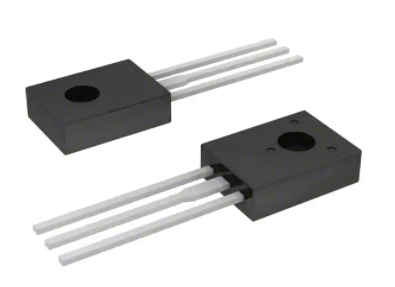

    通用三极管 NPN Ic=1.5A Vceo=80V hfe=40~250 P=1.25W TO225
BD139G 数据手册
BD135, BD137, BD139 Plastic Medium Power Silicon NPN Transistor This series of plastic, medium−power silicon NPN transistors are designed for use as audio amplifiers and drivers utilizing complementary or quasi complementary circuits. http://onsemi.com Features • Pb−Free Packages are Available • DC Current Gain − hFE = 40 (Min) @ IC = 0.15 Adc • BD 135, 137, 139 are complementary with BD 136, 138, 140 1.5 A POWER TRANSISTORS NPN SILICON 45, 60, 80 V, 12.5 W MAXIMUM RATINGS Rating Collector−Emitter Voltage BD135 BD137 BD139 BD135 BD137 BD139 Symbol VCEO Value 45 60 80 45 60 100 5.0 1.5 0.5 1.25 10 12.5 100 – 55 to + 150 Unit Vdc 32 1 Vdc TO−225AA CASE 77 STYLE 1 Collector−Base Voltage VCBO MARKING DIAGRAM Vdc Adc Adc Watts mW/°C Watts mW/°C °C xx Y WW = 35, 37, 39 = Year = Work Week YWW BD1xx Emitter−Base Voltage Collector Current Base Current Total Device Dissipation @ TA = 25°C Derate above 25°C Total Device Dissipation @ TC = 25°C Derate above 25°C Operating and Storage Junction Temperature Range VEBO IC IB PD PD TJ, Tstg ORDERING INFORMATION Device BD135 BD135G BD137 Package TO−225AA TO−225AA (Pb−Free) TO−225AA TO−225AA (Pb−Free) TO−225AA TO−225AA (Pb−Free) Shipping† 500 Units/Box 500 Units/Box 500 Units/Box 500 Units/Box 500 Units/Box 500 Units/Box Maximum ratings are those values beyond which device damage can occur. Maximum ratings applied to the device are individual stress limit values (not normal operating conditions) and are not valid simultaneously. If these limits are exceeded, device functional operation is not implied, damage may occur and reliability may be affected. THERMAL CHARACTERISTICS Characteristic Thermal Resistance, Junction−to−Case Thermal Resistance, Junction−to−Ambient Symbol qJC qJA Max 10 100 Unit °C/W °C/W BD137G BD139 BD139G †For information on tape and reel specifications, including part orientation and tape sizes, please refer to our Tape and Reel Packaging Specifications Brochure, BRD8011/D. *For additional information on our Pb−Free strategy and soldering details, please download the ON Semiconductor Soldering and Mounting Techniques Reference Manual, SOLDERRM/D. © Semiconductor Components Industries, LLC, 2005 1 April, 2005 − Rev. 12 Publication Order Number: BD135/D BD135, BD137, BD139 ELECTRICAL CHARACTERISTICS (TC = 25_C unless otherwise noted) Characteristic Collector−Emitter Sustaining Voltage* (IC = 0.03 Adc, IB = 0) Symbol BVCEO* BD 135 BD 137 BD 139 ICBO − − IEBO hFE* 25 40 25 VCE(sat)* VBE(on)* − − − 250 − 0.5 1 Vdc Vdc − 0.1 10 10 mAdc − 45 60 80 − − − mAdc Type Min Max UnIt Vdc Collector Cutoff Current (VCB = 30 Vdc, IE = 0) (VCB = 30 Vdc, IE = 0, TC = 125_C) Emitter Cutoff Current (VBE = 5.0 Vdc, IC = 0) DC Current Gain (IC = 0.005 A, VCE = 2 V) (IC = 0.15 A, VCE = 2 V) (IC = 0.5 A VCE = 2 V) Collector−Emitter Saturation Voltage* (IC = 0.5 Adc, IB = 0.05 Adc) Base−Emitter On Voltage* (IC = 0.5 Adc, VCE = 2.0 Vdc) *Pulse Test: Pulse Width x 300 ms, Duty Cycle x 2.0%. 10.0 IC, COLLECTOR CURRENT (AMP) 5.0 2.0 1.0 0.5 TJ = 125°C 5 ms 0.1 ms 0.5 ms dc 0.1 0.05 0.02 0.01 1 BD135 BD137 BD139 2 5 10 20 50 VCE, COLLECTOR−EMITTER VOLTAGE (VOLTS) 80 Figure 1. Active−Region Safe Operating Area http://onsemi.com 2 BD135, BD137, BD139 PACKAGE DIMENSIONS TO−225AA CASE 77−09 ISSUE Z NOTES: 1. DIMENSIONING AND TOLERANCING PER ANSI Y14.5M, 1982. 2. CONTROLLING DIMENSION: INCH. 3. 077−01 THRU −08 OBSOLETE, NEW STANDARD 077−09. INCHES MIN MAX 0.425 0.435 0.295 0.305 0.095 0.105 0.020 0.026 0.115 0.130 0.094 BSC 0.050 0.095 0.015 0.025 0.575 0.655 5 _ TYP 0.148 0.158 0.045 0.065 0.025 0.035 0.145 0.155 0.040 −−− MILLIMETERS MIN MAX 10.80 11.04 7.50 7.74 2.42 2.66 0.51 0.66 2.93 3.30 2.39 BSC 1.27 2.41 0.39 0.63 14.61 16.63 5 _ TYP 3.76 4.01 1.15 1.65 0.64 0.88 3.69 3.93 1.02 −−− −B− U Q F M C −A− 123 H K V G S D 2 PL 0.25 (0.010) M J R 0.25 (0.010) A M A M M B M B M DIM A B C D F G H J K M Q R S U V STYLE 1: PIN 1. EMITTER 2. COLLECTOR 3. BASE http://onsemi.com 3 BD135, BD137, BD139 ON Semiconductor and are registered trademarks of Semiconductor Components Industries, LLC (SCILLC). SCILLC reserves the right to make changes without further notice to any products herein. SCILLC makes no warranty, representation or guarantee regarding the suitability of its products for any particular purpose, nor does SCILLC assume any liability arising out of the application or use of any product or circuit, and specifically disclaims any and all liability, including without limitation special, consequential or incidental damages. “Typical” parameters which may be provided in SCILLC data sheets and/or specifications can and do vary in different applications and actual performance may vary over time. All operating parameters, including “Typicals” must be validated for each customer application by customer’s technical experts. SCILLC does not convey any license under its patent rights nor the rights of others. SCILLC products are not designed, intended, or authorized for use as components in systems intended for surgical implant into the body, or other applications intended to support or sustain life, or for any other application in which the failure of the SCILLC product could create a situation where personal injury or death may occur. Should Buyer purchase or use SCILLC products for any such unintended or unauthorized application, Buyer shall indemnify and hold SCILLC and its officers, employees, subsidiaries, affiliates, and distributors harmless against all claims, costs, damages, and expenses, and reasonable attorney fees arising out of, directly or indirectly, any claim of personal injury or death associated with such unintended or unauthorized use, even if such claim alleges that SCILLC was negligent regarding the design or manufacture of the part. SCILLC is an Equal Opportunity/Affirmative Action Employer. This literature is subject to all applicable copyright laws and is not for resale in any manner. PUBLICATION ORDERING INFORMATION LITERATURE FULFILLMENT: Literature Distribution Center for ON Semiconductor P.O. Box 61312, Phoenix, Arizona 85082−1312 USA Phone: 480−829−7710 or 800−344−3860 Toll Free USA/Canada Fax: 480−829−7709 or 800−344−3867 Toll Free USA/Canada Email: orderlit@onsemi.com N. American Technical Support: 800−282−9855 Toll Free USA/Canada Japan: ON Semiconductor, Japan Customer Focus Center 2−9−1 Kamimeguro, Meguro−ku, Tokyo, Japan 153−0051 Phone: 81−3−5773−3850 ON Semiconductor Website: http://onsemi.com Order Literature: http://www.onsemi.com/litorder For additional information, please contact your local Sales Representative. http://onsemi.com 4 BD135/D
