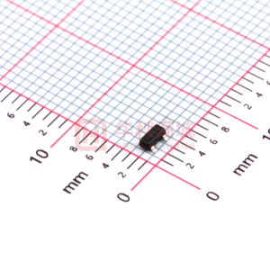

BZX84B4V3 SERIES SURFACE MOUNT SILICON ZENER DIODES VOLTAGE 4.3 to 51 Volts POWER 410 mWatts SOT- 23 Unit: inch (mm) FEATURES • Planar Die construction • 410mW Power Dissipation .056(1.40) .119(3.00) .110(2.80) • Zener Voltages from 4.3~51V • Ideally Suited for Automated Assembly Processes • Pb free product : 99% Sn above can meet RoHS environment substance directive request .047(1.20) .007(.20)MIN .103(2.60) .083(2.10) .066(1.70) .006(.15) .002(.05) MECHANICAL DATA • Case: SOT-23, Molded Plastic • Terminals: Solderable per MIL-STD-750, Method 2026 .044(1.10) .006(.15)MAX • Polarity: See Diagram Below • Approx. Weight: 0.008 grams • Mounting Position: Any .020(.50) .013(.35) MAXIMUM RATINGS AND ELECTRICAL CHARACTERISTICS Parameter Maximum Power Dissipation (Notes A) at 25O C Operating Junction and StorageTemperature Range Symbol Value 410 -50 to +150 .035(0.90) Units mW O PD TJ C NOTES: A. Mounted on 5.0mm2(.013mm thick) land areas. STAD-JAN.13.2006 .086(2.20) PAGE . 1 BZX84B4V3 SERIES Nominal Zener Voltage Part Number Nom. V VZ @ IZT Min. V Max. V Ω Max. Zener Impedance ZZT @ IZT mA Ω ZZK @ IZK mA Max Reverse Leakage Current IR @ VR µA V Marking C ode W7 W8 W9 WA WB WC WD WE WF WG WH WI WK WJ WL WM 17C WN WO WP WR WS 28C WT WU WW WX WY WZ XA P ackag e BZX84B4V3 BZX84B4V7 BZX84B5V1 BZX84B5V6 BZX84B6V2 BZX84B6V8 BZX84B7V5 BZX84B8V2 BZX84B9V1 BZX84B10 BZX84B11 BZX84B12 BZX84B13 BZX84B14 BZX84B15 BZX84B16 BZX84B17 BZX84B18 BZX84B20 BZX84B22 BZX84B24 BZX84B27 BZX84B28 BZX84B30 BZX84B33 BZX84B36 BZX84B39 BZX84B43 BZX84B47 BZX84B51 4.3 4.7 5.1 5.6 6.2 6.8 7.5 8.2 9.1 10 11 12 13 14 15 16 17 18 20 22 24 27 28 30 33 36 39 43 47 51 4.21 4.61 5.00 5.49 6.08 6.66 7.35 8.04 8.92 9.80 10.78 11.76 12.74 13.72 14.70 15.68 16.66 17.64 19.60 21.56 23.52 26.46 27.44 29.40 32.34 35.28 38.22 42.14 46.06 49.98 4.39 4.79 5.20 5.71 6.32 6.94 7.65 8.36 9.28 10.20 11.22 12.24 13.26 14.28 15.30 16.32 17.34 18.36 20.40 22.44 24.48 27.54 28.56 30.60 33.66 36.72 39.78 43.86 47.94 52.02 90 80 60 40 10 15 15 15 15 20 20 25 30 30 30 40 40 45 55 55 70 80 80 80 80 90 130 150 170 100 5.0 5.0 5.0 5.0 5.0 5.0 5.0 5.0 5.0 5.0 5.0 5.0 5.0 5.0 5.0 5.0 5.0 5.0 5.0 5.0 5.0 5.0 5.0 5.0 5.0 5.0 5.0 5.0 5.0 5.0 600 500 480 400 150 80 80 80 100 150 150 150 170 170 200 200 200 225 225 250 250 300 300 300 325 350 350 375 375 750 1.00 1.00 1.00 1.00 1.00 1.00 1.00 1.00 1.00 1.00 1.00 1.00 1.00 1.00 1.00 1.00 1.00 1.00 1.00 1.00 1.00 1.00 1.00 1.00 1.00 1.00 1.00 1.00 1.00 1.00 3.0 3.0 2.0 1.0 3.0 2.0 1.0 0.7 0.5 0.2 0.1 0.1 0.1 0.1 0.1 0.1 0.1 0.1 0.1 0.1 0.1 0.1 0.1 0.1 0.1 0.1 0.1 0.1 0.1 0.1 1.0 2.0 2.0 2.0 4.0 4.0 5.0 5.0 6.0 7.0 8.0 8.0 8.0 10.0 10.5 11.2 12.2 12.6 14.0 15.4 16.8 18.90 20.50 21.00 23.10 25.20 27.30 30.10 32.90 38.00 SOT-23 SOT-23 SOT-23 SOT-23 SOT-23 SOT-23 SOT-23 SOT-23 SOT-23 SOT-23 SOT-23 SOT-23 SOT-23 SOT-23 SOT-23 SOT-23 SOT-23 SOT-23 SOT-23 SOT-23 SOT-23 SOT-23 SOT-23 SOT-23 SOT-23 SOT-23 SOT-23 SOT-23 SOT-23 SOT-23 STAD-JAN.13.2006 PAGE . 2 BZX84B4V3 SERIES TEMPERATURE COEFFICIENT,(mA/ OC) 100 0.6 POWER DISSIPATION, Watts 0.5 0.4 0.3 T A =25 OC 10 0.2 0.1 0 0 25 50 75 O 100 125 150 1 10 100 TEMPERATURE ( C) NOMINAL ZENER VOLTAGE,VOLTS Fig.1 STEADY STATE POWER DERATING Fig.2 TEMPERATURE COEFFICENTS 1000 1000 LEAKAGE CURRENT,uA 10 1 0.1 0.01 0.001 0.0001 0.00001 0 10 20 30 40 50 60 70 FORWARD CURRENT,mA 100 100 +150 C O +25 C -55 C 80 90 O O 10 150 C O O 75 C 25 C O 5OC 1 0.4 0.5 0.6 0.7 0.8 0.9 1.0 1.1 1.2 NORMAL ZENER VOLTAGE, VOLTS FORWARD VOLTAGE, VOLTS F i g . 3 TYPICAL LEAKAGE CURRENT Fig.4 TYPICAL FORWARD VOLTAGE STAD-JAN.13.2006 PAGE . 3 BZX84B4V3 SERIES MOUNTING PAD LAYOUT ORDER INFORMATION • Packing information T/R - 12K per 13" plastic Reel T/R - 3K per 7" plastic Reel LEGAL STATEMENT Copyright PanJit International, Inc 2006 The information presented in this document is believed to be accurate and reliable. The specifications and information herein are subject to change without notice. Pan Jit makes no warranty, representation or guarantee regarding the suitability of its products for any particular purpose. Pan Jit products are not authorized for use in life support devices or systems. Pan Jit does not convey any license under its patent rights or rights of others. STAD-JAN.13.2006 PAGE . 4
