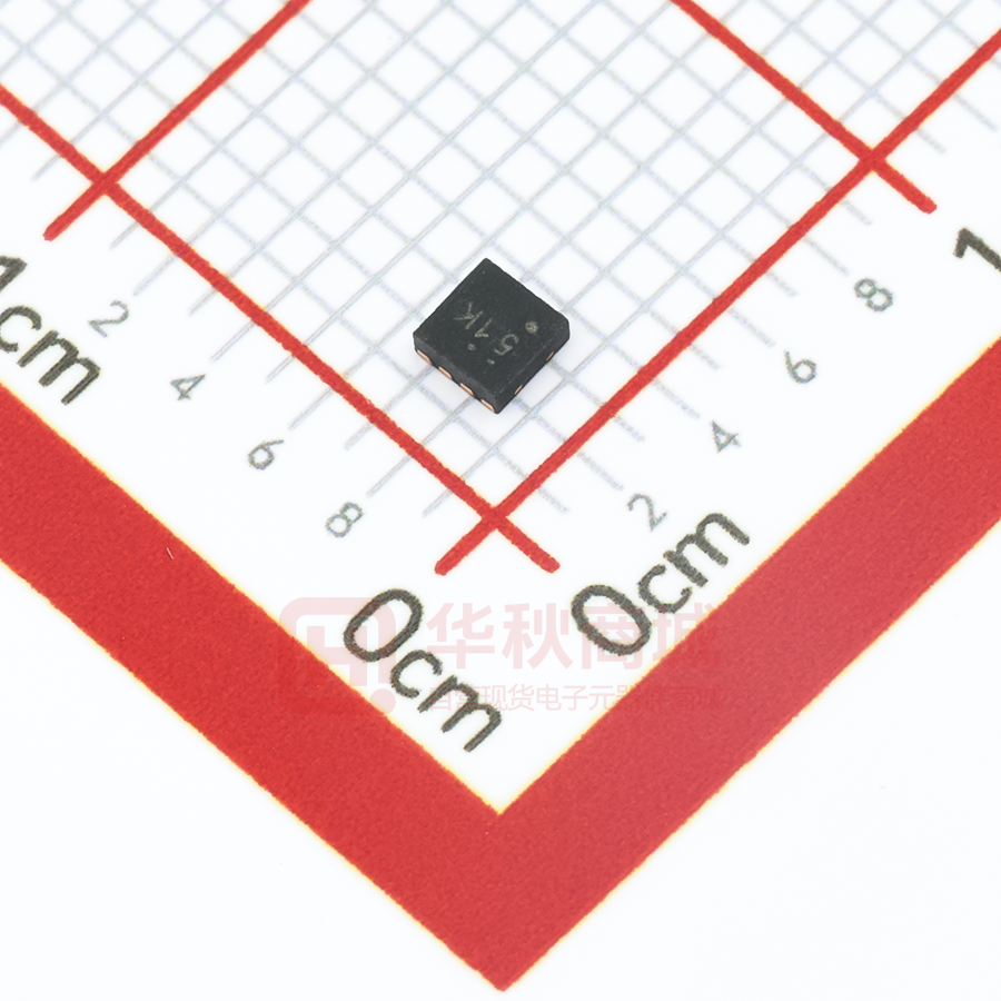

® RT5753A/B 3A, 1.2MHz, 5.5V Synchronous Step-Down Converter In WDFN-8L 2x2 General Description Features The RT5753A/B is a simple, easy-to-use, 3A synchronous step-down DC-DC converter with an input supply voltage range from 2.5V to 5.5V. The device builds in an accurate 0.6V reference voltage and integrates low RDS(ON) power MOSFETs to achieve high efficiency in WDFN-8L 2x2 and WDFN-8SL 2x2 packages.  The RT5753A/B adopts Advanced Constant On-Time (ACOT®) control architecture to provide an ultrafast transient response with few external components and to operate in nearly constant switching frequency over the line, load, and output voltage range. The RT5753A operates in automatic PSM that maintains high efficiency during light load operation. The RT5753B operates in Forced PWM that helps to meet tight voltage regulation accuracy requirements.               The RT5753A/B senses both FETs current for a robust over-current protection. The device features cycle-by-cycle current limit protection which prevents the device from the catastrophic damage in output short circuit, over current or inductor saturation. A built-in soft-start function prevents inrush current during start-up. The device also includes input under-voltage lockout, output under-voltage protection, over-voltage protection (RT5753AL/BL) and over-temperature protection to provide safe and smooth operation in all operating conditions. Input Voltage Range from 2.5V to 5.5V Ω and 70mΩ Ω FETs Integrated 100mΩ 100% Duty Cycle for Lowest Dropout Internal Reference Voltage with 1% Accuracy 1.2MHz Typical Switching Frequency Power Saving Mode for Light Loads (RT5753A) Advanced Constant On-Time (ACOT®) Control Internal Soft Startup (1.5ms) Enable Control Input Power Good Indicator Both FETs Over-Current Protection Negative Over-Current Protection (RT5753B) Input Under-Voltage Lockout Protection Output Under-Voltage Protection Over-Temperature Protection RoHS Compliant and Halogen Free Applications     Mobile Phones and Handheld Devices STB, Cable Modem, and xDSL Platforms WLAN ASIC Power / Storage (SSD and HDD) General Purpose for POL LV Buck Converters Simplified Application Circuit RT5753A/B VIN VIN RPG SW L VOUT CIN RFB1 VPG CFF COUT PG Chip Enable FB EN AGND Copyright © 2020 Richtek Technology Corporation. All rights reserved. DS5753A/B-01 November 2020 PGND RFB2 is a registered trademark of Richtek Technology Corporation. www.richtek.com 1 RT5753A/B Ordering Information Pin Configuration RT5753A/B Lead Plating System G : Green (Halogen Free and Pb Free) FB 1 PG 2 VIN 3 PGND UVP Option H : Hiccup L : Latched-Off PGND (TOP VIEW) Package Type QW : WDFN-8L 2x2 (W-Type) QWA : WDFN-8SL 2x2 (W-Type) (Exposed Pad-Option 2) 9 4 8 AGND 7 EN 6 SW 5 NC WDFN-8L 2x2/WDFN-8SL 2x2 PWM Operation Mode A : Automatic PSM B : Forced PWM Note : Richtek products are :  RoHS compliant and compatible with the current requirements of IPC/JEDEC J-STD-020.  Suitable for use in SnPb or Pb-free soldering processes. Marking Information RT5753AHGQW 54 : Product Code 54W W : Date Code RT5753AHGQWA 5K : Product Code 5KW RT5753ALGQWA RT5753ALGQW 51 : Product Code W : Date Code 51W RT5753BHGQW 4Z : Product Code 4ZW W : Date Code 5J : Product Code 5JW W : Date Code RT5753BHGQWA 5H : Product Code 5HW W : Date Code RT5753BLGQWA RT5753BLGQW 4Y : Product Code 4YW W : Date Code W : Date Code Copyright © 2020 Richtek Technology Corporation. All rights reserved. www.richtek.com 2 5G : Product Code 5GW W : Date Code is a registered trademark of Richtek Technology Corporation. DS5753A/B-01 November 2020 RT5753A/B Functional Pin Description Pin No. Pin Name Pin Function 1 FB Output voltage sense. Sense the output voltage at the FB pin through a resistive divider. The feedback reference voltage is 0.6V typically. 2 PG Open-drain power-good indicator output. Once being started-up, PG will be pulled low to ground if any internal protection is triggered. 3 VIN Power input. The input voltage range is from 2.5V to 5.5V. Connect a suitable input capacitor between this pin and PGND pins, usually one 22F or higher than 22F ceramic capacitors is recommended. PGND Power ground. The exposed pad is internally unconnected which must be soldered to a large PCB cooper area and connected to PGND for maximum power dissipation. 5 NC No internal connection. Keep this pin floating. 6 SW Switch node between the internal switch and the synchronous rectifier. Connect this pin to the inductor. 7 EN Enable control input. Connect this pin to logic high enables the device and connect this pin to ground disables the device. 8 AGND Analog ground. 4, 9 (Exposed Pad) Functional Block Diagram EN *OVP : OVP is designed for RT5753A/BL VIN UVLO Shutdown Control OTP *OVP FB Error Amplifier + + FB VREF PG Comparator + - Ramp Generator SW 90%VREF VFB FB UV TON Logic Control Current Limit Detector Driver SW VIN SW PGND SW Discharge Resistor + AGND Copyright © 2020 Richtek Technology Corporation. All rights reserved. DS5753A/B-01 November 2020 is a registered trademark of Richtek Technology Corporation. www.richtek.com 3 RT5753A/B Operation The RT5753A/B is a high-efficiency, synchronous stepdown DC-DC converter that delivers up to 3A output current from a 2.5V to 5.5V input supply. Advanced Constant On-Time Control and PWM Operation The RT5753A/B adopts ACOT® control for its ultrafast transient response, low external component counts and stable with low ESR MLCC output capacitors. When the feedback voltage falls below the feedback reference voltage, the minimum off-time one-shot (90ns, typ.) has timed out and the inductor current is below the current limit threshold, then the internal on-time one-shot circuitry is triggered and the high-side switch is turned on. Since the minimum off-time is short, the device exhibits ultrafast transient response and enables the use of smaller output capacitance. The on-time is inversely proportional to input voltage and directly proportional to output voltage to achieve pseudofixed frequency over the input voltage range. After the ontime one-shot timer is expired, the high-side switch is turned off and the low-side switch is turned on until the on-time one-shot is triggered again. In the steady state, the error amplifier compares the feedback voltage VFB and an internal reference voltage. If the virtual inductor current ramp voltage is lower than the output of the error amplifier, a new pre-determined fixed on-time will be triggered by the on-time one-shot generator. Power Saving Mode The RT5753A automatically enters power saving mode (PSM) at light load to maintain high efficiency. As the load current decreases and eventually the inductor current ripple valley touches the zero current, which is the boundary between continuous conduction and discontinuous conduction modes. The low-side switch is turned off when the zero inductor current is detected. As the load current is further decreased, it takes longer time to discharge the output capacitor to the level that requires the next on-time. The switching frequency decreases and is proportional to the load current to maintain high efficiency at light load. Copyright © 2020 Richtek Technology Corporation. All rights reserved. www.richtek.com 4 Enable Control The RT5753A/B provides an EN pin, as an external chip enable control, to enable or disable the device. If VEN is held below a logic-low threshold voltage (VEN_L) of the enable input (EN), the converter will disable output voltage, that is, the converter is disabled and switching is inhibited even if the VIN voltage is above VIN under-voltage lockout threshold (VUVLO). During shutdown mode, the supply current can be reduced to ISHDN (15μA or below). If the EN voltage rises above the logic-high threshold voltage (VEN_H) while the VIN voltage is higher than UVLO threshold, the device will be turned on, that is, switching being enabled and soft-start sequence being initiated. Soft-Start (SS) The RT5753A/B provides an internal soft-start feature for inrush control. At power up, the internal capacitor is charged by an internal current source to generate a softstart ramp voltage as a reference voltage to the PWM comparator. The device will initiate switching and the output voltage will smoothly ramp up to its targeted   regulation voltage only after this ramp voltage is greater than the feedback voltage VFB to ensure the converters have a smooth start-up from pre-biased output. The output voltage starts to rise in 220μs(Typ.) from EN rising, and the soft-start ramp-up time (0%VOUT to 95%VOUT) is 1.5ms(Typ.). VIN EN 1.5ms 220µs 95%VOUT 0%VOUT SS END VOUT SS (Internal) 2.5ms PG Figure 1. Start-Up Sequence is a registered trademark of Richtek Technology Corporation. DS5753A/B-01 November 2020 RT5753A/B Maximum Duty Cycle Operation The RT5753A/B is designed to operate in dropout at the high duty cycle approaching 100%. If the operational duty cycle is large and the required off-time becomes smaller than minimum off-time, the RT5753A/B starts to enable skip off-time function and keeps high-side MOSFET switch on continuously. The RT5753A/B implements skip off-time function to achieve high duty approaching 100%. Therefore, the maximum output voltage is near the minimum input supply voltage of the application for input voltage momentarily falls down to the normal output voltage requirement. The input voltage at which the devices enter dropout changes depending on the input voltage, output voltage, switching frequency, load current, and the efficiency of the design. Power Good Indication The RT5753A/B features an open-drain power-good output (PG) to monitor the output voltage status. The output delay of comparator prevents false flag operation for short excursions in the output voltage, such as during line and load transients. Pull-up PG with a resistor to VIN or an external voltage below 5.5V. When VIN voltage rises above VUVLO, the power-good function is activated. After softstart is finished, the PG pin is controlled by a comparator connected to the feedback signal VFB. If VFB rises above a power-good high threshold (VTH_PGLH) (typically 90% of the reference voltage), the PG pin will be in high impedance and VPG will be held high. When VFB falls short of powergood low threshold (VTH_PGHL) (typically 85% of the reference voltage), the PG pin will be pulled low. Once being started-up, if any internal protection is triggered, PG will be pulled low to GND. The internal open-drain pulldown device will pull the PG pin low. The power good indication profile is shown below. Table 1. PG Pin Status Conditions PG Pin VEN > VEN_H, VFB > VTH_PGLH High Impedance VEN > VEN_H, VFB < VTH_PGHL Low Shutdown VEN < VEN_L Low OTP TJ > TSD Low Enable   Input Under-Voltage Lockout In addition to the EN pin, the RT5753A/B also provides enable control through the VIN pin. If VEN rises above VENH first, switching will still be inhibited until the VIN voltage rises above VUVLO. It is to ensure that the internal regulator is ready so that operation with not-fully-enhanced internal MOSFET switches can be prevented. After the device is powered up, if the input voltage VIN goes below the UVLO falling threshold voltage (VUVLO − ΔVUVLO), this switching will be inhibited; if VIN rises above the UVLO rising threshold (VUVLO), the device will resume normal operation with a complete soft-start. The Over-Current Protection The RT5753A/B features cycle-by-cycle current-limit protection on both the high-side and low-side MOSFETs and the protection prevents the device from the catastrophic damage in output short circuit, over current or inductor saturation. The high-side MOSFET over-current protection is achieved by an internal current comparator that monitors the current in the high-side MOSFET during each on-time. The switch current is compared with the high-side switch peak-current limit (ILIM_H) after a certain amount of delay when the highside switch being turned on each cycle. If an over-current condition occurs, the converter will immediately turn off the high-side switch and turn on the low-side switch to prevent the inductor current from exceeding the high-side current limit. The low-side MOSFET over-current protection is achieved by measuring the inductor current through the synchronous rectifier (low-side switch) during the low-side on-time. Once the current rises above the low-side switch valley current limit (ILIM_L), the on-time one-shot will be Copyright © 2020 Richtek Technology Corporation. All rights reserved. DS5753A/B-01 November 2020 is a registered trademark of Richtek Technology Corporation. www.richtek.com 5 RT5753A/B inhibited until the inductor current ramps down to the current limit level (ILIM_L), that is, another on-time can only be triggered when the inductor current goes below the low-side current limit. If the output load current exceeds the available inductor current (clamped by the low-side current limit), the output capacitor needs to supply the extra current such that the output voltage will begin to drop. If it drops below the output under-voltage protection threshold, the IC will stop switching to avoid excessive heat. VOUT (500mV/Div) tHICCUP_OFF (5ms, typ.), and then attempt to recover automatically for tHICCUP_ON (1ms, typ.). Upon completion of the soft-start sequence, if the fault condition is removed, the converter will resume normal operation; otherwise, such cycle for auto-recovery will be repeated until the fault condition is cleared. Hiccup mode allows the circuit to operate safely with low input current and power dissipation, and then resume normal operation as soon as the overload or short-circuit condition is removed. A short-circuit protection and recovery profile is shown below. VOUT (500mV/Div) VSW (5V/Div) Short Applied Short Removed VSW (5V/Div) VPG (5V/Div) VPG (5V/Div) I SW (2A/Div) I SW (2A/Div) Time (50μs/Div) Time (5ms/Div) Figure 2. Over-Current Protection Figure 3. Short-Circuit Protection and Recovery Output Active Discharge When the RT5753A/B is disabled by EN pin, UVLO or OTP, the device discharges the output capacitors (via SW pins) through an internal discharge resistor (100Ω) connected to ground. This function prevents the reverse current flow from the output capacitors to the input capacitors once the input voltage collapses. It doesn't need to rely on another active discharge circuit for discharging output capacitors. This function will be turned off when the fault condition is removed. Output Under-Voltage Protection The RT5753A/B includes output under-voltage protection (UVP) against over-load or short-circuited condition by constantly monitoring the feedback voltage VFB. If VFB drops below the under-voltage protection threshold (typically 40% of the internal feedback reference voltage), the UV comparator will go high to turn off both the internal high-side and low-side MOSFET switches. The RT5753A/ B will enter output under-voltage protection with hiccup mode. During hiccup mode, the IC will shut down for Copyright © 2020 Richtek Technology Corporation. All rights reserved. www.richtek.com 6 Output Over-Voltage Protection The RT5753A/BL includes an output over-voltage protection (OVP) circuit to limit output voltage and minimize output voltage overshoot. If the VFB goes above the 120% of the reference voltage, the high-side MOSFET will be forced off to limit the output voltage then the IC will be into Latchoff mode. Thermal Shutdown The RT5753A/B includes an over-temperature protection (OTP) circuitry to prevent overheating due to excessive power dissipation. The OTP will shut down switching operation when junction temperature exceeds a thermal shutdown threshold (TSD). Once the junction temperature cools down by a thermal shutdown hysteresis (ΔTSD), the IC will resume normal operation with a complete soft-start. Note that the over-temperature protection is intended to protect the device during momentary overload conditions. The protection is activated outside of the absolute is a registered trademark of Richtek Technology Corporation. DS5753A/B-01 November 2020 RT5753A/B maximum range of operation as a secondary fail-safe and therefore should not be relied upon operationally. Continuous operation above the specified absolute maximum operating junction temperature may impair device reliability or permanently damage the device. Negative Over-Current Limit (RT5753B) The RT5753B is the part which is forced to PWM and allows negative current operation. In case of PWM operation, high negative current may be generated as an external power source which is tied to output terminal unexpectedly. As the risk described above, the internal circuit monitors negative current in each on-time interval of low-side MOSFET and compares it with NOC threshold. Once the negative current exceeds the NOC threshold, the low-side MOSFET is turned off immediately, and then the high-side MOSFET will be turned on to discharge the energy of output inductor. This behavior can keep the valley of negative current at NOC threshold to protect low-side MOSFET. However, the negative current can't be limited at NOC threshold anymore since minimum off-time is reached. Copyright © 2020 Richtek Technology Corporation. All rights reserved. DS5753A/B-01 November 2020 is a registered trademark of Richtek Technology Corporation. www.richtek.com 7 RT5753A/B Absolute Maximum Ratings         Supply Input Voltage ----------------------------------------------------------------------------------------------VIN to SW -----------------------------------------------------------------------------------------------------------VIN to SW (t ≤ 10ns) ---------------------------------------------------------------------------------------------Switch Voltage, SW ----------------------------------------------------------------------------------------------SW (t ≤ 10ns) ------------------------------------------------------------------------------------------------------Other Pins -----------------------------------------------------------------------------------------------------------Lead Temperature (Soldering, 10 sec.) -----------------------------------------------------------------------Junction Temperature ---------------------------------------------------------------------------------------------Storage Temperature Range ------------------------------------------------------------------------------------- ESD Ratings  (Note 1) (Note 2) ESD Susceptibility HBM (Human Body Model) --------------------------------------------------------------------------------------- 2kV Recommended Operating Conditions    −0.3V to 6.5V −0.3V to 6.5V −2.5V to 9V −0.3V to 6.5V −2.5V to 9V −0.3V to 6.5V 260°C 150°C −65°C to 150°C (Note 3) Supply Input Voltage ------------------------------------------------------------------------------------------------------ 2.5V to 5.5V Output Voltage ------------------------------------------------------------------------------------------------------------- 0.6V to VIN Junction Temperature Range -------------------------------------------------------------------------------------------- −40°C to 125°C Thermal Information (Note 4 and Note 5) Thermal Parameter WDFN-8L 2x2 WDFN-8SL 2x2 Unit JA Junction-to-ambient thermal resistance (JEDEC standard) 49.5 48.2 C/W JC(Top) Junction-to-case (top) thermal resistance 167.1 158.5 C/W JC(Bottom) Junction-to-case (bottom) thermal resistance 5.8 5.5 C/W JA(EVB) Junction-to-ambient thermal resistance (specific EVB) 49.7 49.7 C/W JC(Top) Junction-to-top characterization parameter 5.01 5.01 C/W JB Junction-to-board characterization parameter 30.5 30.5 C/W   Copyright © 2020 Richtek Technology Corporation. All rights reserved. www.richtek.com 8 is a registered trademark of Richtek Technology Corporation. DS5753A/B-01 November 2020 RT5753A/B Electrical Characteristics (VIN = 3.6V. TJ = TA = −40°C to 125°C. Typical value is tested at TA = 25°C. The limit over temperature is guaranteed by characterization, unless otherwise noted.) Parameter Symbol Test Conditions Min Typ Max Unit 2.5 -- 5.5 V 2.15 2.3 2.45 V -- 300 -- mV Supply Voltage VIN Supply Input Operating Voltage VIN Under-Voltage Lockout Threshold VUVLO VIN rising Under-Voltage Lockout Threshold VUVLO Hysteresis Supply Current (Shutdown) ISHDN VEN = 0V -- -- 15 Supply Current (Quiescent) IQ VEN = 2V, VFB = 0.7V, not switching -- 23 35 tSS 0%VOUT to 95%VOUT 1 1.5 2.4 VEN_H EN high-level input voltage 0.88 -- 1.2 VEN_L EN low-level input voltage 0.4 -- 0.85 -- 1.5 -- A 0.594 0.6 0.606 V -- 0.1 0.4 µA A Soft-Start Soft-Start Time ms Enable Voltage Enable Voltage Threshold Enable Pull-Low Current IEN_PL V Feedback Voltage Feedback Threshold Voltage VFB Feedback Input Current IFB VFB = 0.6V, TA = 25°C Internal MOSFET High-Side On-Resistance RDS(ON)_H -- 100 120 Low-Side On-Resistance RDS(ON)_L -- 70 85 3.6 4.14 4.8 3 3.45 3.9 f SW 1 1.2 1.44 MHz tOFF_MIN -- 90 -- ns VUVP -- 40 -- % 110 120 130 % m Current Limit High-Side Switch Current Limit ILIM_H Low-Side Switch Valley Current Limit ILIM_L VIN = 3.6V, VOUT = 1.2V, L = 1H, TA = 25C A Switching Frequency Switching Frequency On-Time Timer Control Minimum Off-Time Output Voltage Protection Output Under-Voltage Threshold (RT5753A/BH : Hiccup) (RT5753A/BL : Latch-Off) Output Over-Voltage Threshold (RT5753A/BL: Latch-Off, Deglitch VOVP Time = 2s) Copyright © 2020 Richtek Technology Corporation. All rights reserved. DS5753A/B-01 November 2020 VFB rising is a registered trademark of Richtek Technology Corporation. www.richtek.com 9 RT5753A/B Parameter Symbol Test Conditions Min Typ Max Unit Thermal Shutdown Thermal Shutdown Threshold TSD -- 150 -- Thermal Shutdown Hysteresis TSD -- 20 -- C Power Good Power Good High Threshold VTH_PGLH VFB rising, PG goes high 83 90 -- % Power Good Falling Threshold VTH_PGHL VFB falling, PG goes low 78 85 -- % IPG sinks 5mA -- -- 0.4 V VEN = 0V (Protection) -- 100 --  Power Good Sink Current Capability Output Discharge Resistor Output Discharge Switch On-Resistor RDISCHG Note 1. Stresses beyond those listed under “Absolute Maximum Ratings” may cause permanent damage to the device. These are stress ratings only, and functional operation of the device at these or any other conditions beyond those indicated in the operational sections of the specifications is not implied. Exposure to absolute maximum rating conditions may affect device reliability. Note 2. Devices are ESD sensitive. Handling precaution is recommended. Note 3. The device is not guaranteed to function outside its operating conditions. Note 4. For more information about thermal parameter, see the Application and Definition of Thermal Resistances report, AN061. Note 5. θJA(EVB), ψJC(Top) and ψJB are measured on a high effective-thermal-conductivity four-layer test board which is in size of 70mm x 50mm; furthermore, all layers with 1 oz. Cu. Thermal resistance/parameter values may vary depending on the PCB material, layout, and test environmental conditions. Copyright © 2020 Richtek Technology Corporation. All rights reserved. www.richtek.com 10 is a registered trademark of Richtek Technology Corporation. DS5753A/B-01 November 2020 RT5753A/B Typical Application Circuit RT5753A/B 3 VIN RPG 100k VIN SW 6 L VOUT CIN2 0.1µF CIN1 2 VPG RFB1 COUT PG Chip Enable 7 CFF* FB 1 EN AGND 8 RFB2 PGND 4, 9 (Exposed pad) CFF*: Optional for performance fine-tune Table 2. Suggested Component Values VOUT (V) RFB1 (k) RFB2 (k) CIN1 (F) L (H) COUT (F) CFF (pF) 3.3 100 22.1 22 1  44 to 66  -- 1.8 100 50 22  1  44 to 66  ‐‐  1.5 100 66.6 22  1  44 to 66  ‐‐  1.2 100 100 22  1  44 to 66  22  1.05 100 133 22  1  44 to 66  22  1 100 148 22  1  44 to 66  22    Table 3. Recommended External Components   Component Description Vendor P/N CIN 22F, 6.3V, X5R, 0603 GRM188R60J226MEA0D (MURATA) COUT 22F, 6.3V, X5R, 0603 GRM188R60J226MEA0D (MURATA) 1H DFE322512F-1R0M (MURATA) L COUT and CIN : Considering the effective capacitance de-rated with biased voltage level and size, the COUT and CIN components need to satisfy the effective capacitance which corresponding to recommended external components. Copyright © 2020 Richtek Technology Corporation. All rights reserved. DS5753A/B-01 November 2020 is a registered trademark of Richtek Technology Corporation. www.richtek.com 11 RT5753A/B Typical Operating Characteristics Efficiency vs. Output Current Efficiency vs. Output Current 100 100 90 90 VIN VIN VIN VIN VIN 70 60 50 40 = = = = = 2.5V 3.3V 3.6V 4.5V 5V Efficiency (%) Efficiency (%) 80 30 20 70 = = = = = 2.5V 3.3V 3.6V 4.5V 5V 60 50 10 0 0.001 VIN VIN VIN VIN VIN 80 RT5753B, VOUT = 1.2V 0.01 0.1 1 RT5753A, VOUT = 1.2V 40 0.001 10 0.01 Output Current (A) 0.1 1 10 Output Current (A) Efficiency vs. Output Current Efficiency vs. Output Current 100 100 90 VIN VIN VIN VIN 70 60 = = = = 90 3.3V 3.6V 4.5V 5V Efficiency (%) Efficiency (%) 80 50 40 30 20 80 = = = = 3.3V 3.6V 4.5V 5V 70 60 50 10 0 0.001 VIN VIN VIN VIN RT5753A, VOUT = 1.8V RT5753B, VOUT = 1.8V 0.01 0.1 1 40 0.001 10 0.01 Output Current (A) 0.1 1 10 Output Current (A) Efficiency vs. Output Current Efficiency vs. Output Current 100 100 90 VIN = 4.5V VIN = 5V 70 60 50 40 30 20 70 60 RT5753A, VOUT = 3.3V RT5753B, VOUT = 3.3V 0.01 0.1 1 Output Current (A) Copyright © 2020 Richtek Technology Corporation. All rights reserved. www.richtek.com 12 80 50 10 0 0.001 VIN = 4.5V VIN = 5V 90 Efficiency (%) Efficiency (%) 80 10 40 0.001 0.01 0.1 1 10 Output Current (A) is a registered trademark of Richtek Technology Corporation. DS5753A/B-01 November 2020 RT5753A/B Output Voltage vs. Output Current 1.220 1.215 1.215 1.210 1.210 Output Voltage (V) Output Voltage (V) Output Voltage vs. Output Current 1.220 1.205 1.200 1.195 1.190 1.185 1.205 1.200 1.195 1.190 1.185 RT5753B, VIN = 5V, VOUT = 1.2V 1.180 0.001 0.01 0.1 1 RT5753A, VIN = 5V, VOUT = 1.2V 1.180 0.001 10 0.01 Output Current (A) 0.1 1 10 Output Current (A) Output Voltage vs. Input Voltage Current Limit vs. Temperature 4.0 1.220 3.8 1.210 Current Limit (A) Output Voltage(V) 1.215 1.205 1.200 1.195 1.190 3.6 3.4 3.2 1.185 Low-side MOSFET, VIN = 3.6V VOUT = 1.2V, IOUT = 1.5A 3.0 1.180 2.5 3 3.5 4 4.5 5 -50 5.5 -25 0 Input Voltage (V) Current Limit vs. Temperature 50 75 100 125 Switching Frequency vs. Temperature 1.30 4.8 4.6 4.4 4.2 High-side MOSFET, VIN = 3.6V 4.0 Switching Frequency (MHz)1 5.0 Current Limit (A) 25 Temperature (°C) 1.25 1.20 1.15 1.10 1.05 1.00 -50 -25 0 25 50 75 100 Temperature (°C) Copyright © 2020 Richtek Technology Corporation. All rights reserved. DS5753A/B-01 November 2020 125 -50 -25 0 25 50 75 100 125 Temperature (°C) is a registered trademark of Richtek Technology Corporation. www.richtek.com 13 RT5753A/B Shutdown Current vs. Temperature 5.0 45 4.5 40 4.0 Shutdown Current (μA)1 Quiescent Current (μA) Quiescent Current vs. Temperature 50 35 30 25 20 15 10 5 VIN = 3.6V 3.5 3.0 2.5 2.0 1.5 1.0 0.5 VIN = 3.6V 0.0 0 -50 -25 0 25 50 75 100 -50 125 -25 0 25 Input UVLO Threshold vs. Temperature 100 125 Enable Voltage Threshold vs. Temperature 2.5 1.2 2.4 Enable Voltage Threshold(V) Input UVLO Threshold(V) 75 Temperature (°C) Temperature (°C) Rising 2.3 2.2 2.1 Falling 2.0 1.9 1.8 1.1 1.0 Rising 0.9 0.8 Falling 0.7 0.6 0.5 0.4 0.3 -50 -25 0 25 50 75 100 125 -50 -25 0 25 50 75 100 Temperature (°C) Temperature (°C) Reference Voltage vs. Temperature Load Transient Response 0.62 125 VIN = 5V, VOUT = 3.3V, L = 1μH, COUT = 44μF, IOUT = 100mA to 1A, TR = TF = 1μs 0.61 Reference Voltage (V) 50 0.60 VOUT (50mV/Div) 0.59 0.58 0.57 0.56 VIN = 3.6V, IOUT = 0A IOUT (500mA/Div) 0.55 -50 -25 0 25 50 75 100 125 Time (20μs/Div) Temperature (°C) Copyright © 2020 Richtek Technology Corporation. All rights reserved. www.richtek.com 14 is a registered trademark of Richtek Technology Corporation. DS5753A/B-01 November 2020 RT5753A/B Load Transient Response Load Transient Response VIN = 3.6V, VOUT = 1.2V, L = 1μH, COUT = 44μF, CFF = 22pF, IOUT = 100mA to 1A, TR = TF = 1μs VIN = 5V, VOUT = 3.3V, L = 1μH, COUT = 44μF, IOUT = 2A to 3A, TR = TF = 1μs VOUT (50mV/Div) VOUT (100mV/Div) IOUT (1A/Div) IOUT (500mA/Div) Time (20μs/Div) Time (20μs/Div) Load Transient Response Output Ripple Voltage VIN = 3.6V, VOUT = 1.2V, L = 1μH, COUT = 44μF, CFF = 22pF, IOUT = 2A to 3A, TR = TF = 1μs VOUT (50mV/Div) VOUT (20mV/Div) IOUT (1A/Div) VSW (4V/Div) VIN = 5V, VOUT = 3.3V, IOUT = 10mA, L = 1μH, COUT = 44μF, CFF = 22pF Time (20μs/Div) Time (50μs/Div) Output Ripple Voltage Output Ripple Voltage VIN = 5V, VOUT = 3.3V, IOUT = 1.5A, L = 1μH, COUT = 44μF, CFF = 22pF VIN = 3.6V, VOUT = 1.2V, IOUT = 10mA, L = 1μH, COUT = 44μF, CFF = 22pF VOUT (20mV/Div) VOUT (20mV/Div) VSW (4V/Div) VSW (4V/Div) Time (500ns/Div) Copyright © 2020 Richtek Technology Corporation. All rights reserved. DS5753A/B-01 November 2020 Time (50μs/Div) is a registered trademark of Richtek Technology Corporation. www.richtek.com 15 RT5753A/B Output Ripple Voltage VIN = 3.6V, VOUT = 1.2V, IOUT = 1.5A, L = 1μH, COUT = 44μF, CFF = 22pF VOUT (10mV/Div) VPG (4V/Div) VEN (1V/Div) VPG (4V/Div) VOUT (1V/Div) VSW (4V/Div) VEN (1V/Div) Power On from EN IOUT (1A/Div) Time (500ns/Div) Time (1ms/Div) Power Off from EN Power On from VIN VIN = 5V, VOUT = 3.3V, IOUT = 3A, VPG reference source pull high to 5V VIN (2V/Div) VSW (4V/Div) VOUT (1V/Div) IOUT (1A/Div) VOUT (2V/Div) IOUT (2A/Div) VIN (2V/Div) VIN = 5V, VOUT = 3.3V, IOUT = 3A, VPG reference source pull high to 5V VIN = 5V, VOUT = 3.3V, IOUT = 3A Time (50μs/Div) Time (2ms/Div) Power Off from VIN Power On from EN VEN (1V/Div) VSW (4V/Div) VPG (2V/Div) VOUT (2V/Div) VOUT (500mV/Div) IOUT (2A/Div) VIN = 5V, VOUT = 3.3V, IOUT = 3A Time (5ms/Div) Copyright © 2020 Richtek Technology Corporation. All rights reserved. www.richtek.com 16 IOUT (1A/Div) VIN = 3.6V, VOUT = 1.2V, IOUT = 3A VPG reference source pull high to 3.6V Time (1ms/Div) is a registered trademark of Richtek Technology Corporation. DS5753A/B-01 November 2020 RT5753A/B Power On from VIN Power Off from EN VEN (1V/Div) VPG (2V/Div) VOUT (500mV/Div) VIN = 3.6V, VOUT = 1.2V, IOUT = 3A VPG reference source pull high to 3.6V VIN (2V/Div) VSW (4V/Div) VOUT (1V/Div) IOUT (1A/Div) IOUT (2A/Div) Time (20μs/Div) VIN = 3.6V, VOUT = 1.2V, IOUT = 3A Time (5ms/Div) Power Off from VIN VIN (2V/Div) VSW (4V/Div) VOUT (1V/Div) IOUT (2A/Div) VIN = 3.6V, VOUT = 1.2V, IOUT = 3A Time (5ms/Div) Copyright © 2020 Richtek Technology Corporation. All rights reserved. DS5753A/B-01 November 2020 is a registered trademark of Richtek Technology Corporation. www.richtek.com 17 RT5753A/B Application Information The output stage of a synchronous buck converter is composed of an inductor and capacitor, which stores and delivers energy to the load, and forms a second-order lowpass filter to smooth out the switch node voltage to maintain a regulated output voltage. current limit of the device rather than the inductor peak current. For EMI sensitive application, choosing shielding type inductor is preferred. Input Capacitor Selection Inductor Selection The inductor selection trade-offs among size, cost, efficiency, and transient response requirements. Generally, three key inductor parameters are specified for operation with the device: inductance value (L), inductor saturation current (ISAT), and DC resistance (DCR). A good compromise between size and loss is to choose the peak-to-peak ripple current equals to 20% to 50% of the IC rated current. The switching frequency, input voltage, output voltage, and selected inductor ripple current determines the inductor value as follows : V  (VIN  VOUT ) L = OUT VIN  fSW  IL Once an inductor value is chosen, the ripple current (ΔIL) is calculated to determine the required peak inductor current. V  (VIN  VOUT ) IL = OUT VIN  fSW  L IL_PEAK = IOUT_MAX + 1 IL 2 IL(PEAK) should not exceed the minimum value of IC's upper current limit level. Besides, the current flowing through the inductor is the inductor ripple current plus the output current. During power up, faults or transient load conditions, the inductor current can increase above the calculated peak inductor current level calculated above. In transient conditions, the inductor current can increase up to the switch current limit of the device. For this reason, the most conservative approach is to specify an inductor with a saturation current rating equal to or greater than the switch current limit rather than the peak inductor current. Input capacitance, CIN, is needed to filter the pulsating current at the drain of the high-side power MOSFET. CIN should be sized to do this without causing a large variation in input voltage. The waveform of CIN ripple voltage and ripple current are shown in Figure 4. The peak-to-peak voltage ripple on input capacitor can be estimated as equation below : + IOUT  ESR VCIN = D  IOUT  1  D CIN  fSW where V D = OUT VIN  For ceramic capacitors, the equivalent series resistance (ESR) is very low, the ripple which is caused by ESR can be ignored, and the minimum input capacitance can be estimated as equation below : D 1  D  CIN_MIN = IOUT_MAX  VCIN_MAX  fSW where ΔVCIN_MAX is maximum input ripple voltage. VCIN CIN Ripple Voltage VESR = IOUT x ESR (1-D) x IOUT CIN Ripple Current D x IOUT D x tSW (1-D) x tSW Figure 4. CIN Ripple Voltage and Ripple Current For the selected inductor, the inductor’s saturation and thermal rating should meet or greater than the ripple current (ΔIL). For more conservative, the rating for inductor saturation current must be equal to or greater than switch Copyright © 2020 Richtek Technology Corporation. All rights reserved. www.richtek.com 18 is a registered trademark of Richtek Technology Corporation. DS5753A/B-01 November 2020 RT5753A/B In addition, the input capacitor needs to have a very low ESR and must be rated to handle the worst-case RMS input current of : V VIN IRMS  IOUT _MAX  OUT  1 VIN VOUT It is common to use the worse IRMS ≅ IOUT/2 at VIN = 2VOUT for design. Note that ripple current ratings from capacitor manufacturers are often based on only 2000 hours of life which makes it advisable to further de-rate the capacitor, or choose a capacitor rated at a higher temperature than required. Several capacitors may also be paralleled to meet size, height and thermal requirements in the design. For low input voltage applications, sufficient bulk input capacitance is needed to minimize transient effects during output load changes. Ceramic capacitors are ideal for switching regulator applications because of its small size, robustness and very low ESR. However, care must be taken when these capacitors are used at the input. A ceramic input capacitor combined with trace or cable inductance forms a high quality (under damped) tank circuit. If the RT5753A/B circuit is plugged into a live supply, the input voltage can ring to twice its nominal value, possibly exceeding the device's rating. This situation is easily avoided by placing the low ESR ceramic input capacitor in parallel with a bulk capacitor with higher ESR to damp the voltage ringing. The input capacitor should be placed as close as possible to the VIN pins, with a low inductance connection to the GND of the IC. In addition to a larger bulk capacitor, a small ceramic capacitors of 0.1μF should be placed close to the VIN and GND pin. This capacitor should be 0402 or 0603 in size. Output Capacitor Selection The RT5753A/B are optimized for ceramic output capacitors and best performance will be obtained by using them. The total output capacitance value is usually determined by the desired output voltage ripple level and transient response requirements for sag (undershoot on load apply) and soar (overshoot on load release). Copyright © 2020 Richtek Technology Corporation. All rights reserved. DS5753A/B-01 November 2020 Output Ripple The output voltage ripple at the switching frequency is a function of the inductor current ripple going through the output capacitor's impedance. To derive the output voltage ripple, the output capacitor with capacitance, COUT, and its equivalent series resistance, RESR, must be taken into consideration. The output peak-to-peak ripple voltage VRIPPLE, caused by the inductor current ripple ΔIL, is characterized by two components, which are ESR ripple VRIPPLE(ESR) and capacitive ripple VRIPPLE(C), and can be expressed as below : VRIPPLE = VRIPPLE(ESR)  VRIPPLE(C) VRIPPLE(ESR) = IL  RESR VRIPPLE(C) = IL 8  COUT  fSW If ceramic capacitors are used as the output capacitors, both the components need to be considered due to the extremely low ESR and relatively small capacitance. Output Transient Undershoot and Overshoot In addition to voltage ripple at the switching frequency, the output capacitor and its ESR also affect the voltage sag (undershoot) and soar (overshoot) when the load steps up and down abruptly. The ACOT® transient response is very quick and output transients are usually small. The following section shows how to calculate the worst-case voltage swings in response to very fast load steps. The output voltage transient undershoot and overshoot each have two components : the voltage steps caused by the output capacitor's ESR, and the voltage sag and soar due to the finite output capacitance and the inductor current slew rate. Use the following formula to check if the ESR is low enough (typically not a problem with ceramic capacitors) and the output capacitance is large enough to prevent excessive sag and soar on very fast load step edges, with the chosen inductor value. The amplitude of the ESR step up or down is a function of the load step and the ESR of the output capacitor : VESR _STEP = ΔIOUT x RESR The amplitude of the capacitive sag is a function of the load step, the output capacitor value, the inductor value, the input-to-output voltage differential, and the maximum duty cycle. The maximum duty cycle during a fast transient is a registered trademark of Richtek Technology Corporation. www.richtek.com 19 RT5753A/B is a function of the on-time and the minimum off-time since the ACOT® control scheme will ramp the current using on-times spaced apart with minimum off-times, which is as fast as allowed. Calculate the approximate on-time (neglecting parasites) and maximum duty cycle for a given input and output voltage as : VOUT tON t ON = and DMAX = VIN  fSW tON  tOFF_MIN The actual on-time will be slightly longer as the IC compensates for voltage drops in the circuit, but we can neglect both of these since the on-time increase compensates for the voltage losses. Calculate the output voltage sag as : VSAG = L  (IOUT )2 2  COUT   VIN(MIN)  DMAX  VOUT  The amplitude of the capacitive soar is a function of the load step, the output capacitor value, the inductor value and the output voltage : VSOAR = L  (IOUT )2 2  COUT  VOUT EN Pin for Start-Up and Shutdown Operation For automatic start-up, the EN pin can be connected to the input supply VIN directly. The large built-in hysteresis band makes the EN pin useful for simple delay and timing circuits. The EN pin can be externally connected to VIN by adding a resistor REN and a capacitor CEN, as shown in Figure 6, to have an additional delay. The time delay can be calculated with the EN's internal threshold, at which switching operation begins. An external MOSFET can be added for the EN pin to be logic-controlled, as shown in Figure 7. In this case, a pullup resistor, REN, is connected between VIN and the EN pin. The MOSFET Q1 will be under logic control to pull down the EN pin. To prevent the device being enabled when VIN is smaller than the VOUT target level or some other desired voltage level, a resistive divider (REN1 and REN2) can be used to externally set the input under-voltage lockout threshold, as shown in Figure 8. VIN Because some modern digital loads can exhibit nearly instantaneous load changes, the amplitude of the ESR step up or down should be taken into consideration. REN EN RT5753A/B CEN GND Output Voltage Setting Set the desired output voltage using a resistive divider from the output to ground with the midpoint connected to FB, as shown in Figure 5. The output voltage is set according to the following equation : Figure 6. Enable Timing Control VIN REN GND VOUT RFB1 RT5753A/B Q1 Enable VOUT = 0.6V x (1 + RFB1 / RFB2) EN Figure 7. Logic Control for the EN Pin FB RT5753A/B RFB2 GND VIN REN1 EN REN2 Figure 5. Output Voltage Setting Place the FB resistors within 5mm of the FB pin. For output voltage accuracy, use divider resistors with 1% or better tolerance. Copyright © 2020 Richtek Technology Corporation. All rights reserved. www.richtek.com 20 RT5753A/B GND Figure 8. Resistive Divider for Under-Voltage Lockout Threshold Setting is a registered trademark of Richtek Technology Corporation. DS5753A/B-01 November 2020 RT5753A/B Power-Good Output The PG pin is an open-drain power-good indication output and is to be connected to an external voltage source through a pull-up resistor. The external voltage source can be an external voltage supply below 5.5V, VCC or the output of the RT5753A/B if the output voltage is regulated under 5.5V. It is recommended to connect a 100kΩ between external voltage source to PG pin. the excitation frequency is sufficient. It is important that the converter operates in PWM mode, outside the light load efficiency range, and below any current limit threshold. A load transient from 30% to 60% of maximum load is reasonable which is shown in Figure 10. fCO Feedforward Capacitor (CFF) The RT5753A/B is optimized for low duty-cycle applications, and the control loop is stable with low ESR ceramic output capacitors. This optimization makes circuit easily to achieve stability with reasonable output capacitors, but it also narrows the optimization of transient responses of the converter. In higher duty-cycle applications (higher output voltages or lower input voltage), the internal ripple signal will increase in amplitude. Before the ACOT® control loop can react to an output voltage fluctuation, the voltage change on the feedback signal must exceed the internal ripple amplitude. Because of the large internal ripple in this condition, the response may become too slow and may show an under-damped response. This can cause some ringing in the output and is especially visible at higher output voltage applications where dutycycle is high. The feedback network attenuation is large, adding to the delay. As shown in Figure 9, adding a feedforward capacitor (CFF) across the upper feedback resistor is recommended. This increases the damping of the control system. 60% Load 30% Load Figure 10. Example of Measuring the Converter fCO by Fast Load Transient CFF can be calculated base on below equation : CFF = 1 1  1 + 1   2  fco RFB1  RFB1 RFB2  Note that, after defining the CFF, please also check the load regulation because the feedforward capacitor might inject an offset voltage into VOUT to cause VOUT inaccuracy. If the output voltage is over specification caused by calculated CFF, please decrease the value of feedforward capacitor CFF. Figure 11. shows the transient performance with and without feedforward capacitor. L SW RT5753A/B VOUT RFB1 CFF COUT FB GND RFB2 Figure 9. Feedback Loop with Feedforward Capacitor Loop stability can be checked by viewing the load transient response. A load step with a speed that exceeds the converter bandwidth must be applied. For ACOT®, loop bandwidth can be in the order of 100 to 200kHz, so a load step with 500ns maximum rise time (di/dt  2A/μs) ensures Copyright © 2020 Richtek Technology Corporation. All rights reserved. DS5753A/B-01 November 2020 Figure 11. Load Transient Response with and without Feedforward Capactior is a registered trademark of Richtek Technology Corporation. www.richtek.com 21 RT5753A/B Thermal Considerations In many applications, the RT5753A/B does not generate much heat due to its high efficiency and low thermal resistance of its WDFN-8L 2x2 and WDFN-8SL 2x2 packages. However, in applications which the RT5753A/ B runs at a high ambient temperature and high input voltage or high switching frequency, the generated heat may exceed the maximum junction temperature of the part. The junction temperature should never exceed the absolute maximum junction temperature of the part. The junction temperature should never exceed the absolute maximum junction temperature TJ(MAX), listed under Absolute Maximum Ratings, to avoid permanent damage to the device. If the junction temperature reaches approximately 150°C, the RT5753A/B stops switching the power MOSFETs until the temperature cools down by 20°C. loss, 16.5mW, can be obtained from its website in this case. In this case, the power dissipation of the RT5753A/B is   1 η  POUT  IO 2  DCR + PCORE = 1.03W η Considering the θJA(EFFECTIVE) is 59.64°C/W by using the RT5753A/B evaluation board with 4 layers PCB, all layers with 1 oz. Cu, the junction temperature of the regulator operating in a 25°C ambient temperature is approximately : PD, RT = TJ = 1.03W x 59.64°C/W + 25°C = 86.4°C Layout Considerations Follow the PCB layout guidelines for optimal performance of the device.  Keep the high-current paths short, especially at the ground terminals. This practice is essential for stable, jitter-free operation. The high current path comprising of input capacitor, high-side FET, inductor, and the output capacitor should be as short as possible. This practice is essential for high efficiency. where TJ(MAX) is the maximum junction temperature of the die. For recommended operating condition specifications, the maximum junction temperature is 150°C. TA is the ambient temperature, and θJA(EFFECTIVE) is the systemlevel junction to ambient thermal resistance. It can be estimated from thermal modeling or measurements in the system.  Place the input MLCC capacitors as close to the VIN and PGND pins as possible. The major MLCC capacitors should be placed on the same layer as the RT5753A/B.  SW node is with high frequency voltage swing and should be kept at small area. Keep analog components away from the SW node to prevent stray capacitive noise pickup. The thermal resistance of the device strongly depends on the surrounding PCB layout and can be improved by providing a heat sink of surrounding copper ground. The addition of backside copper with thermal vias, stiffeners, and other enhancements can also help reduce thermal resistance.  Connect feedback network behind the output capacitors. Place the feedback components next to the FB pin.  For better thermal performance, design a wide and thick plane for PGND pin or add a lot of vias to GND plane.  AGND and PGND are connected with a via and at only one point to reduce circulating currents. The maximum power dissipation can be calculated by the following formula : PD(MAX) = (TJ(MAX) − TA) / θJA(EFFECTIVE) Experiments in the Richtek thermal lab show that simply set θJA(EFFECTIVE) as 110% to 120% of the θJA is reasonable to obtain the allowed PD(MAX). An example of PCB layout guide is shown from Figure 12. As an example, consider the case when the RT5753A/B is used in applications where VIN = 5V, IOUT = 3A, fSW = 1.2MHz, VOUT = 1.2V. The efficiency at 1.2V, 3A is 74.2% by using WE-74437324010 (1μH, 22mΩ DCR) as the inductor and measured at room temperature. The core Copyright © 2020 Richtek Technology Corporation. All rights reserved. www.richtek.com 22 is a registered trademark of Richtek Technology Corporation. DS5753A/B-01 November 2020 RT5753A/B GND VOUT COUT1 COUT1 Connect output feedback network behind the top layer. COUT2 GND Shielding inductor by GND. SW should be connected to inductor by wide and short trace. Please keep analog components away from the SW node to prevent stray capacitive noise pickup. Add extra vias for thermal Dissipation. Place the input MLCC capacitors as close to the VIN and GND pins as possible. EN AGND GND PGNG ` VIN CIN1 PGND VIN PG FB RFB2 RPG VOUT RFB1 CFF REN EN NC SW CIN2 L EN The VIN trace should have enough width, and use several vias to shunt the high input current. Place the feedback components next to the FB pin. Connect EN network behind In order to avoid the the ground noise interruption at bad the top layer. ground plane, it’s recommended to connect AGND to GND plane at only one point to reduce circulating currents. Figure 12. Layout Guide Copyright © 2020 Richtek Technology Corporation. All rights reserved. DS5753A/B-01 November 2020 is a registered trademark of Richtek Technology Corporation. www.richtek.com 23 RT5753A/B Outline Dimension D2 D L E E2 1 e SEE DETAIL A b 2 1 2 1 A A1 A3 DETAIL A Pin #1 ID and Tie Bar Mark Options Note : The configuration of the Pin #1 identifier is optional, but must be located within the zone indicated. Symbol Dimensions In Millimeters Dimensions In Inches Min Max Min Max A 0.700 0.800 0.028 0.031 A1 0.000 0.050 0.000 0.002 A3 0.175 0.250 0.007 0.010 b 0.200 0.300 0.008 0.012 D 1.950 2.050 0.077 0.081 D2 1.000 1.250 0.039 0.049 E 1.950 2.050 0.077 0.081 E2 0.400 0.650 0.016 0.026 e L 0.500 0.300 0.020 0.400 0.012 0.016 W-Type 8L DFN 2x2 Package Copyright © 2020 Richtek Technology Corporation. All rights reserved. www.richtek.com 24 is a registered trademark of Richtek Technology Corporation. DS5753A/B-01 November 2020 RT5753A/B 2 1 2 1 DETAIL A Pin #1 ID and Tie Bar Mark Options Note : The configuration of the Pin #1 identifier is optional, but must be located within the zone indicated. Symbol D2 E2 Dimensions In Millimeters Dimensions In Inches Min. Max. Min. Max. A 0.700 0.800 0.028 0.031 A1 0.000 0.050 0.000 0.002 A3 0.175 0.250 0.007 0.010 b 0.200 0.300 0.008 0.012 D 1.900 2.100 0.075 0.083 Option1 1.150 1.250 0.045 0.049 Option2 1.550 1.650 0.061 0.065 E 1.900 2.100 0.075 0.083 Option1 0.750 0.850 0.030 0.033 Option2 0.850 0.950 0.033 0.037 e L 0.500 0.250 0.020 0.350 0.010 0.014 W-Type 8SL DFN 2x2 Package Copyright © 2020 Richtek Technology Corporation. All rights reserved. DS5753A/B-01 November 2020 is a registered trademark of Richtek Technology Corporation. www.richtek.com 25 RT5753A/B Footprint Information Footprint Dimension (mm) Package Number of Pin P A B C D Sx Sy M V/W/U/XDFN2*2-8 8 0.50 2.80 1.20 0.80 0.30 1.30 0.70 1.80 Package V/W/U/XDFN2*2-8S Option1 Option2 Tolerance ±0.05 Footprint Dimension (mm) Number of Pin P A B C D 8 0.50 2.80 1.30 0.75 0.30 Sx Sy 1.30 0.90 1.60 0.90 M 1.80 Tolerance ±0.05 Richtek Technology Corporation 14F, No. 8, Tai Yuen 1st Street, Chupei City Hsinchu, Taiwan, R.O.C. Tel: (8863)5526789 Richtek products are sold by description only. Richtek reserves the right to change the circuitry and/or specifications without notice at any time. Customers should obtain the latest relevant information and data sheets before placing orders and should verify that such information is current and complete. Richtek cannot assume responsibility for use of any circuitry other than circuitry entirely embodied in a Richtek product. Information furnished by Richtek is believed to be accurate and reliable. However, no responsibility is assumed by Richtek or its subsidiaries for its use; nor for any infringements of patents or other rights of third parties which may result from its use. No license is granted by implication or otherwise under any patent or patent rights of Richtek or its subsidiaries. www.richtek.com 26 DS5753A/B-01 November 2020
