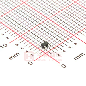

RB715F Diodes Shottky barrier diode RB715F Application Low current rectification Features 1) Small mold type. (UMD3) 2) Low VF 3) High reliability. External dimensions (Unit : mm) Lead size figure (Unit : mm) Each lead has same dimension Construction Silicon epitaxial planer Structure Taping dimensions (Unit : mm) Absolute maximum ratings (Ta=25 C) Parameter Reverse voltage (repetitive peak) Reverse voltage (DC) Average rectified forward current Forward current surge peak (60Hz 1cyc) (*1) Junction temperature Storage temperature (*1)Rating of per diode Electrical characteristics (Ta=25 C) Symbol VRM VR Io IFSM Tj Tstg Limits 40 40 30 200 125 -40 to +125 Unit V V mA mA Parameter Forward voltage Capacitance between terminals Symbol VF IR Ct Min. - Typ. 2.0 Max. 0.37 1 - Unit V μA pF Conditions IF=1mA VR=10V VR=1V f=1MHz Rev.B 1/3 RB715F Diodes Electrical characteristic curves (Ta=25 C) Rev.B 2/3 RB715F Diodes Rev.B 3/3 Appendix Notes No technical content pages of this document may be reproduced in any form or transmitted by any means without prior permission of ROHM CO.,LTD. The contents described herein are subject to change without notice. The specifications for the product described in this document are for reference only. Upon actual use, therefore, please request that specifications to be separately delivered. Application circuit diagrams and circuit constants contained herein are shown as examples of standard use and operation. Please pay careful attention to the peripheral conditions when designing circuits and deciding upon circuit constants in the set. Any data, including, but not limited to application circuit diagrams information, described herein are intended only as illustrations of such devices and not as the specifications for such devices. ROHM CO.,LTD. disclaims any warranty that any use of such devices shall be free from infringement of any third party's intellectual property rights or other proprietary rights, and further, assumes no liability of whatsoever nature in the event of any such infringement, or arising from or connected with or related to the use of such devices. Upon the sale of any such devices, other than for buyer's right to use such devices itself, resell or otherwise dispose of the same, no express or implied right or license to practice or commercially exploit any intellectual property rights or other proprietary rights owned or controlled by ROHM CO., LTD. is granted to any such buyer. Products listed in this document are no antiradiation design. The products listed in this document are designed to be used with ordinary electronic equipment or devices (such as audio visual equipment, office-automation equipment, communications devices, electrical appliances and electronic toys). Should you intend to use these products with equipment or devices which require an extremely high level of reliability and the malfunction of with would directly endanger human life (such as medical instruments, transportation equipment, aerospace machinery, nuclear-reactor controllers, fuel controllers and other safety devices), please be sure to consult with our sales representative in advance. About Export Control Order in Japan Products described herein are the objects of controlled goods in Annex 1 (Item 16) of Export Trade Control Order in Japan. In case of export from Japan, please confirm if it applies to "objective" criteria or an "informed" (by MITI clause) on the basis of "catch all controls for Non-Proliferation of Weapons of Mass Destruction. Appendix1-Rev1.1
