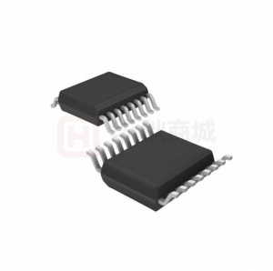

SGM321 SGM358 SGM324 PRODUCT DESCRIPTION The SGM321(single), SGM358(dual) and SGM324(quad) are rail-to-rail input and output voltage feedback amplifiers offering low cost. They have a wide input common-mode voltage range and output voltage swing, and take the minimum operating supply voltage down to 2.1V and the maximum recommended supply voltage is 5.5 V. All are specified over the extended – 40°C to +85°C temperature range. The SGM321/358/324 provide 1MHz bandwidth at a low current consumption of 60µA per amplifier. Very low input bias currents of 10pA, enable SGM321/358/ 324 to be used for integrators, photodiode amplifiers, and piezoelectric sensors. Rail-to-rail inputs and outputs are useful to designers buffering ASIC in single-supply systems. Applications for the series amplifiers include safety monitor- ing, portable equipment, battery and power supply control, and signal conditioning and interfacing for transducers in very low power systems. The SGM321 is available in SOT23-5 and SC70-5 packages. The SGM358 comes in SO-8,MSOP-8 and PDIP-8 packages. The SGM324 is offered in SO-14, TSSOP-14, TSSOP-16 and SO-16 packages. 1MHz, 60µA, Rail-to-Rail I/O CMOS Operational Amplifier FEATURES • Low Cost • Rail-to-Rail Input and Output 0.8mV Typical VOS • Unity Gain Stable • Gain Bandwidth Product: 1MHz • Very Low Input Bias Currents: 10pA • Operates on 2.1 V to 5.5 V Supplies • Input Voltage Range: - 0.1 V to +5.6 V with VS = 5.5 V • Low Supply Current: 60µA/Amplifier • Small Packaging SGM321 Available in SOT23-5 and SC70-5 SGM358 Available in SO-8, MSOP-8 and PDIP-8 SGM324 Available in SO-14, SO-16, TSSOP-14 and TSSOP-16 PIN CONFIGURATIONS (Top View) SGM321 OUT A 1 +IN 1 5 +VS -INA 2 -VS 2 +INA 3 -IN 3 4 OUT -VS 4 SGM358 8 7 +VS OUT B 6 -INB 5 +INB SOT23-5 / SC70-5 SO-8 / MSOP-8 / PDIP-8 APPLICATIONS ASIC Input or Output Amplifier Sensor Interface Piezo Electric Transducer Amplifier Medical Instrumentation Mobile Communication Audio Output Portable Systems Smoke Detectors Notebook PC PCMCIA cards Battery –Powered equipment DSP interface OUT A -IN A +IN A +VS +INB -INB OUT B NC 1 2 3 4 5 6 7 8 SGM324 16 OUT D 15 -IND 14 +IND 13 -VS 12 +INC 11 -INC 10 OUT C NC = NO CONNECT SGM324 OUT A -IN A +IN A +VS +INB -INB OUT B 1 2 3 4 5 6 7 14 OUT D 13 -IND 12 +IND 11 -VS 10 +INC 9 8 -INC OUT C 9 NC TSSOP-16 / SO-16 TSSOP-14/SO-14 Shengbang Microelectronics Co, Ltd Tel: 86/451/84348461 www.sg-micro.com REV. D ELECTRICAL CHARACTERISTICS : VS = +5V (At RL = 100kΩ connected to Vs/2,and VOUT = Vs/2, unless otherwise noted) SGM321/358/324 PARAMETER CONDITION TYP +25℃ INPUT CHARACTERISTICS Input Offset Voltage (VOS) Input Bias Current (IB) Input Offset Current (IOS) Common-Mode Voltage Range (VCM) Common-Mode Rejection Ratio(CMRR) Open-Loop Voltage Gain( AOL) Input Offset Voltage Drift (∆VOS/∆T) OUTPUT CHARACTERISTICS Output Voltage Swing from Rail Output Current (IOUT) POWER SUPPLY 2.1 5.5 Power Supply Rejection Ratio (PSRR) Quiescent Current / Amplifier (IQ) DYNAMIC PERFORMANCE Gain-Bandwidth Product (GBP) Slew Rate (SR) Settling Time to 0.1%( tS) Overload Recovery Time NOISE PERFORMANCE Voltage Noise Density (en) f = 1kHz f = 10kHz 27 20 nV/ nV/ Hz Hz MIN/MAX OVER TEMPERATURE +25℃ -40℃ to 85℃ UNITS MIN / MAX ±0.8 10 10 VS = 5.5V VS = 5.5V, VCM = - 0.1V to 4 V VS = 5.5V, VCM = - 0.1V to 5.6 V RL = 5KΩ ,Vo = 0.1V to 4.9V RL =100KΩ ,Vo = 0.035V to 4.965V - 0.1 to + 5.6 70 68 80 84 2.7 ±5 ±5.6 mV pA pA V MAX TYP TYP TYP MIN MIN MIN MIN TYP 62 56 70 80 62 55 70 80 dB dB dB dB µV/℃ RL = 100KΩ RL = 10KΩ 0.008 0.08 23 20 18.8 V V mA TYP TYP MIN Operating Voltage Range Vs = +2.5 V to + 5.5 V VCM = (-VS) + 0.5 IOUT = 0 CL = 100pF 1 G = +1 , 2V Output Step G = +1, 2 V Output Step VIN ·Gain = Vs 0.52 5.3 2.6 82 60 2.5 5.5 58 86 V V dB µA MIN MAX MIN MAX 60 80 MHz V/µs µs µs TYP TYP TYP TYP TYP TYP Specifications subject to change without notice. 2 SGM321/358/324 PACKAGE/ORDERING INFORMATION MODEL SGM321 ORDER NUMBER SGM321YC5/TR SGM321YN5/TR SGM358YS/TR SGM358 SGM358YMS/TR SGM358YP SGM324YS/TR SGM324 SGM324YTS/TR SGM324YS14/TR SGM324YTS14/TR PACKAGE DESCRIPTION SC70-5 SOT23-5 SO-8 MSOP-8 PDIP-8 SO-16 TSSOP-16 SO-14 TSSOP-14 PACKAGE OPTION Tape and Reel, 3000 Tape and Reel, 3000 Tape and Reel, 2500 Tape and Reel, 3000 Tube, 50 Tape and Reel, 2500 Tape and Reel, 3000 Tape and Reel, 2500 Tape and Reel, 3000 MARKING INFORMATION 321 321 SGM358YS SGM358YMS SGM358YP SGM324YS SGM324YTS SGM324YS14 SGM324YTS14 ABSOLUTE MAXIMUM RATINGS Supply Voltage, V+ to V- . . . . . . . . . . . . . . . . . . . . . 7.5 V Common-Mode Input Voltage . . . . . . . . . . . . . . . . . . . . (–VS) – 0.5 V to (+VS )+0.5V Storage Temperature Range . . . . . . . . .–65℃ to +150℃ Junction Temperature . . . . . . . . . . . . . . . .. . . . . . . .160℃ Operating Temperature Range . . . . . . . –45℃ to +85℃ Package Thermal Resistance @ TA = 25℃ SC70-5, θJA................................................................ 333℃/W SOT23-5, θJA.............................................................. 190℃/W SO-8, θJA......................................................................125℃/W MSOP-8, θJA.............................................................. 216℃/W SO-16, θJA..................................................................... 82℃/W TSSOP-16, θJA............................................................ 105℃/W Lead Temperature Range (Soldering 10 sec) .....................................................260℃ ESD Susceptibility HBM................................................................................4000V MM....................................................................................400V CAUTION This integrated circuit can be damaged by ESD. Shengbang Micro-electronics recommends that all integrated circuits be handled with appropriate precautions. Failure to observe proper handling and installation procedures can cause damage. ESD damage can range from subtle performance degradation to complete device failure. Precision integrated circuits may be more susceptible to damage because very small parametric changes could cause the device not to meet its published specifications. NOTES 1. Stresses above those listed under Absolute Maximum Ratings may cause permanent damage to the device. This is a stress rating only; functional operation of the device at these or any other conditions above those indicated in the operational section of this specification is not implied. Exposure to absolute maximum rating conditions for extended periods may affect device reliability. 3 SGM321/358/324 TYPICAL PERFORMANCE CHARACTERISTICS At TA = +25℃, VS = +5V, and RL = 100kΩ connected to Vs/2,unless otherwise noted. Small-Signal Step Response G = +1 CL = 100pF RL = 100KΩ Large-Signal Step Response G = +1 CL = 100pF RL = 100KΩ 20mV/div 2µs/div 500mV/div 10µs/div Small-Signal Overshoot vs.Load Capacitance Small-Signal Overshoot vs.Load Capacitance 60 Small-Signal Overshoot(%) 50 40 30 20 10 0 G = +1 RL = 100KΩ G = -1 RFB = 5KΩ G = -1 RFB = 100KΩ 60 Small-Signal Overshoot(%) 50 40 30 20 10 0 10 100 1000 Load Capacitance(pF) 10000 G = -5 RFB = 100KΩ 10 100 1000 Load Capacitance(pF) 10000 Maximum Output Voltage vs.Frequency 6 5 Output Voltage(Vp-p) 4 3 2 1 0 1 10 100 1000 Frequency(kHz) 10000 VS = 2.5V VS = 5V Maximum Output Voltage Without Slew-Rate Induced Distortion 50 Quiescent And Short-Circuit Current vs.Supply Voltage 30 25 Short-Circuit Current(mA) VS = 5.5V Quiescent Current(μA) 45 40 35 30 25 2 2.5 3 3.5 4 4.5 Supply Voltage(V) 5 5.5 IQ ISC 20 15 10 5 4 SGM321/358/324 TYPICAL PERFORMANCE CHARACTERISTICS At TA = +25℃, VS = +5V, and RL = 100kΩ connected to Vs/2,unless otherwise noted. Input Voltage Noise Spectral Density vs.Frequency CMRR And PSRR vs.Frequency 100 90 80 CMRR,PSRR(dB) 70 60 50 40 30 20 10 0 0.01 0.1 1 10 100 Frequency(kHz) 1000 10000 PSRR CMRR 1000 Voltage Noise(nV/√Hz) 100 10 0.01 0.1 1 Frequency(kHz) 10 100 Output Voltage Swing vs.Output Current 3 135℃ Output Voltage(V) 2 VS = 3 V 1 -50℃ 25℃ 135℃ Sinking Current 0 0 4 8 12 16 20 Output Current(mA) Sourcing Current -50℃ Output Voltage(V) 25℃ 4 3 2 1 0 0 5 Output Voltage Swing vs.Output Current 135℃ 25℃ VS = 5 V -50℃ Sourcing Current Sinking Current -50℃ 135℃ 5 10 15 25℃ 20 25 30 Output Current(mA) Supply Current vs.Temperature 60 55 50 45 40 35 30 -50 -30 -10 10 30 50 70 Temperature(℃) 90 110 130 VS = 2.5V Open-Loop Gain vs.Temperature 120 110 Open–Loop Gain(dB) RL = 5kΩ RL = 100kΩ Supply Current(μA) VS = 5V VS = 3V 100 90 80 70 60 -50 -30 -10 10 30 50 70 Temperature(℃) 90 110 130 5 SGM321/358/324 TYPICAL PERFORMANCE CHARACTERISTICS At TA = +25℃, VS = +5V, and RL = 100kΩ connected to Vs/2,unless otherwise noted. Common-Mode Rejection Ratio vs.Temperature 120 110 100 CMRR(dB) 90 80 70 60 -50 -30 -10 10 30 50 70 Temperature(℃) 90 110 130 PSRR(dB) 120 Power-Supply Rejection Ratio vs.Temperature -Vs < VCM < (+Vs)-1.5V 110 100 -Vs < VCM
