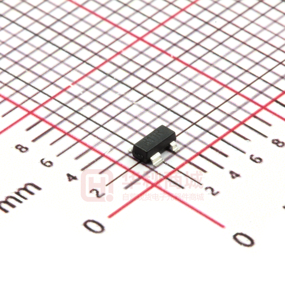

SGM811/SGM812 Microprocessor Supervisory with Manual Reset Input GENERAL DESCRIPTION FEATURES The SGM811/SGM812 supervisory circuits monitor the ● Superior Upgrade for MAX811/MAX812 and power supply voltage in microprocessor and digital ADM811/ADM812 systems. The SGM811/SGM812 is designed to monitor ● Specified Over Temperature seven different voltages; these voltages have been ● Low Power Consumption (13μA TYP) selected for the effective monitoring of 1.8V, 2.5V, 3V, ● Precision Voltage Monitor: 1.8V, 2.5V, 3V, 3.3V 3.3V and 5V supply voltage levels. and 5V Options ● Reset Assertion Down to 1V VCC They provide a reset output during power-up, power- ● 150ms Min Power-On Reset down and brownout conditions. On power-up, an internal Logic Low RESET Output (SGM811) timer holds reset asserted for 240ms. This holds the Logic High RESET Output (SGM812) microprocessor in a reset state until conditions have ● Manual Reset Input stabilized. The RESET output remains operational with ● Green SOT-143 and SOT-23-5 Packages VCC as low as 1V. The SGM811 provides an active low reset signal ( RESET ) while the SGM812 provides an PIN CONFIGURATIONS (TOP VIEW) active high signal (RESET) output. SOT-143 GND 1 4 VCC 3 MR 5 VCC 4 MR The SGM811/SGM812 has a manual reset input. The manual reset function is very useful, especially if the circuit in which the SGM811/SGM812 is operating enters 2 RESET/RESET into a state that can only be detected by the user. SOT-23-5 Allowing the user to reset a system manually can reduce the damage or danger that could otherwise be caused by GND 1 an out-of-control or locked system. The devices come in NC 2 RESET/RESET 3 SOT-143 and SOT-23-5 packages. APPLICATIONS Microprocessor Systems Controllers TYPICAL OPERATION CIRCUIT VCC Intelligent Instruments SGM811 Automotive Systems Safety Systems Portable Instruments SG Micro Corp www.sg-micro.com VCC MICROPROCESSOR SYSTEM RESET MR RESET GND GND 100kΩ REV. B. 4 Microprocessor Supervisory with Manual Reset Input SGM811/812 PACKAGE/ORDERING INFORMATION ORDERING NUMBER RESET THRESHOLD (V) PECKAGE TYPE SPECIFIED TEMPERATURE RANGE PACKAGE MARKING PACKING OPTION SGM811-LXN5/TR 4.63 SOT-23-5 -40℃ to +125℃ 811L Tape and Reel, 3000 SGM811-MXN5/TR 4.38 SOT-23-5 -40℃ to +125℃ 811M Tape and Reel, 3000 SGM811-JXN5/TR 4.00 SOT-23-5 -40℃ to +125℃ 811J Tape and Reel, 3000 SGM811-TXN5/TR 3.08 SOT-23-5 -40℃ to +125℃ 811T Tape and Reel, 3000 SGM811-SXN5/TR 2.93 SOT-23-5 -40℃ to +125℃ 811S Tape and Reel, 3000 SGM811-RXN5/TR 2.63 SOT-23-5 -40℃ to +125℃ 811R Tape and Reel, 3000 SGM811-ZXN5/TR 2.32 SOT-23-5 -40℃ to +125℃ 811Z Tape and Reel, 3000 SGM811-LXKA4/TR 4.63 SOT-143 -40℃ to +125℃ 811L Tape and Reel, 3000 SGM811-MXKA4/TR 4.38 SOT-143 -40℃ to +125℃ 811M Tape and Reel, 3000 SGM811-JXKA4/TR 4.00 SOT-143 -40℃ to +125℃ 811J Tape and Reel, 3000 SGM811-TXKA4/TR 3.08 SOT-143 -40℃ to +125℃ 811T Tape and Reel, 3000 SGM811-SXKA4/TR 2.93 SOT-143 -40℃ to +125℃ 811S Tape and Reel, 3000 SGM811-RXKA4/TR 2.63 SOT-143 -40℃ to +125℃ 811R Tape and Reel, 3000 -40℃ to +125℃ 811Z Tape and Reel, 3000 Tape and Reel, 3000 SGM811-ZXKA4/TR 2.32 SOT-143 SGM811-XXKA4/TR 1.63 SOT-143 -40℃ TO +125℃ 811X SGM812-LXN5/TR 4.63 SOT-23-5 -40℃ to +125℃ 812L Tape and Reel, 3000 SGM812-M XN5/TR 4.38 SOT-23-5 -40℃ to +125℃ 812M Tape and Reel, 3000 SGM812-JXN5/TR 4.00 SOT-23-5 -40℃ to +125℃ 812J Tape and Reel, 3000 SGM812-TXN5/TR 3.08 SOT-23-5 -40℃ to +125℃ 812T Tape and Reel, 3000 SGM812-SXN5/TR 2.93 SOT-23-5 -40℃ to +125℃ 812S Tape and Reel, 3000 SGM812-RXN5/TR 2.63 SOT-23-5 -40℃ to +125℃ 812R Tape and Reel, 3000 SGM812-ZXN5/TR 2.32 SOT-23-5 -40℃ to +125℃ 812Z Tape and Reel, 3000 SGM812-LXKA4/TR 4.63 SOT-143 -40℃ to +125℃ 812L Tape and Reel, 3000 SGM812-MXKA4/TR 4.38 SOT-143 -40℃ to +125℃ 812M Tape and Reel, 3000 SGM812-JXKA4/TR 4.00 SOT-143 -40℃ to +125℃ 812J Tape and Reel, 3000 SGM812-TXKA4/TR 3.08 SOT-143 -40℃ to +125℃ 812T Tape and Reel, 3000 SGM812-SXKA4/TR 2.93 SOT-143 -40℃ to +125℃ 812S Tape and Reel, 3000 SGM812-RXKA4/TR 2.63 SOT-143 -40℃ to +125℃ 812R Tape and Reel, 3000 SGM812-ZXKA4/TR 2.32 SOT-143 -40℃ to +125℃ 812Z Tape and Reel, 3000 SG Micro Corp www.sg-micro.com 2 Microprocessor Supervisory with Manual Reset Input SGM811/812 ELECTRICAL CHARACTERISTICS (VCC TYP = 5V for L/M/J Models, 3.3V for T/S Models, 3V for R Models, 2.5V for Z Models, 1.8V for X Models; unless otherwise noted.) PARAMETER CONDITIONS MIN TYP MAX UNITS SUPPLY Voltage TA = 0℃ to +70℃ 1.0 5.5 V TA = -40℃ to +125℃ 1.2 5.5 V 30 μA 50 μA 25 μA 45 μA 4.723 V 4.86 V 4.38 4.468 V 4.56 V 4.00 4.08 V 4.2 V 3.08 3.157 V 3.23 V 2.93 3.003 V 3.08 V 2.696 V 2.76 V 2.378 V 2.42 V 1.671 V 1.71 V VCC < 5.5V, SGM81_L/M/J, TA = +25℃ 17 VCC < 5.5V, SGM81_L/M/J, TA = -40℃ to +125℃ Current VCC < 3.6V, SGM81_R/S/T/Z/X, TA = +25℃ 13 VCC < 3.6V, SGM81_R/S/T/Z/X, TA = -40℃ to +125℃ RESET VOLTAGE THRESHOLD SGM81_L SGM81_M SGM81_J TA = +25℃ 4.537 TA = -40℃ to +125℃ 4.40 TA = +25℃ 4.292 TA = -40℃ to +125℃ 4.16 TA = +25℃ 3.92 TA = -40℃ to +125℃ TA = +25℃ SGM81_T SGM81_S SGM81_R SGM81_Z SGM811X 3.8 3.003 TA = -40℃ to +125℃ 2.92 TA = +25℃ 2.857 TA = -40℃ to +125℃ 2.78 TA = +25℃ 2.564 TA = -40℃ to +125℃ 2.50 TA = +25℃ 2.262 TA = -40℃ to +125℃ 2.22 TA = +25℃ 1.589 TA = -40℃ to +125℃ 1.55 Reset Threshold Temperature Coefficient VCC to RESET/ RESET Delay Reset Active Timeout Period 4.63 2.63 2.32 1.63 30 VCC = VTH to (VTH - 100mV) ppm/°C 20 TA = -40℃ to +85℃ 150 TA = -40℃ to +125℃ 100 240 μs 560 ms 840 ms MANUAL RESET Minimum Pulse Width 10 μs Glitch Immunity 100 ns RESET/ RESET Propagation Delay 0.5 μs 1 MΩ Pull-Up Resistance The Manual Reset Circuit Will Act On: An Input Rising Above VCC > VTH(MAX), SGM81_L/M/J An Input Falling Below VCC > VTH(MAX), SGM81_L/M/J An Input Rising Above VCC > VTH(MAX), SGM81_R/S/T/Z/X An Input Falling Below VCC > VTH(MAX), SGM81_R/S/T/Z/X SG Micro Corp www.sg-micro.com 2.3 V 0.8 V 0.25 × VCC V 0.7 × VCC V 3 Microprocessor Supervisory with Manual Reset Input SGM811/812 ELECTRICAL CHARACTERISTICS (VCC TYP = 5V for L/M/J Models, 3.3V for T/S Models, 3V for R Models, 2.5V for Z Models, 1.8V for X Models; unless otherwise noted.) PARAMETER CONDITIONS MIN TYP MAX UNITS RESET/ RESET OUTPUT VOLTAGE Low (SGM811R/S/T/Z/X) VCC = VTH(MIN), ISINK = 1.2mA 0.3 V Low (SGM811L/M/J) VCC = VTH(MIN), ISINK = 3.2mA 0.4 V 0.3 V Low (SGM811R/S/T/Z/X/L/M/J) VCC > 1.0V, ISINK = 50μA High (SGM811R/S/T/Z/X) VCC > VTH(MAX), ISOURCE = 500μA 0.8 × VCC V High (SGM811L/M/J) VCC > VTH(MAX), ISOURCE = 800μA VCC - 1.5 V Low (SGM812R/S/T/Z/X) VCC = VTH(MAX), ISINK = 1.2mA 0.3 V Low (SGM812L/M/J) VCC = VTH(MAX), ISINK = 3.2mA 0.4 V High (SGM812 R/S/T/Z/X/L/M/J) 1.8 V < VCC < VTH(MIN), ISOURCE = 150μA SG Micro Corp www.sg-micro.com 0.8 × VCC V 4 SGM811/812 Microprocessor Supervisory with Manual Reset Input ABSOLUTE MAXIMUM RATINGS (Typical values are at TA = +25°C, unless otherwise noted.) Terminal Voltage (With Respect to Ground) VCC.............................................................................-0.3V to 6V All Other Inputs.............................................-0.3V to VCC + 0.3V Input Current VCC, MR .............................................................................20mA Output Current RESET, RESET .................................................................20mA Power Dissipation, PD @ TA = +25℃ SOT-23-5.............................................................................0.4W SOT-143........................................................................... 0.32W Operating Temperature Range.........................-40℃ to +125℃ Junction Temperature.......................................................150℃ Storage Temperature........................................-65℃ to +150℃ Lead Temperature (Soldering, 10s)...................................260℃ ESD Susceptibility HBM..................................................................................4000V MM......................................................................................400V Stresses beyond those listed under “Absolute Maximum Ratings” may cause permanent damage to the device. These are stress ratings only, and functional operation of the device at these or any other conditions beyond those indicated in the operational sections of the specifications is not implied. Exposure to absolute maximum rating conditions for extended periods may affect device reliability. CAUTION This integrated circuit can be damaged by ESD if you don’t pay attention to ESD protection. SGMICRO recommends that all integrated circuits be handled with appropriate precautions. Failure to observe proper handling and installation procedures can cause damage. ESD damage can range from subtle performance degradation to complete device failure. Precision integrated circuits may be more susceptible to damage because very small parametric changes could cause the device not to meet its published specifications. SGMICRO reserves the right to make any change in circuit design, specification or other related things if necessary without notice at any time. Please contact SGMICRO sales office to get the latest datasheet. PIN DESCRIPTION PIN NUMBER FUNCTION NAME SGM811 SGM812 SOT-143 SOT-23-5 SOT-143 SOT-23-5 GND 1 1 1 1 Ground NC 2 2 No Connect. Active Low Logic Output. RESET remains low while VCC is below 2 3 — — the reset threshold or when MR is low; RESET then remains low RESET for at least 150ms after VCC rises above the reset threshold. Active High Logic Output. RESET remains high while VCC is below the reset threshold or when MR is low; RESET then RESET — — 2 3 remains high for 240ms (typical) after VCC rises above the reset threshold. Manual Reset. This active low debounced input will ignore input 3 4 3 4 pulses of 100ns or less (typical) and is guaranteed to accept input MR pulses of greater than 10μs. Leave floating when not used. VCC 4 5 4 5 Power supply voltage that is monitored. SG Micro Corp www.sg-micro.com 5 Microprocessor Supervisory with Manual Reset Input SGM811/812 TYPICAL PERFORMANCE CHARACTERISTICS Power-Down RESET Delay vs. Temperature Power-Down RESET Delay vs. Temperature 250 Power-Down RESET (µs) Power-Down RESET (µs) VOD = VTH - VCC SGM811L/M/J 200 VOD = 10mV 150 VOD = 20mV 100 50 300 VOD = 100mV VOD = 200mV 10 70 SGM811T/S/R 200 VOD = 20mV 150 100 VOD = 100mV 50 -50 -30 -10 30 50 90 -50 110 130 -30 -10 30 50 70 90 110 130 Supply Current vs. Temperature (No Load) Power-Up RESET Delay vs. Temperature 270 10 Temperature (℃) Temperature (℃) 30 SGM8_S 265 25 260 255 Supply Current (μA) Power-Down RESET (ms) VOD = 200mV 0 0 250 245 240 235 230 VCC = 5.5V 20 15 VCC = 3.6V 10 5 225 0 220 -50 -30 -10 10 30 50 70 90 110 -50 130 -30 -10 10 30 50 70 90 110 130 Temperature (℃) Temperature (℃) Normalized RESET Voltage Threshold vs. Temperature Maximum Transient Duration Without Causing a Reset Pulse vs. RESET Comparator Overdrive 1.008 400 Maximum Transient Duration (µs) Normalized RESET Threshold VOD = VTH - VCC VOD = 10mV 250 1.006 1.004 1.002 1 0.998 0.996 0.994 0.992 0.99 0.988 -50 -30 -10 10 30 50 70 Temperature (℃) SG Micro Corp www.sg-micro.com 90 110 130 350 300 SGM811L/M/J 250 200 150 100 50 SGM811T/S/R 0 1 10 100 1000 RESET Comparator Overdrive, VTH - VCC (mV) 6 Microprocessor Supervisory with Manual Reset Input SGM811/812 TYPICAL PERFORMANCE CHARACTERISTICS RESET Output Voltage vs. Supply Voltage Supply Voltage 5VP-P 2V/div RESET Output Voltage SGM811R SGM811S 200ms/div SG Micro Corp www.sg-micro.com 7 Microprocessor Supervisory with Manual Reset Input SGM811/812 APPLICATION INFORMATION Manual Reset Reset Output The SGM811/SGM812 is equipped with a manual reset input This input is designed to operate in a noisy environment where unwanted glitches could be induced. These glitches could be produced by the bouncing action of a switch contact, or where a manual reset switch may be located some distance away from the circuit (the cabling of which may pick-up noise). The manual reset input is guaranteed to ignore logically valid inputs that are faster than 100ns and to accept inputs longer in duration than 10μs. On power-up and after VCC rises above the reset threshold, an internal timer holds the reset output active for 240ms (typical). This is intended as a power-on reset signal for the processor. It allows time for both the power supply and the microprocessor to stabilize after power-up. If a power supply brownout or interruption occurs, the reset output is similarly activated and remains active for 240ms (typical) after the supply recovers. This allows time for the power supply and microprocessor to stabilize. The SGM811 provides an active low reset output ( RESET ) while the SGM812 provides an active high output ( RESET ). During power-down of the SGM811, the RESET output remains valid (low) with VCC as low as 1V. This ensures that the microprocessor is held in a stable shutdown condition as the supply falls and also ensures that no spurious activity can occur via the microprocessor as it powers up. Very Accurate Reset Threshold Because the SGM811/SGM812 can operate effectively even when there are large degradations of the supply voltages, the possibility of a malfunction during a power failure is greatly reduced. Another advantage of the SGM811/SGM812 is its very accurate internal voltage reference circuit. Combined, these benefits produce an exceptionally reliable microprocessor supervisory circuit. Glitch Immunity The SGM811/SGM812 contains internal filtering circuitry providing glitch immunity from fast transient glitches on the power supply line. VCC VCC VCC SGM811 RESET GND RESET VREF VREF t1 VREF VREF t1 t1 = RESET Time = 240ms Typical VREF = RESET Voltage Threshold Figure 1. Ensuring a Valid RESET Output Down to VCC = 0V Figure 2. Power Fail RESET Timing Ensuring A Valid Reset Output Down to Vcc = 0V Interfacing to Other Devices Output When VCC falls below 1.0 V, the SGM811/SGM812’s RESET no longer sinks current. Therefore, a high impedance CMOS logic input connected to RESET may drift to undetermined logic levels. To eliminate this problem, a 100kΩ resistor should be connected from RESET to ground. The SGM811/SGM812 is designed to integrate with as many devices as possible. One feature of the SGM811/SGM812 is the reset output, which is directly proportional to VCC (this is guaranteed only while VCC is greater than 1V). This enables the part to be used with both 3V and 5V, or any nominal voltage within the minimum and maximum specifications for VCC. SG Micro Corp www.sg-micro.com 8 Microprocessor Supervisory with Manual Reset Input SGM811/812 PACKAGE OUTLINE DIMENSIONS SOT-23-5 1.90 D e1 E1 2.59 E 0.99 b e 0.95 0.69 RECOMMENDED LAND PATTERN (Unit: mm) L A A1 θ A2 Symbol Dimensions In Millimeters MIN MAX c 0.2 Dimensions In Inches MIN MAX A 1.050 1.250 0.041 0.049 A1 0.000 0.100 0.000 0.004 A2 1.050 1.150 0.041 0.045 b 0.300 0.500 0.012 0.020 c 0.100 0.200 0.004 0.008 D 2.820 3.020 0.111 0.119 E 1.500 1.700 0.059 0.067 E1 2.650 2.950 0.104 0.116 e 0.950 BSC e1 0.037 BSC 1.900 BSC 0.075 BSC L 0.300 0.600 0.012 0.024 θ 0° 8° 0° 8° SG Micro Corp www.sg-micro.com 9 Microprocessor Supervisory with Manual Reset Input SGM811/812 PACKAGE OUTLINE DIMENSIONS SOT-143 1.90 D 0.95 e1 e E1 E 2.2 1.0 d b1 b 0.20 0.55 0.95 RECOMMENDED LAND PATTERN (Unit: mm) L L1 A A1 θ A2 c 0.250 Symbol A A1 A2 b b1 c D d E E1 e e1 L L1 θ SG Micro Corp www.sg-micro.com Dimensions In Millimeters MIN MAX 0.900 1.150 0.000 0.100 0.900 1.050 0.300 0.500 0.750 0.900 0.080 0.150 2.800 3.000 0.200 TYP 1.200 1.400 2.250 2.550 0.95 TYP 1.800 2.000 0.55 REF 0.300 0.500 0° 8° Dimensions In Inches MIN MAX 0.035 0.045 0.000 0.004 0.035 0.041 0.012 0.020 0.030 0.035 0.003 0.006 0.110 0.118 0.008 TYP 0.047 0.055 0.089 0.100 0.037 TYP 0.071 0.079 0.022 REF 0.012 0.020 0° 8° 10 Microprocessor Supervisory with Manual Reset Input SGM811/812 TAPE AND REEL INFORMATION REEL DIMENSIONS TAPE DIMENSIONS P2 W P0 Q1 Q2 Q1 Q2 Q1 Q2 Q3 Q4 Q3 Q4 Q3 Q4 B0 Reel Diameter P1 A0 K0 DIRECTION OF FEED Reel Width (W1) NOTE: The picture is only for reference. Please make the object as the standard. KEY PARAMETER LIST OF TAPE AND REEL Package Type Reel Diameter Reel Width W1 (mm) A0 (mm) B0 (mm) K0 (mm) P0 (mm) P1 (mm) P2 (mm) W (mm) Pin1 Quadrant SOT-23-5 7″ 9.5 3.2 3.2 1.4 4.0 4.0 2.0 8.0 Q3 SOT-143 7″ 9.5 3.2 2.8 1.3 4.0 4.0 2.0 8.0 Q3 SG Micro Corp www.sg-micro.com 11 Microprocessor Supervisory with Manual Reset Input SGM811/812 CARTON BOX DIMENSIONS NOTE: The picture is only for reference. Please make the object as the standard. KEY PARAMETER LIST OF CARTON BOX Reel Type Length (mm) Width (mm) Height (mm) Pizza/Carton 7″ (Option) 368 227 224 8 7″ 442 410 224 18 SG Micro Corp www.sg-micro.com 12
