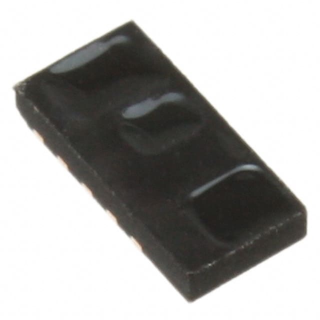

VCNL3020 www.vishay.com Vishay Semiconductors Fully Integrated Proximity Sensor With Infrared Emitter, I2C Interface, and Interrupt Function FEATURES • Package type: surface-mount • Dimensions (L x W x H in mm): 4.90 x 2.40 x 0.83 • Integrated modules: infrared emitter (IRED), proximity sensor (PD), and signal conditioning IC • Interrupt function • Supply voltage range VDD: 2.5 V to 3.6 V • Supply voltage range IR anode: 2.5 V to 5 V • Communication via I2C interface IR anode 1 SDA 2 INT 3 SCL 4 VDD 5 10 IR cathode • I2C bus H-level range: 1.7 V to 5 V 9 GND • Floor life: 72 h, MSL 4, according to J-STD-020 8 GND • Low stand by current consumption: 1.5 μA 7 nc 6 nc • Material categorization: for definitions of compliance please see www.vishay.com/doc?99912 PROXIMITY FUNCTION DESCRIPTION The VCNL3020 is a fully integrated proximity sensor. Fully integrated means that the infrared emitter is included in the package. It has 16 bit resolution. It includes a signal processing IC and features standard I2C communication interface. It features an interrupt function. • Built-in infrared emitter and photo-pin-diode for proximity function • 16 bit effective resolution for proximity detection range ensures excellent cross talk immunity • Programmable LED drive current from 10 mA to 200 mA in 10 mA steps • Excellent ambient light suppression by signal modulation APPLICATIONS • Proximity distance up to 200 mm • Proximity sensor for mobile devices (e.g. smart phones, touch phones, PDA, GPS) for touch screen locking, power saving, etc. • Proximity / optical switch for consumer, computing and industrial devices and displays PRODUCT SUMMARY PART NUMBER VCNL3020 OPERATING RANGE (mm) OPERATING VOLTAGE RANGE (V) I2C BUS VOLTAGE RANGE (V) LED PULSE CURRENT (1) (mA) OUTPUT CODE ADC RESOLUTION PROXIMITY / AMBIENT LIGHT 1 to 200 2.5 to 3.6 1.7 to 5 10 to 200 16 bit, I2C 16 bit / - PACKAGING VOLUME (1) Note (1) Adjustable through I2C interface ORDERING INFORMATION ORDERING CODE VCNL3020-GS08 VCNL3020-GS18 Tape and reel MOQ: 3300 pcs MOQ: 13 300 pcs REMARKS 4.90 mm x 2.40 mm x 0.83 mm Note MOQ: minimum order quantity (1) Rev. 1.2, 20-Mar-18 Document Number: 84150 1 For technical questions, contact: sensorstechsupport@vishay.com THIS DOCUMENT IS SUBJECT TO CHANGE WITHOUT NOTICE. THE PRODUCTS DESCRIBED HEREIN AND THIS DOCUMENT ARE SUBJECT TO SPECIFIC DISCLAIMERS, SET FORTH AT www.vishay.com/doc?91000 VCNL3020 www.vishay.com Vishay Semiconductors ABSOLUTE MAXIMUM RATINGS (Tamb = 25 °C, unless otherwise specified) PARAMETER SYMBOL MIN. MAX. UNIT Supply voltage TEST CONDITION VDD -0.3 5.5 V Operation temperature range Tamb -25 +85 °C Storage temperature range Tstg -25 +85 °C Ptot 50 mW Tj 100 °C Tamb ≤ 25 °C Total power dissipation Junction temperature BASIC CHARACTERISTICS (Tamb = 25 °C, unless otherwise specified) PARAMETER MAX. UNIT Supply voltage VDD TEST CONDITION SYMBOL 2.5 3.6 V Supply voltage IR anode 2.5 5 V I2C Bus H-level range 1.7 5 V INT H-level range MIN. TYP. 1.7 5 V 0.4 V 2 μA INT low voltage 3 mA sink current Current consumption Standby current, no IRED-operation 1.5 2 measurements per second, IRED current 20 mA 5 μA 250 measurements per second, IRED current 20 mA 520 μA 2 measurements per second, IRED current 200 mA 35 μA 250 measurements per second, IRED current 200 mA 4 mA Current consumption proximity mode incl. IRED (averaged) I2C clock rate range fSCL CIRCUIT BLOCK DIAGRAM 3400 kHz TEST CIRCUIT IRED IR Anode 1 9 GND Kodak gray card (18 % reflectivity) d = 20 mm SDA 2 INT 3 30 mm x 30 mm 10 IR Cathode VCNL 3020 ASIC 8 GND SCL 4 VDD 5 7 nc 22300-3 Proxi PD VCNL3020 IRED Proxi-PD 6 nc Note • nc must not be electrically connected Pads 6 and 7 are only considered as solder pads Rev. 1.2, 20-Mar-18 Document Number: 84150 2 For technical questions, contact: sensorstechsupport@vishay.com THIS DOCUMENT IS SUBJECT TO CHANGE WITHOUT NOTICE. THE PRODUCTS DESCRIBED HEREIN AND THIS DOCUMENT ARE SUBJECT TO SPECIFIC DISCLAIMERS, SET FORTH AT www.vishay.com/doc?91000 VCNL3020 www.vishay.com Vishay Semiconductors BASIC CHARACTERISTICS (Tamb = 25 °C, unless otherwise specified) 250 IIRED - Forward Current IRED (mA) 2.2 2.0 VDD = 3.6 V VDD = 3.5 V VDD = 3.3 V VDD = 3.1 V 1.8 VDD = 2.5 V VDD = 2.7 V VDD = 2.9 V 1.6 1.4 1.2 1.0 - 50 - 30 - 10 10 30 50 70 90 200 mA 200 160 mA 120 mA 100 mA 80 mA 60 mA 50 40 mA 20 mA 0 -60 -20 20 60 100 140 Tamb - Ambient Temperature (°C) 22304 Fig. 4 - Forward Current vs. Temperature 2.4 1.1 Ie, rel - Relative Radiant Intensity IDD - Supply Current Idle Mode (μA) 140 mA 100 Fig. 1 - Idle Current vs. Ambient Temperature 100 °C 2.2 2.0 80 °C 1.8 55 °C 1.6 25 °C 1.4 -10 °C 1.2 -40 °C 2.4 2.6 2.8 3.0 3.2 3.4 3.6 VDD - Supply Voltage (V) 22302 IF = 100 mA 1.0 0.9 0.8 0.7 0.6 0.5 0.4 0.3 0.2 0.1 1.0 0 750 3.8 22305 Fig. 2 - Idle Current vs. VDD 800 850 900 950 1000 1050 λ - Wavelength (nm) Fig. 5 - Relative Radiant Intensity vs. Wavelength 0° LED current 200 mA 10 000 1000 LED current 100 mA 100 LED current 20 mA 10 Media: Kodak gray card Mod. frequency = 390 kHz Irel - Relative Radiant Intensity 100 000 Proximity Value (cts) 180 mA 150 110 Tamb - Ambient Temperature (°C) 22301 VIRED = 2.5 V 20° 1.0 0.9 40° 0.8 0.7 60° 0.6 ϕ - Angular Displacement IDD - Supply Current Idle Mode (μA) 2.4 80° 1 0.1 1 10 Distance to Reflecting Card (mm) Fig. 3 - Proximity Value vs. Distance Rev. 1.2, 20-Mar-18 0.5 0.4 0.3 0.2 0.1 0 100 22306 Fig. 6 - Relative Radiant Intensity vs. Angular Displacement Document Number: 84150 3 For technical questions, contact: sensorstechsupport@vishay.com THIS DOCUMENT IS SUBJECT TO CHANGE WITHOUT NOTICE. THE PRODUCTS DESCRIBED HEREIN AND THIS DOCUMENT ARE SUBJECT TO SPECIFIC DISCLAIMERS, SET FORTH AT www.vishay.com/doc?91000 VCNL3020 www.vishay.com Vishay Semiconductors 0° 20° 0.9 0.8 0.7 0.6 0.5 0.4 0.3 0.2 1.0 0.9 40° 0.8 0.7 60° 0.6 ϕ - Angular Displacement 1.0 Srel - Relative Sensitivity S(λ)rel - Relative Spectral Sensitivity 1.1 80° 0.1 0 400 500 600 700 800 900 0.5 0.4 0.3 0.2 0.1 0 1000 1100 λ - Wavelength (nm) 22307 22308 Fig. 7 - Relative Spectral Sensitivity vs. Wavelength (Proximity Sensor) Fig. 8 - Relative Radiant Sensitivity vs. Angular Displacement (Proximity Sensor) APPLICATION INFORMATION VCNL3020 is a cost effective solution of proximity sensor with I2C bus interface. The standard serial digital interface is easy to access “Proximity Signal” without complex calculation and programming by external controller. Beside the digital output also a flexible programmable interrupt pin is available. 1. Application Circuit 1.7 V to 5.0 V 2.5 V to 5.0 V C1 C2 R2 R3 R4 22 μF 100 nF 2.5 V to 3.6 V IR_Anode (1) R1 10R C4 C3 VDD (5) 10 μF 100 nF VCNL3020 GND (8, 9) Host Micro Controller INT (3) GPIO SCL (4) SDA (2) I2C Bus Clock SCL I2C Bus Data SDA 22312-4 Fig. 9 - Application Circuit (x) = Pin Number Notes • The interrupt pin is an open drain output. The needed pull-up resistor may be connected to the same supply voltage as the application controller and the pull-up resistors at SDA/SCL. Proposed value R2 should be >1 kΩ , e.g. 10 kΩ to 100 kΩ. Proposed value for R3 and R4, e.g. 2.2 kΩ to 4.7 kΩ, depend also on the I2C bus speed. For detailed description about set-up and use of the interrupt as well as more application related information see AN: “Designing VCNL3020 into an Application”. • IR_Cathode needs no external connection. The needed connection to the driver is done internally. Rev. 1.2, 20-Mar-18 Document Number: 84150 4 For technical questions, contact: sensorstechsupport@vishay.com THIS DOCUMENT IS SUBJECT TO CHANGE WITHOUT NOTICE. THE PRODUCTS DESCRIBED HEREIN AND THIS DOCUMENT ARE SUBJECT TO SPECIFIC DISCLAIMERS, SET FORTH AT www.vishay.com/doc?91000 VCNL3020 www.vishay.com Vishay Semiconductors 2. I2C Interface The VCNL3020 contains seventeen 8 bit registers for operation control, parameter setup and result buffering. All registers are accessible via I2C communication. Figure 13 shows the basic I2C communication with VCNL3020. The built in I2C interface is compatible with all I2C modes (standard, fast, and high speed). I2C H-level range = 1.7 V to 5 V. Please refer to the I2C specification from NXP for details. Send byte S Write command to VCNL3020 Slave address Receive byte Wr A Register address Data byte A A P Read data from VCNL3020 S Slave address Wr A Register address A P S Slave address Rd A Data byte A P S = start condition P = stop condition A = acknowledge Host action 22313-3 VCNL3020 response Fig. 10 - Send Byte/Receive Byte Protocol Device Address Register Addresses The VCNL3020 has a fix slave address for the host programming and accessing selection. The predefined 7 bit I2C bus address is set to 0010 011 = 13h. The least significant bit (LSB) defines read or write mode. Accordingly the bus address is set to 0010 011x = 26h for write, 27h for read. VCNL3020 has seventeen user accessible 8 bit registers. The register addresses are 80h (register #0) to 90h (register #16). REGISTER FUNCTIONS Register #0 Command Register Register address = 80h The register #0 is for starting proximity measurements. This register contains a flag bit for data ready indication. TABLE 1 - COMMAND REGISTER #0 Bit 7 Bit 6 Bit 5 Bit 4 Bit 3 Bit 2 Bit 1 Bit 0 config_lock n/a prox_data_rdy n/a prox_od n/a prox_en selftimed_en Description config_lock prox_data_rdy Read only bit. Value = 1 Read only bit. Value = 1 when proximity measurement data is available in the result registers. This bit will be reset when one of the corresponding result registers (reg #7, reg #8) is read. prox_od R/W bit. Starts a single on-demand measurement for proximity. Result is available at the end of conversion for reading in the registers #7(HB) and #8(LB). prox_en R/W bit. Enables periodic proximity measurement selftimed_en R/W bit. Enables state machine and LP oscillator for self timed measurements; no measurement is performed until the corresponding bit is set Note • Beside prox_en first selftimed_en needs to be set. On-demand measurement mode is disabled if selftimed_en bit is set. For the selftimed_en mode changes in reading rates (reg #2) can be made only when b0 (selftimed_en bit) = 0. Rev. 1.2, 20-Mar-18 Document Number: 84150 5 For technical questions, contact: sensorstechsupport@vishay.com THIS DOCUMENT IS SUBJECT TO CHANGE WITHOUT NOTICE. THE PRODUCTS DESCRIBED HEREIN AND THIS DOCUMENT ARE SUBJECT TO SPECIFIC DISCLAIMERS, SET FORTH AT www.vishay.com/doc?91000 VCNL3020 www.vishay.com Vishay Semiconductors Register #1 Product ID Revision Register Register address = 81h. This register contains information about product ID and product revision. Register data value of current revision = 21h. TABLE 2 - PRODUCT ID REVISION REGISTER #1 Bit 7 Bit 6 Bit 5 Bit 4 Bit 3 Bit 2 Product ID Bit 1 Bit 0 Bit 1 Bit 0 Revision ID Description Product ID Read only bits. Value = 2 Revision ID Read only bits. Value = 1 Register #2 Rate of Proximity Measurement Register address = 82h. TABLE 3 - PROXIMITY RATE REGISTER #2 Bit 7 Bit 6 Bit 5 Bit 4 Bit 3 Bit 2 Rate of Proximity Measurement (no. of measurements per second) n/a Description Proximity rate R/W bits. 000 - 1.95 measurements/s (DEFAULT) 001 - 3.90625 measurements/s 010 - 7.8125 measurements/s 011 - 16.625 measurements/s 100 - 31.25 measurements/s 101 - 62.5 measurements/s 110 - 125 measurements/s 111 - 250 measurements/s Note • If self_timed measurement is running, any new value written in this register will not be taken over until the mode is actualy cycled. Register #3 LED Current Setting for Proximity Mode Register address = 83h. This register is to set the LED current value for proximity measurement. The value is adjustable in steps of 10 mA from 0 mA to 200 mA. This register also contains information about the used device fuse program ID. TABLE 4 - IR LED CURRENT REGISTER #3 Bit 7 Bit 6 Bit 5 Bit 4 Bit 3 Bit 2 Bit 1 Fuse prog ID IR LED current value Fuse prog ID Read only bits. Information about fuse program revision used for initial setup/calibration of the device. Bit 0 Description IR LED current value Rev. 1.2, 20-Mar-18 R/W bits. IR LED current = Value (dec.) x 10 mA. Valid Range = 0 to 20d. e.g. 0 = 0 mA , 1 = 10 mA, …., 20 = 200 mA (2 = 20 mA = DEFAULT) LED Current is limited to 200 mA for values higher as 20d. Document Number: 84150 6 For technical questions, contact: sensorstechsupport@vishay.com THIS DOCUMENT IS SUBJECT TO CHANGE WITHOUT NOTICE. THE PRODUCTS DESCRIBED HEREIN AND THIS DOCUMENT ARE SUBJECT TO SPECIFIC DISCLAIMERS, SET FORTH AT www.vishay.com/doc?91000 VCNL3020 www.vishay.com Vishay Semiconductors Register #7 and #8 Proximity Measurement Result Register Register address = 87h and 88h. These registers are the result registers for proximity measurement readings. The result is a 16 bit value. The high byte is stored in register #7 and the low byte in register #8. TABLE 5 - PROXIMITY RESULT REGISTER #7 Bit 7 Bit 6 Bit 5 Bit 4 Bit 3 Bit 2 Bit 1 Bit 0 Bit 1 Bit 0 Description Read only bits. High byte (15:8) of proximity measurement result TABLE 6 - PROXIMITY RESULT REGISTER #8 Bit 7 Bit 6 Bit 5 Bit 4 Bit 3 Bit 2 Description Read only bits. Low byte (7:0) of proximity measurement result Register #9 Interrupt Control Register Register address = 89h. TABLE 7 - INTERRUPT CONTROL REGISTER #9 Bit 7 Bit 6 Int count exceed Bit 5 Bit 4 Bit 3 Bit 2 Bit 1 Bit 0 n/a INT_PROX_ ready_EN n/a INT_THRES_EN INT_THRES_ SEL Description Int count exceed INT_PROX_ready_EN R/W bits. These bits contain the number of consecutive measurements needed above/below the threshold 000 - 1 count = DEFAULT 001 - 2 count 010 - 4 count 011 - 8 count 100 -16 count 101 - 32 count 110 - 64 count 111 - 128 count R/W bit. Enables interrupt generation at proximity data ready INT_THRES_EN R/W bit. Enables interrupt generation when high or low threshold is exceeded INT_THRES_SEL R/W bit. 0: thresholds are applied to proximity measurements Rev. 1.2, 20-Mar-18 Document Number: 84150 7 For technical questions, contact: sensorstechsupport@vishay.com THIS DOCUMENT IS SUBJECT TO CHANGE WITHOUT NOTICE. THE PRODUCTS DESCRIBED HEREIN AND THIS DOCUMENT ARE SUBJECT TO SPECIFIC DISCLAIMERS, SET FORTH AT www.vishay.com/doc?91000 VCNL3020 www.vishay.com Vishay Semiconductors Register #10 and #11 Low Threshold Register address = 8Ah and 8Bh. These registers contain the low threshold value. The value is a 16 bit word. The high byte is stored in register #10 and the low byte in register #11. TABLE 8 - LOW THRESHOLD REGISTER #10 Bit 7 Bit 6 Bit 5 Bit 4 Bit 3 Bit 2 Bit 1 Bit 0 Bit 2 Bit 1 Bit 0 Description R/W bits. High byte (15:8) of low threshold value TABLE 9 - LOW THRESHOLD REGISTER #11 Bit 7 Bit 6 Bit 5 Bit 4 Bit 3 Description R/W bits. Low byte (7:0) of low threshold value Register #12 and #13 High Threshold Register address = 8Ch and 8Dh. These registers contain the high threshold value. The value is a 16 bit word. The high byte is stored in register #12 and the low byte in register #13. TABLE 10 - HIGH THRESHOLD REGISTER #12 Bit 7 Bit 6 Bit 5 Bit 4 Bit 3 Bit 2 Bit 1 Bit 0 Bit 1 Bit 0 Description R/W bits. High byte (15:8) of high threshold value TABLE 11 - HIGH THRESHOLD REGISTER #13 Bit 7 Bit 6 Bit 5 Bit 4 Bit 3 Bit 2 Description R/W bits. Low byte (7:0) of high threshold value Register #14 Interrupt Status Register Register address = 8Eh. This register contains information about the interrupt status indicates if high or low going threshold exceeded. TABLE 12 - INTERRUPT STATUS REGISTER #14 Bit 7 Bit 6 Bit 5 n/a Bit 4 Bit 3 Bit 2 Bit 1 Bit 0 int_prox_ready n/a int_th_low int_th_hi Description int_prox_ready R/W bit. Indicates a generated interrupt for proximity int_th_low R/W bit. Indicates a low threshold exceed int_th_hi R/W bit. Indicates a high threshold exceed Note • Once an interrupt is generated the corresponding status bit goes to 1 and stays there unless it is cleared by writing a 1 in the corresponding bit. The int pad will be pulled down while at least one of the status bit is 1. Rev. 1.2, 20-Mar-18 Document Number: 84150 8 For technical questions, contact: sensorstechsupport@vishay.com THIS DOCUMENT IS SUBJECT TO CHANGE WITHOUT NOTICE. THE PRODUCTS DESCRIBED HEREIN AND THIS DOCUMENT ARE SUBJECT TO SPECIFIC DISCLAIMERS, SET FORTH AT www.vishay.com/doc?91000 VCNL3020 www.vishay.com Vishay Semiconductors Register #15 Proximity Modulator Timing Adjustment Register address = 8Fh. TABLE 13 - PROXIMITY MODULATOR TIMING ADJUSTMENT #15 Bit 7 Bit 6 Bit 5 Bit 4 Modulation delay time Bit 3 Bit 2 Proximity frequency Bit 1 Bit 0 Modulation dead time Description Modulation delay time R/W bits. Setting a delay time between IR LED signal and IR input signal evaluation. This function is for compensation of delays from IR LED and IR photo diode. Also in respect to the possibility for setting different proximity signal frequency. Correct adjustment is optimizing measurement signal level. ( DEFAULT = 0) Proximity frequency R/W bits. Setting the proximity IR test signal frequency The proximity measurement is using a square IR signal as measurement signal. Four different values are possible: 00 = 390.625 kHz (DEFAULT) 01 = 781.25 kHz 10 = 1.5625 MHz 11 = 3.125 MHz Modulation dead time R/W bits. Setting a dead time in evaluation of IR signal at the slopes of the IR signal. ( DEFAULT = 1) This function is for reducing of possible disturbance effects. This function is reducing signal level and should be used carefully. Note • The settings for best performance will be provided by Vishay. With first samples this is evaluated to: delay time = 0; dead time = 1 and proximity frequency = 0. With that register#15 should be programmed with 1 (= default value). Register #16 Ambient IR Light Level Register Register address = 90h. This register is not intended to be used by customer. 3. IMPORTANT APPLICATION HINTS AND EXAMPLES 3.1 Receiver standby mode In standby mode the receiver has the lowest current consumption of about 1.5 μA. In this mode only the I2C interface is active. This is always valid, when there are no proximity measurement demands executed. Also the current sink for the IR-LED is inactive, so there is no need for changing register #3 (IR LED current). 3.2 Data Read In order to get a certain register value, the register has to be addressed without data like shown in the following scheme. After this register addressing, the data from the addressed register is written after a subsequent read command. Receive byte Read data from VCNL4020 S Slave address Wr A Register address A P S Slave address Rd A Data byte A P S = start condition P = stop condition A = acknowledge Host action VCNL4020 response Fig. 11 - Send Byte/Receive Byte Protocol The stop condition between these write and read sequences is not mandatory. It works also with a repeated start condition. Note • For reading out 2 (or more) subsequent registers like the result registers, it is not necessary to address each of the registers separately. After one read command the internal register counter is increased automatically and any subsequent read command is accessing the next register. Rev. 1.2, 20-Mar-18 Document Number: 84150 9 For technical questions, contact: sensorstechsupport@vishay.com THIS DOCUMENT IS SUBJECT TO CHANGE WITHOUT NOTICE. THE PRODUCTS DESCRIBED HEREIN AND THIS DOCUMENT ARE SUBJECT TO SPECIFIC DISCLAIMERS, SET FORTH AT www.vishay.com/doc?91000 VCNL3020 www.vishay.com Vishay Semiconductors Example: read register “Proximity Result Register” #7 and #8: Addressing:command: 26h, 87h (VCNL3020_I2C_Bus_Write_Adr., Proximity Result Register #7 [87]) Read register #7: command: 27h, data (VCNL3020_I2C_Bus_Read_Adr., {High Byte Data of Proximity Result register #7 [87])} Read register #8: command: 27h, data (VCNL3020_I2C_Bus_Read_Adr., {Low Byte Data of Proximity Result register #8 [88])} PACKAGE DIMENSIONS in millimeters VDD SCL INT Cathode PD Cathode PD VDD SCL Anode Emitter 0 .8 3 4.15 VSS technical drawings according to DIN specifications 0 .1 5 VSS Anode Emitter Cathode Emitter Pinning Top view 1.62 INT 1.49 0.98 SDA 0.78 0.95 Cathode Emitter 0.73 0 .2 4 0.3 0.65 0 .5 5 0.685 SDA Pinning Bottom view 4x0.685= 2.74 Proposed PCB Footprint ( 4.9) 1.75 0.83 Rev. 1.2, 20-Mar-18 0.28 1.1 0.4 0 .2 0 .2 0.45 0.4 0 .8 Drawing refers to following types: VCNL3020 Drawing-No.: 6.550-5319 Issue: prel. 14. MAY 2012 ( 2 .4 ) 4.9 Not indicated tolerances ± 0.1 0.25 2 .4 1 .5 1 .2 7 0.37 0.4 0 .8 0.69 4x 0.685= 2.74 Document Number: 84150 10 For technical questions, contact: sensorstechsupport@vishay.com THIS DOCUMENT IS SUBJECT TO CHANGE WITHOUT NOTICE. THE PRODUCTS DESCRIBED HEREIN AND THIS DOCUMENT ARE SUBJECT TO SPECIFIC DISCLAIMERS, SET FORTH AT www.vishay.com/doc?91000 VCNL3020 www.vishay.com Vishay Semiconductors TAPE AND REEL DIMENSIONS in millimeters Rev. 1.2, 20-Mar-18 Document Number: 84150 11 For technical questions, contact: sensorstechsupport@vishay.com THIS DOCUMENT IS SUBJECT TO CHANGE WITHOUT NOTICE. THE PRODUCTS DESCRIBED HEREIN AND THIS DOCUMENT ARE SUBJECT TO SPECIFIC DISCLAIMERS, SET FORTH AT www.vishay.com/doc?91000 VCNL3020 www.vishay.com Vishay Semiconductors SOLDER PROFILE DRYPACK Devices are packed in moisture barrier bags (MBB) to prevent the products from moisture absorption during transportation and storage. Each bag contains a desiccant. Axis Title 10000 300 Max. 260 °C 255 °C 240 °C 217 °C 245 °C FLOOR LIFE 1000 200 Max. 30 s 1st line 2nd line 2nd line Temperature (°C) 250 150 Max. 120 s 100 Max. 100 s Max. ramp down 6 °C/s 100 Floor life (time between soldering and removing from MBB) must not exceed the time indicated on MBB label: Floor life: 72 h Conditions: Tamb < 30 °C, RH < 60 % Moisture sensitivity level 4, according to J-STD-020. Max. ramp up 3 °C/s 50 DRYING 10 0 0 50 100 150 200 250 300 Time (s) 19841 Fig. 12 - Lead (Pb)-free Reflow Solder Profile According to J-STD-020 Rev. 1.2, 20-Mar-18 In case of moisture absorption devices should be baked before soldering. Conditions see J-STD-020 or label. Devices taped on reel dry using recommended conditions 192 h at 40 °C (+ 5 °C), RH < 5 %. Document Number: 84150 12 For technical questions, contact: sensorstechsupport@vishay.com THIS DOCUMENT IS SUBJECT TO CHANGE WITHOUT NOTICE. THE PRODUCTS DESCRIBED HEREIN AND THIS DOCUMENT ARE SUBJECT TO SPECIFIC DISCLAIMERS, SET FORTH AT www.vishay.com/doc?91000 Legal Disclaimer Notice www.vishay.com Vishay Disclaimer ALL PRODUCT, PRODUCT SPECIFICATIONS AND DATA ARE SUBJECT TO CHANGE WITHOUT NOTICE TO IMPROVE RELIABILITY, FUNCTION OR DESIGN OR OTHERWISE. Vishay Intertechnology, Inc., its affiliates, agents, and employees, and all persons acting on its or their behalf (collectively, “Vishay”), disclaim any and all liability for any errors, inaccuracies or incompleteness contained in any datasheet or in any other disclosure relating to any product. Vishay makes no warranty, representation or guarantee regarding the suitability of the products for any particular purpose or the continuing production of any product. To the maximum extent permitted by applicable law, Vishay disclaims (i) any and all liability arising out of the application or use of any product, (ii) any and all liability, including without limitation special, consequential or incidental damages, and (iii) any and all implied warranties, including warranties of fitness for particular purpose, non-infringement and merchantability. Statements regarding the suitability of products for certain types of applications are based on Vishay's knowledge of typical requirements that are often placed on Vishay products in generic applications. Such statements are not binding statements about the suitability of products for a particular application. It is the customer's responsibility to validate that a particular product with the properties described in the product specification is suitable for use in a particular application. Parameters provided in datasheets and / or specifications may vary in different applications and performance may vary over time. All operating parameters, including typical parameters, must be validated for each customer application by the customer's technical experts. Product specifications do not expand or otherwise modify Vishay's terms and conditions of purchase, including but not limited to the warranty expressed therein. Hyperlinks included in this datasheet may direct users to third-party websites. These links are provided as a convenience and for informational purposes only. Inclusion of these hyperlinks does not constitute an endorsement or an approval by Vishay of any of the products, services or opinions of the corporation, organization or individual associated with the third-party website. Vishay disclaims any and all liability and bears no responsibility for the accuracy, legality or content of the third-party website or for that of subsequent links. Except as expressly indicated in writing, Vishay products are not designed for use in medical, life-saving, or life-sustaining applications or for any other application in which the failure of the Vishay product could result in personal injury or death. Customers using or selling Vishay products not expressly indicated for use in such applications do so at their own risk. Please contact authorized Vishay personnel to obtain written terms and conditions regarding products designed for such applications. No license, express or implied, by estoppel or otherwise, to any intellectual property rights is granted by this document or by any conduct of Vishay. Product names and markings noted herein may be trademarks of their respective owners. © 2022 VISHAY INTERTECHNOLOGY, INC. ALL RIGHTS RESERVED Revision: 01-Jan-2022 1 Document Number: 91000
