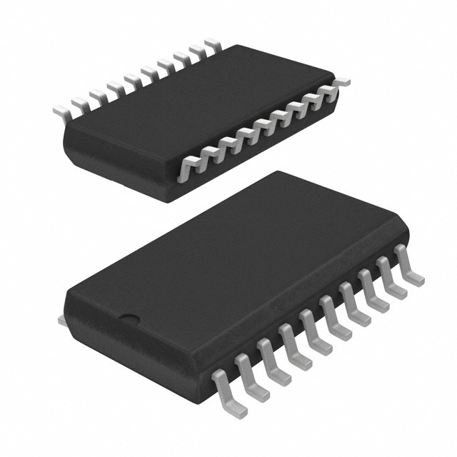

74HC574D
74HC574D
    TOSHIBA(东芝)
    SOIC20
    IC FF D-TYPE SNGL 8BIT 20SOIC
74HC574D 数据手册
74HC574D CMOS Digital Integrated Circuits Silicon Monolithic 74HC574D 1. Functional Description • Octal D-Type Flip Flop with 3-State Outputs 2. General The 74HC574D is a high speed CMOS OCTAL FLIP-FLOP with 3-STATE OUTPUT fabricated with silicon gate C2MOS technology. It achieves the high speed operation similar to equivalent LSTTL while maintaining the CMOS low power dissipation. These 8-bit D-type flip-flops are controlled by a clock input (CK) and an output enable input (OE). When the OE input is high, the eight outputs are in a high impedance state. All inputs are equipped with protection circuits against static discharge or transient excess voltage. 3. Features (1) Wide operating temperature range: Topr = -40 to 125 � (Note 1) (2) High speed: fMAX = 59 MHz (typ.) at VCC = 6.0 V (3) Low power dissipation: ICC = 4.0 µA (max) at Ta = 25 � (4) Balanced propagation delays: tPLH ≈ tPHL (5) Wide operating voltage range: VCC(opr) = 2.0 V to 6.0 V Note 1: Operating Range spec of Topr = -40 � to 125 � is applicable only for the products which manufactured after July 2020. 4. Packaging SOIC20 Start of commercial production 2020-07 ©2016-2020 Toshiba Electronic Devices & Storage Corporation 1 2020-11-17 Rev.3.0 74HC574D 5. Pin Assignment 6. Marking 7. IEC Logic Symbol ©2016-2020 Toshiba Electronic Devices & Storage Corporation 2 2020-11-17 Rev.3.0 74HC574D 8. Truth Table X: Z: Qn: Don't care High impedance No change 9. System Diagram ©2016-2020 Toshiba Electronic Devices & Storage Corporation 3 2020-11-17 Rev.3.0 74HC574D 10. Absolute Maximum Ratings (Note) Characteristics Symbol Note Rating Unit Supply voltage VCC -0.5 to 7.0 V Input voltage VIN -0.5 to VCC + 0.5 V VOUT -0.5 to VCC + 0.5 V IIK ±20 mA Output diode current IOK ±20 mA Output current IOUT ±35 mA VCC/ground current ICC Power dissipation PD Storage temperature Tstg Output voltage Input diode current (Note 1) ±75 mA 500 mW -65 to 150 � Note: Exceeding any of the absolute maximum ratings, even briefly, lead to deterioration in IC performance or even destruction. Using continuously under heavy loads (e.g. the application of high temperature/current/voltage and the significant change in temperature, etc.) may cause this product to decrease in the reliability significantly even if the operating conditions (i.e. operating temperature/current/voltage, etc.) are within the absolute maximum ratings and the operating ranges. Please design the appropriate reliability upon reviewing the Toshiba Semiconductor Reliability Handbook (“Handling Precautions”/“Derating Concept and Methods”) and individual reliability data (i.e. reliability test report and estimated failure rate, etc). Note 1: PD derates linearly with -8 mW/� above 85 � 11. Operating Ranges (Note) Characteristics Supply voltage Input voltage Symbol Note Test Condition Rating Unit VCC 2.0 to 6.0 V VIN 0 to VCC V Output voltage VOUT 0 to VCC V Operating temperature Topr Input rise and fall times tr,tf (Note 1) (Note 1) -40 to 125 � VCC = 2.0 V 0 to 1000 ns VCC = 4.5 V 0 to 500 VCC = 6.0 V 0 to 400 � 0 to 50 µs Note: The operating ranges must be maintained to ensure the normal operation of the device. Unused inputs must be tied to either VCC or GND. Note 1: Operating Range spec of Topr = -40 � to 125 � is applicable only for the products which manufactured after July 2020. ©2016-2020 Toshiba Electronic Devices & Storage Corporation 4 2020-11-17 Rev.3.0 74HC574D 12. Electrical Characteristics 12.1. DC Characteristics (Unless otherwise specified, T a = 25 �) Characteristics High-level input voltage Low-level input voltage High-level output voltage Low-level output voltage Symbol Test Condition VIH � VIL VOH VOL � VIN = VIH or VIL Min Typ. Max Unit 2.0 1.50 � � V 4.5 3.15 � � 6.0 4.20 � � 2.0 � � 0.50 4.5 � � 1.35 6.0 � � 1.80 2.0 1.9 2.0 � 4.5 4.4 4.5 � 6.0 5.9 6.0 � IOH = -6 mA 4.5 4.18 4.31 � IOH = -7.8 mA 6.0 5.68 5.80 � IOL = 20 µA 2.0 � 0.0 0.1 4.5 � 0.0 0.1 IOH = -20 µA VIN = VIH or VIL VCC (V) 6.0 � 0.0 0.1 IOL = 6 mA 4.5 � 0.17 0.26 IOL = 7.8 mA V V V 6.0 � 0.18 0.26 IOZ VIN = VIH or VIL VOUT = VCC or GND 6.0 � � ±0.5 µA Input leakage current IIN VIN = VCC or GND 6.0 � � ±0.1 µA Quiescent supply current ICC VIN = VCC or GND 6.0 � � 4.0 µA 3-state output OFF-state leakage current 12.2. DC Characteristics (Unless otherwise specified, T a = -40 to 85 �) Characteristics High-level input voltage Low-level input voltage High-level output voltage Low-level output voltage 3-state output OFF-state leakage current Symbol VIH VIL VOH VOL Test Condition � � VIN = VIH or VIL VIN = VIH or VIL IOH = -20 µA VCC (V) Min Max Unit 2.0 1.50 � V 4.5 3.15 � 6.0 4.20 � 2.0 � 0.50 4.5 � 1.35 6.0 � 1.80 2.0 1.9 � 4.5 4.4 � V V 6.0 5.9 � IOH = -6 mA 4.5 4.13 � IOH = -7.8 mA 6.0 5.63 � IOL = 20 µA 2.0 � 0.1 4.5 � 0.1 6.0 � 0.1 IOL = 6 mA 4.5 � 0.33 IOL = 7.8 mA 6.0 � 0.33 ±5.0 µA V IOZ VIN = VIH or VIL VOUT = VCC or GND 6.0 � Input leakage current IIN VIN = VCC or GND 6.0 � ±1.0 µA Quiescent supply current ICC VIN = VCC or GND 6.0 � 40.0 µA ©2016-2020 Toshiba Electronic Devices & Storage Corporation 5 2020-11-17 Rev.3.0 74HC574D 12.3. DC Characteristics (Note) (Unless otherwise specified, T a = -40 to 125 �) Characteristics High-level input voltage Low-level input voltage High-level output voltage Low-level output voltage 3-state output OFF-state leakage current Symbol VIH VIL VOH VOL Test Condition � � VIN = VIH or VIL VIN = VIH or VIL IOH = -20 µA VCC (V) Min Max Unit 2.0 1.50 � V 4.5 3.15 � 6.0 4.20 � 2.0 � 0.50 4.5 � 1.35 6.0 � 1.80 2.0 1.9 � 4.5 4.4 � V V 6.0 5.9 � IOH = -6 mA 4.5 3.7 � IOH = -7.8 mA 6.0 5.2 � IOL = 20 µA 2.0 � 0.1 4.5 � 0.1 6.0 � 0.1 IOL = 6 mA 4.5 � 0.4 IOL = 7.8 mA 6.0 � 0.4 ±5.0 µA V IOZ VIN = VIH or VIL VOUT = VCC or GND 6.0 � Input leakage current IIN VIN = VCC or GND 6.0 � ±1.0 µA Quiescent supply current ICC VIN = VCC or GND 6.0 � 80.0 µA Note: Operating Range spec of Topr = -40 � to 125 � is applicable only for the products which manufactured after July 2020. ©2016-2020 Toshiba Electronic Devices & Storage Corporation 6 2020-11-17 Rev.3.0 74HC574D 12.4. Timing Requirements (Unless otherwise specified, T a = 25 �, Input: t r = t f = 6 ns) Characteristics Symbol Test Condition VCC (V) Typ. Limit Unit Minimum pulse width (CK) tw(L),tw(H) � 2.0 � 75 ns 4.5 � 15 6.0 � 13 Minimum setup time (Dn) ts 2.0 � 75 4.5 � 15 6.0 � 13 2.0 � 0 4.5 � 0 6.0 � 0 2.0 � 6 4.5 � 31 6.0 � 36 Minimum hold time (Dn) th Clock frequency f � � � ns ns MHz 12.5. Timing Requirements (Unless otherwise specified, T a = -40 to 85 �, Input: t r = t f = 6 ns) Characteristics Symbol Test Condition VCC (V) Limit Unit Minimum pulse width (CK) tw(L),tw(H) � 2.0 95 ns 4.5 19 6.0 16 Minimum setup time (Dn) ts 2.0 95 4.5 19 6.0 16 2.0 0 4.5 0 6.0 0 2.0 5 4.5 24 6.0 28 Minimum hold time (Dn) th Clock frequency f � � � ns ns MHz 12.6. Timing Requirements (Note) (Unless otherwise specified, T a = -40 to 125 �, Input: t r = t f = 6 ns) Characteristics Minimum pulse width (CK) Symbol Test Condition VCC (V) Limit Unit tw(L),tw(H) � 2.0 108 ns 4.5 22 6.0 18 2.0 108 4.5 22 6.0 18 2.0 0 4.5 0 6.0 0 Minimum setup time (Dn) ts Minimum hold time (Dn) th Clock frequency Note: � � f � 2.0 4 4.5 19 6.0 23 ns ns MHz Operating Range spec of Topr = -40 � to 125 � is applicable only for the products which manufactured after July 2020. ©2016-2020 Toshiba Electronic Devices & Storage Corporation 7 2020-11-17 Rev.3.0 74HC574D 12.7. AC Characteristics (Unless otherwise specified, T a = 25 �, Input: t r = t f = 6 ns) Characteristics Output transition time Propagation delay time (CK-Q) Symbol Note Test Condition CL (pF) tTLH,tTHL � tPLH,tPHL � 50 50 150 Output enable time tPZL,tPZH RL = 1 kΩ 50 150 Output disable time Maximum clock frequency Input capacitance tPLZ,tPHZ RL = 1 kΩ fMAX � CIN Output capacitance COUT Power dissipation capacitance CPD (Note 1) 50 50 VCC (V) Min Typ. Max Unit 2.0 � 25 60 ns 4.5 � 7 12 6.0 � 6 10 2.0 � 70 150 4.5 � 20 30 6.0 � 15 26 2.0 � 88 190 4.5 � 25 38 6.0 � 19 33 2.0 � 48 125 4.5 � 15 25 6.0 � 12 21 2.0 � 60 165 4.5 � 20 33 6.0 � 16 28 2.0 � 34 125 4.5 � 17 25 6.0 � 15 21 2.0 6 17 � 4.5 31 50 � 6.0 ns ns ns MHz 36 59 � � � 5 10 pF � � 10 � pF � � 54 � pF Note 1: CPD is defined as the value of the internal equivalent capacitance which is calculated from the operating current consumption without load. Average operating current can be obtained by the equation. ICC(opr) = CPD × VCC × fIN + ICC/8 (per latch) And the total CPD when n pcs of latch operate can be gained by the following equation. CPD (total) = 39 + 15 × n ©2016-2020 Toshiba Electronic Devices & Storage Corporation 8 2020-11-17 Rev.3.0 74HC574D 12.8. AC Characteristics (Unless otherwise specified, T a = -40 to 85 �, Input: t r = t f = 6 ns) Characteristics Output transition time Propagation delay time (CK-Q) Symbol Test Condition CL (pF) VCC (V) Min Max Unit tTLH,tTHL � 50 2.0 � 75 ns 4.5 � 15 6.0 � 13 2.0 � 190 4.5 � 38 6.0 � 33 2.0 � 240 4.5 � 48 6.0 � 41 2.0 � 155 4.5 � 31 6.0 � 26 2.0 � 205 4.5 � 41 6.0 � 35 2.0 � 155 4.5 � 31 6.0 � 26 2.0 5 � 4.5 24 � 6.0 28 � � 10 tPLH,tPHL � 50 150 Output enable time tPZL,tPZH RL = 1 kΩ 50 150 Output disable time Maximum clock frequency Input capacitance tPLZ,tPHZ fMAX CIN ©2016-2020 Toshiba Electronic Devices & Storage Corporation RL = 1 kΩ � 50 50 � 9 ns ns ns MHz pF 2020-11-17 Rev.3.0 74HC574D 12.9. AC Characteristics (Note) (Unless otherwise specified, T a = -40 to 125 �, Input: t r = t f = 6 ns) Characteristics Output transition time Symbol Test Condition VCC (V) CL (pF) Min Max Unit tTLH,tTHL � 2.0 50 � 85 ns � 17 4.5 6.0 Propagation delay time (CK-Q) tPLH,tPHL � � 15 � 217 4.5 � 43 6.0 � 38 � 273 � 55 2.0 2.0 50 150 4.5 6.0 Output enable time tPZL,tPZH RL = 1 kΩ � 46 � 175 4.5 � 35 6.0 � 29 � 232 � 46 2.0 2.0 50 150 4.5 6.0 Output disable time Maximum clock frequency Input capacitance Note: tPLZ,tPHZ fMAX CIN RL = 1 kΩ � � 40 � 175 4.5 � 35 6.0 � 29 2.0 2.0 � 50 4 � 4.5 50 19 � 6.0 23 � � 10 ns ns ns MHz pF Operating Range spec of Topr = -40 � to 125 � is applicable only for the products which manufactured after July 2020. ©2016-2020 Toshiba Electronic Devices & Storage Corporation 10 2020-11-17 Rev.3.0 74HC574D Package Dimensions Unit: mm Weight: 0.51 g (typ.) Package Name(s) Nickname: SOIC20 ©2016-2020 Toshiba Electronic Devices & Storage Corporation 11 2020-11-17 Rev.3.0 74HC574D RESTRICTIONS ON PRODUCT USE Toshiba Corporation and its subsidiaries and affiliates are collectively referred to as "TOSHIBA". Hardware, software and systems described in this document are collectively referred to as "Product". • TOSHIBA reserves the right to make changes to the information in this document and related Product without notice. • This document and any information herein may not be reproduced without prior written permission from TOSHIBA. Even with TOSHIBA's written permission, reproduction is permissible only if reproduction is without alteration/omission. • Though TOSHIBA works continually to improve Product's quality and reliability, Product can malfunction or fail. Customers are responsible for complying with safety standards and for providing adequate designs and safeguards for their hardware, software and systems which minimize risk and avoid situations in which a malfunction or failure of Product could cause loss of human life, bodily injury or damage to property, including data loss or corruption. Before customers use the Product, create designs including the Product, or incorporate the Product into their own applications, customers must also refer to and comply with (a) the latest versions of all relevant TOSHIBA information, including without limitation, this document, the specifications, the data sheets and application notes for Product and the precautions and conditions set forth in the "TOSHIBA Semiconductor Reliability Handbook" and (b) the instructions for the application with which the Product will be used with or for. Customers are solely responsible for all aspects of their own product design or applications, including but not limited to (a) determining the appropriateness of the use of this Product in such design or applications; (b) evaluating and determining the applicability of any information contained in this document, or in charts, diagrams, programs, algorithms, sample application circuits, or any other referenced documents; and (c) validating all operating parameters for such designs and applications. TOSHIBA ASSUMES NO LIABILITY FOR CUSTOMERS' PRODUCT DESIGN OR APPLICATIONS. • PRODUCT IS NEITHER INTENDED NOR WARRANTED FOR USE IN EQUIPMENTS OR SYSTEMS THAT REQUIRE EXTRAORDINARILY HIGH LEVELS OF QUALITY AND/OR RELIABILITY, AND/OR A MALFUNCTION OR FAILURE OF WHICH MAY CAUSE LOSS OF HUMAN LIFE, BODILY INJURY, SERIOUS PROPERTY DAMAGE AND/OR SERIOUS PUBLIC IMPACT ("UNINTENDED USE"). Except for specific applications as expressly stated in this document, Unintended Use includes, without limitation, equipment used in nuclear facilities, equipment used in the aerospace industry, lifesaving and/or life supporting medical equipment, equipment used for automobiles, trains, ships and other transportation, traffic signaling equipment, equipment used to control combustions or explosions, safety devices, elevators and escalators, and devices related to power plant. IF YOU USE PRODUCT FOR UNINTENDED USE, TOSHIBA ASSUMES NO LIABILITY FOR PRODUCT. For details, please contact your TOSHIBA sales representative or contact us via our website. • Do not disassemble, analyze, reverse-engineer, alter, modify, translate or copy Product, whether in whole or in part. • Product shall not be used for or incorporated into any products or systems whose manufacture, use, or sale is prohibited under any applicable laws or regulations. • The information contained herein is presented only as guidance for Product use. No responsibility is assumed by TOSHIBA for any infringement of patents or any other intellectual property rights of third parties that may result from the use of Product. No license to any intellectual property right is granted by this document, whether express or implied, by estoppel or otherwise. • ABSENT A WRITTEN SIGNED AGREEMENT, EXCEPT AS PROVIDED IN THE RELEVANT TERMS AND CONDITIONS OF SALE FOR PRODUCT, AND TO THE MAXIMUM EXTENT ALLOWABLE BY LAW, TOSHIBA (1) ASSUMES NO LIABILITY WHATSOEVER, INCLUDING WITHOUT LIMITATION, INDIRECT, CONSEQUENTIAL, SPECIAL, OR INCIDENTAL DAMAGES OR LOSS, INCLUDING WITHOUT LIMITATION, LOSS OF PROFITS, LOSS OF OPPORTUNITIES, BUSINESS INTERRUPTION AND LOSS OF DATA, AND (2) DISCLAIMS ANY AND ALL EXPRESS OR IMPLIED WARRANTIES AND CONDITIONS RELATED TO SALE, USE OF PRODUCT, OR INFORMATION, INCLUDING WARRANTIES OR CONDITIONS OF MERCHANTABILITY, FITNESS FOR A PARTICULAR PURPOSE, ACCURACY OF INFORMATION, OR NONINFRINGEMENT. • Do not use or otherwise make available Product or related software or technology for any military purposes, including without limitation, for the design, development, use, stockpiling or manufacturing of nuclear, chemical, or biological weapons or missile technology products (mass destruction weapons). Product and related software and technology may be controlled under the applicable export laws and regulations including, without limitation, the Japanese Foreign Exchange and Foreign Trade Law and the U.S. Export Administration Regulations. Export and re-export of Product or related software or technology are strictly prohibited except in compliance with all applicable export laws and regulations. • Please contact your TOSHIBA sales representative for details as to environmental matters such as the RoHS compatibility of Product. Please use Product in compliance with all applicable laws and regulations that regulate the inclusion or use of controlled substances, including without limitation, the EU RoHS Directive. TOSHIBA ASSUMES NO LIABILITY FOR DAMAGES OR LOSSES OCCURRING AS A RESULT OF NONCOMPLIANCE WITH APPLICABLE LAWS AND REGULATIONS. https://toshiba.semicon-storage.com/ ©2016-2020 Toshiba Electronic Devices & Storage Corporation 12 2020-11-17 Rev.3.0
