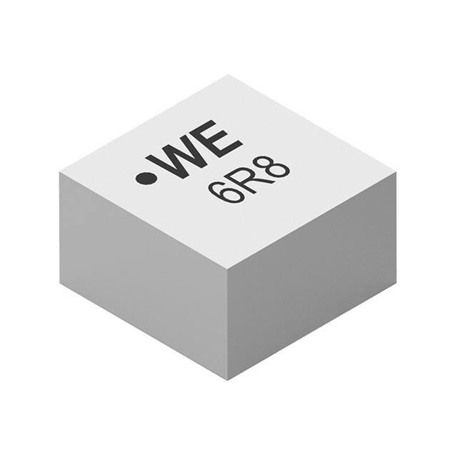

    6.8 µH 屏蔽 电感器 4.3 A 48.3 毫欧最大 非标准
78438367068 数据手册
Dimensions: [mm] Recommended Land Pattern: [mm] Electrical Properties: Properties Solder resist Inductance L IR,40K 5,6 Rated Current Test conditions Value Unit Tol. 100 kHz/ 10 mA 6.8 µH ±20% ΔT = 40K 5.3 A max. Saturation Current @ 10% ISAT, 10% |ΔL/L| < 10 % 3.7 A typ. Saturation Current @ 30% ISAT,30% |ΔL/L| < 30 % 7.7 A typ. mΩ typ. DC Resistance RDC @ 20 °C 42 DC Resistance RDC @ 20 °C 48.3 mΩ max. Self Resonant Frequency fres 15.5 MHz typ. 1,6 ±0,2 Certification: 2,2 5,4 ±0,2 1,7 no vias and traces in restricted area 3,1 max. Scale - 5:1 Schematic: RoHS Approval Compliant [2011/65/EU&2015/863] REACh Approval Conform or declared [(EC)1907/2006] Halogen Free Conform [JEDEC JS709B] Halogen Free Conform [IEC 61249-2-21] Automotive Approval Released Component Qualification AEC-Q200 Grade 1 5,4 ±0,2 General Properties: Ambient Temperature (referring to IR) -40 up to +85 °C Operating Temperature -40 up to +125 °C Storage Conditions (in original packaging) < 40 °C ; < 75 % RH Moisture Sensitivity Level (MSL) 1 Test conditions of Electrical Properties: +20 °C, 33 % RH if not specified differently Test conditions of Rated Current: refer to IEC 62024-2-2020, Class C (PCB Copper Width: 40 mm; PCB Copper Thickness: 105 µm) Scale - 5:1 Product Marking: Start of Winding Marking • 6R8 (Inductance Code) CHECKED REVISION DATE (YYYY-MM-DD) GENERAL TOLERANCE AdGa 002.000 2023-12-30 DIN ISO 2768-1m PROJECTION METHOD DESCRIPTION WE-MAIA SMT Power Inductor Würth Elektronik eiSos GmbH & Co. KG EMC & Inductive Solutions Max-Eyth-Str. 1 74638 Waldenburg Germany Tel. +49 (0) 79 42 945 - 0 www.we-online.com eiSos@we-online.com ORDER CODE 78438367068 SIZE/TYPE BUSINESS UNIT STATUS PAGE 5030 eiSos Valid 1/9 This electronic component has been designed and developed for usage in general electronic equipment only. This product is not authorized for use in equipment where a higher safety standard and reliability standard is especially required or where a failure of the product is reasonably expected to cause severe personal injury or death, unless the parties have executed an agreement specifically governing such use. Moreover Würth Elektronik eiSos GmbH & Co KG products are neither designed nor intended for use in areas such as military, aerospace, aviation, nuclear control, submarine, transportation, transportation signal, disaster prevention, medical, public information network etc.. Würth Elektronik eiSos GmbH & Co KG must be informed about the intent of such usage before the design-in stage. In addition, sufficient reliability evaluation checks for safety must be performed on every electronic component which is used in electrical circuits that require high safety and reliability functions or performance. Typical Temperature Rise vs. Current Characteristics: Typical Inductance vs. Frequency Characteristics: 8 100 7 90 80 6 Inductance [µH] Temperature Rise [K] 70 60 50 40 5 4 3 30 2 20 1 10 0 0 0 2 4 6 Current [A] 8 10 0 2 4 6 8 10 Current [A] CHECKED REVISION DATE (YYYY-MM-DD) GENERAL TOLERANCE AdGa 002.000 2023-12-30 DIN ISO 2768-1m PROJECTION METHOD DESCRIPTION WE-MAIA SMT Power Inductor Würth Elektronik eiSos GmbH & Co. KG EMC & Inductive Solutions Max-Eyth-Str. 1 74638 Waldenburg Germany Tel. +49 (0) 79 42 945 - 0 www.we-online.com eiSos@we-online.com ORDER CODE 78438367068 SIZE/TYPE BUSINESS UNIT STATUS PAGE 5030 eiSos Valid 2/9 This electronic component has been designed and developed for usage in general electronic equipment only. This product is not authorized for use in equipment where a higher safety standard and reliability standard is especially required or where a failure of the product is reasonably expected to cause severe personal injury or death, unless the parties have executed an agreement specifically governing such use. Moreover Würth Elektronik eiSos GmbH & Co KG products are neither designed nor intended for use in areas such as military, aerospace, aviation, nuclear control, submarine, transportation, transportation signal, disaster prevention, medical, public information network etc.. Würth Elektronik eiSos GmbH & Co KG must be informed about the intent of such usage before the design-in stage. In addition, sufficient reliability evaluation checks for safety must be performed on every electronic component which is used in electrical circuits that require high safety and reliability functions or performance. Typical Impedance Characteristics: 10000 Impedance [Ω] 1000 100 10 1 0.01 0.1 1 Frequency [MHz] 10 100 Z CHECKED REVISION DATE (YYYY-MM-DD) GENERAL TOLERANCE AdGa 002.000 2023-12-30 DIN ISO 2768-1m PROJECTION METHOD DESCRIPTION WE-MAIA SMT Power Inductor Würth Elektronik eiSos GmbH & Co. KG EMC & Inductive Solutions Max-Eyth-Str. 1 74638 Waldenburg Germany Tel. +49 (0) 79 42 945 - 0 www.we-online.com eiSos@we-online.com ORDER CODE 78438367068 SIZE/TYPE BUSINESS UNIT STATUS PAGE 5030 eiSos Valid 3/9 This electronic component has been designed and developed for usage in general electronic equipment only. This product is not authorized for use in equipment where a higher safety standard and reliability standard is especially required or where a failure of the product is reasonably expected to cause severe personal injury or death, unless the parties have executed an agreement specifically governing such use. Moreover Würth Elektronik eiSos GmbH & Co KG products are neither designed nor intended for use in areas such as military, aerospace, aviation, nuclear control, submarine, transportation, transportation signal, disaster prevention, medical, public information network etc.. Würth Elektronik eiSos GmbH & Co KG must be informed about the intent of such usage before the design-in stage. In addition, sufficient reliability evaluation checks for safety must be performed on every electronic component which is used in electrical circuits that require high safety and reliability functions or performance. Packaging Specification - Tape and Reel: [mm] P0 A P2 T E1 D0 W3 K0 W1 close to center A W F E2 B0 C Top Cover Tape D1 A N D B P1 W2 T1 A0 T2 End Start Feeding direction detail B B Carrier Tape Cover Tape Cover Tape Chip Cavity Sprocket Hole No Component min.160mm Component No Component min.100mm Cover Tape min.400mm Embossment Packaging is referred to the international standard IEC 60286-3:2019 Tape Type Tolerance Value 2a A0 (mm) typ. 5,90 B0 (mm) typ. 5,90 W (mm) +0,3/ -0,3 12,00 T (mm) ref. 0,30 T1 (mm) ref. 0,10 T2 (mm) typ. 3,50 K0 (mm) typ. 3,30 P0 (mm) ±0,1 4,00 P1 (mm) ±0,1 8,00 P2 (mm) ±0,05 2,00 D0 (mm) +0,1/ -0,0 1,50 D1 (mm) min. 1,50 E1 (mm) ±0,1 1,75 E2 (mm) min. 10,25 F (mm) ±0,1 5,50 Material Qty. (pcs.) Polystyrene 700 165° - 180° Tolerance Value A (mm) + 0,0/-3,0 180,00 B (mm) min. 1,50 C (mm) ±0,2 13,00 D (mm) min. 20,20 N (mm) + 1,0/-0,0 60,00 W1 (mm) + 2,0 12,40 CHECKED REVISION DATE (YYYY-MM-DD) GENERAL TOLERANCE AdGa 002.000 2023-12-30 DIN ISO 2768-1m W2 (mm) max. 18,40 W3 (mm) ±0,5 13,00 W3 (mm) max. 13,50 Material Polystyrene PROJECTION METHOD DESCRIPTION WE-MAIA SMT Power Inductor Pull-off force Tape width 12 mm 0,1 N - 1,3 N Würth Elektronik eiSos GmbH & Co. KG EMC & Inductive Solutions Max-Eyth-Str. 1 74638 Waldenburg Germany Tel. +49 (0) 79 42 945 - 0 www.we-online.com eiSos@we-online.com ORDER CODE 78438367068 SIZE/TYPE BUSINESS UNIT STATUS PAGE 5030 eiSos Valid 4/9 This electronic component has been designed and developed for usage in general electronic equipment only. This product is not authorized for use in equipment where a higher safety standard and reliability standard is especially required or where a failure of the product is reasonably expected to cause severe personal injury or death, unless the parties have executed an agreement specifically governing such use. Moreover Würth Elektronik eiSos GmbH & Co KG products are neither designed nor intended for use in areas such as military, aerospace, aviation, nuclear control, submarine, transportation, transportation signal, disaster prevention, medical, public information network etc.. Würth Elektronik eiSos GmbH & Co KG must be informed about the intent of such usage before the design-in stage. In addition, sufficient reliability evaluation checks for safety must be performed on every electronic component which is used in electrical circuits that require high safety and reliability functions or performance. Packaging Specification - Outer Carton: [mm] H C H IC Packaging Specification - Reel in Carton: [mm] W W L L C IC C IC Tolerance Value LIC (mm) typ. 185,00 WIC (mm) typ. 140,00 HIC (mm) typ. 190,00 No. of Reel (pcs.) 6 Qty. (pcs.) 4200 Material Paper Tolerance Value LC (mm) typ. 390,00 WC (mm) typ. 295,00 HC (mm) typ. 215,00 No. of Inner Carton (pcs.) Qty. (pcs.) Material 4 16800 Paper CHECKED REVISION DATE (YYYY-MM-DD) GENERAL TOLERANCE AdGa 002.000 2023-12-30 DIN ISO 2768-1m PROJECTION METHOD DESCRIPTION WE-MAIA SMT Power Inductor Würth Elektronik eiSos GmbH & Co. KG EMC & Inductive Solutions Max-Eyth-Str. 1 74638 Waldenburg Germany Tel. +49 (0) 79 42 945 - 0 www.we-online.com eiSos@we-online.com ORDER CODE 78438367068 SIZE/TYPE BUSINESS UNIT STATUS PAGE 5030 eiSos Valid 5/9 This electronic component has been designed and developed for usage in general electronic equipment only. This product is not authorized for use in equipment where a higher safety standard and reliability standard is especially required or where a failure of the product is reasonably expected to cause severe personal injury or death, unless the parties have executed an agreement specifically governing such use. Moreover Würth Elektronik eiSos GmbH & Co KG products are neither designed nor intended for use in areas such as military, aerospace, aviation, nuclear control, submarine, transportation, transportation signal, disaster prevention, medical, public information network etc.. Würth Elektronik eiSos GmbH & Co KG must be informed about the intent of such usage before the design-in stage. In addition, sufficient reliability evaluation checks for safety must be performed on every electronic component which is used in electrical circuits that require high safety and reliability functions or performance. Classification Reflow Profile for SMT components: Classification Reflow Soldering Profile: Profile Feature Tp tp Max. Ramp Up Rate Max. Ramp Down Rate TL Temperature Ts max tL Preheat Area Ts min TC –5°C Value Preheat Temperature Min Ts min 150 °C Preheat Temperature Max Ts max 200 °C Preheat Time ts from Ts min to Ts max ts Ramp-up Rate (TL to TP) 60 - 120 seconds 3 °C/ second max. Liquidous Temperature TL 217 °C Time tL maintained above TL tL 60 - 150 seconds Peak package body temperature Tp Tp ≤ Tc, see Table below Time within 5°C of actual peak temperature tp 20 - 30 seconds Ramp-down Rate (TP to TL) 6 °C/ second max. Time 25°C to peak temperature 8 minutes max. refer to IPC/ JEDEC J-STD-020E Make sure that you use the correct thickness of solder paste to avoid an insufficient soldering result. We recommend 100µm solder paste as a reference. tS Package Classification Reflow Temperature (Tc): 25 Volume mm³ 350-2000 Volume mm³ >2000 PB-Free Assembly | Package Thickness 260 °C < 1.6 mm 260 °C 260 °C PB-Free Assembly | Package Thickness 260 °C 1.6 mm - 2.5 mm 250 °C 245 °C PB-Free Assembly | Package Thickness 250 °C > 2.5 mm 245 °C 245 °C Properties Time 25°C to Peak Time Volume mm³
