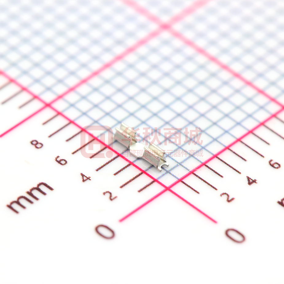

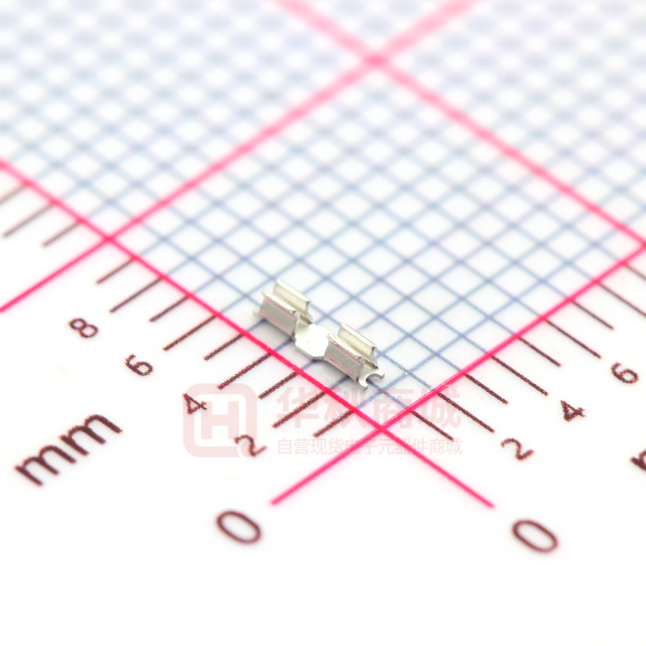

    夹子/挂钩 3.9x1mm EMI 3.90 x 1.00mm
ICSRC3910SFR 数据手册
REV 0,15 A B 1,15 0,25 0,8 C P.K.KO SHIELD CASE THICKNESS 0.2±0.02 => 0.2 +0.02 -0 P.K.KOH 2 ±0.05 ,5 O1 +0.1 0 0,3 12 5,34 1,35 4 ±0.1 NOTES 1. MATERIAL : SUS301 2. MATERIAL THICKNESS :0.15t 3. FINISHED : Sn(100%) PLATING ON BOTH SIDE ( Ni 0.5㎛ Sn 1.27㎛ ) 4. PACKING MATERIALS. - REEL : HIPS 0.3t - COVER TAPE : PS _ Q'TY/REEL : 10,000ea 5. AVAILABLE SHIELD CASE THICKNESS : 0.2 +0.02 -0 6. CONTACT RESISTANCE 300mmΩ MAX 7. INTENTION FORCE/RETENTION FORCE SPEC INTENTION FORCE RETENTION FORCE SPEC MAX 1.3Kg MIN 0.5Kg 1 SCALE : 20 / 1 1 0,63 0,72 +0.1 -0.05 0,15 +0.02 -0.05 2012.03.30 APPROVED P.K.KO 1,1 3,9 0,9 2,25 1,75 ±0.1 TAPING사사사 (SCALE 3/1 ) REVISION HISTORY DESCRIPTION DATE 신신제제 2009,06,05 인인부 공공 변경 0.72 +0.1 -0.05 2012,2.17 1,5 1,1 4,1 RECOMMENDED PCB LAYOUT 9. Maintain 90˚±3 while engage & disengage shield can & shield clip to prevent deformation & to maintain retention force of shield clip 0,8 1,1 0,9 8. STENCIL THICKNESS : 0.12T 1,3 1,2 1,3 REECOMMENDED STENCIL LAY-OUT 0.1T UNLESS OTHERWISE SPECIFIED DIMENSIONS ARE IN MILLIMETERS TOLERANCES ARE ANGLES ± 0. 3° 0 ~ 1 ± 0.05 1 ~ 5 ± 0.1 5 ~ 10 ± 0.15 TITLE SIZE DWG NO SHLED CLIP A3 ICSRC3910SFR FILE NAME: ICSRC3910SFR.dft SCALE: WEIGHT: SHEET 1 OF 1 REV C
