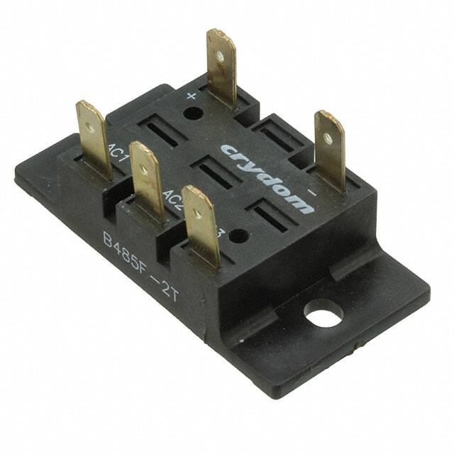

    BRIDGE RECT 1PHASE 1.2KV 50A
B485F-2T 数据手册
B48-2T, B48-2 | SERIES POWER MODULES Features •  •  •  •  Single and Three Phase Circuits 5 Different Circuits to Choose from Up to 1600 Volt Blocking Standard UL Recognized E72445 ELECTRICAL SPECIFICATIONS Symbol Single Phase Three Phase Maximum DC Output Current (Tc = 85°C) ID 35A 50A Maximum Voltage Drop @ Amps Peak VF 1.25V @ 35A 1.35V @ 50A Operating Junction Temperature Range TJ -40 - 125°C -40 - 125°C 400 (120 VAC) 600 (240 VAC) Repetitive Peak Reverse Voltage (AC Line Nominal) [Vpk] V RMS 800 (280 VAC) 1200 (480 VAC) 1400 (530 VAC) 1600 (600 VAC) Maximum Non-Repetitive Surge Current (1/2 Cycle, 60 Hz) ITSM 600 600 Maximum I²T for Fusing (t=8.3ms) [A²sec] 2 IT 1500 1500 Maximum Thermal Resistance, Junction to Ceramic Base per Chip [°C/W] R JC 0.9°C/W 0.9°C/W Isolation Voltage [Vrms] VISOL 2500 GENERAL SPECIFICATIONS Description Parameters Weight (typical) 1.5 oz (42.5g) Page 1 Copyright © 2018 Sensata Technologies, Inc. www.sensata.com CIRCUIT DIAGRAMS B48-2T B48-2 B48-2T 1 3 2 4 B48-2 5 MECHANICAL SPECIFICATIONS *Tolerances: ±0.02 in / 0.5 mm All dimensions are in: inches [millimeters] B48-2T 2.50 (63.5) 1.90 (48.2) MOUNTING HOLE/SLOT 0.21 (5.2) DIA. B48-2 2.50 (63.5) 1.90 (48.2) MOUNTING HOLE/SLOT 0.21 (5.2) DIA. 1.00 1.25 [25.4] [31.7] .50 [12.9] 1.06 [26.9] .25 TERMINAL (6.3) .25 TERMINAL (6.3) .10 [2.5] .10 [2.5] .78 [19.7] .55 [14.0] Page 2 Copyright © 2018 Sensata Technologies, Inc. www.sensata.com Example : B482B-2T AVAILABLE OPTIONS Note: Not all combinations available B48 2 B -2T Series* B48 Circuit Type* 1 2 3 4 5 (see schematic diagrams) AC Line Voltage* B: 400 (120VAC) C: 600 (240VAC) E: 1000 (380VAC) F: 1200 (480VAC) G: 1400 (530VAC) H: 1600 (600VAC) Case Study* -2T: Standard -2: With Isolation Barriers *Required for valid part number **For options only and not required for valid part number Page 3 Copyright © 2018 Sensata Technologies, Inc. www.sensata.com AGENCY APPROVALS & CERTIFICATIONS E72445 WARNINGS RISK OF MATERIAL DAMAGE AND HOT ENCLOSURE • The product’s side panels may be hot, allow the product to cool before touching • Follow proper mounting instructions including torque values • Do not allow liquids or foreign objects to enter this product Failure to follow these instructions can result in serious injury, or equipment damage. HAZARD OF ELECTRIC SHOCK, EXPLOSION OR ARC FLASH • Disconnect all power before installing or working with this equipment • Verify all connections and replace all covers before turning on power Failure to follow these instructions will result in death or serious injury. Page 4 Sensata Technologies, Inc. (“Sensata”) data sheets are solely intended to assist designers (“Buyers”) who are developing systems that incorporate Sensata products (also referred to herein as “components”). Buyer understands and agrees that Buyer remains responsible for using its independent analysis, evaluation and judgment in designing Buyer’s systems and products. Sensata data sheets have been created using standard laboratory conditions and engineering practices. Sensata has not conducted any testing other than that specifically described in the published documentation for a particular data sheet. Sensata may make corrections, enhancements, improvements and other changes to its data sheets or components without notice. Buyers are authorized to use Sensata data sheets with the Sensata component(s) identified in each particular data sheet. HOWEVER, NO OTHER LICENSE, EXPRESS OR IMPLIED, BY ESTOPPEL OR OTHERWISE TO ANY OTHER SENSATA INTELLECTUAL PROPERTY RIGHT, AND NO LICENSE TO ANY THIRD PARTY TECHNOLOGY OR INTELLECTUAL PROPERTY RIGHT, IS GRANTED HEREIN. SENSATA DATA SHEETS ARE PROVIDED “AS IS”. SENSATA MAKES NO WARRANTIES OR REPRESENTATIONS WITH REGARD TO THE DATA SHEETS OR USE OF THE DATA SHEETS, EXPRESS, IMPLIED OR STATUTORY, INCLUDING ACCURACY OR COMPLETENESS. SENSATA DISCLAIMS ANY WARRANTY OF TITLE AND ANY IMPLIED WARRANTIES OF MERCHANTABILITY, FITNESS FOR A PARTICULAR PURPOSE, QUIET ENJOYMENT, QUIET POSSESSION, AND NON-INFRINGEMENT OF ANY THIRD PARTY INTELLECTUAL PROPERTY RIGHTS WITH REGARD TO SENSATA DATA SHEETS OR USE THEREOF. All products are sold subject to Sensata’s terms and conditions of sale supplied at www.sensata.com SENSATA ASSUMES NO LIABILITY FOR APPLICATIONS ASSISTANCE OR THE DESIGN OF BUYERS’ PRODUCTS. BUYER ACKNOWLEDGES AND AGREES THAT IT IS SOLELY RESPONSIBLE FOR COMPLIANCE WITH ALL LEGAL, REGULATORY AND SAFETY-RELATED REQUIREMENTS CONCERNING ITS PRODUCTS, AND ANY USE OF SENSATA COMPONENTS IN ITS APPLICATIONS, NOTWITHSTANDING ANY APPLICATIONS-RELATED INFORMATION OR SUPPORT THAT MAY BE PROVIDED BY SENSATA. Mailing Address: Sensata Technologies, Inc., 529 Pleasant Street, Attleboro, MA 02703, USA. Copyright © 2018 Sensata Technologies, Inc. Rev. 03/29/18 ECN 20395 FDE-07-01 Rev. B CONTACT US Americas +1 (877) 502 5500 sales.crydom@sensata.com Europe, Middle East & Africa +44 (1202) 416170 ssr-info.eu@sensata.com Asia Pacific sales.isasia@list.sensata.com China +86 (21) 2306 1500 Japan +81 (45) 277 7117 Korea +82 (31) 601 2004 India +91 (80) 67920890 Rest of Asia +886 (2) 27602006 ext 2808 www.sensata.com
