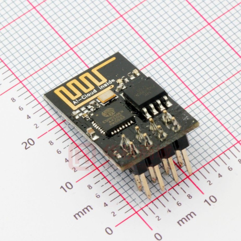

    WiFi及蓝牙模块 DIP-8 3~3.6V Onboard Antenna
ESP-01 数据手册
ESP-01 802.11 b/g/n Wi-Fi V1.2 ink er ESP-01 802.11 b/g/n Wi-Fi 2.54mm±0.05mm 6mm±0.2mm 0.64mm±0.01mm - 802.11b/g/n Wi-Fi SOC ESP-01 -T h - 32 CPU 160MHz ESP-01 - DIP-8 Wi-Fi MAC/ BB/RF/PA/LNA , - 1.0 mW lwIP ESP-01 STA/AP/STA+AP DIP Smart Config/AirKiss 4Mbps Ai - UART/GPIO AT FOTA Copyright © 2017 Shenzhen Ai-Thinker Technology Co., Ltd All Rights Reserved 2 ESP-01 DIP-8 V1.2 ink er ESP-01 802.11 b/g/n Wi-Fi 24.7*14.4*11.0 ±0.2 mm SPI Flash 8Mbit UART/GPIO IO 2 300 ~ 4608000 bps 115200 bps 2412 ~ 2484MHz PCB , 2dBi 802.11b: 16±2 dBm (@11Mbps) 802.11g: 14±2 dBm (@54Mbps) 802.11n: 13±2 dBm (@HT20, MCS7) -T h CCK, 1 Mbps : -90dBm CCK, 11 Mbps: -85dBm 6 Mbps (1/2 BPSK): -88dBm 54 Mbps (3/4 64-QAM): -70dBm HT20, MCS7 (65 Mbps, 72.2 Mbps): -67dBm => ~71mA Modem Sleep: ~20mA Light Sleep: ~2mA Deep Sleep: ~0.02mA 300mA WEP/WPA-PSK/WPA2-PSK 3.0V ~ 3.6V -20 ~ 85 -40 ~ 90 >300mA , < 90%RH Ai 0.65g www.ai-thinker.com C2 6 0755-29162996 Copyright © 2017 Shenzhen Ai-Thinker Technology Co., Ltd All Rights Reserved support@aithinker.com 2
