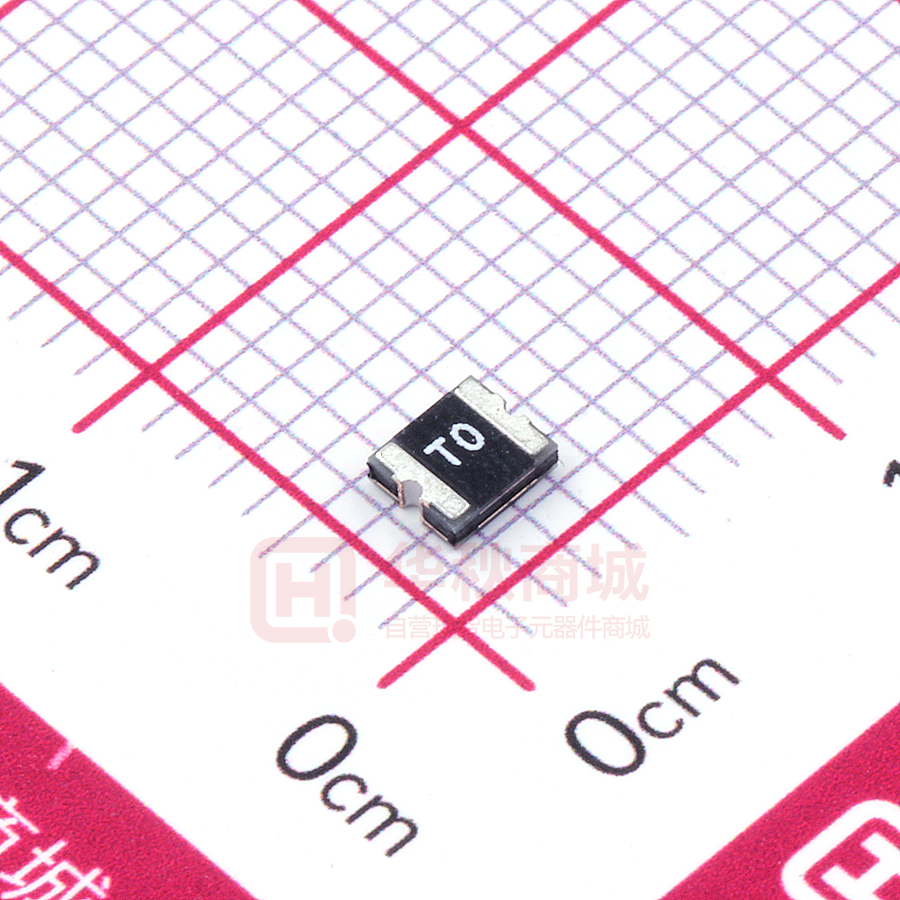

    PTC自恢复保险丝 FUSE1210 Vmax=30V Ih=0.05A
TLC-USMD005 数据手册
Revision: A Date: 2018-04-24 Page No.: 1 OF 1 PPTC RESETTALBE 电路保护元器件专业制造商 FUSES USMD1210 Series Features ◆ Surface Mount Devices ◆ Standard 1210mils footprint ◆ Surface mount packaging for automated assembly ◆ Compatible with Pb and Pb-free solder reflow profiles. ◆ UL(E352136), C-UL(E352136), TUV(R50306076) ◆ RoHS, Reach, HF compliance Applications ◆ Mobile phones ◆ PC motherboards ◆ IEEE1394 ports ◆ USB port protection ◆ HDMI source protection ◆ Game console port protection 电气特性 : 保持电流 跳脱电流 最大电压 最大电流 最大动作时间 IH, (A) IT, (A) V max, (V) I max, (A) (A) TLC-USMD005 0.05 0.15 30 10 TLC-USMD010 0.10 0.30 30 10 TLC-USMD020 0.20 0.40 30 10 8.00 P/N 消耗功率 (Sec.) Pd typ, (W) 0.25 1.50 0.50 0.60 电阻范围(Ω) R min, R1 max, 0.60 2.80 50.00 0.60 0.80 15.00 0.02 0.60 0.40 5.00 TLC-USMD035 0.35 0.75 6 40 8.00 0.20 0.60 0.20 1.30 TLC-USMD050 0.50 1.00 13.2 40 8.00 0.10 0.60 0.18 0.90 TLC-USMD075 0.75 1.50 6 40 8.00 0.10 0.60 0.07 0.45 TLC-USMD110 1.10 2.20 6 40 8.00 0.30 0.60 0.05 0.24 TLC-USMD150 1.50 3.00 6 40 8.00 0.50 0.60 0.03 0.11 TLC-USMD175 1.75 4.00 6 40 8.00 1.00 0.70 0.02 0.09 TLC-USMD200 2.00 4.00 6 40 8.00 1.00 0.70 0.02 0.09 产品尺寸 (Unit: mm) : Top and Bottom View Side View A T02 C B D T 02 Manufacturer's Trademark Part Identification P/N A B C D Marking (标识) Min. Max. Min. Max. Min. Max. Min. TLC-USMD005 T0 3.00 3.43 2.35 2.80 0.80 1.20 0.30 TLC-USMD010 T01 3.00 3.43 2.35 2.80 0.80 1.20 0.30 TLC-USMD020 T02 3.00 3.43 2.35 2.80 0.80 1.20 0.30 TLC-USMD035 T03 3.00 3.43 2.35 2.80 0.60 1.00 0.30 TLC-USMD050 T05 3.00 3.43 2.35 2.80 0.60 1.00 0.30 TLC-USMD075 T07 3.00 3.43 2.35 2.80 0.60 1.00 0.30 TLC-USMD110 T11 3.00 3.43 2.35 2.80 0.45 0.85 0.30 TLC-USMD150 T15 3.00 3.43 2.35 2.80 0.60 1.00 0.30 TLC-USMD175 T20 3.00 3.43 2.35 2.80 0.60 1.00 0.30 TLC-USMD200 T20 3.00 3.43 2.35 2.80 0.60 1.00 0.30 TEL: 86-0769-3892 0554 FAX: 86-0769-8793 2077 E-mail:sales@tlcet.com.cn Address:No.18,5th GaoLi Road,TangXia Town,DongGuan,GuangDong,P.R China 523710 Revision: A Date: 2018-04-24 Page No.: 1 OF 2 PPTC RESETTALBE 电路保护元器件专业制造商 FUSES USMD1210 Series 环境温度与工作电流关系特性曲线 : P/N 工作环境温度 -40℃ -20℃ 0℃ 25℃ 40℃ 50℃ 60℃ 70℃ 85℃ TLC-USMD005 0.08 0.07 0.06 0.05 0.04 0.04 0.03 0.03 0.02 TLC-USMD010 0.15 0.13 0.12 0.10 0.09 0.08 0.07 0.06 0.05 TLC-USMD020 0.32 0.28 0.24 0.20 0.18 0.16 0.14 0.12 0.10 TLC-USMD035 0.51 0.46 0.40 0.35 0.30 0.27 0.24 0.22 0.18 TLC-USMD050 0.76 0.66 0.58 0.50 0.42 0.38 0.35 0.29 0.23 TLC-USMD075 1.10 0.97 0.86 0.75 0.64 0.58 0.55 0.47 0.39 TLC-USMD110 1.60 1.42 1.26 1.10 0.94 0.86 0.80 0.70 0.58 TLC-USMD150 2.30 2.02 1.76 1.50 1.24 1.11 1.00 0.85 0.65 TLC-USMD175 2.55 2.26 2.00 1.75 1.50 1.37 0.98 0.86 0.71 TLC-USMD200 3.20 2.80 2.40 2.00 1.80 1.60 1.40 1.20 1.00 动作电流时间曲线表 : The Time to Trip curves represent typical performance of a device in a simulated application environment. Actual performance in specific customer applications may differ from these values due to the influence of other variables. 标准包装数量 : Model Q’t y/Reel TLC-USMD005~TLC-USMD020; TLC-USMD150~TLC-USMD200 3500pcs TLC-USMD035~TLC-USMD110 4000pcs Note: Reel packaging per EIA-481-1 standard 6、Agency Recognition: Caution:Operation beyond the rated voltage or current may result in rupture electrical arcing or flame.Specifications are subject to change without notice. TEL: 86-0769-3892 0554 FAX: 86-0769-8793 2077 E-mail:sales@tlcet.com.cn Address:No.18,5th GaoLi Road,TangXia Town,DongGuan,GuangDong,P.R China 523710
