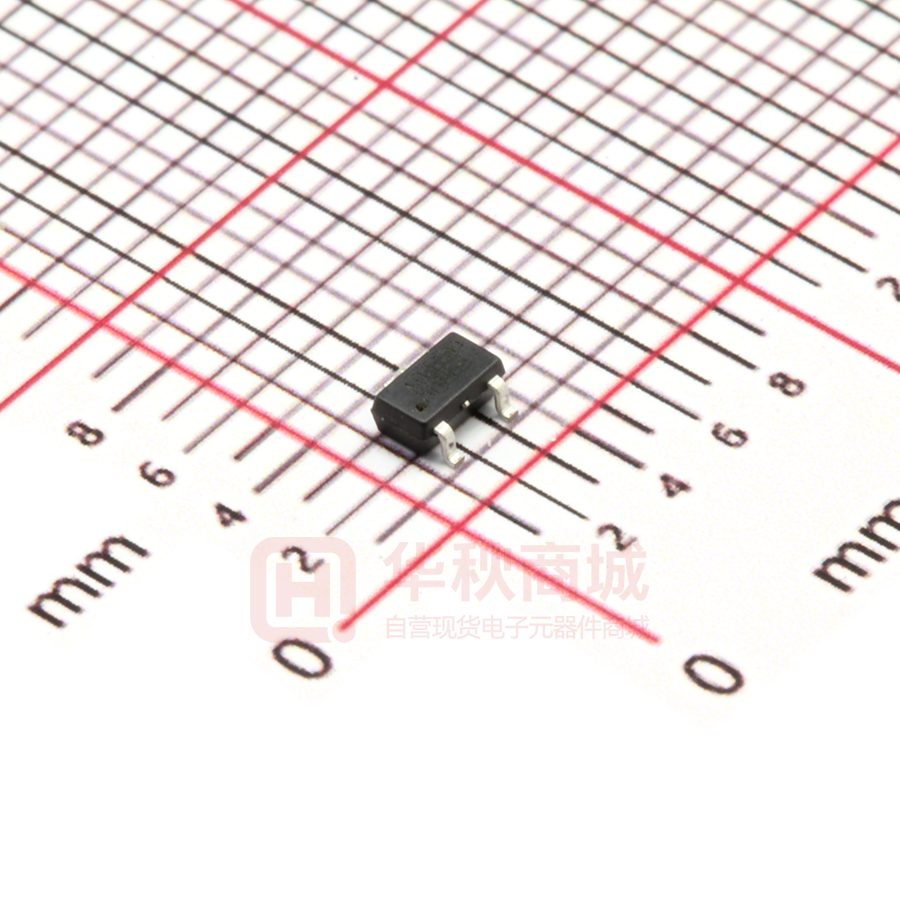

    N-Ch MOSFET
WSTBSS138 数据手册
WSTBSS138 N-Ch MOSFET General Description Product Summery The WSTBSS138 is the highest performance trench N-ch MOSFETs with extreme high cell density , which provide excellent RDSON and gate charge for most of the synchronous buck converter applications . BVDSS RDSON 60V 110mΩ ID 2.1A Applications The WSTBSS138 meet the RoHS and Green Product requirement , 100% EAS guaranteed with full function reliability approved. z High Frequency Point-of-Load Synchronous Buck Converter for MB/NB/UMPC/VGA z Networking DC-DC Power System Features z Load Switch z Advanced high cell density Trench technology SOT-23-3L Pin Configuration z Super Low Gate Charge z Excellent CdV/dt effect decline z 100% EAS Guaranteed z Green Device Available Absolute Maximum Ratings Symbol Parameter VDS VGS ID@TC=25℃ ID@TC=70℃ IDM Rating Units Drain-Source Voltage 60 V Gate-Source Voltage ±20 V 1 2.1 A 1 1.5 A 10 A Continuous Drain Current, VGS @ 10V Continuous Drain Current, VGS @ 10V Pulsed Drain Current 2 3 EAS Single Pulse Avalanche Energy 15 mJ IAS Avalanche Current 21 A Total Power Dissipation 1.25 W TSTG Storage Temperature Range -55 to 150 ℃ TJ Operating Junction Temperature Range -55 to 150 ℃ PD@TA=25℃ 4 Thermal Data Symbol Parameter RθJA Thermal Resistance Junction-ambient RθJC 1 www.winsok.tw Thermal Resistance Junction-Case Page 1 1 Typ. Max. Unit --- 125 ℃/W --- 25 ℃/W Rev:1.0 May.2019 WSTBSS138 N-Ch MOSFET Electrical Characteristics (TJ=25 ℃, unless otherwise noted) Symbol BVDSS Parameter Conditions Drain-Source Breakdown Voltage △BVDSS/△TJ BVDSS Temperature Coefficient RDS(ON) VGS(th) Static Drain-Source On-Resistance2 Gate Threshold Voltage Min. Typ. Max. Unit VGS=0V , ID=250uA 55 --- --- V Reference to 25℃ , ID=1mA --- 0.041 --- V/℃ VGS=4.5V , ID=2.1A --- 85 110 VGS=2.5V , ID=1.5A --- 95 120 1.0 1.5 2.5 V --- -4.7 --- mV/℃ VDS=44V , VGS=0V , TJ=25℃ --- --- 1 VDS=44V , VGS=0V , TJ=85℃ --- --- 5 VGS=VDS , ID =250uA mΩ △VGS(th) VGS(th) Temperature Coefficient IDSS Drain-Source Leakage Current IGSS Gate-Source Leakage Current VGS=±20V , VDS=0V --- --- ±100 nA gfs Forward Transconductance VDS=5V , ID=4A --- 10 --- S Rg Gate Resistance VDS=0V , VGS=0V , f=1MHz --- 2.5 5 Ω Qg Total Gate Charge (10V) --- 2.1 3.9 Qgs Gate-Source Charge --- 0.6 --- Qgd Gate-Drain Charge --- 0.8 ----- VDS=27V , VGS=4.5V , ID=2.1A uA nC --- 3.6 Rise Time VDD=27V , VGS=10V , RG=6Ω --- 3.5 --- Turn-Off Delay Time ID=1A --- 32 --- Fall Time --- 3 --- Ciss Input Capacitance --- 295 --- Coss Output Capacitance --- 40 --- Crss Reverse Transfer Capacitance --- 15 --- Min. Typ. Max. Unit 15.2 --- --- mJ Min. Typ. Max. Unit --- --- 1 A --- --- 4 A --- --- 1.2 V --- 10.1 --- nS --- 6.4 --- nC Td(on) Tr Td(off) Tf Turn-On Delay Time VDS=15V , VGS=0V , f=1MHz ns pF Guaranteed Avalanche Characteristics Symbol EAS Parameter Conditions 5 Single Pulse Avalanche Energy VDD=25V , L=0.1mH , IAS=15A Diode Characteristics Parameter Symbol Conditions 1,6 IS Continuous Source Current ISM Pulsed Source Current2,6 VSD Diode Forward Voltage2 trr Reverse Recovery Time Qrr Reverse Recovery Charge VG=VD=0V , Force Current VGS=0V , IS=1A , TJ=25℃ IF=4A , dI/dt=100A/µs , TJ=25℃ Note : 1.The data tested by surface mounted on a 1 inch2 FR-4 board with 2OZ copper,t
