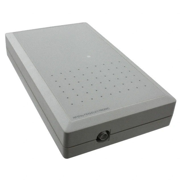

    ID ISC.MR102 USB MID READR
3605.000.00 数据手册
 HF Mid Range Reader ID ISC.MR102 FEATURES  Compact Multitag Reader for various applications  Anticollision function  Numerous communication interfaces: Ethernet (TCP/IP), USB, RS232  Available as module or housing version  3 different reader modes  Compatible with the previous version ID ISC.MR101  Ideal for retail, industry, logistics and libraries  DESCRIPTION TECHNICAL DATA The HF Mid Range Reader ID ISC.MR102 identifies transponders according to ISO 15693 with an operating frequency of 13,56 MHz. The reader is suitable for applications with middle read ranges. Depending on the used antenna the ID ISC.MR102 has a read range up to 40 cm. Dimensions (W x H x D) Due to its numerous communication interfaces the HF Mid Range Reader ID ISC.MR102 is suitable to be used in fields of applications like library, retail, logistics and industry and is easy to integrate in existing systems. Operating frequency Transmitting power Power supply - ID ISC.MR102-A/-USB - ID ISC.MR102-PoE Power consumption Antenna connector Supply voltage at antenna output Interfaces - ID ISC.MR102-A - ID ISC.MR102-PoE - ID ISC.MR102-USB Indicators, optical Supported transponders With its anticollision function the ID ISC.MR102 is able to read up to 30 transponders simultaneous. A switchable DC voltage at the antenna output can supply a LED inside a connected antenna. Depending on the interface the ID ISC.MR102 is available as module or housing version. For the housing version the electronic is mounted inside a solid plastic housing which could be used in industrial environments. Weight Housing Enclosure rating Colour Reader modes Others Temperature range Operation Storage Relative humidity * 85 mm x 145 mm x 31 mm (3,3 inch x 5,7 inch x 1,2 inch) 200 g Plastic ABS IP 30 similar to RAL 9018 (Papyrus white) 13.56 MHz 1.2 W ± 1 dB 12…24 V DC 12…24 V DC or PoE max. 6 W 1 x SMA connector (50 Ω) 7.5 V DC (max. 5 mA) RS232 Ethernet (TCP/IP) USB 2.0 1 LED (multicolour) ISO 15693 (ISO 18000-3 MODE 1)* ISO Host Mode, Scan Mode, Notification Mode Antenna shortcut detection Temperature control Full support of the external multiplexer ID ISC.ANT.MUX –25 °C up to 55 °C (-13 °F up to 131 °F) –25 °C up to 85 °C (-13 °F up to 185 °F) 5…95 % (non-condensing) e.g. EM HF ISO Chips, Fujitsu HF ISO Chips, IDS Sensor Chips, Infineon my-d, KSW Sensor Chips, NXP I-Code, STM ISO Chips, TI Tag-it STANDARD CONFORMITY ORDER DESCRIPTIONS ID ISC.MR102-A Housing version; RS232 asynchr. ID ISC.MRM102-A Module version; RS232 asynchr. ID ISC.MR102-PoE Housing version; Ethernet (PoE) ID ISC.MR102-USB Housing version; USB 2.0 ID ISC.MRM102-USB Module version; USB 2.0 Radio license Europe USA Canada EMC Safety Low voltage Human exposure Vibration Shock resistance EN 300 330 FCC 47 CFR Part 15 IC RSS-GEN, RSS-210 EN 301 489 EN 60950 EN 50364 EN 60068-2-6 10…150 Hz: 0,075 mm / 1 g EN 60068-2-27 Acceleration: 30 g FEIG ELECTRONIC reserves the rigth to change specification without notice at any time. Stand of information: December 2017.
