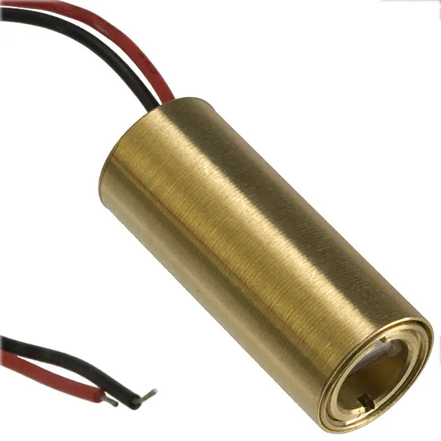

Industrial Use Line Laser VLM-635-27 Series FEATURES:              Industrial Red Line Laser. The best line-accuracy and the widest emitting angle line Laser module for use with high-precision devices. This module has integrated quartz cylindrical lens, collimating lens, laser diode, and APC driver circuit. APC driver circuit enables the Laser output power safe and constant. Includes patented solid brass structure for the best shock resistance and better heat transfer consideration. Aspherical Plastic Lens and Quartz Cylindrical Lens provides Line Laser. Dimensions : Ø 12.5 x 30 mm (Ø 0.492" x 1.181") Wavelength : 635 nm Two laser power output : Class 1M / Class 2M Laser line accuracy: 40" (+/- 1mm @5m). Emitting Angle : >90° 2.6~6 VDC operation. Connection type : Lead wire APPLICATIONS:         High accuracy Red Straight Line Laser, for Industrial high-precision leveling, alignment, adjusting, positioning, measuring and targeting device. Wood processing. Metal processing. Stone processing. Textile industry. Food industry. Automotive industry. Medical science. @Copyright 2021 Quarton inc.All Rights Reserved. www.quarton.com VLM-635-27 Series OUTLINE DIMENSIONS (UNITS: mm) Outline (Lead Wire type) SPECIFICATIONS SPECIFICATIONS 1 Dimensions VLM-635-27 LPT LPT-10 Ø 12.5 x 30 mm (Ø 0.492" x 1.181") 2 Operating voltage (Vop) 2.6~6 VDC 3 Operating current (Iop) Less than 50mA Less than 55mA 4 Optical power* Less than 2mW 4~5mW 5 Laser power output** 6 Laser class Less than 0.39mW Class 1M 7 Wavelength at peak emission (λp) 630~645nm 8 Collimating lens Plastic lens 9 Line lens Plastic lens 10 Beam shape Line 11 Laser Line width 3 ±0.5mm @5m, 6 ±0.5mm @10m 12 Laser line accuracy 40” (± 1mm @5M) 13 Emitting angle More than 90° 14 Operating temp. range*** +10°C ~+40°C 15 Storage temp. range -20°C ~+65°C 16 Housing material Brass 17 Potential housing**** VDD(+) @Copyright 2021 Quarton inc.All Rights Reserved. www.quarton.com VLM-635-27 Series 18 Electrostatic discharge (ESD) 30KV 19 Moisture sensitivity level (MSL) Level 1 - acc to JEDEC J-STD-020E. 20 Wire type 1007-26 AWG 21 Cable length 115±15mm 22 Mean time to failure (MTTF) 25°C 23 Application 10000hrs General industrial alignment 24 Suggestion work distance Above 2 meters * Optical power is total power output measured at the aperture of the laser. ** According to FDA 1040.10 & IEC 60825-1 regulations, laser power output is measured by 7mm aperture stop from a 10 cm distance of the laser. *** Operation temperature means within this temperature range, the laser spot/line will not be affected to change the spot size/line width. It can still work over this range, but the laser spot size or laser line width will be larger. **** Laser module housing is an electrical positive surface, it is imperative that contact between the laser module and the machine be avoided. This is to prevent damage from the machine electrical leakage. Surge protected power supply to the laser module is strongly recommended. ORDER CODE Order Code Wavelength Optical power* Laser power Laser Class output** Connection Type VLM-635-27 LPT 635 nm Less than 2mW Less than 0.39mW Class 1M Lead Wire VLM-635-27 LPT-10 635 nm 4~5mW Less than 0.39mW Class 1M Lead Wire * Optical power is total power output measured at the aperture of the laser. ** According to FDA 1040.10 & IEC 60825-1 regulations, laser power output is measured by 7mm aperture stop from a 10 cm distance of the laser. SAFETY LABEL @Copyright 2021 Quarton inc.All Rights Reserved. www.quarton.com VLM-635-27 Series @Copyright 2021 Quarton inc.All Rights Reserved. www.quarton.com
