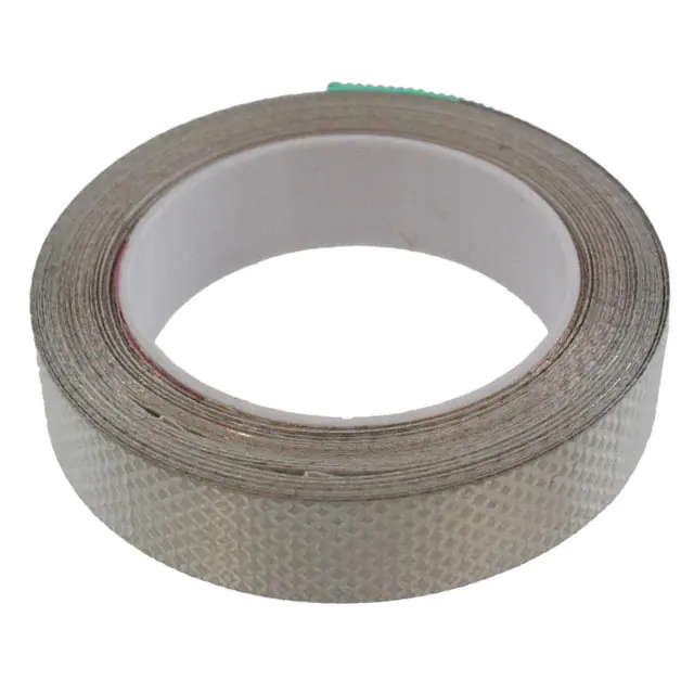

3M™ EMI Embossed Tin-Plated Copper Shielding Tape 1345 with Non-Conductive Acrylic Adhesive Data Sheet Product Description June 2021 3M™ EMI Embossed Tin-Plated Copper Shielding Tape 1345 is a 4.1-mil (0.104 mm) thick tape composed of a 1.4-mil (0.036 mm) embossed tin-plated copper foil backing coated on one side with a non-corrosive, non-conductive acrylic pressure-sensitive adhesive supplied on a removeable liner.      Embossed pattern cuts through adhesive to establish z-axis contact between the Tin-plated copper backing and application substrate Commonly used for grounding, EMI shielding in equipment, components and shielded rooms Can be die-cut, is solderable and offers a multitude of uses in electrical design and test laboratories for prototyping, design and troubleshooting Adhesive requires no moisture, solvents, heat or other manner of preparation to affect application Flame Retardant per UL-510A Standard Properties Value Imperial (Metric) Matte Tin Physical Properties Color - Visual Electrical Properties Adhesive Non-Conductive Acrylic Backing Tin-Plate Copper Foil - Embossed Flame Retardant2 Adhesion to Steel1 - Minimum Pass Value Imperial (Metric) 1.4 mil (0.036 mm) 4.1 +/- 0.51 mils (0.104 +/- 0.013 mm) 30.2 oz/in (3.3 N/cm) Breaking Strength1 - Minimum 14 lb/in (25N/cm) Mechanical Properties Backing Thickness - Nominal Total Thickness1 Notes: 1. 2. 3. 4. Electrical Resistance4 - Maximum Shielding Effectiveness3 - Average 300 kHz – 2.5 GHz Value Imperial (Metric) 0.005 Ω/in2 66 dB ASTM D1000 Test Method - properties measured at room temperature 73°F (23°C) unless otherwise stated UL Recognized Flame Retardant per UL510A Standard, Category OARC2, File No. E17385 ASTM D4935 Test Method - properties measured at room temperature 73°F (23°C) unless otherwise stated Test Method: MIL-STD-202 Method 307 maintained at 5 psi (3.4 N/cm2) measured over a 1 in2 surface area Shielding Effectiveness Many factors determine the true shielding effectiveness of a shielding tape, including type and thickness of foil, adhesive type, intimacy of contact, smoothness of application surface, frequency of the EMI signal, etc. Agency Approvals & Self Certifications  UL Component Recognized: UL510A Standard, Category OARC2, File No. E17385  For Regulatory information including RoHS, REACH, please visit www.3M.com/regs Shelf Life & Storage This product has a 5-year shelf life (from date of manufacture) when stored in humiditycontrolled storage (50°F/10°C to 80°F/27°C and

- 物料型号: 3M™ EMI Embossed Tin-Plated Copper Shielding Tape 1345 - 器件简介: 该胶带通常用于接地、电磁干扰屏蔽、设备、组件和屏蔽室。可以模切成形、可焊接,并在电气设计和测试实验室中有多种用途。 - 引脚分配: 文档中未提及引脚分配,因为这是一个胶带产品,不是电子元件。 - 参数特性: - 颜色: 亚光锡色 - 胶粘剂: 非导电丙烯酸 - 背衬: 压花镀锡铜箔 - 阻燃性: 通过UL-510A标准 - 电气特性包括最大电阻和屏蔽效能,其中屏蔽效能在300 kHz至2.5 GHz的平均值为66 dB。 - 功能详解: 压花图案可穿透胶粘剂,在镀锡铜背衬和应用基材之间建立z轴接触,增强屏蔽效果。 - 应用信息: 适用于电磁干扰屏蔽和接地,可在电气设计和测试实验室中用于原型设计、设计和故障排除。 - 封装信息: 文档中未明确提及封装信息,但提到产品可从3M授权经销商/转换器处获得,也可通过3M.com/oem或电话1.800.245.3573购买。
