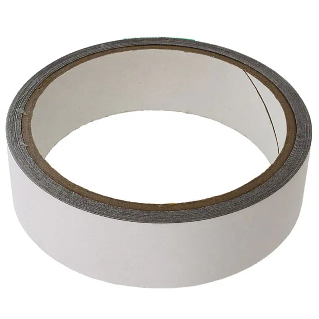

™ 3M Fabric Tape CN-3190 Nickel on Copper-Plated Polyester Fabric Data Sheet September 2008 Description 3M™ Fabric Tape CN-3190 consists of anti-corrosion polyester rip-stop fabric and unique electrically conductive pressure-sensitive acrylic adhesive. Applications 3M CN-3190 is used in applications typically served by metal foil shielding tapes such as grounding and EMI shielding equipment, components, shielded rooms, etc. The unique metal-plated fabric backing offers the additional benefits of excellent flexibility and conformability, very light weight, and exceptional strength. The fabric backing also minimizes the possibility of finger lacerations. Shielding Effectiveness Many factors determine the true shielding effectiveness of a shielding tape, including type and thickness of foil adhesive type, intimacy of contact, smoothness of application surface, strength and frequency of the EMI signal, etc. However, using standard tests and fixtures it is possible to determine a value for the attenuations. For CN-3190 fabric tape, typical shielding effectiveness is in the range of 65dB to 70dB. Before using this product, the user must evaluate it and determine if it is suitable for the intended application. Typical Properties Technical information provided consists of typical product data and should not be used for specification purposes. Unless otherwise noted, all tests are performed at room temperature. Physical Property (Test Method) (ASTM D1000 unless noted) Typical Value US units (metric) Color Grey Adhesive Conductive acrylic Type of Backing Copper/Nickel coated ripstop polyester Total Thickness (backing plus adhesive) 4.3 mils (0,11 mm) Liner Thickness 5.8 mils (0,14 mm) Breaking Strength 40 lb/in (18 kgf/25 mm) Adhesion Strength 31 oz/in (900gf/25 mm) 3 1 of 2 3M™ Fabric Tape CN-3190 Nickel on Copper-Plated Polyester Fabric Typical Properties Electrical Property (Test Method) (ASTM D1000 unless noted) Electrical Resistance Through Adhesive 1 Typical Value US units (metric) 1 0.05 ohms MIL-STD-202 Method 307 maintained at 5 psi (3,4 N/cm2) measured over 1 in 2 surface area. Conductive particles in the adhesive provide the electrical path between the application substrate and the foil backing. Specifications • • • Shelf Life & Storage The tape has a 5-year shelf life from date of manufacture when stored in a clean, dry place at a temperature of 70° F (21° C) and 40-50% relative humidity. Availability For availability, please contact your local distributor. Names and addresses are available from 3M.com/electrical [Where to Buy] or call 1-800-676-8381. Important Notice All statements, technical information, and recommendations related to 3M’s products are based on information believed to be reliable, but the accuracy or completeness is not guaranteed. Before using this product, you must evaluate it and determine if it is suitable for your intended application. You assume all risks and liability associated with such use. Any statements related to the product which are not contained in 3M’s current publications, or any contrary statements contained on your purchase order shall have no force or effect unless expressly agreed upon, in writing, by an authorized officer of 3M. Warranty; Limited Remedy; Limited Liability This product will be free from defects in material and manufacture at the time of purchase. 3M MAKES NO OTHER WARRANTIES INCLUDING, BUT NOT LIMITED TO, ANY IMPLIED WARRANTY OF MERCHAN OR FITNESS FOR A PARTICULAR PURPOSE. If this product is defective within the warranty period stated above, your exclusive remedy shall be, at 3M’s option, to replace or repair the 3M product or refund the purchase price of the 3M product. Except where prohibited by law, 3M will not be liable for any indirect, special, incidental or consequential loss or damage arising from this 3M product, regardless of the legal theory asserted. Anti-corrosion treated Cu/Ni conductive fabric Conductive acrylic adhesive Supplied on a removable liner for easy handling and die cutting 3M is a trademark of 3M Company. 30 Electrical Markets Division 6801 River Place Blvd. Austin, TX 78726-9000 800 676 8381 FAX 800 828 9329 www.3M.com/electrical/oem Please recycle. © 3M 2008 All rights reserved. 78-8126-9843-5_B 2 of 2

- 物料型号:3M™ Fabric Tape CN-3190 - 器件简介:由抗腐蚀聚酯防撕裂布和独特的电导性压敏丙烯酸胶组成。 - 引脚分配:文档中未提及。 - 参数特性: - 颜色:灰色 - 胶粘剂类型:导电丙烯酸 - 基材类型:铜/镍涂层防撕裂聚酯 - 总厚度(基材加胶粘剂):4.3 mils (0.11mm) - 衬纸厚度:5.8 mils (0.14mm) - 断裂强度:40 lb/in (18kgf/25 mm) - 粘附强度:31 oz/in (900gf/25mm) - 胶粘剂电阻:0.05欧姆 - 功能详解:用于通常由金属箔屏蔽胶带服务的应用,如接地和电磁干扰屏蔽设备、组件、屏蔽室等。金属镀布背衬提供额外的柔韧性、适应性、轻重量和卓越强度。布背衬还最小化了手指割伤的可能性。 - 应用信息:用于金属箔屏蔽胶带通常服务的应用,如接地和电磁干扰屏蔽。 - 封装信息:抗腐蚀处理的铜/镍导电织物,导电丙烯酸胶,带可移除衬纸,便于操作和模切。 - 保质期和存储:在干净、干燥的地方,温度70°F (21°C) 和40-50%相对湿度下,胶带有5年的保质期。 - 可用性:请联系当地分销商获取可用性信息。
