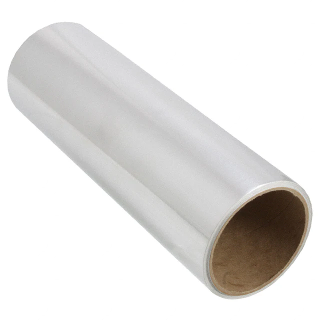

3M™ Aluminum Foil Tape 1120 with Electrically Conductive Acrylic Adhesive Data Sheet Product Description June 2021 3M™ Aluminum Foil Tape 1120 is a 3-mil (0.076 mm) thick tape composed of a 2-mil (0.051 mm) flat aluminum foil backing coated on one side with a non-corrosive, electrically conductive acrylic pressure-sensitive adhesive supplied on a removeable liner.     Commonly used for EMI/RFI shielding applications in the electronics industry and for static charge draining, seaming shielded rooms, cable wrapping and surface contact to non-solderable materials Can be die-cut and offers a multitude of uses in electrical design and test laboratories for prototyping, design and troubleshooting Adhesive requires no moisture, solvents, heat or other manner of preparation to affect application Flame Retardant per UL-510A Standard Properties Value Imperial (Metric) Silver Physical Properties Color - Visual Electrical Properties Adhesive Electrically Conductive Acrylic Backing Aluminum Foil - Flat Flame Retardant2 Adhesion to Steel1 - Minimum Pass Value Imperial (Metric) 2 mil (0.051 mm) 3.0 +/- 0.1 mils (0.076 +/- 0.003 mm) 25 oz/in (2.7 N/cm) Breaking Strength1 - Minimum 14 lb/in (25 N/cm) Mechanical Properties Backing Thickness - Nominal Total Thickness1 Notes: 1. 2. 3. 4. Electrical Resistance4 - Maximum Shielding Effectiveness3 - Average 300 kHz – 2.5 GHz Value Imperial (Metric) 0.010 Ω/in2 69 dB ASTM D1000 Test Method - properties measured at room temperature 73°F (23°C) unless otherwise stated UL Recognized Flame Retardant per UL510A Standard, Category OARC2, File No. E17385 ASTM D4935 Test Method - properties measured at room temperature 73°F (23°C) unless otherwise stated Test Method: MIL-STD-202 Method 307 maintained at 5 psi (3.4 N/cm2) measured over a 1 in2 surface area a. Silver coated glass beads embedded in acrylic adhesive provide the electrical path between application substrate and foil backing Shielding Effectiveness Many factors determine the true shielding effectiveness of a shielding tape, including type and thickness of foil, adhesive type, intimacy of contact, smoothness of application surface, frequency of the EMI signal, etc. Agency Approvals & Self Certifications  UL Component Recognized: UL510A Standard, Category OARC2, File No. E17385  For Regulatory information including RoHS, REACH, please visit www.3M.com/regs Shelf Life & Storage This product has a 5-year shelf life (from date of manufacture) when stored in humiditycontrolled storage (50°F/10°C to 80°F/27°C and

参数特性: - 颜色:银色 - 胶粘剂:导电丙烯酸 - 背衬:平铝箔 - 阻燃性:通过UL-510A标准 - 电气特性:最大电阻为0.010 /平方英寸 - 屏蔽效能:在300 kHz至2.5 GHz的平均值为69dB - 机械特性:背衬厚度约2密耳(0.051毫米),总厚度约3.0±0.1密耳(0.076±0.003毫米),对钢的粘附力至少为25盎司/英寸(2.7牛顿/厘米),断裂强度至少为14磅/英寸(25牛顿/厘米)。
功能详解:该胶带常用于电子行业的电磁干扰/射频干扰屏蔽应用,以及静态电荷排放、屏蔽房间接缝、电缆包裹和与非焊接材料的表面接触。它可以模切成形,并在电气设计和测试实验室中提供多种用途,用于原型设计、设计和故障排除。胶粘剂无需水分、溶剂、热量或其他方式即可应用。
