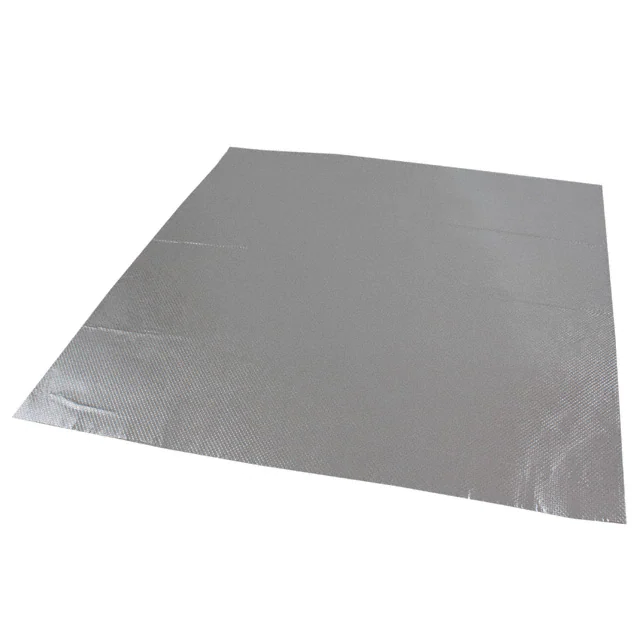

3M™ EMI Embossed Aluminum Shielding Tape 1267 with Non-Conductive Acrylic Adhesive Data Sheet Product Description June 2021 3M™ EMI Embossed Aluminum Shielding Tape 1267 is a 4.95-mil (0.126 mm) thick tape composed of a 2.0-mil (0.051 mm) embossed aluminum foil backing coated on one side with a non-corrosive, non-conductive acrylic pressure-sensitive adhesive supplied on removeable liner.      Embossed pattern cuts through adhesive to establish z-axis contact between the aluminum foil backing and application substrate Commonly used for grounding, EMI shielding in equipment, components and shielded rooms Can be die-cut and offers a multitude of uses in electrical design and test laboratories for prototyping, design and troubleshooting Adhesive requires no moisture, solvents, heat or other manner of preparation to affect application Flame Retardant per UL-510A Standard Properties Value Imperial (Metric) Silver Physical Properties Color - Visual Adhesive Non-Conductive Acrylic Backing Aluminum Foil - Embossed Flame Retardant2 Adhesion to Steel1 - Minimum Pass Value Imperial (Metric) 2.0 mil (0.051 mm) 4.95 +/- 0.65 mils (0.126 +/- 0.17 mm) 30.2 oz/in (3.3 N/cm) Breaking Strength1 - Minimum 14 lb/in (25 N/cm) Mechanical Properties Backing Thickness - Nominal Total Thickness1 Notes: 1. 2. 3. 4. Electrical Properties Electrical Resistance4 - Maximum Shielding Effectiveness3 - Average 300 kHz – 2.5 GHz Value Imperial (Metric) 0.0075 Ω/in2 64 dB ASTM D1000 Test Method - properties measured at room temperature 73°F (23°C) unless otherwise stated UL Recognized Flame Retardant per UL510A Standard, Category OARC2, File No. E17385 ASTM D4935 Test Method - properties measured at room temperature 73°F (23°C) unless otherwise stated Test Method: MIL-STD-202 Method 307 maintained at 5 psi (3.4 N/cm2) measured over a 1 in2 surface area Shielding Effectiveness Many factors determine the true shielding effectiveness of a shielding tape, including type and thickness of foil, adhesive type, intimacy of contact, smoothness of application surface, frequency of the EMI signal, etc. Agency Approvals & Self Certifications  UL Component Recognized: UL510A Standard, Category OARC2, File No. E17385  For Regulatory information including RoHS, REACH, please visit www.3M.com/regs Shelf Life & Storage This product has a 5-year shelf life (from date of manufacture) when stored in humiditycontrolled storage (50°F/10°C to 80°F/27°C and

参数特性: - 颜色:银色 - 胶粘剂类型:非导电丙烯酸 - 屏蔽效能:在300 kHz至2.5 GHz的平均值为64 dB - 电气电阻:最大0.0075欧姆/平方英寸 - 背衬厚度:2.0密耳(0.051毫米) - 总厚度:4.95±0.65密耳(0.126±0.017毫米) - 对钢的粘附力:最小30.2盎司/英寸(3.3牛顿/厘米) - 断裂强度:最小14磅/英寸(25牛顿/厘米)
功能详解:压花图案可穿透胶粘剂,在铝箔背衬和应用基材之间建立z轴接触,提高屏蔽效果。胶粘剂无需水分、溶剂、热量或其他方式即可应用。
