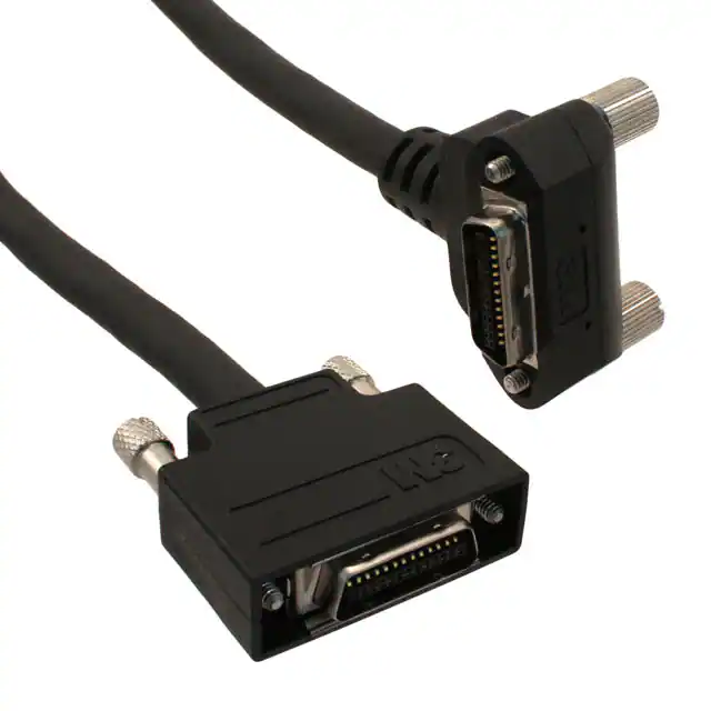

3M™ Mini D Ribbon (MDR) Cable Assembly .050” Right-Angle High-Flex Digital Camera Cable – 26 position 14H26-SZ3X-XXX-04C • Flexible cable enables moving head applications. • For machine vision camera to frame grabber communications in applications where full CameraLink™ configuration is not necessary • Mates to popular 3M MDR 26 position receptacle • 3 shielded quads with drains and 5 unshielded twisted pairs • Entire cable bundle shielded with foil and braid for additional signal protection • Rugged MDR ribbon type contact for reliable, repeatable connectivity • Rugged thumbscrew retention • EMI shielded junction shell • See Regulatory Information Appendix (RIA) for chemical compliance information Date Modified: January 20, 2008 TS-2259-B Sheet 1 of 3 Physical Connector Contact Plating: Wiping Area: 30 µ” [0.76 µ m] Min. Gold (RIA E1 & C1 apply) Overmolded Shell: Color: Black Material: Polyvinyl Chloride (PVC) Shell: Color: Black Material: Polyester Elastomer Cable: Color: Black Jacket Material: Polyvinyl Chloride (PVC) Flammability: AWM VW-1 Flex Cycles: > 2 x 106 cycles (100 mm bend radius, 100 mm stroke, 30 strokes/minute) Electrical Voltage Rating: 30V Current Rating: 1 A Insulation Resistance: > 1 x 108 Ω at 100 VDC Withstanding Voltage: 350 VRMS for 1 minute Shielded Twisted Pairs: Characteristic Impedance: 100 ± 10 Ω Conductor Size: 28 AWG Stranded Skew (within pair): 50 ps/meter maximum Skew (Channel skew per chipset): 100 ps/meter maximum Environmental Temperature Rating: -20 °C to +75 °C UL File No.: E86982 3 Electronic Solutions Division Interconnect Solutions http://www.3M.com/interconnects/ 3M is a trademark of 3M Company. For technical, sales or ordering information call 800-225-5373 3M™ Mini D Ribbon (MDR) Cable Assembly .050” Right-Angle High-Flex Digital Camera Cable – 26 position CN-1 CAMERA 14H26-SZ3X-XXX-04C CN-2 FRAME GRABBER 39.7 [1.56] 19.4 [0.76] Connector Label (Camera Side) 39.7 [1.56] #4-40 Thumbscrews 2 x 26 Position High Density Mini D Ribbon (MDR) Male Plug 12.8 [0.51] Cable Length 42.4 [1.67] 32.5 [1.28] Cable Length Tolerance is the larger of + 50 mm / -0 mm or +3% / -0% MDR 26 Position Plug Right-Angle (Camera) End MDR 26 Position Plug Straight (Frame Grabber) End 1 13 14 26 mm [inch] Tolerance Unless Noted 14H26-SZ3M-XXX-04C 14H26-SZ3S-XXX-04C mm Use 3M™ Jacksocket 3341-31 for mounting receptacle to panel. [ ] Dimensions for Reference Only .0 ±.1 .00 ±.10 Ordering Information 14H26-SZ3X-XXX-04C Right Angle Orientation M = Position 1 opposite cable S = Position 1 on cable side Cable Length 050 100 150 200 250 = = = = = 50 cm 100 cm 150 cm 200 cm 250 cm 300 350 400 450 500 = = = = = 300 cm 350 cm 400 cm 450 cm 500 cm 600 700 800 900 A00 = = = = = 600 cm 700 cm 800 cm 900 cm 1000 cm TS-2259-B Sheet 2 of 3 For lengths greater than 1000 cm refer to Table 2 3 Electronic Solutions Division Interconnect Solutions http://www.3M.com/interconnects/ 3M is a trademark of 3M Company. For technical, sales or ordering information call 800-225-5373 3M™ Mini D Ribbon (MDR) Cable Assembly .050” Right-Angle High-Flex Digital Camera Cable – 26 position Table 1 CN-1 Connector Position 14 2 15 3 16 1 4 17 5 18 6 19 7 20 13 8 21 9 22 10 23 11 24 12 25 26 X0 X1 GND X0X0+ X1X1+ X2 XC GND X2X2+ XclkXclk+ X3X3+ SerTC+ SerTCX3 SerTC GND SerTFGSerTFG+ CC1CC1+ CC2+ CC2CC3CC3+ CC4+ CC4NC Twisted Pair 1 Twisted Pair 2 Twisted Pair 3 Twisted Pair 4 Twisted Pair 5 OPEN Table 2 Length Codes First 2 Digits 10 11 12 13 14 15 16 Alpha Code A B C D E F G First 2 Digits 17 18 19 20 21 22 23 Alpha Code H J K L M N P First 2 Digits 24 25 26 27 28 29 30 Alpha Code R S T V W Y Z QUAD 3 QUAD 2 QUAD 1 Wiring Chart Cable X0 X1 GND X0X0+ X1X1+ X2 XC GND X2X2+ XclkXclk+ X3X3+ SerTC+ SerTCX3 SerTC GND SerTFGSerTFG+ CC1CC1+ CC2+ CC2CC3CC3+ CC4+ CC4NC CN-2 Connector Position 13 25 12 24 11 26 23 10 22 9 21 8 20 7 14 19 6 18 5 17 4 16 3 15 2 1 14H26-SZ3X-XXX-04C For lengths in excess of 1000 cm substitute the corresponding alpha code for the first 2 digits. Example: the code for 1160 cm is B60. TS-2259-B Sheet 3 of 3 3 Electronic Solutions Division Interconnect Solutions http://www.3M.com/interconnects/ 3M is a trademark of 3M Company. For technical, sales or ordering information call 800-225-5373 Regulatory Information Appendix 3M Electronic Solutions Division/Interconnect EUROPE Appendix E1: European Union RoHS Directive 2002/95/EC, Restriction of the Use of Certain Hazardous Substances in Electrical & Electronic Equipment, as amended by EU Commission Decision 2005/618/EC. This product is RoHS Compliant 2005/95/EC. “RoHS Compliant 2005/95/EC” means that the product or part (“Product”) does not contain any of the substances in excess of the maximum concentration values in EU Directive 2002/95/EC, as amended by Commission Decision 2005/618/EC, unless the substance is in an application that is exempt under EU RoHS. Unless otherwise stated by 3M in writing, this information represents 3M’s best knowledge and belief based upon information provided by third party suppliers to 3M. In the event any product is proven not to conform with 3M’s Regulatory Information Appendix, then 3M’s entire liability and Buyer’s exclusive remedy will be in accordance with the Warranty stated below. Appendix E2: European Union RoHS Directive 2002/95/EC, Restriction of the Use of Certain Hazardous Substances in Electrical & Electronic Equipment, as amended by EU Commission Decision 2005/618/EC. This product contains lead in the compliant pin area in excess of the maximum concentration value allowed but is compliant by exemption under EU Commission Decision 2005/747/EC. “RoHS Compliant 2005/95/EC” means that the product or part (“Product”) does not contain any of the substances in excess of the maximum concentration values in EU Directive 2002/95/EC, as amended by Commission Decision 2005/618/EC, unless the substance is in an application that is exempt under EU RoHS. Unless otherwise stated by 3M in writing, this information represents 3M’s best knowledge and belief based upon information provided by third party suppliers to 3M. In the event any product is proven not to conform with 3M’s Regulatory Information Appendix, then 3M’s entire liability and Buyer’s exclusive remedy will be in accordance with the Warranty stated below. Appendix E3: European Union RoHS Directive 2002/95/EC, Restriction of the Use of Certain Hazardous Substances in Electrical & Electronic Equipment as amended by Commission Decision 2005/618/EC. This product contains lead in the solder tail area in excess of the maximum concentration value allowed. Unless otherwise stated by 3M in writing, this information represents 3M’s best knowledge and belief based upon information provided by third party suppliers to 3M. In the event any product is proven not to conform with 3M’s Regulatory Information Appendix, then 3M’s entire liability and Buyer’s exclusive remedy will be in accordance with the Warranty stated below. Appendix E4: European Union RoHS Directive 2002/95/EC, Restriction of the Use of Certain Hazardous Substances in Electrical & Electronic Equipment, as amended by EU Commission Decision 2005/618/EC. This product contains decaBDE in the insulating material in excess of the maximum concentration value allowed but is compliant by exemption under EU Commission Decision 2005/717/EC. “RoHS Compliant 2005/95/EC” means that the product or part (“Product”) does not contain any of the substances in excess of the maximum concentration values in EU Directive 2002/95/EC, as amended by Commission Decision 2005/618/EC, unless the substance is in an application that is exempt under EU RoHS. Unless otherwise stated by 3M in writing, this information represents 3M’s best knowledge and belief based upon information provided by third party suppliers to 3M. In the event any product is proven not to conform with 3M’s Regulatory Information Appendix, then 3M’s entire liability and Buyer’s exclusive remedy will be in accordance with the Warranty stated below. RIA-2217B-D Appendix E5: European Union RoHS Directive 2002/95/EC, Restriction of the Use of Certain Hazardous Substances in Electrical and Electronic Equipment, as amended by EU Commission Decision 2005/618/EC. This product contains lead in excess of the maximum concentration value allowed but is compliant by exemption under Item 6 of the Annex to the Directive. “RoHS Compliant 2005/95/EC” means that the product or part (“Product”) does not contain any of the substances in excess of the maximum concentration values in EU Directive 2002/95/EC, as amended by Commission Decision 2005/618/EC, unless the substance is in an application that is exempt under EU RoHS. Unless otherwise stated by 3M in writing, this information represents 3M’s best knowledge and belief based upon information provided by third party suppliers to 3M. In the event any product is proven not to conform with 3M’s Regulatory Information Appendix, then 3M’s entire liability and Buyer’s exclusive remedy will be in accordance with the Warranty stated below. CHINA Appendix C1: China RoHS Electronic Industry Standard of the People’s Republic of China, SJ/T11363-2006, Requirements for Concentration Limits for Certain Hazardous Substances in Electronic Information Products. This symbol, per Marking for the Control of Pollution Caused by Electronic Information Products, SJ/T11364-2006, means that the product or part does not contain any of the following substances in excess of the following maximum concentration values in any homogeneous material: (a) 0.1% (by weight) for lead, mercury, hexavalent chromium, polybrominated biphenyls or polybrominated diphenyl ethers; or (b) 0.01% (by weight) for cadmium. Unless otherwise stated by 3M in writing, this information represents 3M’s best knowledge and belief based upon information provided by third party suppliers to 3M. In the event any product is proven not to conform with 3M’s Regulatory Information Appendix, then 3M’s entire liability and Buyer’s exclusive remedy will be in accordance with the Warranty stated below. Appendix C2: China RoHS Electronic Industry Standard of the People’s Republic of China, SJ/T11363-2006, Requirements for Concentration Limits for Certain Hazardous Substances in Electronic Information Products. This symbol, per Marking for the Control of Pollution Caused by Electronic Information Products, SJ/T11364-2006, means that the product or part does contain a substance, as detailed in the chart below, in excess of the following maximum concentration values in any homogeneous material: (a) 0.1% (by weight) for lead, mercury, hexavalent chromium, polybrominated biphenyls or polybrominated diphenyl ethers; or (b) 0.01% (by weight) for cadmium. Unless otherwise stated by 3M in writing, this information represents 3M’s best knowledge and belief based upon information provided by third party suppliers to 3M. The numerical reference in the symbol above should not be construed as a representation regarding the product’s life or an extension of a product warranty. The product warranty is stated below. In the event any product is proven not to conform with 3M’s Regulatory Information Appendix, then 3M’s entire liability and Buyer’s exclusive remedy will be in accordance with the product Warranty stated below. RIA-2217B-D Appendix C3: China RoHS Electronic Industry Standard of the People’s Republic of China, SJ/T11363-2006, Requirements for Concentration Limits for Certain Hazardous Substances in Electronic Information Products. This symbol, per Marking for the Control of Pollution Caused by Electronic Information Products, SJ/T11364-2006, means that the product or part does contain a substance, as detailed in the chart below, in excess of the following maximum concentration values in any homogeneous material: (a) 0.1% (by weight) for lead, mercury, hexavalent chromium, polybrominated biphenyls or polybrominated diphenyl ethers; or (b) 0.01% (by weight) for cadmium. Unless otherwise stated by 3M in writing, this information represents 3M’s best knowledge and belief based upon information provided by third party suppliers to 3M. The numerical reference in the symbol above should not be construed as a representation regarding the product’s life or an extension of a product warranty. The product warranty is stated below. In the event any product is proven not to conform with 3M’s Regulatory Information Appendix, then 3M’s entire liability and Buyer’s exclusive remedy will be in accordance with the product Warranty stated below. Important Notice All statements, technical information, and recommendations related to 3M’s products are based on information believed to be reliable, but the accuracy or completeness is not guaranteed. Before using this product, you must evaluate it and determine if it is suitable for your intended application. You assume all risks and liability associated with such use. Any statements related to the product which are not contained in 3M’s current publications, or any contrary statements contained on your purchase order shall have no force or effect unless expressly agreed upon, in writing, by an authorized officer of 3M. Warranty; Limited Remedy; Limited Liability. This product will be free from defects in material and manufacture for a period of one (1) year from the time of purchase. 3M MAKES NO OTHER WARRANTIES INCLUDING, BUT NOT LIMITED TO, ANY IMPLIED WARRANTY OF MERCHANTABILITY OR FITNESS FOR A PARTICULAR PURPOSE. If this product is defective within the warranty period stated above, your exclusive remedy shall be, at 3M’s option, to replace or repair the 3M product or refund the purchase price of the 3M product. Except where prohibited by law, 3M will not be liable for any indirect, special, incidental or consequential loss or damage arising from this 3M product, regardless of the legal theory asserted. 3 3M Electronics Solutions Division 6801 River Place Blvd. Austin, TX 78726-9000 U.S.A. 1-800-225-5373 www.3m.com/interconnects Please recycle. Printed in USA. © 3M 2008. All rights reserved. RIA-2217B-D 3M is a trademark of 3M Company.
