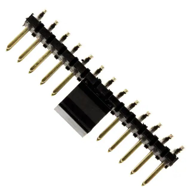

    CONN 26POS 2MM HEADER DL STR SMD
151226-2420-RB-WD 数据手册
3M™ Pin Strip Header, 1512 Series 2 mm × 2 mm Solder Tail Straight & Right Angle, Surface Mount Straight • Mates with a variety of dual row 2 mm board mount and wire mount sockets • High temperature insulator compatible with lead-free solder processes • Extensive pin count availability from 4 to 80 positions • Available with vacuum cap in tape and reel packaging for automatic placement • Minimizes use of PC board space • End and side stackable design • Visit 3M.com/regs or contact your 3M representative to find the RoHS compliance status of the 3M part you are interested in. Date Modified: January 20, 2017  TS-0808-J Sheet 1 of 5 Physical Insulation: Material: Glass-filled LCP Flammability: UL 94V-0 Color: Black Contact: Material: Copper Alloy Plating: Underplating: 50 μ" [1.27 μm] Nickel Wiping Area: 30 μ" [ 0.76 μm ] Gold Avg. Solder Tails: 200-300 μ" [5.08-7.62 μm] Matte Tin Marking: None Electrical Current Rating: 3.50 A, 1 Line Powered 1.75 A, 6 Adjacent Lines Powered 1.00 A, All Lines Powered Rating Conditions: EIA-364-070 Method 2, 30°C maximum temperature rise, 20% derated. Reference appropriate 3M Product Specification for detailed current derating curves. Insulation Resistance: > 1 × 109 Ω at 250 VDC Withstanding Voltage: 500 VRMS at Sea Level Environmental Temperature Rating: -55°C to +105°C Process Rating: Maximum 260°C (per J-STD-020C) Moisture Sensitivity Level: 1 (per J-STD-020C) UL File No.: E68080 Electronics Materials Solutions Division Interconnect Solutions http://www.3Mconnectors.com 3M is a trademark of 3M Company. For technical, sales or ordering information call 800-225-5373 3M™ Pin Strip Header, 1512 Series 2 mm × 2 mm Solder Tail Straight & Right Angle, Surface Mount Straight Straight C +.000 -.020 .155 [3.94] 0.039 [1.00] .0787 [2.000] .0787 [2.000] A ± .008 .059 [1.50] Contact Quantity Dimension C 80 3.15 [80.0] .118 ± .010 .009 ± .001 [0.23] mm [Inch] Tolerance Unless Noted .0787 ± .003 [2.000] in. .0787 ± .003 [2.000] mm 0.X - ±0.5 0.XX ±0.01 ±0.25 0.XXX ±0.005 ±0.13 [ ] Dimensions for Reference Only .032 ± .003 [0.81] After Plating Recommended Mounting Hole Pattern Pin Cross Section C Ordering Information Contact Quantity (See Table 1) Electronics Materials Solutions Division Interconnect Solutions http://www.3Mconnectors.com 1512XX-8X22-RB (RIA E1 & C1 Apply) Pin Length Dim ‘A' 3 = .130" 4 = .152" TS-0808-J Sheet 2 of 5 3M is a trademark of 3M Company. For technical, sales or ordering information call 800-225-5373 3M™ Pin Strip Header, 1512 Series 2 mm × 2 mm Solder Tail Straight & Right Angle, Surface Mount Straight Right Angle .118 ± .010 .165 [4.19] C +.000 -.020 .0787 [2.000] .157 [3.99] Contact Quantity Dimension C 80 3.15 [80.0] .047 [1.19] .015 [0.38] Standoff .0787 [2.000] .0787 [2.000] .068 [1.73] .029 [0.74] A ± .008 mm [Inch] Tolerance Unless Noted in. .0787 ± .003 [2.000] mm 0.X - ±0.5 0.XX ±0.01 ±0.25 0.XXX ±0.005 ±0.13 [ ] Dimensions for Reference Only .0787 ± .003 [2.000] .032 ± .003 [0.81] After Plating Recommended Mounting Hole Pattern Pin Cross Section C Ordering Information Contact Quantity (See Table 1) Electronics Materials Solutions Division Interconnect Solutions http://www.3Mconnectors.com 1512XX-7X22-RB (RIA E1 & C1 Apply) Pin Length Dim ‘A' 3 = .130" 4 = .152" TS-0808-J Sheet 3 of 5 3M is a trademark of 3M Company. For technical, sales or ordering information call 800-225-5373 3M™ Pin Strip Header, 1512 Series 2 mm × 2 mm Solder Tail Straight & Right Angle, Surface Mount Straight 0.299 [7.6] 0.197 [5.0] Example of vacuum cap on part C +.000 -.020 Contact Quantity Dimension C Tape Width Order Code 80 3.15 [80.0] n/a n/a .155 [ 3.94 ] .0787 [ 2.00 ] .03 [ 0.8 ] .0787 [ 2.00 ] .059 [ 1.50 ] mm [Inch] A ± .008 Tolerance Unless Noted in. .263 ± .02 [ 6.68 ] .122 [ 3.10 ] .030 [ 0.76 ] .050 [ 1.27 ] mm 0.X - ±0.5 0.XX ±0.01 ±0.25 0.XXX ±0.005 ±0.13 [ ] Dimensions for Reference Only .310 [ 7.87 ] Notes: 1.Tape & reel include vacuum pick-up cap for pick n place handling equipment. 2. Parts in tray packaging are supplied without vacuum cap. .0787 [ 2.00 ] Recommended PCB Pad Layout Pin Cross Section C Ordering Information Contact Quantity (See Table 1) Electronics Materials Solutions Division Interconnect Solutions http://www.3Mconnectors.com 1512XX-2X20-RB-XX (RIA E1 & C1 Apply) Pin Length Dim ‘A' 3 = .130" 4 = .152" Packaging suffix: Blank = Tray Packaging WX = Tape & Reel Packaging (see table 1) TS-0808-J Sheet 4 of 5 3M is a trademark of 3M Company. For technical, sales or ordering information call 800-225-5373 Regulatory: For regulatory information about this product, contact your 3M representative. Technical Information: The technical information, recommendations and other statements contained in this document are based upon tests or experience that 3M believes are reliable, but the accuracy or completeness of such information is not guaranteed. Product Use: Many factors beyond 3M’s control and uniquely within user’s control can affect the use and performance of a 3M product in a particular application. Given the variety of factors that can affect the use and performance of a 3M product, user is solely responsible for evaluating the 3M product and determining whether it is fit for a particular purpose and suitable for user’s method of application. Warranty, Limited Remedy, and Disclaimer: Unless an additional warranty is specifically stated on the applicable 3M product packaging or product literature, 3M warrants that each 3M product meets the applicable 3M product specification at the time 3M ships the product. 3M MAKES NO OTHER WARRANTIES OR CONDITIONS, EXPRESS OR IMPLIED, INCLUDING, BUT NOT LIMITED TO, ANY IMPLIED WARRANTY OR CONDITION OF MERCHANTABILITY OR FITNESS FOR A PARTICULAR PURPOSE OR ANY IMPLIED WARRANTY OR CONDITION ARISING OUT OF A COURSE OF DEALING, CUSTOM OR USAGE OR TRADE. If the 3M product does not conform to this warranty, then the sole and exclusive remedy is, at 3M’s option, replacement of the 3M product or refund of the purchase price. Limitation of Liability: Except where prohibited by law, 3M will not be liable for any loss or damage arising from the 3M product, whether direct, indirect, special, incidental or consequential, regardless of the legal theory asserted, including warranty, contract, negligence or strict liability. 3M Electronics Materials Solutions Division 6801 River Place Blvd. Austin, TX 78726-9000 U.S.A. 1-800-225-5373 www.3Mconnectors.com 3M is a trademark of 3M Company. Please recycle. Printed in USA. © 3M 2017. All rights reserved.

物料型号:3M™ Pin Strip Header, 1512系列
器件简介:该引脚排与多种双排2毫米板载和线束插座兼容,高温绝缘材料适用于无铅焊接工艺,引脚数量从4到80位不等,可带真空帽以适应自动放置,最小化PCB板空间使用,端部和侧面可堆叠设计。
引脚分配:文档提供了详细的引脚分配和尺寸信息,包括引脚数量、尺寸C、引脚长度等。
参数特性:包括电流额定值、绝缘电阻、耐压、温度范围等电气特性。
功能详解:文档提供了引脚排的物理、电气和环境特性的详细描述。
应用信息:适用于需要最小化PCB板空间和自动放置的应用。
封装信息:提供了订购信息和包装选项,包括直插和直角两种类型的引脚排。
