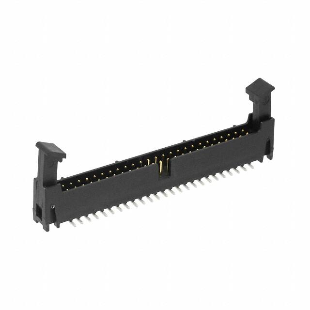

3M™ Latch/Eject Header 2 mm x 2 mm Straight & Right Angle, Through-Hole, Straight, Surface Mount 1552 Series • 14 pin counts ranging from 6 to 50 positions • Latch/eject mechanism maintains a secure connection • Roll pins retain latches to body in shipping and high vibration environments • Ejector helps make removal of assemblies easy • Latch design helps resist breakage during eject • High temperature insulators suitable for “lead free” processing and meet JEDEC J-STD-020C • Robust system solution when used with 3M™ IDC Wiremount Sockets or 3M™ Molded Cable Assemblies • SMT latch/eject headers are available in tape and reel with vacuum cap for automatic placement. Latch option 2 and 3. • See Regulatory Information Appendix (RIA) for chemical compliance information Date Modified: September 16, 2008 TS-2199-F Sheet 1 of 4 Physical Insulation: Material: Glass Filled Polyester (PCT) Flammability: UL 94V-0 Color: Black Contact: Material: Copper Alloy Plating: Underplating: 50 μ" [ 1.27 μm ] Nickel Wiping Area: See Ordering Information Solder Tails: 200 μ" [ 5.0 μm ] Matte Tin Electrical Current Rating: 1A Insulation Resistance: > 1 × 109 Ω at 500 VDC Withstanding Voltage: 1,000 VRMS at Sea Level Environmental Temperature Rating: -55°C to +105°C Process Rating: Maximum 260°C (per J-STD-020C) Moisture Sensitivity Level: 1 (per J-STD-020C) 3 Electronic Solutions Division Interconnect Solutions http://www.3M.com/interconnects/ 3M is a trademark of 3M Company. For technical, sales or ordering information call 800-225-5373 3M™ Latch/Eject Header 2 mm x 2 mm Straight & Right Angle, Through-Hole, Straight, Surface Mount Straight .22 5.5 .59 15.1 REF. .22 5.5 1552 Series .29 7.4 .59 15.1 REF. .29 7.4 .59 15.1 REF. .59 15.1 REF. .18 4.6 REF. .18 4.6 REF. 1552XX-X2XX Latch mating to 1552XX-X2XX molded-on socket with Latch latching ear mating to molded-on socket with See Chart 1 for latch availability. latching ear .18 4.6 REF. 1552XX-X3XX Latch mating to 1552XX-X3XX press-on socket Latch mating to See Chart 1 for latch availability. press-on socket .18 4.6 REF. See Chart 1 for latch availability. .44 11.2 .76 19.3 REF. See Chart 1 for latch availability. DIM. "A" DIM. "D" DIM. "A" DIM. "D" DIM. "A" DIM. "D" .163 4.14 2.00 1552XX-X4XX .079 Latch mating to 2.00 SCI Carrier .079 .079 2.00 .28 7.11 REF. .247 6.27 .163 4.14 .247 6.27 .163 4.14 .247 6.27 See Chart 1 for latch availability. POSITION #1 ORIENTATION POSITION #1 TRIANGLE ORIENTATION TRIANGLE .079 2.00 .079 2.00 .079 2.00 .15 3.8 .26 6.7 .15 3.8 .26 6.7 .425 10.80 Inch [Imm] Tolerance Unless Noted .0 Inch ±.1 .00 ±.01 .000 ±.005 .425 10.80 .020 0.51 SQ. DIM. "B" DIM. "B" [ ] Dimensions for Reference Only PC Board Footprint PC Board Footprint .079 ±.003 .079 2.00 ±0.08 ±.003 2.00 ±0.08 .079 ±.003 .079 2.00 ±0.08 ±.003 2.00 ±0.08 DIM. "E" ±.01 [DIM. "E"] ±0.25 ±.01 DIM. "E" [DIM. "E"] ±0.25 .020 0.51 SQ. .032 ±.003 .032 0.81O±0.08 ±.003 0.81 AFTER PLATING±0.08 AFTER PLATING O DIM. "B" DIM. "B" .787 .787 20.00 20.00 Note: SeeChart 1 (sheet 4) for dimensions A, B, D Ordering Information 1552XX-6X0X-XX Contact Quantity (See Table) Solder Tail Length: Dimension "E" 2 = .112" [ 2.84 ] 3 = .155" [ 3.94 ] Plating Options: RB = 30 μ" [ 0.76 μm ] Gold RA = 10 μ" [ 0.25 μm ] Gold (RIA E1 & C1 apply) (both platings) Latching: 2 = Latch, molded on skt with latching ear 3 = Latch, press on skt 4 = Latch, 2 mm SCI Carrier Only Note: See Chart 1 (sheet 4) for latching availability TS-2199-F Sheet 2 of 4 3 Electronic Solutions Division Interconnect Solutions http://www.3M.com/interconnects/ 3M is a trademark of 3M Company. For technical, sales or ordering information call 800-225-5373 3M™ Latch/Eject Header 2 mm x 2 mm Straight & Right Angle, Through-Hole, Straight, Surface Mount Right Angle DIM. "A" Inch [Imm] Tolerance Unless Noted .0 .00 ±.01 .000 ±.005 Inch ±.1 1552 Series .163 4.14 .079 2.00 .079 2.00 DIM. "D" POSITION #1 ORIENTATION TRIANGLE .59 15.1 2X .247 6.27 [ ] Dimensions for Reference Only .26 6.7 .425 10.80 .51 12.9 .15 3.8 DIM. "B" DIM. "E" ±.01 [DIM. "E"] ±0.25 .079 2.00 PC Board Footprint .33 8.5 EDGE OF PCB ±.003 O .032 ±0.08 0.81 AFTER PLATING .079 ±.003 2.00 ±0.08 DIM. "B" Notes: 1. See straight drawings (sheet 2) for latch dimensions. 2. See Chart 1 (sheet 4) for dimensions A, B, and D. .079 ±.003 2.00 ±0.08 .787 20.00 Ordering Information 1552XX-5X0X-XX Contact Quantity (See Table) Solder Tail Length: Dimension "E" 2 = .112" [ 2.84 ] 3 = .155" [ 3.94 ] Plating Options: RB = 30 μ" [ 0.76 μm ] Gold RA = 10 μ" [ 0.25 μm ] Gold (RIA E1 & C1 apply) (both platings) Latching: 2 = Latch, molded on skt with latching ear 3 = Latch, press on skt Note: See Chart 1 (sheet 4) for latching availability TS-2199-F Sheet 3 of 4 3 Electronic Solutions Division Interconnect Solutions http://www.3M.com/interconnects/ 3M is a trademark of 3M Company. For technical, sales or ordering information call 800-225-5373 3M™ Latch/Eject Header 2 mm x 2 mm Straight & Right Angle, Through-Hole, Straight, Surface Mount DIM. "A" DIM. "D" .163 4.14 .079 2.00 .079 2.00 .247 6.27 1552 Series Surface Mount Vertical Inch [Imm] Tolerance Unless Noted .0 Inch ±.1 .00 ±.01 .000 ±.005 [ ] Dimensions for Reference Only POSITION #1 ORIENTATION TRIANGLE .425 10.80 .15 3.8 .26 6.7 .020 0.51 SQ. .320 ±.010 8.13 ±0.25 DIM. "B" Chart 1 Contact Quantity 8 6 Dim. "A" .752 [19.10] .673 [17.09] .831 [21.10] Dim "B" .236 [6.00] .157 [4.00] .315 [8.00] Dim "D" .411 [10.44] .333 [8.45] Latch Availability 2,4 2,4 Tape Width 44 mm 44 mm 44 mm Order Code WD WD WD WE PC Board Footprint 0.079±0.003 [2.01±0.08] 0.030 [0.76] 10 12 26 24 30 34 40 44 22 20 16 1.461 [37.10] 1.382 [35.10] 1.618 [41.10] 1.774 [45.09] 2.012 [51.10] 2.169 [55.09] 1.303 [33.10] 1.224 [31.09] 1.067 [27.10] .910 [23.10] .394 [10.00] .709 [18.00] .490 [12.45] .551 [14.00] .569 [14.45] 2,3,4 3,4 2,4 1.102 [28.00] 1.260 [32.00] 1.496 [38.00] 1.654 [42.00] 1.890 [48.00] .945 [24.00] .866 [22.00] .787 [20.00] 1.120 [28.45] 1.278 [32.46] 1.435 [36.46] 1.671 [42.44] 1.829 [46.46] 1.041 [26.44] .963 [24.46] .884 [22.45] .726 [18.44] 44 mm 56 mm 56 mm WD WE 0 .366 [9.30] 0.150 [3.81] 0.394 [10.01] 2,3,4 2,4 2,4 2,4 2,4 2,3,4 56 mm 72 mm 72 mm 72 mm 72 mm 88 mm 56 mm WE WF WF WF WF WE DIM "B" 2,3,4 2,3,4 2,3,4 50 2.405 [61.09] 2.065 [54.45] 88 mm WG WG Note: 1. See straight drawings (pg 2) for latch dimensions. 2. Tape & reel parts always supplied with pick ‘n place surface 3. Tray parts supplied without pick ‘n place Notes: 1. See straight drawings (sheet 2) for latch dimensions. 2. See Chart 1 for applicability. 3. Tape and Reel parts include tape vacuum pick-up cap 4. Tape and reel not available with SCI latch. Ordering Information 1552XX-2X00-XX-XX Contact Quantity (See Table) Packaging: WX = Tape & reel (see table) Blank = Trays Plating Options: RB = 30 μ" [ 0.76 μm ] Gold RA = 10 μ" [ 0.25 μm ] Gold (RIA E1 & C1 apply) (both platings) TS-2199-F Sheet 4 of 4 Latching: 2 = Latch, molded on skt with latching ear 3 = Latch, press on skt 4 = Latch, 2 mm SCI carrier only 3 Electronic Solutions Division Interconnect Solutions http://www.3M.com/interconnects/ 3M is a trademark of 3M Company. For technical, sales or ordering information call 800-225-5373 Regulatory Information Appendix 3M Electronic Solutions Division/Interconnect EUROPE Appendix E1: European Union RoHS Directive 2002/95/EC, Restriction of the Use of Certain Hazardous Substances in Electrical & Electronic Equipment, as amended by EU Commission Decision 2005/618/EC. This product is RoHS Compliant 2005/95/EC. “RoHS Compliant 2005/95/EC” means that the product or part (“Product”) does not contain any of the substances in excess of the maximum concentration values in EU Directive 2002/95/EC, as amended by Commission Decision 2005/618/EC, unless the substance is in an application that is exempt under EU RoHS. Unless otherwise stated by 3M in writing, this information represents 3M’s best knowledge and belief based upon information provided by third party suppliers to 3M. In the event any product is proven not to conform with 3M’s Regulatory Information Appendix, then 3M’s entire liability and Buyer’s exclusive remedy will be in accordance with the Warranty stated below. Appendix E2: European Union RoHS Directive 2002/95/EC, Restriction of the Use of Certain Hazardous Substances in Electrical & Electronic Equipment, as amended by EU Commission Decision 2005/618/EC. This product contains lead in the compliant pin area in excess of the maximum concentration value allowed but is compliant by exemption under EU Commission Decision 2005/747/EC. “RoHS Compliant 2005/95/EC” means that the product or part (“Product”) does not contain any of the substances in excess of the maximum concentration values in EU Directive 2002/95/EC, as amended by Commission Decision 2005/618/EC, unless the substance is in an application that is exempt under EU RoHS. Unless otherwise stated by 3M in writing, this information represents 3M’s best knowledge and belief based upon information provided by third party suppliers to 3M. In the event any product is proven not to conform with 3M’s Regulatory Information Appendix, then 3M’s entire liability and Buyer’s exclusive remedy will be in accordance with the Warranty stated below. Appendix E3: European Union RoHS Directive 2002/95/EC, Restriction of the Use of Certain Hazardous Substances in Electrical & Electronic Equipment as amended by Commission Decision 2005/618/EC. This product contains lead in the solder tail area in excess of the maximum concentration value allowed. Unless otherwise stated by 3M in writing, this information represents 3M’s best knowledge and belief based upon information provided by third party suppliers to 3M. In the event any product is proven not to conform with 3M’s Regulatory Information Appendix, then 3M’s entire liability and Buyer’s exclusive remedy will be in accordance with the Warranty stated below. Appendix E4: European Union RoHS Directive 2002/95/EC, Restriction of the Use of Certain Hazardous Substances in Electrical & Electronic Equipment, as amended by EU Commission Decision 2005/618/EC, as amended by EU Commission Decision 2005/717/EC, as amended by EU Court of Justice Decision 2008/C 116/04 This product contains decaBDE in the insulating material in excess of the maximum concentration allowed for finished products subject to EU RoHS that are placed on the EU market after June 30, 2008. Unless otherwise stated by 3M in writing, this information represents 3M’s best knowledge and belief based upon information provided by third party suppliers to 3M. In the event any product is proven not to conform with 3M’s Regulatory Information Appendix, then 3M’s entire liability and Buyer’s exclusive remedy will be in accordance with the Warranty stated below.product Warranty stated below. RIA-2217A-E Appendix E5: European Union RoHS Directive 2002/95/EC, Restriction of the Use of Certain Hazardous Substances in Electrical and Electronic Equipment, as amended by EU Commission Decision 2005/618/EC. This product contains lead in excess of the maximum concentration value allowed but is compliant by exemption under Item 6 of the Annex to the Directive. “RoHS Compliant 2005/95/EC” means that the product or part (“Product”) does not contain any of the substances in excess of the maximum concentration values in EU Directive 2002/95/EC, as amended by Commission Decision 2005/618/EC, unless the substance is in an application that is exempt under EU RoHS. Unless otherwise stated by 3M in writing, this information represents 3M’s best knowledge and belief based upon information provided by third party suppliers to 3M. In the event any product is proven not to conform with 3M’s Regulatory Information Appendix, then 3M’s entire liability and Buyer’s exclusive remedy will be in accordance with the Warranty stated below. CHINA Appendix C1: China RoHS Electronic Industry Standard of the People’s Republic of China, SJ/T11363-2006, Requirements for Concentration Limits for Certain Hazardous Substances in Electronic Information Products. This symbol, per Marking for the Control of Pollution Caused by Electronic Information Products, SJ/T11364-2006, means that the product or part does not contain any of the following substances in excess of the following maximum concentration values in any homogeneous material: (a) 0.1% (by weight) for lead, mercury, hexavalent chromium, polybrominated biphenyls or polybrominated diphenyl ethers (excluding decaBDE); or (b) 0.01% (by weight) for cadmium. Unless otherwise stated by 3M in writing, this information represents 3M’s best knowledge and belief based upon information provided by third party suppliers to 3M. In the event any product is proven not to conform with 3M’s Regulatory Information Appendix, then 3M’s entire liability and Buyer’s exclusive remedy will be in accordance with the Warranty stated below. Appendix C2: China RoHS Electronic Industry Standard of the People’s Republic of China, SJ/T11363-2006, Requirements for Concentration Limits for Certain Hazardous Substances in Electronic Information Products. This symbol, per Marking for the Control of Pollution Caused by Electronic Information Products, SJ/T11364-2006, means that the product or part does contain a substance, as detailed in the chart below, in excess of the following maximum concentration values in any homogeneous material: (a) 0.1% (by weight) for lead, mercury, hexavalent chromium, polybrominated biphenyls or polybrominated diphenyl ethers (excluding decaBDE); or (b) 0.01% (by weight) for cadmium. Unless otherwise stated by 3M in writing, this information represents 3M’s best knowledge and belief based upon information provided by third party suppliers to 3M. The numerical reference in the symbol above should not be construed as a representation regarding the product’s life or an extension of a product warranty. The product warranty is stated below. In the event any product is proven not to conform with 3M’s Regulatory Information Appendix, then 3M’s entire liability and Buyer’s exclusive remedy will be in accordance with the product Warranty stated below. RIA-2217A-E Appendix C3: China RoHS Electronic Industry Standard of the People’s Republic of China, SJ/T11363-2006, Requirements for Concentration Limits for Certain Hazardous Substances in Electronic Information Products. This symbol, per Marking for the Control of Pollution Caused by Electronic Information Products, SJ/T11364-2006, means that the product or part does contain a substance, as detailed in the chart below, in excess of the following maximum concentration values in any homogeneous material: (a) 0.1% (by weight) for lead, mercury, hexavalent chromium, polybrominated biphenyls or polybrominated diphenyl ethers (excluding decaBDE); or (b) 0.01% (by weight) for cadmium. Unless otherwise stated by 3M in writing, this information represents 3M’s best knowledge and belief based upon information provided by third party suppliers to 3M. The numerical reference in the symbol above should not be construed as a representation regarding the product’s life or an extension of a product warranty. The product warranty is stated below. In the event any product is proven not to conform with 3M’s Regulatory Information Appendix, then 3M’s entire liability and Buyer’s exclusive remedy will be in accordance with the product Warranty stated below. Important Notice All statements, technical information, and recommendations related to 3M’s products are based on information believed to be reliable, but the accuracy or completeness is not guaranteed. Before using this product, you must evaluate it and determine if it is suitable for your intended application. You assume all risks and liability associated with such use. Any statements related to the product which are not contained in 3M’s current publications, or any contrary statements contained on your purchase order shall have no force or effect unless expressly agreed upon, in writing, by an authorized officer of 3M. Warranty; Limited Remedy; Limited Liability. This product will be free from defects in material and manufacture for a period of 90 days from the time of purchase. 3M MAKES NO OTHER WARRANTIES INCLUDING, BUT NOT LIMITED TO, ANY IMPLIED WARRANTY OF MERCHANTABILITY OR FITNESS FOR A PARTICULAR PURPOSE. If this product is defective within the warranty period stated above, your exclusive remedy shall be, at 3M’s option, to replace or repair the 3M product or refund the purchase price of the 3M product. Except where prohibited by law, 3M will not be liable for any indirect, special, incidental or consequential loss or damage arising from this 3M product, regardless of the legal theory asserted. 3 3M Electronics Solutions Division 6801 River Place Blvd. Austin, TX 78726-9000 U.S.A. 1-800-225-5373 www.3m.com/interconnects Please recycle. Printed in USA. © 3M 2008. All rights reserved. RIA-2217A-E 3M is a trademark of 3M Company.

### 物料型号 - 型号:3M™ Latch/Eject Header 1552 Series
### 器件简介 - 3M™ Latch/Eject Header是一种电子连接器,提供2mm x 2mm的直插和直角两种形式,支持通孔和表面贴装技术。该系列提供6至50个位置的14种不同引脚数量。
### 引脚分配 - 引脚数量从6到50不等,具体分配需参考PDF文档中的图表和说明。
### 参数特性 - 绝缘材料:玻璃填充聚酯(PCT),符合UL 94V-0阻燃等级,颜色为黑色。 - 接触材料:铜合金,镀层为50微英寸镍和200微英寸的哑光锡。 - 电气特性:绝缘电阻大于1×10^9欧姆(500V DC),耐受电压1000V RMS(海平面)。 - 环境温度:-55°C至+105°C,加工温度最高260°C(依据J-STD-020C)。 - 湿度敏感度等级:1(依据J-STD-020C)。
### 功能详解 - 该系列Latch/Eject Header具有Latch/eject机制,确保连接牢固,并在运输和高振动环境中保持稳定。Ejector设计有助于轻松移除组件,Latch设计有助于在弹出过程中抵抗断裂。适用于无铅加工,与3M™ IDC Wiremount Sockets或3M™ Molded Cable Assemblies配合使用,提供稳健的系统解决方案。
### 应用信息 - 适用于需要牢固连接和易于移除组件的应用场景,如自动化设备、电子测试设备等。
### 封装信息 - 提供直插和直角两种形式,支持通孔和表面贴装技术。SMT latch/eject headers提供带真空盖的胶带和卷轴,适用于自动放置。
