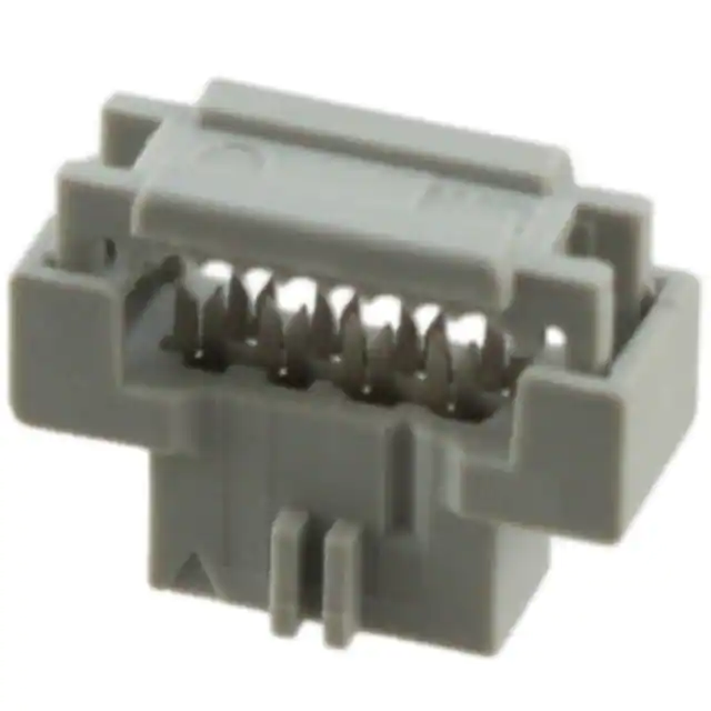

    8 Position Rectangular Socket Connector IDC Gold 28 AWG
158208-0120 数据手册
8 7 6 5 4 3 2 1 NOTES Ribbon Cable Socket 2 mm X 2 mm Pitch 158 Series 5.22 .206 2 PLATING: 2.03-3.81 m [80-150 NICKEL UNDERPLATE 0.38 m [15 in] OR 0.76 m [30 in] AVG GOLD ON WIPING AREA. D MAXIMUM MATING PIN LENGTH 5.84 .334 4.19 .165 3 RIBBON CABLE: RECOMMENDED: 3MTM 3625 (28 AWG, 7 STRAND). .230 1.90 4.97 .075 .196 DIM G 4 APPLICATION TOOLS: 3460 PRESS (OR EQUIVALENT) 3443-119 LOCATOR PLATE, 3442-9 PLATEN SEE 3M INSTRUCTION SHEET 78-9101-2810-3. 1.75 .069 4.00 MATE POINT .158 PIN 1 INDICATOR DIM A OPTIONAL CENTER BUMP 1.63 .064 TYP 2.00 .0787 TYP TM 5 MATES WITH 3M HEADERS 159 SERIES (REFERENCE 3M DRAWING 78-5100-2359-7). (0.51 mm [.020 in] SQ, CROWNED PINS). OPTIONAL FRICTION BUMP 6 SEE THE REGULATORY INFORMATION APPENDIX (RIA) IN THE "RoHS COMPLIANCE" SECTION OF WWW.3MCONNECTOR.COM FOR COMPLIANCE INFORMATION (RIA E1 & C1 APPLY). C 2.00 .0787 11.48 1.53 .452 .060 DIM D 5.22 7 FOR PRODUCT SPECIFICATIONS AND WARRANTY INFORMATION SEE 3M 78-5102-0078-1. 8 IN THE EVENT OF CONFLICT BETWEEN THIS DATA AND THAT CONTAINED IN THE PRODUCT SPECIFICATION, THE PRODUCT SPECIFICATION TAKES PRECEDENT. PREASSEMBLED HEIGHT WITH COVER .206 D DIM E 8.99 B B .354 5.74 C G 8.48 in] REVISION DIM B DRAWING NUMBER 3M 1 MATERIAL: BODY: HIGH TEMP GLASS FILLED POLYESTER, GRAY UL94V-0 CONTACTS: COPPER ALLOY 78-5100-2358-9 TM 3.25 .226 .128 OPTIONAL NONCONDUCTIVE TRANSFER ADHESIVE WITH LINER DIM C PERFORMANCE 7 8 ASSEMBLED HEIGHT WITH COVER 1.25 A, ALL LINES ENERGIZED CURRENT: 2.00 A, 6 LINES ENERGIZED 2.75 A, 1 LINE ENERGIZED INSULATION RESISTANCE: >1X109 OHMS AT 500 VDC 5.22 G OCT 27,2017 TEMPERATURE RATING: REMOVED REV D,E,F HISTORY -55 C TO +125 C A 3.56 12.04 .140 .474 30741 OCT 28,2010 NEXT ASSEMBLY ACCESS CODES A DIVISION REV ECO ISSUE DATE AND DESCRIPTION DRFT DATE L. SCHMIDT JUL 23,2010 CHKD DATE DIVISION CODE 3M Center DO NOT SCALE DRAWING 6.03 6 1 INCHES R ASSEMBLED HEIGHT WITH COVER AND STRAIN RELIEF THIRD ANGLE PROJECTION INTERPRET PER ASME Y14.5 - 2009 UL FILE NO: E68080 MAX SURFACE ROUGHNESS 125 ALL SURFACES MARKED ONLY 8 7 6 5 4 3 St. Paul, TOLERANCES EXCEPT AS NOTED SCALE METRIC [ENGLISH] STRAIN RELIEF LDS SF DRFT CHKD INITIAL RELEASE DESIGN REFERENCE .238 SBC SAN UPDATED PERFORMANCE TABLE WITHSTANDING VOLTAGE: 500 VACrms AT SEA LEVEL .206 DIM F 73037 2 .0 .00 .000 .0000 MILLIMETERS 0 2 .0 .5 .00 .13 .000 .005 ANGLES 1 MN 55144 MFG DATE APPVL DATE S. FELDMAN JUL 30,2010 C 3M COPYRIGHT 2017 This document and the information it contains are 3M property and may not be reproduced or further distributed without 3M permission, or used or disclosed other than for 3M authorized purposes. All rights reserved. TITLE 3M RIBBON CABLE SOCKET 2 MM x 2 MM PITCH 158 SERIES CAGE SIZE DRAWING NO. NUMBER REV. 78-5100-2358-9 MODEL DET. LISTS 1 YES NO G SHT 1 OF 3 Imaged: G.1 Central Standard Time10/27/2017UTC Offset COVER A 8 7 6 5 4 3 2 1 3MTM Ribbon Cable Socket 2 mm X 2 mm Pitch 158 Series NUMBER OF POSITIONS 6 8 10 12 14 16 20 22 24 26 30 34 40 44 50 D DIM A 6.39 8.39 10.39 12.39 14.39 16.39 20.39 22.39 24.39 26.39 30.39 34.39 40.39 44.39 50.39 [.252] [.330] [.409] [.488] [.567] [.645] [.803] [.882] [.960] [1.039] [1.197] [1.354] [1.590] [1.748] [1.984] DIM B 12.64 14.64 16.64 18.64 20.64 22.64 26.64 28.64 30.64 32.64 36.64 40.64 46.64 50.64 56.64 [.497] [.576] [.655] [.734] [.812] [.891] [1.049] [1.127] [1.206] [1.285] [1.442] [1.600] [1.836] [1.994] [2.230] DIM C 8.98 10.98 12.98 14-98 16.98 18.98 22.98 24.98 26.98 28.98 32.98 36.98 42.98 46.98 52.98 DIM D [.354] [.432] [.511] [.590] [.669] [.747] [.905] [.984] [1.062] [1.141] [1.299] [1.456] [1.692] [1.850] [2.086] 10.81 12.81 14.81 16.81 18.81 20.81 24.81 26.81 28.81 30.81 34.81 38.81 44.81 48.81 54.81 DIM E [.426] [.504] [.583] [.662] [.741] [.819] [.977] [1.056] [1.134] [1.213] [1.371] [1.528] [1.764] [1.922] [2.158] 11.32 13.32 15.32 17.32 19.32 21.32 25.32 27.32 29.32 31.32 35.32 39.32 45.32 49.32 55.32 [.446] [.524] [.603] [.682] [.761] [.839] [.997] [1.076] [1.154] [1.233] [1.391] [1.548] [1.784] [1.942] [2.178] DIM F 12.64 14.64 16.64 18.64 20.64 22.64 26.64 28.64 30.64 32.64 36.64 40.64 46.64 50.64 56.64 DIM G [.497] [.576] [.655] [.734] [.812] [.891] [1.049] [1.127] [1.206] [1.285] [1.442] [1.600] [1.836] [1.994] [2.230] N/A N/A N/A N/A 8.00 [.315] 10.00 [.394] 14.00 [.551] 16.00 [.630] 18.00 [.709] 20.00 [.787] 24.00 [.945] 28.00 [1.102] 34.00 [1.339] 38.00 [1.496] 44.00 [1.732] D C CENTER BUMP WITH FRICTION BUMP OPTION 14-50 POSITIONS CENTER FRICTION BUMP OPTION 6-12 POSITIONS ONLY ORDERING INFORMATION TIER 1 - BEST B 1581XX-1X00 TIER 1 = BEST PLATING BLANK = 0.76 m [30 in] GOLD POSITION COUNT (SEE TABLE) PART CONFIGURATION 1 = ADHESIVE COVER PACKAGING 0 = TRAY TIER 2 - BETTER TIER 3 - VALUE 1582XX-0X20XX 1583XX-211015 TIER 2 = BETTER TIER 3 = VALUE POSITION COUNT (SEE TABLE) PLATING BLANK = 0.76 m [30 in] GOLD 15 = 0.38 m [15 in] GOLD PART CONFIGURATION 0 = PREASSEMBLED COVER PACKAGING 2 = SWORDS PART CONFIGURATION 2 = SEPARATE COVER B PLATING 15 = 0.38 m [15 in] GOLD POSITION COUNT (SEE TABLE) PACKAGING 1 = BULK PACK POLARIZATION/LATCHING POLARIZATION/LATCHING POLARIZATION/LATCHING 1 = WITH CENTER BUMP, NO FRICTION BUMPS (6-50 POS) 0 = NO CENTER BUMP, NO FRICTION BUMPS (6-50 POS) 1 = WITH CENTER BUMP, NO FRICTION BUMPS (6-50 POS) G 73037 OCT 27,2017 UPDATED PERFORMANCE TABLE 1 = WITH CENTER BUMP, NO FRICTION BUMPS, (6-50 POS) REMOVED REV D,E,F HISTORY A 2 = WITH CENTER BUMP AND DUAL FRICTION BUMPS (14-50 POS ONLY) 30741 OCT 28,2010 DESIGN REFERENCE NEXT ASSEMBLY ACCESS CODES DIVISION REV ECO ISSUE DATE AND DESCRIPTION DRFT DATE L. SCHMIDT JUL 23,2010 CHKD DATE DIVISION CODE 3M Center DO NOT SCALE DRAWING STRAIN RELIEF 3448-158XX 6 1 INCHES THIRD ANGLE PROJECTION INTERPRET PER ASME Y14.5 - 2009 MAX SURFACE ROUGHNESS 125 ALL SURFACES MARKED ONLY 7 6 5 4 3 St. Paul, TOLERANCES EXCEPT AS NOTED SCALE METRIC [ENGLISH] POSITION COUNT (SEE TABLE) 8 LDS SF DRFT CHKD INITIAL RELEASE 3 = WITH CENTRAL FRICTION BUMP, NO CENTER BUMP (6-12 POS ONLY) A SBC SAN 2 .0 .00 .000 .0000 MILLIMETERS 0 2 .0 .5 .00 .13 .000 .005 ANGLES 1 MN 55144 MFG DATE APPVL DATE S. FELDMAN JUL 30,2010 C 3M COPYRIGHT 2017 This document and the information it contains are 3M property and may not be reproduced or further distributed without 3M permission, or used or disclosed other than for 3M authorized purposes. All rights reserved. TITLE 3M RIBBON CABLE SOCKET 2 MM x 2 MM PITCH 158 SERIES CAGE SIZE DRAWING NO. NUMBER REV. 78-5100-2358-9 MODEL DET. LISTS 1 YES NO G SHT 2 OF 3 Imaged: G.1 Central Standard Time10/27/2017UTC Offset CENTER BUMP OPTION ALL POSITIONS DRAWING NUMBER SOCKET WITHOUT OPTIONS ALL POSITIONS 78-5100-2358-9 G REVISION C A 8 7 6 5 4 3 2 1 3MTM Ribbon Cable Socket 2 mm X 2 mm Pitch 158 Series D D POLARIZING KEY 3435-152200 C DRAWING NUMBER 78-5100-2358-9 G REVISION C B G 73037 OCT 27,2017 SBC SAN UPDATED PERFORMANCE TABLE POLARIZING KEY ORIENTATION AND INSTALLATION REMOVED REV D,E,F HISTORY A 30741 OCT 28,2010 LDS SF DRFT CHKD INITIAL RELEASE DESIGN REFERENCE NEXT ASSEMBLY ACCESS CODES A DIVISION REV ECO ISSUE DATE AND DESCRIPTION DRFT DATE L. SCHMIDT JUL 23,2010 CHKD DATE DIVISION CODE 3M Center DO NOT SCALE DRAWING 1 1 INCHES METRIC [ENGLISH] THIRD ANGLE PROJECTION INTERPRET PER ASME Y14.5 - 2009 RIBBON CABLE SOCKET ACCESSORIES MAX SURFACE ROUGHNESS 125 ALL SURFACES MARKED ONLY 8 7 6 5 4 3 St. Paul, TOLERANCES EXCEPT AS NOTED SCALE 2 .0 .00 .000 .0000 MILLIMETERS 0 2 .0 .5 .00 .13 .000 .005 ANGLES 1 MN 55144 MFG DATE APPVL DATE S. FELDMAN JUL 30,2010 C 3M COPYRIGHT 2017 This document and the information it contains are 3M property and may not be reproduced or further distributed without 3M permission, or used or disclosed other than for 3M authorized purposes. All rights reserved. TITLE 3M RIBBON CABLE SOCKET 2 MM x 2 MM PITCH 158 SERIES CAGE SIZE DRAWING NO. NUMBER REV. 78-5100-2358-9 MODEL DET. LISTS 1 YES NO G SHT 3 OF 3 Imaged: G.1 Central Standard Time10/27/2017UTC Offset B A 8 7 6 5 4 3 2 1 3MTM Ribbon Cable Socket 2 mm X 2 mm Pitch 158 Series D D Technical Information: The technical information, recommendations and other statements contained in this document are based upon tests or experience that 3M believes are reliable, but the accuracy or completeness of such information is not guaranteed. Product Use: Many factors beyond 3M's control and uniquely within user's knowledge and control can affect the use and performance of a 3M product in a particular application. Given the variety of factors that can affect the use and performance of a 3M product, user is solely responsible for evaluating the 3M product and determining whether it is fit for a particular purpose and suitable for user's method of application. C C 78-5100-2358-9 G REVISION Warranty, Limited Remedy, and Disclaimer: Unless an additional warranty is specifically stated on the applicable 3M product packaging or product literature, 3M warrants that each 3M product meets the applicable 3M product specification at the time 3M ships the product. 3M MAKES NO OTHER WARRANTIES OR CONDITIONS, EXPRESS OR IMPLIED, INCLUDING, BUT NOT LIMITED TO, ANY IMPLIED WARRANTY OR CONDITION OF MERCHANTABILITY OR FITNESS FOR A PARTICULAR PURPOSE OR ANY IMPLIED WARRANTY OR CONDITION ARISING OUT OF A COURSE OF DEALING, CUSTOM OR USAGE OF TRADE. If the 3M product does not conform to this warranty, then the sole and exclusive remedy is, at 3M's option, replacement of the 3M product or refund of the purchase price. DRAWING NUMBER Limitation of Liability: Except where prohibited by law, 3M will not be liable for any loss or damage arising from the 3M product, whether direct, indirect, special, incidental or consequential, regardless of the legal theory asserted, including warranty, contract, negligence or strict liability. B G 73037 OCT 27,2017 SBC SAN UPDATED PERFORMANCE TABLE REMOVED REV D,E,F HISTORY A 30741 OCT 28,2010 LDS SF DRFT CHKD INITIAL RELEASE DESIGN REFERENCE NEXT ASSEMBLY ACCESS CODES A DIVISION REV ECO ISSUE DATE AND DESCRIPTION DRFT DATE L. SCHMIDT JUL 23,2010 CHKD DATE DIVISION CODE 3M Center DO NOT SCALE DRAWING 3M ELECTRONICS MATERIALS SOLUTIONS DIVISION INTERCONNECT SOLUTIONS http://www.3m.com/Interconnect 1 1 INCHES THIRD ANGLE PROJECTION INTERPRET PER ASME Y14.5 - 2009 3M IS A TRADEMARK OF 3M COMPANY. FOR TECHNICAL, SALES OR ORDERING INFORMATION CALL 800-225-5373 MAX SURFACE ROUGHNESS 125 ALL SURFACES MARKED ONLY 8 7 6 5 4 3 St. Paul, TOLERANCES EXCEPT AS NOTED SCALE 2 .0 .00 .000 .0000 MILLIMETERS 0 2 .0 .5 .00 .13 .000 .005 ANGLES 1 MN 55144 MFG DATE APPVL DATE S. FELDMAN JUL 30,2010 C 3M COPYRIGHT 2017 This document and the information it contains are 3M property and may not be reproduced or further distributed without 3M permission, or used or disclosed other than for 3M authorized purposes. All rights reserved. TITLE 3M RIBBON CABLE SOCKET 2 MM x 2 MM PITCH 158 SERIES CAGE SIZE DRAWING NO. NUMBER REV. 78-5100-2358-9 MODEL DET. LISTS 1 YES NO G SHT 3 OF 3 Imaged: G.1 Central Standard Time10/27/2017UTC Offset B A
158208-0120
物料型号:3M品牌的带状电缆插座,具体型号未在文档中明确。
器件简介:该插座适用于2毫米间距的带状电缆,具有多种配置选项,如不同的镀金层厚度、是否带有中心凸起和摩擦凸起等。
引脚分配:文档中未明确列出具体的引脚分配,但提到了与3M 159系列插座的兼容性。
参数特性: - 电流:所有线路激活时1.25A,6线路激活时2.00A,单线路激活时2.75A。 - 绝缘电阻:大于1100欧姆,在500V直流下。 - 耐电压:3000伏交流有效值,海平面条件下。 - 温度范围:-55°C至+125°C。
功能详解:文档提供了详细的装配图和性能表,包括不同配置的尺寸和性能参数。
应用信息:适用于需要带状电缆连接的应用,文档中提到了3M 3625型号的带状电缆作为推荐使用。
封装信息:提供了详细的机械尺寸和装配高度,以及不同配置的选项。
