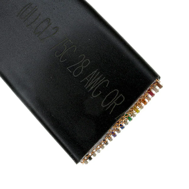

3M™ Shielded/Jacketed, Flat Cable .050" 28 AWG Stranded, Twisted Pair, PVC/PVC 1785 Series • Meets external wiring requirements of National Electrical Code, Article 725 • UL listed for US and Canadian markets • Expanded copper shielding provides easier termination than aluminum/mylar shielding • 360 degree expanded copper shielding provides 20 db average shielding effectiveness • Twist and flat repeat has variable length options • See Regulatory Information Appendix (RIA) for chemical compliance information (RIA E1 & C1 apply) Date Modified: May 5, 2009  TS-0308-C Sheet 1 of 2 Physical Jacket Material: Polyvinyl Chloride (PVC) Color: Black Primary Material: PVC Color: 10 Color Repeat with Tan Common (UL) CL2 75C 28 AWG OR AWM 2912 3M NU Marking Standard: C AWM IIA/B 80C 150V FT1 EU 1 × 109 Ω/10 ft. [ 3 m ] Balanced Characteristic Impedance: Unbalanced Capacitance: Inductance: Propagation Delay: Velocity of Propagation: Canada: 150V 67 Ω 118 Ω 24.7 pF/ft [ 81.0 pF/m ] 13.8 pF/ft [ 45.3 pF/m ] EU:

物料型号:3M™ Shielded/Jacketed, Flat Cable 1785 Series
器件简介:该电缆满足美国国家电气代码第725条的外部布线要求,适用于美国和加拿大市场,具有360度扩展铜屏蔽,提供20 dB平均屏蔽效能。
引脚分配:文档中未明确列出引脚分配,但提到了导体为28 AWG,7×36 AWG [7ר 0.127] 镀锡绞合铜。
参数特性: - 电压等级:美国150V,加拿大150V,欧盟<50V - 绝缘电阻:> 1 × 10^9 Ω/10 ft. [3 m] - 特性阻抗:非平衡67 Ω,平衡118 Ω - 电容:24.7 pF/ft [81.0 pF/m](非平衡),13.8 pF/ft [45.3 pF/m](平衡) - 电感:0.11 μH/ft [0.36 μH/m](非平衡),0.19 μH/ft [0.62 μH/m](平衡) - 传播延迟:1.65 ns/ft [5.41 ns/m](非平衡),1.63 ns/ft [5.35 ns/m](平衡) - 传播速度:62%
功能详解:电缆设计用于满足特定的电气和环境要求,具有可变长度选项的扭曲和平坦重复,以及可定制的扁平重复长度。
应用信息:适用于需要屏蔽和特定电气特性的应用,如电源限制电路电缆。
