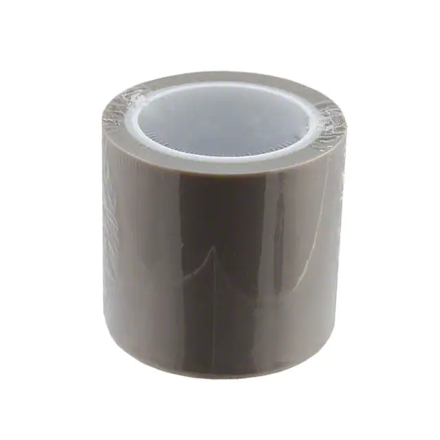

    TAPE PTFE FILM 2" X 5YD
2-5-5481 数据手册
PTFE Skived Film Tape 5480 • 5481 Technical Data October, 2016 Product Description 3M™ PTFE Skived Film Tape 5480 and 5481 tapes offer an extremely low coefficient of friction which, in combination with a pressure sensitive silicone adhesive, creates a smooth, non-stick surface over a variety of substrates to assist in the movement of web materials in many types of roll-wrap applications Product Construction Backing Adhesive Color Standard Roll Length Skived PTFE (polytetrafluoroethylene) Silicone Gray 36 yds. (32.9 m) Typical Physical Properties Note: The following technical information and data should be considered representative or typical only and should not be used for specification purposes. ASTM Test Method 3M tape 5480 Adhesion to Steel: Tensile Strength: Elongation at Break: Backing Thickness: Total Tape Thickness: Temperature Use Range: 20 oz./in. width (22 N/100 mm) 26 lbs./in. width (461 N/100 mm) 140% 2.0 mils (0.05 mm) 3.7 mils (0.09 mm) -65° to 500°F (-54° to 260°C) D-3330 D-3759 32 oz./in. width (35 N/100 mm) 59 lbs./in. width (1039 N/100 mm) 290% 5.0 mils (0.13 mm) 6.8 mils (0.17 mm) -65° to 500°F (-54° to 260°C) D-3330 D-3759 D-3759 D-3652 D-3652 3M tape 5481 Adhesion to Steel: Tensile Strength: Elongation at Break: Backing Thickness: Total Tape Thickness: Temperature Use Range: Features D-3759 D-3652 D-3652 • Skived 3M™ PTFE Film Tapes are more conformable than typical extruded PTFE film tapes. • Provides excellent chemical resistance except to organic solvents. Note: The silicone adhesive will be attacked by commercial organic solvents and so are not recommended for applications requiring organic resistance. • Silicone adhesive provides clean removal from a variety of surfaces. • Non-stick PTFE film provides an exceptionally slick surface for easy clean-up. 3M™ PTFE Skived Film Tape 5480• 5481 Application Ideas • Easy-release surface provided by wrapping rollers, plates, belts, etc. where buildup of sticky materials and inks can occur.  Shielding and protecting against chemicals.  Mold release for composite or metal bonding.  High temperature wire bundling and harnessing.  High strength and abrasion resistance reduce friction between surfaces, minimizing squeak and noise.  Wide temperature range for performance on heated machinery and equipment. CAUTION: When PTFE film tape is exposed to temperatures above 600°F (316°C), small quantities of hazardous vapors may be released. INHALATION OF THESE VAPORS MAY BE HARMFUL OR MAY CAUSE RESPIRATORY TRACT IRRITATION. Do not heat or expose PTFE film tape to temperatures above 600°F (316°C). Storage Store under normal conditions of 60° to 80°F (16° to 27°C) and 40 to 60% R.H. in the original carton. Shelf Life To obtain best performance, use this product within 24 months from date of manufacture. Technical Information The technical information, recommendations and other statements contained in this document are based upon tests or experience that 3M believes are reliable, but the accuracy or completeness of such information is not guaranteed. Product Use Many factors beyond 3M’s control and uniquely within user’s knowledge and control can affect the use and performance of a 3M product in a particular application. Given the variety of factors that can affect the use and performance of a 3M product, user is solely responsible for evaluating the 3M product and determining whether it is fit for a particular purpose and suitable for user’s method of application. Warranty, Limited Remedy, and Disclaimer Limitation of Liability Unless an additional warranty is specifically stated on the applicable 3M product packaging or product literature, 3M warrants that each 3M product meets the applicable 3M product specification at the time 3M ships the product. 3M MAKES NO OTHER WARRANTIES OR CONDITIONS, EXPRESS OR IMPLIED, INCLUDING, BUT NOT LIMITED TO, ANY IMPLIED WARRANTY OR CONDITION OF MERCHANTABILITY OR FITNESS FOR A PARTICULAR PURPOSE OR ANY IMPLIED WARRANTY OR CONDITION ARISING OUT OF A COURSE OF DEALING, CUSTOM OR USAGE OF TRADE. If the 3M product does not conform to this warranty, then the sole and exclusive remedy is, at 3M’s option, replacement of the 3M product or refund of the purchase price. Except where prohibited by law, 3M will not be liable for any loss or damage arising from the 3M product, whether direct, indirect, special, incidental or consequential, regardless of the legal theory asserted, including warranty, contract, negligence or strict liability. ISO 9001: 2000 This Industrial Adhesives and Tapes Division product was manufactured under a 3M quality system registered to ISO 9001: 2000 standards. 3 Industrial Business Industrial Adhesives and Tapes Division 3M Center, Building 220-3S-06 800-362-3550 · 577-369-2923 (Fax) www.3M.com/industrial Recycled Paper 40% pre-consumer 10% post-consumer 3M is a trademark of 3M Company. Printed in U.S.A. ©3M 2016
