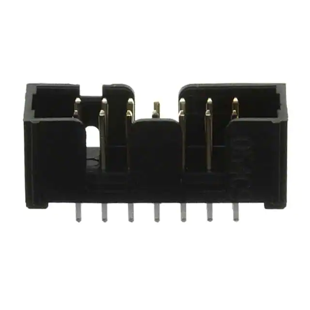

8 7 6 5 4 3 2 1 NOTES 3MTM FOUR-WALL HEADER, 2500 SERIES 1. REGULATORY INFORMATION: VISIT 3M.com/regs * LOW PROFILE, SPACE SAVING DESIGN. * CENTER SLOT POLARIZATION PREVENTS MIS-INSERTIONS AND REDUCES INSERTION TIME. * DUAL SLOT POLARIZATION MEANS BROADER COMPATIBILITY WITH COMPETITIVE POLARIZATION DESIGNS (NOT AVAILABLE ON 6, 8 OR 10 POSITIONS). * OPTIONAL RETAINER CLIP FOR LOCKING SOCKETS IN PLACE AND INCREASING CONNECTION RELIABILITY IN VIBRATION-PRONE ENVIRONMENTS. * HIGH TEMPERATURE INSULATOR SUITABLE FOR "NO LEAD" SOLDERING OPERATIONS. * THROUGH HOLE VERSION SUITABLE FOR REFLOW SOLDERING USING "PASTE IN HOLE" TECHNIQUES. * EXPOSED SOLDER TAILS (ON RIGHT ANGLE VERSION) PROVIDE EASE OF CLEANING AND REDUCED REPAIR COST. * STRAIGHT SURFACE MOUNT VERSION AVAILABLE. .100" X .100" LOW PROFILE, SURFACE MOUNT, STRAIGHT AND RIGHT ANGLE THROUGH-HOLE D 2 3 NOTCHES A & C WILL ACCOMODATE 3M POLARIZING KEY: N3518. 4 CONTACT TAILS .0245 [.622] WIRE WITH .0075 [.191] CORNER RADII AND .028 [.072] DIAGONAL. 5 SOLDER STANDOFFS FACILITATE .01 [.3] CLEARANCE ABOVE BOARD FOR REFLOW SOLDERING. X25XX-60XX STRAIGHT VERSION C HIGH TEMPERATURE GLASS FILLED POLYESTER (PCT) UL94V-0 BLACK COPPER ALLOY NICKEL UNDERPLATE (SEE ORDERING INFORMATION) GOLD (SEE ORDERING INFORMATION) MATTE TIN (SEE ORDERING INFORMATION) 3M LOGO, PART IDENTIFICATION NUMBER AND ORIENTATION TRIANGLE C ELECTRICAL: S DRAWING NUMBER 78-5100-0770-7 2 REVISION CURRENT RATING: 5.00A, 1 CONTACT POWERED 3.00A, 6 CONTACTS POWERED 1.75A, ALL CONTACTS POWERED RATING CONDITIONS: EIA-364-070 METHOD 2, 30 C MAXIMUM TEMPERATURE RISE, 20% DERATED. REFERENCE APPROPRIATE 3M PRODUCT SPECIFICATION FOR DETAILED CURRENT DERATING CURVES. INSULATION RESISTANCE: >1 X 109 AT 500 VDC WITHSTANDING VOLTAGE: 1,000VRMS AT SEA LEVEL X25XX-50XX ENVIRONMENTAL: TEMPERATURE RATING: -55 C TO 105 C PROCESS RATING: 260 C, PER J-STD-020C, SINGLE PASS MOISTURE SENSITIVITY LEVEL: 1 (PER J-STD-020C) RIGHT ANGLE VERSION D PHYSICAL: INSULATOR: MATERIAL: FLAMMABILITY: COLOR: CONTACT: MATERIAL: PLATING: UNDER PLATING: WIPING AREA: SOLDER TAILS: MARKINGS: 2 2 IN THE EVENT OF CONFLICT BETWEEN THIS DATA AND THAT CONTAINED IN THE PRODUCT SPECIFICATION, THE PRODUCT SPECIFICATION TAKES PRECEDENT. B S 0100884 NOV 03,2021 LDS FJR CHANGED LATCH AND P/N R 97909 JUN 22,2021 JNC SAN REVISED ORDERING INFO P 89702 JUL 08,2020 JNC SN JNC SC JNC RS DRFT CHKD REVISE DRAWING PER NEW HEADER MODEL N X25XX-6V0C DIMENSIONS: INCHES [MM] [MM] IS REF. ONLY SURFACE MOUNT VERSION DESIGN REFERENCE NEXT ASSEMBLY ACCESS CODES A DIVISION 3M ELECTRONIC MATERIALS SOLUTIONS DIVISION INTERCONNECT SOLUTIONS http://www.3mconnectors.com R 8 4 1 THIRD ANGLE PROJECTION MAX SURFACE ROUGHNESS UL FILE NO: E68080 7 6 5 4 3 REVISE DIM ON SHT2 & CLIP CHART ON SHT5 56068 M AUG 11,2014 REVISED AND REDRAWN REV ECO ISSUE DATE AND DESCRIPTION DRFT DATE CASTIGLIONE AUG 11,2014 CHKD DATE C EMSD 3M Center St. Paul, TOLERANCES EXCEPT AS NOTED SCALE INTERPRET PER ASME Y14.5 - 2018 3M IS A TRADEMARK OF 3M COMPANY. FOR TECHNICAL, SALES OR ORDERING INFORMATION CALL 800-225-5373 AUG 02,2016 DIVISION CODE Interconnect Solutions DO NOT SCALE DRAWING 68908 ALL SURFACES MARKED ONLY 2 INCHES .0 .1 .00 .01 .000 .005 .0000 .0002 MILLIMETERS 0 2 .0 .3 .00 .13 .000 .005 ANGLES MN 55144 MFG DATE APPVL DATE R. SCHERER SEP 05,2014 3M COPYRIGHT 2021 This document and the information it contains are 3M property and may not be reproduced or further distributed without 3M permission, or used or disclosed other than for 3M authorized purposes. All rights reserved. TITLE HEADER, 4-WALL, LO-PRO, .100 X .100, SMT, STRAIGHT & RA CAGE SIZE NUMBER MODEL 2500 DRAWING NO. REV. 78-5100-0770-7 DET. LISTS 1 YES NO S SHT 1 OF 6 Imaged: Central Standard Time 11/5/2021 -- UTC Offset (hrs) 6 B A 8 7 6 5 4 3 2 1 3MTM FOUR-WALL HEADER, 2500 SERIES .100" X .100" LOW PROFILE, SURFACE MOUNT, STRAIGHT AND RIGHT ANGLE THROUGH-HOLE DIM. "B" NOTCH E NOTCH D D D .228 .025 .338 .250 5.79 0.64 8.59 6.35 SQ. TYP. .100 .253 2.54 NOTCH "B" (SEE TABLE 1) .243 6.43 6.17 .100 .194 4.93 2.54 .17 A-A NOTCH "C" (SEE TABLE 1 & NOTE 3) C .588 [14.94] .688 [17.48] .788 [20.02] .988 [25.10] 1.088 [27.64] 1.288 [32.72] 1.488 [37.80] 1.588 [40.34] 1.788 [45.42] 1.988 [50.50] 2.088 [53.04] 2.288 [58.12] 2.788 [70.82] 3.288 [83.52] 3.488 [88.60] .508 [12.90] .608 [15.44] .708 [17.98] .908 [23.06] 1.008 [25.60] 1.208 [30.68] 1.408 [35.76] 1.508 [38.30] 1.708 [43.38] 1.908 [48.46] 2.008 [51.00] 2.208 [56.08] 2.708 [68.78] 3.208 [81.48] 3.408 [86.56] .200 [5.08] .300 [7.62] .400 [10.16] .600 [15.24] .700 [17.78] .900 [22.86] 1.100 [27.94] 1.200 [30.48] 1.400 [35.56] 1.600 [40.64] 1.700 [43.18] 1.900 [22.86] 2.400 [60.96] 2.900 [73.66] 3.100 [78.74] POLARIZING NOTCHES B B BC BCDE ABCDE ABCDE ABCDE ABCDE ABCDE ABCDE ABCDE ABCDE ABCDE ABCDE ABCDE 9.91 PIN QTY. 06 08 10 14 16 20 24 26 30 34 36 40 50 60 64 .04 1.1 S DIM. "C" REVISION DIM. "B" A DIM. "C" DIM. "A" DRAWING NUMBER DIM. "A" .400 10.16 MIN. END STACKABILITY .035 0.89 .250 6.35 MIN. SIDE STACKABILITY .172 4.37 .003 .003 B 0.08 AFTER PLATING TYP. 0.08 .100 .003 2.54 0.08 S 0100884 NOV 03,2021 LDS FJR CHANGED LATCH AND P/N R .035 0.89 ORDERING INFORMATION STRAIGHT VERSION X25XX-60XX-XX A N = RB PLATING REQ'D D = AR PLATING REQ'D (02 SOLDER TAIL ONLY) .100 POSITION #1 .003 2.54 .050 0.08 1.27 OPTIONAL HOLE FOR POLARIZATION PEG SOLDER TAIL: 02 = FOR .062 [1.57] THICK BOARD 03 = FOR .094 TO .125 [2.39 TO 3.18] THICK BOARD (SOLDER TAIL LENGTH ONLY AVAILABLE ON N25XX-60XX-RB) 7 P 0.08 89702 0.08 N JNC SN 68908 AUG 02,2016 JNC SC JNC RS DRFT CHKD REVISE DIM ON SHT2 & CLIP CHART ON SHT5 RECOMMENDED HOLE PATTERN SHOWN FROM COMPONENT SIDE 56068 DESIGN REFERENCE NEXT ASSEMBLY DIVISION DO NOT SCALE DRAWING ECO ISSUE DATE AND DESCRIPTION DRFT DATE CASTIGLIONE AUG 11,2014 CHKD DATE C EMSD 3M Center St. Paul, TOLERANCES EXCEPT AS NOTED SCALE 4 1 THIRD ANGLE PROJECTION INTERPRET PER ASME Y14.5 - 2018 MAX SURFACE ROUGHNESS ALL SURFACES 3 REV DIVISION CODE Interconnect Solutions 4 AUG 11,2014 REVISED AND REDRAWN ACCESS CODES RB = 30 " [0.76 m] GOLD AVG. 50 -150 [1.27 m-3.81 m] NICKEL UNDERPLATE 25 -200 " [0.63 m-5.08 m] MATTE TIN 5 JUL 08,2020 REVISE DRAWING PER NEW HEADER MODEL M 6 JNC SAN REVISED ORDERING INFO .003 MARKED ONLY 8 JUN 22,2021 .003 PLATING: AR = 10 " [0.25 m] GOLD AVG. 50 -150 [1.27 m-3.81 m] NICKEL UNDERPLATE 40 -120 " [1.02 m-3.05 m] MATTE TIN PIN QUANTITY: (SEE TABLE 1) 97909 2 INCHES .0 .1 .00 .01 .000 .005 .0000 .0002 MILLIMETERS 0 2 .0 .3 .00 .13 .000 .005 ANGLES MN 55144 MFG DATE APPVL DATE R. SCHERER SEP 05,2014 3M COPYRIGHT 2021 This document and the information it contains are 3M property and may not be reproduced or further distributed without 3M permission, or used or disclosed other than for 3M authorized purposes. All rights reserved. TITLE HEADER, 4-WALL, LO-PRO, .100 X .100, SMT, STRAIGHT & RA CAGE SIZE NUMBER MODEL 2500 DRAWING NO. REV. 78-5100-0770-7 DET. LISTS 1 YES NO S SHT 2 OF 6 Imaged: Central Standard Time 11/5/2021 -- UTC Offset (hrs) 6 B 4.19 A .390 TABLE 1 PIN QTY. 06 08 10 14 16 20 24 26 30 34 36 40 50 60 64 SEE LAST SHEET, DETAIL E FOR A REFERENCE ON PLACEMENT OF POST LIP ON BODY .165 POSITION 1 ORIENTATION TRIANGLE C VIEW WITH OPTIONAL POLARIZING POST 3201-3 4.4 NOTCH "A" (SEE TABLE 1 & NOTE 3) 78-5100-0770-7 SECTION SOLDER TAIL .112 .011 [2.84] FOR 02 VERSION .155 .011 [3.94] FOR 03 VERSION A 8 7 6 5 4 3 2 1 3MTM FOUR-WALL HEADER, 2500 SERIES .100" X .100" LOW PROFILE, SURFACE MOUNT, STRAIGHT AND RIGHT ANGLE THROUGH-HOLE DIM. "B" NOTCH D .025 NOTCH E 0.64 SQ. TYP. D D .228 .253 .390 .243 6.43 .338 .250 5.79 8.59 6.35 6.17 9.91 .100 2.54 NOTCH "B" (SEE TABLE 1) .100 .194 4.93 .100 2.54 2.54 SOLDER TAIL .112 .011 [2.84] FOR 02 VERSION .155 .011 [3.94] FOR 03 VERSION SECTION .24 .03 6.0 0.9 NOTCH "A" (SEE TABLE 1 & NOTE 3) .165 B-B 4.19 POSITION 1 ORIENTATION TRIANGLE B .25 NOTCH "C" (SEE TABLE 1 & NOTE 3) 6.4 C C VIEW WITH OPTIONAL VACUUM CLIP .390 9.91 TABLE 1 .508 [12.90] .608 [15.44] .708 [17.98] .908 [23.06] 1.008 [25.60] 1.208 [30.68] 1.408 [35.76] 1.508 [38.30] 1.708 [43.38] 1.908 [48.46] 2.008 [51.00] 2.208 [56.08] 2.708 [68.78] 3.208 [81.48] 3.408 [86.56] .200 [5.08] .300 [7.62] .400 [10.16] .600 [15.24] .700 [17.78] .900 [22.86] 1.100 [27.94] 1.200 [30.48] 1.400 [35.56] 1.600 [40.64] 1.700 [43.18] 1.900 [22.86] 2.400 [60.96] 2.900 [73.66] 3.100 [78.74] PIN QTY. 06 08 10 14 16 20 24 26 30 34 36 40 50 60 64 .04 1.1 B S .588 [14.94] .688 [17.48] .788 [20.02] .988 [25.10] 1.088 [27.64] 1.288 [32.72] 1.488 [37.80] 1.588 [40.34] 1.788 [45.42] 1.988 [50.50] 2.088 [53.04] 2.288 [58.12] 2.788 [70.82] 3.288 [83.52] 3.488 [88.60] POLARIZING NOTCHES B B BC BCDE ABCDE ABCDE ABCDE ABCDE ABCDE ABCDE ABCDE ABCDE ABCDE ABCDE ABCDE REVISION DIM. "C" DIM. "C" DIM. "A" DRAWING NUMBER DIM. "B" 78-5100-0770-7 DIM. "A" .41 10.4 MAX. DIM. TO EDGE OF PCB FOR BUSSING B .100 .400 10.16 2.54 .003 0.08 MIN. END STACKABILITY S 0100884 NOV 03,2021 LDS FJR CHANGED LATCH AND P/N R 97909 JUN 22,2021 JNC SAN REVISED ORDERING INFO .035 .100 2.54 ORDERING INFORMATION RIGHT ANGLE VERSION X25XX-50XX-XX .003 0.89 POSITION #1 0.08 N = RB PLATING REQ'D D = AR PLATING REQ'D (02 SOLDER TAIL ONLY) SOLDER TAIL: 02 = FOR .062 [1.57] THICK BOARD 03 = FOR .094 TO .125 [2.39 TO 3.18] THICK BOARD (SOLDER TAIL LENGTH ONLY AVAILABLE ON N25XX-50XX-RB) RECOMMENDED HOLE PATTERN 7 N 68908 DESIGN REFERENCE NEXT ASSEMBLY DIVISION 56068 DO NOT SCALE DRAWING REV ECO ISSUE DATE AND DESCRIPTION DRFT DATE CASTIGLIONE AUG 11,2014 CHKD DATE C EMSD 3M Center St. Paul, TOLERANCES EXCEPT AS NOTED SCALE 4 1 THIRD ANGLE PROJECTION ALL SURFACES 3 AUG 11,2014 DIVISION CODE Interconnect Solutions 4 AUG 02,2016 JNC SC JNC RS DRFT CHKD REVISED AND REDRAWN MAX SURFACE ROUGHNESS 5 SN REVISE DIM ON SHT2 & CLIP CHART ON SHT5 INTERPRET PER ASME Y14.5 - 2018 6 JNC REVISE DRAWING PER NEW HEADER MODEL ACCESS CODES RB = 30 " [0.76 m] GOLD AVG. 50 -150 [1.27 m-3.81 m] NICKEL UNDERPLATE 25 -200 " [0.63 m-5.08 m] MATTE TIN JUL 08,2020 0.08 MARKED ONLY 8 89702 M PLATING: AR = 10 " [0.25 m] GOLD AVG. 50 -150 [1.27 m-3.81 m] NICKEL UNDERPLATE 40 -120 " [1.02 m-3.05 m] MATTE TIN PIN QUANTITY: (SEE TABLE 1) P AFTER PLATING TYP. SHOWN FROM COMPONENT SIDE A .003 2 INCHES .0 .1 .00 .01 .000 .005 .0000 .0002 MILLIMETERS 0 2 .0 .3 .00 .13 .000 .005 ANGLES MN 55144 MFG DATE APPVL DATE R. SCHERER SEP 05,2014 3M COPYRIGHT 2021 This document and the information it contains are 3M property and may not be reproduced or further distributed without 3M permission, or used or disclosed other than for 3M authorized purposes. All rights reserved. TITLE HEADER, 4-WALL, LO-PRO, .100 X .100, SMT, STRAIGHT & RA CAGE SIZE NUMBER MODEL 2500 DRAWING NO. REV. 78-5100-0770-7 DET. LISTS 1 YES NO S SHT 3 OF 6 Imaged: Central Standard Time 11/5/2021 -- UTC Offset (hrs) 6 B PIN QTY. 06 08 10 14 16 20 24 26 30 34 36 40 50 60 64 A 8 7 6 5 4 3 2 1 3MTM FOUR-WALL HEADER, 2500 SERIES .100" X .100" LOW PROFILE, SURFACE MOUNT, STRAIGHT AND RIGHT ANGLE THROUGH-HOLE DIM. "B" NOTCH E NOTCH D VACUUM CAP REMOVED FOR CLARITY D .025 .253 REEL PKG CODE D .228 0.64 SQ. TYP. .338 .250 5.79 8.59 6.35 6.43 COVER TAPE 13.0 330 REELING DIRECTION .243 2.54 6.17 VACUUM CAP .36 [9.1] SQ. CENTERED ON CONN. REF. 0.25 .194 4.93 POSITION 1 .004 FOR LESS THAN 30 POS. 2.54 .006 FOR 30 AND ABOVE POS. NOTCH "A" (SEE TABLE 1 & NOTE 3) .010 0.25 SECTION C-C 4.19 POSITION 1 ORIENTATION TRIANGLE C NOTCH "C" (SEE TABLE 1 & NOTE 3) C C .035 0.89 TABLE 1 B 13.00 NOTCH "B" (SEE TABLE 1) .165 DIM. "A" DIM. "B" DIM. "C" POLARIZING NOTCHES 06 08 10 14 16 20 24 26 30 34 36 40 50 60 64 .588 [14.94] .688 [17.48] .788 [20.02] .988 [25.10] 1.088 [27.64] 1.288 [32.72] 1.488 [37.80] 1.588 [40.34] 1.788 [45.42] 1.988 [50.50] 2.088 [53.04] 2.288 [58.12] 2.788 [70.82] 3.288 [83.52] 3.488 [88.60] .508 [12.90] .608 [15.44] .708 [17.98] .908 [23.06] 1.008 [25.60] 1.208 [30.68] 1.408 [35.76] 1.508 [38.30] 1.708 [43.38] 1.908 [48.46] 2.008 [51.00] 2.208 [56.08] 2.708 [68.78] 3.208 [81.48] 3.408 [86.56] .200 [5.08] .300 [7.62] .400 [10.16] .600 [15.24] .700 [17.78] .900 [22.86] 1.100 [27.94] 1.200 [30.48] 1.400 [35.56] 1.600 [40.64] 1.700 [43.18] 1.900 [22.86] 2.400 [60.96] 2.900 [73.66] 3.100 [78.74] B B BC BCDE ABCDE ABCDE ABCDE ABCDE ABCDE ABCDE ABCDE ABCDE ABCDE ABCDE ABCDE TAPE AND REEL PKG CODE WD (44 MM) WD (44 MM) WD (44 MM) WD (44 MM) WD (44 MM) WE (56 MM) WE (56 MM) WE (56 MM) WF (72 MM) WF (72 MM) WG (88 MM) WG (88 MM) WG (88 MM) WH (120 MM) WH (120 MM) .390 PIN QTY. 9.91 06 08 10 14 16 20 24 26 30 34 36 40 50 60 64 .04 S PIN QTY. REVISION 11.18 .512 1.1 C DIM. "C" DIM. "A" B .050 1.27 .200 5.08 .470 11.94 .270 S 0100884 6.86 NOV 03,2021 LDS FJR CHANGED LATCH AND P/N .070 R 97909 JUN 22,2021 REVISED ORDERING INFO 1.78 P .100 2.54 ORDERING INFORMATION SURFACE MOUNT VERSION X25XX-6V0C-XX-XX N = RB PLATING REQ'D D = AR PLATING REQ'D 0.08 N AUG 02,2016 SN JNC SC NEXT ASSEMBLY DIVISION DO NOT SCALE DRAWING ECO ISSUE DATE AND DESCRIPTION DRFT DATE CASTIGLIONE AUG 11,2014 CHKD DATE C EMSD 3M Center St. Paul, TOLERANCES EXCEPT AS NOTED SCALE 4 1 INTERPRET PER ASME Y14.5 - 2018 MAX SURFACE ROUGHNESS ALL SURFACES MARKED ONLY 3 REV DIVISION CODE THIRD ANGLE PROJECTION RB = 30 " [0.76 m] GOLD AVG. 50 -150 [1.27 m-3.81 m] NICKEL UNDERPLATE 25 -200 " [0.63 m-5.08 m] MATTE TIN 4 AUG 11,2014 JNC RS DRFT CHKD REVISED AND REDRAWN DESIGN REFERENCE 5 56068 M RECOMMENDED PAD LAYOUT 6 JNC REVISE DIM ON SHT2 & CLIP CHART ON SHT5 PLATING: AR = 10 " [0.25 m] GOLD AVG. 50 -150 [1.27 m-3.81 m] NICKEL UNDERPLATE 40 -120 " [1.02 m-3.05 m] MATTE TIN 7 68908 TYP. Interconnect Solutions 8 JUL 08,2020 REVISE DRAWING PER NEW HEADER MODEL PACKAGING OPTIONS: WX = TAPE & REEL PACKAGING (SEE TABLE 1) PIN QUANTITY: (SEE TABLE 1) 89702 .003 ACCESS CODES A JNC SAN 2 INCHES .0 .1 .00 .01 .000 .005 .0000 .0002 MILLIMETERS 0 2 .0 .3 .00 .13 .000 .005 ANGLES MN 55144 MFG DATE APPVL DATE R. SCHERER SEP 05,2014 3M COPYRIGHT 2021 This document and the information it contains are 3M property and may not be reproduced or further distributed without 3M permission, or used or disclosed other than for 3M authorized purposes. All rights reserved. TITLE HEADER, 4-WALL, LO-PRO, .100 X .100, SMT, STRAIGHT & RA CAGE SIZE NUMBER MODEL 2500 DRAWING NO. REV. 78-5100-0770-7 DET. LISTS 1 YES NO S SHT 4 OF 6 Imaged: Central Standard Time 11/5/2021 -- UTC Offset (hrs) 6 .170 4.32 .440 .100 POCKET TAPE DRAWING NUMBER 10.16 .100 78-5100-0770-7 .400 .010 A 8 7 6 5 4 3 2 1 3MTM FOUR-WALL HEADER, 2500 SERIES .100" X .100" LOW PROFILE, SURFACE MOUNT, STRAIGHT AND RIGHT ANGLE THROUGH-HOLE PART CUSTOMIZATION D THIS SPEC SHEET DETAILS OUR STANDARD OFFERING. POLARIZING POST LOW PROFILE LATCH D 3M HAS SEVERAL CAPABILITIES THAT CAN PROVIDE A PART TAILORED TO YOUR SPECIFIC NEEDS. ASK YOUR 3M SALES REPRESENTATIVE OR CUSTOMER SERVICE FOR MORE DETAILS. .144 * SELECTIVE PIN REMOVAL (FOR BOARD ASSEMBLY POLARIZATION). * DIFFERENT PIN LENGTHS. .204 3.66 .118 5.18 3.00 POLARIZING KEY BREAKAWAY TAB .267 .825 .043 .568 20.96 6.78 .370 1.09 14.43 9.40 .09 2.2 .102 .34 .057 8.5 .118 1.45 3.00 PART NO. MATERIAL COLOR 3201-3 PCT BLACK PART NO. MATERIAL COLOR 3505-33C NYLON BLACK 0.6 3.8 NOTE: 1. LATCHES NOT COMPATIBLE WITH REFLOW SOLDERING. ATTACH LATCHES AFTER SOLDERING. 2. LATCHES ARE MEANT FOR RETENTION ONLY. 3. SEE LAST SHEET FOR ASSEMBLY. DRAWING NUMBER NOTE: 1) #2216 B/A SCOTCHWELD CAN BE USED TO ADHERE KEYS. 2) SEE INSTRUCTION SHEET 78-9100-7795-3 FOR ASSEMBLY. SHORT/LONG SOCKET RETAINER CLIP B DIM. "A" .11 2.8 MAX. UNCOATED AREA (ON BOTH EDGES) .2 5.1 .1 CLIP HEIGHT CODE 3 ALTERNATE UNCOATED AREA PIN QTY. 06 08 10 14 16 20 24 26 30 34 36 40 50 60 64 DIM. "A" N/A N/A .81 [20.6] 1.02 [25.9] 1.12 [28.4] 1.32 [33.5] 1.52 [38.7] 1.63 [41.4] 1.83 [46.4] 2.03 [51.6] N/A 2.33 [59.2] 2.83 [71.9] 3.33 [84.6] 3.53 [89.7] B S 0100884 NOV 03,2021 LDS FJR CHANGED LATCH AND P/N R 97909 JUN 22,2021 JNC SAN REVISED ORDERING INFO P 89702 JUL 08,2020 JNC SN JNC SC JNC RS DRFT CHKD REVISE DRAWING PER NEW HEADER MODEL N 68908 AUG 02,2016 REVISE DIM ON SHT2 & CLIP CHART ON SHT5 A DESIGN REFERENCE NEXT ASSEMBLY ACCESS CODES PIN COUNT (SEE TABLE) DIVISION DO NOT SCALE DRAWING 4 1 THIRD ANGLE PROJECTION INTERPRET PER ASME Y14.5 - 2018 MAX SURFACE ROUGHNESS MARKED ONLY 5 4 3 ECO ISSUE DATE AND DESCRIPTION DRFT DATE CASTIGLIONE AUG 11,2014 CHKD DATE C EMSD 3M Center St. Paul, TOLERANCES EXCEPT AS NOTED SCALE ALL SURFACES 6 REV DIVISION CODE Interconnect Solutions NOTE: 1) THE FOLLOWING RETAINER CLIPS HAVE BEEN DISCONTINUED: 3505-8064 3505-8124 3505-8150 7 AUG 11,2014 REVISED AND REDRAWN 3505-8XXX CLIP HEIGHT CODE 0 = .31 [7.9] FOR SOCKETS WITHOUT STRAIN RELIEF 1 = .53 [13.5] FOR SOCKETS WITH STRAIN RELIEF 8 56068 M NOTE: STAINLESS STEEL WITH GRAY POLYURETHANE COATING. 2 INCHES .0 .1 .00 .01 .000 .005 .0000 .0002 MILLIMETERS 0 2 .0 .3 .00 .13 .000 .005 ANGLES MN 55144 MFG DATE APPVL DATE R. SCHERER SEP 05,2014 3M COPYRIGHT 2021 This document and the information it contains are 3M property and may not be reproduced or further distributed without 3M permission, or used or disclosed other than for 3M authorized purposes. All rights reserved. TITLE HEADER, 4-WALL, LO-PRO, .100 X .100, SMT, STRAIGHT & RA CAGE SIZE NUMBER MODEL 2500 DRAWING NO. REV. 78-5100-0770-7 DET. LISTS 1 YES NO S SHT 5 OF 6 Imaged: Central Standard Time 11/5/2021 -- UTC Offset (hrs) 6 3M PART NO. MATERIAL COLOR 3518 PBT GRAY N3518 LCP BLACK D3518 PBT BLACK S .02 2.08 0.76 REVISION .15 .030 C 2.59 .082 78-5100-0770-7 C A 8 7 6 5 4 3 2 1 3MTM FOUR-WALL HEADER, 2500 SERIES .100" X .100" LOW PROFILE, SURFACE MOUNT, STRAIGHT AND RIGHT ANGLE THROUGH-HOLE D D D D Regulatory: For regulatory information about this product, visit 3M.com/regs or contact your 3M representative. Technical Information: The technical information, recommendations and other statements contained in this document are based upon tests or experience that 3M believes are reliable, but the accuracy or completeness of such information is not guaranteed. Product Use: Many factors beyond 3M's control and uniquely within user's control can affect the use and performance of a 3M product in a particular application. Given the variety of factors that can affect the use and performance of a 3M product, user is solely responsible for evaluating the 3M product and determining whether it is fit for a particular purpose and suitable for user's method of application. Limitation of Liability: Except where prohibited by law, 3M will not be liable for any loss or damage arising from the 3M product, whether direct, indirect, special, incidental or consequential, regardless of the legal theory asserted, including warranty, contract, negligence or strict liability. C E 78-5100-0770-7 S REVISION 3M Company Electronics Materials Solutions Division 13011 McCallen Pass, Bldg. C Austin, TX 78753-5380 1-800-225-5373 www.3M.com/interconnect D-D DRAWING NUMBER SECTION SCALE 6x B B S 0100884 NOV 03,2021 LDS FJR CHANGED LATCH AND P/N R 97909 JUN 22,2021 JNC SAN REVISED ORDERING INFO P 89702 JUL 08,2020 JNC SN JNC SC JNC RS DRFT CHKD REVISE DRAWING PER NEW HEADER MODEL N 68908 AUG 02,2016 REVISE DIM ON SHT2 & CLIP CHART ON SHT5 E Detail SCALE 20x DESIGN REFERENCE TO ASSEMBLE LATCH: PLACE LIP UNDER OPENING IN END WALL. PRESS INTO END WALL UNTIL LATCH CLICKS. NEXT ASSEMBLY DIVISION 6 1 INTERPRET PER ASME Y14.5 - 2018 MAX SURFACE ROUGHNESS ALL SURFACES MARKED ONLY 6 5 4 3 ECO ISSUE DATE AND DESCRIPTION DRFT DATE CASTIGLIONE AUG 11,2014 CHKD DATE C EMSD 3M Center St. Paul, TOLERANCES EXCEPT AS NOTED SCALE THIRD ANGLE PROJECTION 7 REV DIVISION CODE Interconnect Solutions DO NOT SCALE DRAWING 8 AUG 11,2014 REVISED AND REDRAWN ACCESS CODES A 56068 M 2 INCHES .0 .1 .00 .01 .000 .005 .0000 .0002 MILLIMETERS 0 2 .0 .3 .00 .13 .000 .005 ANGLES MN 55144 MFG DATE APPVL DATE R. SCHERER SEP 05,2014 3M COPYRIGHT 2021 This document and the information it contains are 3M property and may not be reproduced or further distributed without 3M permission, or used or disclosed other than for 3M authorized purposes. All rights reserved. TITLE HEADER, 4-WALL, LO-PRO, .100 X .100, SMT, STRAIGHT & RA CAGE SIZE NUMBER MODEL 2500 DRAWING NO. REV. 78-5100-0770-7 DET. LISTS 1 YES NO S SHT 6 OF 6 Imaged: Central Standard Time 11/5/2021 -- UTC Offset (hrs) 6 C Warranty, Limited Remedy, and Disclaimer: Unless an additional warranty is specifically stated on the applicable 3M product packaging or product literature, 3M warrants that each 3M product meets the applicable 3M product specification at the time 3M ships the product. 3M MAKES NO OTHER WARRANTIES OR CONDITIONS, EXPRESS OR IMPLIED, INCLUDING, BUT NOT LIMITED TO, ANY IMPLIED WARRANTY OR CONDITION OF MERCHANTABILITY OR FITNESS FOR A PARTICULAR PURPOSE OR ANY IMPLIED WARRANTY OR CONDITION ARISING OUT OF A COURSE OF DEALING, CUSTOM OR USAGE OR TRADE. If the 3M product does not conform to this warranty, then the sole and exclusive remedy is, at 3M's option, replacement of the 3M product or refund of the purchase price. A

物料型号:3M™ 四壁插座,2500系列,型号为X25XX-60XX。
器件简介:这是一种100" x 100"的低剖面、表面贴装、直通和直角通孔的四壁插座。它具有空间节省设计、中心槽极化以防止误插入并减少插入时间、双槽极化意味着与竞争性极化设计的更广泛兼容性等特性。
引脚分配:文档中提供了详细的引脚分配和尺寸信息,包括不同引脚数量对应的尺寸"A"、"B"、"C"和极化槽信息。
参数特性:电流额定值为每接触5.00A,当6个接触点供电时为3.00A,所有接触点供电时为1.75A。绝缘电阻大于1 x 10^9欧姆,耐受电压为1000VRMS。
功能详解:该插座设计用于在振动环境中锁定插座并提高连接可靠性,适用于"无铅"焊接操作,并通过孔版本适用于使用"孔中浆料"技术的再流焊接。
应用信息:适用于需要低剖面和空间节省设计的电子应用,以及需要极化以防止错误连接的应用。
封装信息:提供了详细的封装尺寸和图纸,包括引脚分配、极化槽和安装指南。
