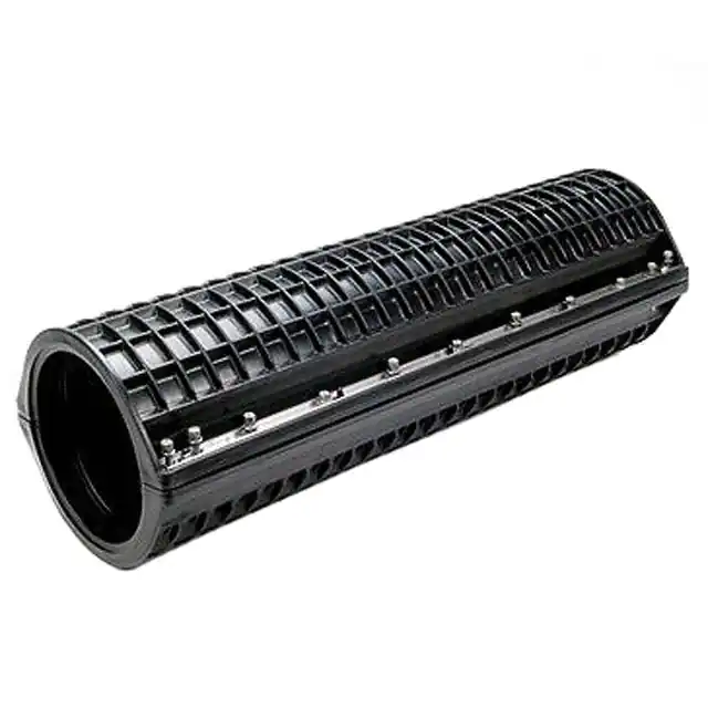

Communication Markets Division 3M™ Pressurized Closure System 2-Type 505 The 3M™ Pressurized Closure System 2-Type 505 is a complete, pressuretight, re-enterable closure system for enclosing spliced connections of communications cable in a wide variety of applications. The 2-Type closure is offered in seven different diameter sizes (3-inch to 12-inch) and 13 different lengths (18.5" to 82.5"). Custom length closures up to 108 inches in length are available upon request. The tools required for installation are a washer cutter tool and a torque wrench. This system allows for quick and easy re-entry of closures. Features • Pressure tight • Re-enterable • Industry common tools used for assembly or re-entry • Constructed of impact- and corrosion-resistant plastic • Craft friendly • Reusable • More than 25-year field history • Used in aerial, underground and manhole applications • Custom lengths available • Suitable for straight and branch splice configurations • C, D and E sizes can handle more than 4200 pairs 3M™ Pressurized Closure System 2-Type 505 3M™ Closure System 2-Type 505-Cover 1 Each complete 2-type cover 505 selection contains: 1. 2 Cover halves with installed sealing gasket 16 2. Protective gloves 5 3. 3M Sealing R-Tape ™ 15 4. 3M™ Dry Towlette Wipe DTW 5. Alignment bars 5 6. Alignment bar hardware 7. 14 Back cover clips 6 11 4 8. Flanged hex nut 9. Hex nuts 13 10. Pressure valve 11. 12 12. External ground ribbon 13. Black cable ties 14. Bond braid with eyelets 15. White cable ties 16. Splice wrap 3M™ Pressurized Closure System 2-Type 505 Ordering Code Covers 2 2-Type Series D 2 A Overall Length of Cover AA 18 ½" (470 mm) Inside Diameter A 27 ½" (699 mm) A 5 ¼" (134 mm) B 36" (914 mm) B 7" (178 mm) C 44 ½" (1,130 mm) C 8" (203 mm) D* 48 ½" (1,232 mm) D 9 ½" (241 mm) E* 52 ¾" (1,340 mm) E 12" (305 mm) F* 57" (1,448 mm) G* 61 ½" (1,563 mm) H* 65 ½" (1,664 mm) I* 69 ¾" (1,772 mm) J* 74" (1,880 mm) K* 78 ½" (1,994 mm) L* 82 ½" (2,096 mm) Material of Manufacture 2 Standard 4 Fire Retardant 3 10 3M Cleaning Wipes CSSC20 ™ * Custom sizes 9 7 8 3M™ Closure System 2-Type 505-Endplates Each Complete 2-type endplate 505 selection contains: 1 1. Endplate sections 2. Sheath scuff 3. 3M™ Sealing Tape RTW 2 10 3 11 9 4. Protective gloves 5. Cable diameter tape 6. Sealing washers 4 7. Additional longer cable retention clamps (depending upon endplate ordered) 5 8. 3M™ Sealing Tape RTE 9. 3M™ Scotchlok™ Shield Bond Connectors 10. Hose clamps 6 8 7 Accessories: Tools Required • • • • (not included with cover or endplate kits) • • • • • 3M Washer Cutter Tool WCT11K 3M™ Spare Blade Kit WCB11K 3M™ Aerial Hanger Kit AH20K 3M™ Underground Closure Support Kit UCS10K 3M™ Plugging Spools 3M™ 2-Type Tool Kit 2-TYPE/TK 3M™ 4-Hole Spool Kit KWSP04 3M™ Universal Alignment Tool Kit UAT20K 3M™ Torque Wrench 2178-2T-LL-CLTK ™ • 3M™ Washer Cutter Tool WCT11K • Speed Wrench • Can wrench with 3/8" (9.5 mm) and 7/16" (11 mm) ends • 1/2" (13 mm) and 7/16" (11 mm) deep wrench sockets • 3" (76 mm) socket extender • Screw driver • Snips • Knife • Tabbing shears 3M™ Pressurized Closure System 2-Type 505 Ordering Code Endplates 2-Type Series 2 D 2 1E Number of Cable Entries in Endplate 1E 1 Cable Inside Diameter 2E 2 Cables A 5 ¼" (134 mm) 3E 3 Cables B 7" (178 mm) C 8" (203 mm) D 9 ½" (241 mm) E 12" (305 mm) Material of Manufacture 2 Standard 4 Fire Retardant 11. 3M™ Cleaning Wipes CSSC20 3M™ Closure System 2-Type 505-Cover Selection Determine number of cable pairs, splice bundle diameter and sheath opening required. Use the proper ordering code, from this table, to indicate your cover selection. Series Number Inside Diameter, Inches (mm) 2A2 5 ¼" (134) 2B2 7" (178) 2C2 8" (203) 2D2 9½" (241) 2E2 12" (305) Overall Length Sheath Opening 18 ½" (470) 10" (254) 2A2AA 2B2AA 2C2AA 2D2AA 2E2AA 27 ½" (699) 19" (483) 2A2AH 2B2AH 2C2AH 2D2AH 2E2AH 600 1200 1800 3600 4200 Maximum number of cable pairs (1) 36" (914) 27 ½" (699) 2A2BH 2B2BH 2C2BH 2D2BH 2E2BH 44 ½" (1130) 36" (914) 2A2CH 2B2CH 2C2CH 2D2CH 2E2CH 48 ½" (1232) 40" (1016) 2A2D 2B2D 2C2D 2D2D 2E2D 52 ¾" (1340) 44 ¼" (1124) 2A2E 2B2E 2C2E 2D2E 2E2E 57" (1448) 48 ½" (1232) 2A2F 2B2F 2C2F 2D2F 2E2F 61 ½" (1563) 53" (1346) 2A2G 2B2G 2C2G 2D2G 2E2G 65 ½" (1664) 57" (1448) 2A2H 2B2H 2C2H 2D2H 2E2H 69 ¾" (1772) 61 ¼" (1556) 2A2I 2B2I 2C2I 2D2I 2E2I 74" (1880) 65 ½" (1664) 2A2J 2B2J 2C2J 2D2J 2E2J 78 ½" (1994) 70" (1778) 2A2K 2B2K 2C2K 2D2K 2E2K 82 ½" (2096) 74" (1880) 2A2L 2B2L 2C2L 2D2L 2E2L Maximum number of cable pairs based on the following specifications: 2Y2 & 2X2 Series = 24/26 gauge cable using 25 pair modular connectors for straight, in-line, 1-bank splice (18 ½" overall cover length, 10" sheath opening) 2A2, 2B2, 2C2, 2D2, & 2E2 Series. = 24/26 gauge cable using 25 pair modular connectors for straight, in-line, 2-bank splice (27 ½" overall cover length, 19" sheath opening). H Alignment bars provided in 505 cover kits. Bold type indicates standard covers. (1) Endplate Selection Number of Cable Openings/Endplate Ordering Code 1 2 3 9 12 18 27 36 42 *1E *2E *3E *9E or S *12E or S *18E or S *27E or S *36E or S *42E(1) A A B A B C 2-Type Endplate Cable Entrance Configuration A A B A B C Series Diameter In. (mm) 2A2-(*) 5Qr" (134) 2.2" (56) 1.6" (41) 1.3" (33) N/A N/A N/A .88" - 1.1" N/A N/A N/A N/A N/A 2B2-(*) 7" (178) 3.4" (86) 2.2" (56) 2.2" (56) 2.2" (56) 1.0" (25) 1.0" (25) N/A .88" - 1.1" N/A N/A N/A N/A 2C2-(*) 8" (203) 3.4" (86) 2.8" (71) 2.8" (71 2.8" (71) 1.6" (41) 1.6" (41) N/A N/A .88" - 1.1" N/A N/A N/A 2D2-(*) 9Qw" (241) 3.4" (86) 3.4" (86) 3.4" (86) 3.4" (86) 2.2" (56) 2.2" (56) N/A N/A .88" - 1.1" .88" - 1.1" .88" - 1.1" .88" - 1.1" 2E2-(*) (305) N/A 4.4" (112) 4.4" (112) 4.0" (102) 3.4" (86) 3.4" (86) N/A N/A N/A .88" - 1.1" .88" - 1.1" .88" - 1.1" 12" Maximum Cable Outside Diameter Cable Range Outside Diameter Tip cable diameters other than cable range shown may be special ordered. “E” designates solid endplate for new construction. “S” designates split endplate for existing or retrofit applications. 42E not available in split endplate configuration Note: 2D2 series endplates may be used with 2E2 series covers. Note: .88” - 1.1” = 22 mm - 28 mm (1) (2) 3M™ Closure System 2-Type 505 Ordering Information To select the correct cover: 1. Determine number of cable pairs 2. Determine splice bundle diameter 3. Determine sheath opening required To select the correct endplate: 4. Determine cable entrance configuration 5. Determine outside diameter of each cable (Outside cable diameter must not exceed pre-sized opening in endplate) Example: Number of cable pairs = 1200/24 gauge Splice bundle diameter = 6" (152 mm) Sheath opening = 19" (483 mm) Cable configuration = 3-way 1200 pairs in/600 pairs out x 600 pairs out Cable outside diameters: 1200 pairs = 2.6" (66 mm) 600 pairs = 1.9" (48 mm) Correct codes to order one cover and two endplates. 1 each 2B2A Cover Assembly 1 each 2B2-1E Endplate Assembly 1 each 2B2-2E Endplate Assembly A complete 2-Type Closure for enclosing spliced connections of communication cables requires the selection of one (1) cover assembly kit and two (2) endplate assembly kits from the same series. Note from the example that the cover series (2B2) matches the endplate series (2B2). This ordering procedure is an approximate guide only. Proper cover and endplate selection will vary with type of splice connectors and splicing method used. 3M™ Closure System 2-Type Accessories 3M™ Washer Cutter Tool Kit WCT11K This kit is used for cutting 3M™ Universal Slotted Washers to match cables entering a closure. 3M™ Closure Tool Kit 2TYPE/TK 3M™ Torque Wrench 2178-2T-LL-CLTK 3M™ Underground Closure Support Kit UCS10K This kit provides closure support on racks in manholes and vaults. 3M™ Aerial Hanger Kit AH20K This kit is used for fastening a complete 2-Type closure to strand support wire in aerial applications. 3M™ Back Cover Clips BCC10K These clips are used for holding the cover assembly to the endplates and for keeping endplates properly spaced and parallel during splicing. 3M™ Plugging Spools FX, GX, HX, JX, KX, LX, MX These spools are used for plugging unused cable openings. 3M™ Universal Slotted Washers FS, GS, HS, JS, KS, LS, MS 3M™ Sealing Tape RTW This tape is used to form collars for sealing cables in end plates. 3M™ Sealing Tape RC This tape is used for sealing grooves. 3M™ Sealing Tape RTE This tape is used to seal endplates. 3M™ Bonding and Grounding Kit This kit is used for maintaining internal shield continuity and external grounding. A pressure valve provides for external flash testing and pressurization. 3M and Scotchlok are trademark of 3M Company. Important Notice All statements, technical information, and recommendations related to 3M’s products are based on information believed to be reliable, but the accuracy or completeness is not guaranteed. Before using this product, you must evaluate it and determine if it is suitable for your intended application. You assume all risks and liability associated with such use. Any statements related to the product which are not contained in 3M’s current publications, or any contrary statements contained on your purchase order shall have no force or effect unless expressly agreed upon, in writing, by an authorized officer of 3M. Warranty; Limited Remedy; Limited Liability. This product will be free from defects in material and manufacture for a period of 12 months from the time of purchase. 3M MAKES NO OTHER WARRANTIES INCLUDING, BUT NOT LIMITED TO, ANY IMPLIED WARRANTY OF MERCHANTABILITY OR FITNESS FOR A PARTICULAR PURPOSE. If this product is defective within the warranty period stated above, your exclusive remedy shall be, at 3M’s option, to replace or repair the 3M product or refund the purchase price of the 3M product. Except where prohibited by law, 3M will not be liable for any loss or damage arising from this 3M product, whether indirect, special, incidental or consequential regardless of the legal theory asserted. Communication Markets Division 6801 River Place Blvd. Austin, TX 78726-9000 USA Phone 1-800-426-8688 Fax 1-800-626-0329 Web 3M.com/Telecom Please recycle. Printed in USA © 3M 2015. All rights reserved. 80-6113-2876-8

物料型号:3M™ Pressurized Closure System 2-Type 505
器件简介:3M™ Pressurized Closure System 2-Type 505 是一种完整的、密封的、可重新进入的闭合系统,用于在各种应用中封闭通信电缆的接续连接。该2型闭合器提供七种不同的直径尺寸(3英寸至12英寸)和13种不同的长度(18.5英寸至82.5英寸)。根据要求,可提供长达108英寸的定制长度闭合器。
引脚分配:文档中未提供引脚分配信息。
参数特性: - 密封性良好 - 可重新进入 - 使用行业通用工具进行组装或重新进入 - 由耐冲击和耐腐蚀塑料制成 - 便于施工 - 可重复使用 - 拥有超过25年的现场使用历史 - 适用于架空、地下和人孔应用 - 提供定制长度 - 适用于直线和分支接续配置 - C、D和E尺寸可以处理超过4200对
功能详解:该系统允许快速轻松地重新进入闭合器,包括盖子、密封垫、保护手套、3M™密封胶带、3M™清洁湿巾、对齐杆、对齐杆硬件、背盖夹、法兰六角螺母、六角螺母、压力阀等组件。
应用信息:适用于架空、地下和人孔中的通信电缆接续连接。
封装信息:提供不同直径和长度的闭合器,以及定制尺寸选项。标准材料为阻燃材料。
