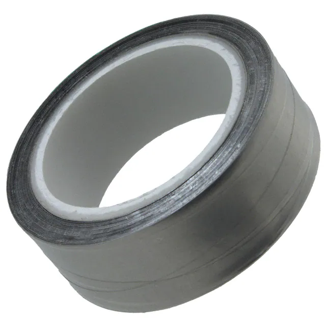

3 High Temperature Aluminum Foil Tape 433 • 433L (Linered) Technical Data Product Description 3M™ High Temperature Aluminum Foil Tape 433 has a silicone adhesive that can be used in many high temperature applications. Also comes in an easy-release film liner. Product Construction Backing Adhesive Color Liner (3M tape 433L) Standard Roll Length Aluminum foil (Alloy 1100-0) Silicone (clear) Shiny silver Clear, easyrelease film 60 yds. (55 m) Typical Physical Properties Note: The following technical information and data should be considered representative or typical only and should not be used for specification purposes. ASTM Test Method Adhesion to Steel: 3M tape 433 40 oz./in. width (43.8 N/100 mm) 3M tape 433L 38 oz./in. width (42.0 N/100 mm) D-3330 D-3330 Tensile Strength: 20 lbs./in. width (350 N/100 mm) D-3759 Elongation at Break: 3.5% D-3759 Backing Thickness: Features 2.0 mils (0.05 mm) D-3652 Total Tape Thickness: 3M tape 433 3.6 mils (0.09 mm) 3M tape 433L 3.5 mils (0.09 mm) D-3652 D-3652 Liner Thickness: 3M tape 433L 2 .9 mils (0.07 mm) D-3652 Water Vapor Transmission Rate: 0.1 gms H2O/100 sq. in./24 hrs. (1.55 g/m2/24 hrs.) Temperature Use Range: Permanent Appl. Removable Appl. -65° to 600°F (-54° to 316°C) -65° to 375°F (-54° to 190°C) Weight: 0.0096 lbs./yd./in. width (.0049 kg/m/24 mm) D-3833 • Flame resistant – meets requirements of F.A.R. 25.853(a). • 3M™ High Temperature Aluminum Foil Tape 433L can easily be die-cut into special sizes or shapes. • Best results obtained when applied to a clean surface above 32°F (0°C), but tape can be applied from 0°F to 200°F (-18°C to 93°C). • Performance range from -65°F to over 600°F (-54°C to over 316°C). Adhesive will gradually thermoset at high temperatures. As it thermosets, the adhesive mass becomes firm and gradually loses its pressure sensitivity but will continue to hold the tape in place. 3M™ High Temperature Aluminum Foil Tape 433 • 433L (Linered) Application Ideas • Moisture barrier around doors and windows to help prevent fogging of glass. • Seal for automotive air bag inflators. • To hold insulation on hot air ducts in industry. • Cover resistance wire heating elements to distribute the heat. • Splice jumbo rolls of aluminum foil or holding the last lap of narrow width rolls in preparation to annealing the rolls. • Ideal as a heat reflective wrap along or over insulations, applied to tubes, engine support structures, missile ground handling equipment, or as a protector from other heat source areas such as hot areas in steel mills. • Good holding, splicing, patching or general protecting tape on many applications involving high temperatures. Storage Store under normal conditions of 60° to 80°F (16° to 27°C) and 40 to 60% R.H. in the original carton. Shelf Life To obtain best performance, use this product within 18 months from date of manufacture. Product Use All statements, technical information and recommendations contained in this document are based upon tests or experience that 3M believes are reliable. However, many factors beyond 3M’s control can affect the use and performance of a 3M product in a particular application, including the conditions under which the product is used and the time and environmental conditions in which the product is expected to perform. Since these factors are uniquely within the user’s knowledge and control, it is essential that the user evaluate the 3M product to determine whether it is fit for a particular purpose and suitable for the user’s method of application. Warranty and Limited Remedy Unless stated otherwise in 3M’s product literature, packaging inserts or product packaging for individual products, 3M warrants that each 3M product meets the applicable specifications at the time 3M ships the product. Individual products may have additional or different warranties as stated on product literature, package inserts or product packages. 3M MAKES NO OTHER WARRANTIES, EXPRESS OR IMPLIED, INCLUDING, BUT NOT LIMITED TO, ANY IMPLIED WARRANTY OF MERCHANTABILITY OR FITNESS FOR A PARTICULAR PURPOSE OR ANY IMPLIED WARRANTY ARISING OUT OF A COURSE OF DEALING, CUSTOM OR USAGE OF TRADE. User is responsible for determining whether the 3M product is fit for a particular purpose and suitable for user’s application. If the 3M product is defective within the warranty period, your exclusive remedy and 3M’s and seller’s sole obligation will be, at 3M’s option, to replace the product or refund the purchase price. Limitation of Liability Except where prohibited by law, 3M and seller will not be liable for any loss or damage arising from the 3M product, whether direct, indirect, special, incidental or consequential, regardless of the legal theory asserted, including warranty, contract, negligence or strict liability. ISO 9001: 2000 3 This Industrial Adhesives and Tapes Division product was manufactured under a 3M quality system registered to ISO 9001: 2000 standards. Industrial Business Industrial Adhesives and Tapes Division 3M Center, Building 21-1W-10, 900 Bush Avenue St. Paul, MN 55144-1000 800-362-3550 • 877-369-2923 (fax) www.3M.com/industrial Recycled Paper 40% pre-consumer 10% post-consumer Printed in U.S.A. ©3M 70-0709-5014-5 (2001 / 7/05)
