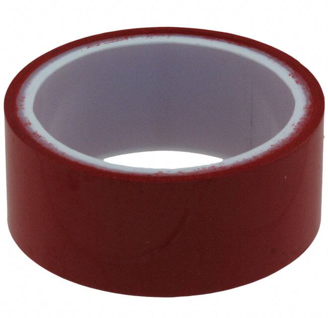

Polyester Film Tape 850 Technical Data August, 2013 Product Description 3M™ Polyester Film Tape 850 can generally be used for splicing and applications where chemical resistance and/or clean removal is necessary. The silver backing is a transparent polyester with a thin layer of aluminum. Product Construction Backing Adhesive Color Standard Roll Length Polyester Acrylic Transparent, Red, Black, White, Silver 72 yds. (65.8 m) Typical Physical Properties Note: The following technical information and data should be considered representative or typical only and should not be used for specification purposes. ASTM Test Method Adhesion to Steel: Silver: Tensile Strength at Break: Elongation at Break: Backing Thickness: Total Thickness: Water Vapor Transmission Rate: Silver: Temperature Use Range: Features • • • • • 30 oz./in. width (33 N/100 mm) 42 oz./in. width (46 N/100 mm) 28 lbs./in. width (491 N/100 mm) 120% 0.9 mils (0.02 mm) 1.9 mils (0.05 mm) 1.6 gms, H2O/100 sq. in./24 hrs. (24.8 g/m2/24 hrs.) 0.9 gms, H2O/100 sq. in./24 hrs. (7.75 g/m2/24 hrs.) -60 - 300°F (-50 - 150°C) D-3330 D-3330 D-3759 D-3759 D-3652 D-3652 D-3833 D-3833 Prolonged exposure to sunlight or hot caustics will cause backing to become brittle and lose tensile strength. Thin, high strength polyester film helps reduce failures due to breakage while meeting low caliper requirements. Chemical and solvent resistance to help reduce rejects produced from chemical and solvent attack. Abrasion resistant to help protect surfaces from abrasion and rough handling. Variety of colors offered when easy detection is required. 3MTM Polyester Tape 850 Application Ideas Transparent, Red, Black, White: • Splicing and web defect marking. • Sealing, labeling, and protecting. • Positive film striping (transparent). • Decorative edging. • Tape hinge. Silver: • Post splicing movie film. • Deflect flagging where reflective sensing is required. • Decorative striping and die cutting. • Decorative edging. Storage Store under normal conditions of 60° to 80°F (16° to 27°C) and 40 to 60% relative humidity in the original packaging material. Shelf Life To obtain best performance, use this product within 18 months from date of manufacture. Technical Information The technical information, recommendations and other statements contained in this document are based upon tests or experience that 3M believes are reliable, but the accuracy or completeness of such information is not guaranteed. Product Use Many factors beyond 3M’s control and uniquely within user’s knowledge and control can affect the use and performance of a 3M product in a particular application. Given the variety of factors that can affect the use and performance of a 3M product, user is solely responsible for evaluating the 3M product and determining whether it is fit for a particular purpose and suitable for user’s method or application. Warranty, Limited Remedy, and Disclaimer Unless an additional warranty is specifically stated on the applicable 3M product packaging or product literature, 3M warrants that each 3M product meets the applicable 3M product specification at the time 3M ships the product. 3M MAKES NO OTHER WARRANTIES OR CONDITIONS, EXPRESS OR IMPLIED, INCLUDING, BUT NOT LIMITED TO, ANY IMPLIED WARRANTY OR CONDITION OF MERCHANTABILITY OR FITNESS FOR A PARTICULAR PURPOS OR ANY IMPLIED WARRANTY OR CONDITION ARISING OUT OF A COURSE OF DEALING, CUSTOM OR USAGE OF TRADE. If the 3M product does not conform to this warranty, then the sole and exclusive remedy is, at 3M’s option, replacement of the 3M product or refund of the purchase price. Limitation of Liability Except where prohibited by law, 3M will not be liable for any loss or damage arising from the 3M product, whether direct, indirect, special, incidental or consequential, regardless of the legal theory asserted, including warranty, contract, negligence or strict liability. This Industrial Adhesives and Tapes Division product was manufactured under a quality system registered to ISO 9001:2000 standards. Industrial Business Industrial Adhesives and Tapes Division 3M Center, Building 220-3S-06 St. Paul, MN 55144-1000 800-362-3550 · 577-369-2923 (Fax) www.3M.com/industrial G/COE/Product Technical Data Sheets/853 Recycled Paper 40% pre-consumer 10% post-consumer 3M is a trademark of 3M Company. Printed in U.S.A. ©3M 2012

物料型号:3M™ Polyester Film Tape 850
器件简介:3M™ Polyester Film Tape 850通常用于拼接和需要化学抗性或清洁移除的应用。银色背衬是透明的聚酯带一层薄薄的铝。
引脚分配:文档中未提及引脚分配,因为这是一个胶带产品,不是电子元件。
参数特性: - 钢上的粘附力:30盎司/英寸宽度(33牛顿/100毫米) - 银色背衬:42盎司/英寸宽度(46牛顿/100毫米) - 断裂时的拉伸强度:28磅/英寸宽度(491牛顿/100毫米) - 断裂时的伸长率:120% - 背衬厚度:0.9毫微米(0.02毫米) - 总厚度:1.9毫微米(0.05毫米) - 水蒸气透过率:1.6克,H2O/100平方英寸/24小时(24.8克/平方米/24小时) - 银色背衬:0.9克,H2O/100平方英寸/24小时(7.75克/平方米/24小时) - 使用温度范围:-60至300°F(-50至150°C)
功能详解: - 透明、红色、黑色、白色:用于拼接和网络缺陷标记。密封、标记和保护。正片条带(透明)、装饰边缘。胶带铰链。银色:电影胶片拼接后使用。在需要反射感应的地方进行偏转标记。
应用信息: - 存储:在原始包装材料中,存放在60°至80°F(16°至27°C)和40至60%相对湿度的正常条件下。 - 保质期:为了获得最佳性能,请在生产日期后的18个月内使用此产品。
