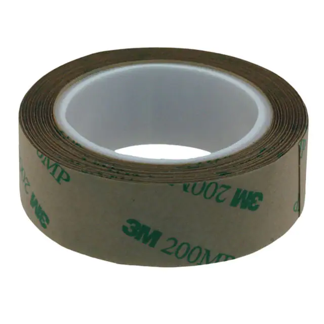

    TAPE ADHSIVE TRANSFER 3/4" X 5YD
3/4-5-9495MP 数据手册
Technical Data November 2011 3M™ Double Coated Tapes 9474LE • 9495LE Product Description 3M™ Double Coated Tapes with 3M™ Laminating Adhesive 300LSE provides high bond strength to most surfaces, including many low surface energy plastics such as polypropylene and powder coated paints. The acrylic adhesive also provides excellent adhesion to surfaces contaminated lightly with oil typically used with machine parts. Construction Faceside1 Adhesive Thickness Carrier Type/ Thickness Backside2 Adhesive Thickness Liner Color, Type, Print 3M™ Double Coated Tape 9474LE 2.8 mil (0.071mm) Clear Polyester 0.5 mil (0.013mm) 3.4 mil (0.086mm) Faceside Liner/ Tan, 58# Polycoated Kraft, no print Backside Liner/ Tan, 58# Polycoated Kraft, “3M 300LSE” 4.2 mil (0.11mm)/ 4.2 mil (0.11mm) 6.7 mil (0.17mm) 3M™ Double Coated Tape 9495LE 2.8 mil (0.071mm) Clear Polyester 0.5 mil (0.013mm) 3.4 mil (0.086mm) Tan, 58#, Polycoated Kraft “3M 300LSE” 4.2 mil (0.11mm) 6.7 mil (0.17mm) Product Number Liner Caliper3 Total Tape Thickness (w/o liner) Note 1: Faceside (FS) adhesive is on the interior of the roll, exposed when unwound. Note 2: Backside (BS) adhesive is on the exterior of the roll, exposed when liner is removed. Note 3: The caliper listed is based on a calculation from manufacturing controlled adhesive coat weights using a density of 1.012 g/cc. Features • This tape has a film carrier which can add dimensional stability to foams and other substrates and also makes it easier to handle the tape during slitting and die-cutting. • 3M™ Double Coated Tape 9474LE features a dual liner for ease in selective die cutting. • The bond strength of 3M™ Laminating Adhesive 300LSE increases as a function of time and temperature, and has very high initial adhesion. Application Ideas • Foam to powder coated painted surfaces. • Low surface energy plastic adhesion. • Lens bonding applications. 3 3M™ Double Coated Tapes 9474LE • 9495LE Typical Physical Properties and Performance Characteristics Note: The following technical information and data should be considered representative or typical only and should not be used for specification purposes. Product Number 3M™ Double Coated Tapes 9474LE, 9495LE Adhesion to stainless steel ASTM D3330 - 180 degree, 2 mil Al foil Oz/in (N/cm) [kg/25.4 mm] - 15 minute RT 60 (6.6) [1.7] - 72 hour RT 90 (9.9) [2.6] Adhesion to other surfaces ASTM D3330 - 180 degree, 2 mil Al foil, 72 hour RT ABS 110 (12.0) [3.1] Polypropylene 125 (13.7) [3.6] Polycarbonate 130 (14.2) [3.7] Glass 95 (10.4) [2.7] Shear Strength - ASTM D3654 modified (.5 inch2 sample size) 1000 grams at 72°F (22°C) >10,000 minutes 500 grams at 158°F (70°C) >10,000 minutes Relative High Temperature Operating Ranges: Long Term (days, weeks) 200°F (93°C) Short Term (minutes, hours) 300°F (149°C) Relative Solvent Resistance: Very Good Dielectric Properties: Dielectric Strength 1100 volts/mil Breakdown Voltage 7100 volts Available Sizes Roll length, width, slitting tolerance, core size. Available Lengths (Subject to minimum order requirements) Product Number 3M™ Double Coated Tape 9474LE 3M™ Double Coated Tape 9495LE 1/2" to 63/64" – 180 yd. (164 m) 1" to 3" – 360 yd. (329 m) 3" to 48" – 360 yd. (329 m) 48" to 54" – 360 yd. (329 m) Normal Slitting Tolerance – ±1/32 in. (0.8 mm) Core Size – 3.0 in. (76.2 mm) Sheet Size 24" x 36" – Maximum Length in: (2) 3M™ Double Coated Tapes 9474LE • 9495LE Application Techniques Bond strength is dependent upon the amount of adhesive-to-surface contact developed. Firm application pressure and moderate heat, from 100°F (38°C) to 130°F (54°C), will assist the adhesive in developing intimate contact with the bonding surface. To obtain optimum adhesion, the bonding surfaces must be clean, dry and well unified. Some typical surface cleaning solvents are isopropyl alcohol or heptane.* Ideal tape application temperature range is 70°F to 100°F (21°C to 38°C). Initial tape application to surfaces at temperatures below 50°F (10°C) is not recommended because the adhesive becomes too firm to adhere readily. However, once properly applied, low temperature holding is generally satisfactory. *Note: Carefully read and follow the manufacturer’s precautions and directions for use when working with solvents. These cleaning recommendations may not be compliant with the rules of certain Air Quality Management Districts in California; consult applicable rules before use. Application Equipment To apply adhesives in a wide web format, lamination equipment is required to ensure acceptable quality. To learn more about working with pressure-sensitive adhesives please refer to technical bulletin, Lamination Techniques for Converters of Laminating Adhesives (70-0704-1430-8). For additional dispenser information, contact your local 3M sales representative, or the toll free 3M sales assistance number at 1-800-251-8634. Environmental Performance Humidity Resistance: High humidity has minimal effect on adhesive performance. No significant reduction in bond strength is observed after exposure for seven days at 90°F (32°C) and 90% relative humidity. UV Resistance: When properly applied, nameplates and decorative trim parts are not adversely affected by exposure to direct sunlight. Water Resistance: Immersion in water has no appreciable effect on the bond strength. After 100 hours at room temperature, the high bond strength is maintained. Temperature Cycling Resistance: High bond strength is maintained after cycling four times through: 4 hours at 158°F (70°C) 4 hours at -20°F (-29°C) 4 hours at 73°F (22°C) Chemical Resistance: When properly applied, nameplate and decorative trim parts will hold securely after exposure to numerous chemicals including oil, mild acids and alkalis. Storage Store in original cartons at 70°F (21°C) and 50% relative humidity. Shelf Life If stored under proper conditions, product retains its performance and properties for two years from date of manufacture. (3) 3M™ Double Coated Tapes 9474LE • 9495LE Certification/Recognition MSDS: 3M has not prepared a MSDS for this product which is not subject to the MSDS requirements of the Occupational Safety and Health Administration’s Hazard Communication Standard, 29 C.F.R. 1910.1200(b)(6)(v). When used under reasonable conditions or in accordance with the 3M directions for use, the product should not present a health and safety hazard. However, use or processing of the product in a manner not in accordance with the directions for use may affect its performance and present potential health and safety hazards. TSCA: This product is defined as an article under the Toxic Substances Control Act and therefore, it is exempt from inventory listing requirements. RoHs Complaint/REACH Compliant: This product complies with the European Union’s “Restriction of Hazardous Substances” (RoHs) initiative and with European REACH regulations 2002/95/EC and 2005/618/EC. For Additional Information To request additional product information or to arrange for sales assistance, call toll free 1-800-251-8634. Address correspondence to: 3M, Electronics Markets Materials Division, 3M Center, Building 225-3S-06, St. Paul, MN 551441000. Our fax number is 651-778-4244 or 1-877-369-2923. In Canada, phone: 1-800-364-3577. In Puerto Rico, phone: 1-787-750-3000. In Mexico, phone: 52-70-04-00. Important Notice All statements, technical information, and recommendations related to 3M’s products are based on information believed to be reliable, but the accuracy or completeness is not guaranteed. Before using this product, you must evaluate it and determine if it is suitable for your intended application. You assume all risks and liability associated with such use. Any statements related to the product which are not contained in 3M’s current publications, or any contrary statements contained on your purchase order shall have no force or effect unless expressly agreed upon, in writing, by an authorized officer of 3M. Warranty; Limited Remedy; Limited Liability. This product will be free from defects in material and manufacture at the time of purchase. 3M MAKES NO OTHER WARRANTIES INCLUDING, BUT NOT LIMITED TO, ANY IMPLIED WARRANTY OF MERCHANTABILITY OR FITNESS FOR A PARTICULAR PURPOSE. If this product is defective within the warranty period stated above, your exclusive remedy shall be, at 3M’s option, to replace or repair the 3M product or refund the purchase price of the 3M product. Except where prohibited by law, 3M will not be liable for any indirect, special, incidental or consequential loss or damage arising from this 3M product, regardless of the legal theory asserted. 3 Electronics Markets Materials Division 3M Center, Building 225-3S-06 St. Paul, MN 55144-1000 1-800-251-8634 phone 651-778-4244 fax www.3M.com/electronics 3M is a trademark of 3M Company. Please recycle. Printed in U.S.A. © 3M 2011. All rights reserved. 60-5002-0532-7 (4) 3
3/4-5-9495MP
1. 物料型号:3M™双面胶带9474LE和9495LE。 2. 器件简介:这些胶带使用3M™Laminating Adhesive 300LSE,具有高粘合强度,适用于多种表面,包括低表面能塑料如聚丙烯和粉末涂层油漆。 3. 引脚分配:文档中没有提及引脚分配,因为这是胶带产品,不是电子元件。 4. 参数特性: - 9474LE和9495LE胶带的面胶厚度为2.8mil(0.071mm),背胶厚度为3.4mil(0.086mm)。 - 胶带的载体类型为透明聚酯,厚度为0.5mil(0.013mm)。 - 总胶带厚度(不包括衬垫)为6.7mil(0.17mm)。 5. 功能详解: - 胶带具有薄膜载体,可以增加泡沫和其他基材的尺寸稳定性,也使切割和模切更容易。 - 9474LE胶带具有双面衬里,便于选择性模切。 - 3M™Laminating Adhesive 300LSE的粘合强度随时间和温度的增加而增加,具有非常高的初始粘合力。 6. 应用信息: - 适用于泡沫到粉末涂层表面、低表面能塑料粘合、镜头粘合等应用。 7. 封装信息:提供了胶带的尺寸信息,包括最大长度、常规切割公差和芯尺寸。
