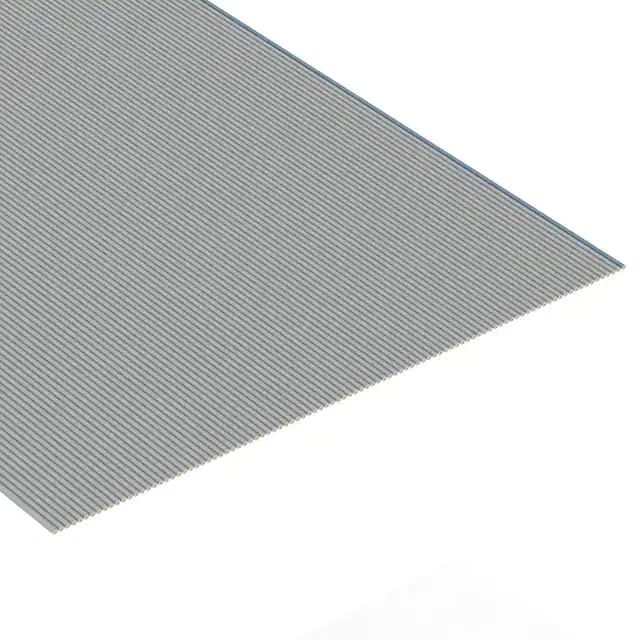

8 TM 3M 7 6 5 4 3 2 1 NOTES ROUND CONDUCTOR FLAT CABLE, 3749 SERIES 1. REGULATORY INFORMATION: FOR REGULATORY INFORMATION ABOUT THIS PRODUCT, VISIT 3m.com/regs OR CONTACT YOUR 3M REPRESENTATIVE. .025" 30 AWG SOLID, TPE UL FILE NO: E42769. STYLE NO: 20297 D 2. CLOSE SPACING PERMITS HIGHER SIGNAL DENSITY DIM A DIM B .013 0.33 .025 ORDERING INFORMATION 3749/XX XX BLANK = STANDARD C = CANADIAN CERTIFIED VERSION .005 .025 D 3. TPE INSULATION PROVIDES EXCELLENT TRANSMISSION PROPERTIES. 4. 30 AWG SOLID CONDUCTORS ON .025 INCH SPACING ALLOWS FOR MASS TERMINATION. .002 TYP 0.64 5. ZIPPABLE FOR BRANCHING OR DISCRETE TERMINATION. 6. MEETS THE SCSI-3 FAST-20 CHARACTERISTIC IMPEDANCE REQUIREMENTS. .003 0.64 7 BLUE MARKING ON ONE EDGE OF CABLE DESIGNATES WIRE #1. 7 30 AWG [0.254] TINNED SOLID COPPER CONDUCTORS BLANK = STANDARD SF = SPLICE FREE TPE INSULATION NUMBER OF CONDUCTORS (SEE TABLE) C C NOTE: AVAILABLE IN STANDARD 100 FT OR 300 FT ROLLS. PLEASE SPECIFY WHEN ORDERING. CONTACT 3M FOR AVAILABILITY OF ADDITIONAL CONDUCTOR COUNTS AND/OR CUSTOM ROLL LENGTHS. PHYSICAL: INSULATION MATERIAL: COLOR: MARKING STANDARD: CANADIAN: THERMOPLASTIC ELASTOMER, TPE (TPO TYPE) GRAY NONE SEE "PRINTING ILLUSTRATION" VIEW TABLE 1 R 0.225 0.275 0.325 0.375 0.475 0.575 0.625 0.725 0.825 0.875 0.975 1.225 1.475 1.675 1.975 2.475 G .006 [6.35] .006 [7.62] .006 [8.89] .006 [10.16] .006 [12.70] .006 [15.24] .006 [16.51] .009 [19.05] .009 [21.59] .009 [22.86] .009 [25.40] .009 [31.75] .012 [38.10] .012 [43.18] .015 [50.80] .015 [63.50] 0.254] TINNED SOLID COPPER REVISION 0.250 0.300 0.350 0.400 0.500 0.600 0.650 0.750 0.850 0.900 1.000 1.250 1.500 1.700 2.000 2.500 CONDUCTORS MATERIAL: 30 AWG [ DIMENSION B .004 [5.72] .004 [6.99] .004 [8.26] .004 [9.53] .004 [12.07] .004 [14.61] .004 [15.88] .006 [18.42] .006 [20.96] .006 [22.23] .006 [24.77] .006 [31.12] .009 [37.47] .009 [42.55] .011 [50.17] .012 [62.87] ELECTRICAL: VOLTAGE RATING: USA 150V CANADIAN 150V 10 INSULATION RESISTANCE: >1 X 10 /10ft. [3m] CHARACTERISTIC IMPEDANCE: CAPACITANCE: INDUCTANCE: PROPAGATION DELAY: VELOCITY OF PROPAGATION: DRAWING NUMBER DIMENSION A 78-5100-0068-6 3M PART NUMBER 3749/10 3749/12 3749/14 3749/16 3749/20 3749/24 3749/26 3749/30 3749/34 3749/36 3749/40 3749/50 3749/60 3749/68 3749/80 3749/100 UNBALANCED 90 16.5 pF/ft [54.1 pF/m] 0.13 H/ft [0.43 H/m] 1.48 ns/ft [4.86 ns/m] 69% B NOTE: UNBALANCED IS MEASURED BETWEEN GROUND-SIGNAL-GROUND CONDUCTORS. ENVIRONMENTAL: TEMPERATURE RATING: -40 C TO +105 C FLAMMABILITY RATING: USA: UL HORIZONTAL CANADA: FT2 R G 0101481 JAN 04,2022 REDRAWN DIMENSIONS: INCH [MM] DESIGN REFERENCE CANADIAN OPTION A INCH [MM] TOLERANCE - UNLESS NOTED .X .XX .XXX INCH .1 .05 .010 [] = DIM. FOR REFERENCE ONLY "PRINTING ILLUSTRATION" R 3M ELECTRONICS MATERIALS SOLUTIONS DIVISION INTERCONNECT SOLUTIONS http://www.3M.com/interconnect R DIVISION DO NOT SCALE DRAWING 4 1 INTERPRET PER ASME Y14.5 - 2018 ALL SURFACES MARKED ONLY 5 4 3 ECO ISSUE DATE AND DESCRIPTION DRFT DATE L SCHMIDT DEC 14,2021 CHKD DATE T PLEPYS JAN 04,2022 C 3M Center 125 6 REV St. Paul, TOLERANCES EXCEPT AS NOTED SCALE MAX SURFACE ROUGHNESS 7 WORK REQUEST 13221 DIVISION CODE THIRD ANGLE PROJECTION AWM IA 105C 150V FT2 EU

物料型号:3749/XX,其中XX代表导体数量。
器件简介:3M公司生产的0.025英寸直径的30 AWG实心TPE绝缘的圆导体扁平电缆。
引脚分配:文档中没有提供具体的引脚分配信息。
参数特性: - 导体材料:30 AWG实心镀锡铜导体。 - 绝缘材料:热塑性弹性体TPE(TPO类型),颜色为灰色。 - 电压等级:美国150V,加拿大150V。 - 绝缘电阻:大于10^10欧姆/10英尺。 - 特性阻抗:未平衡时为90欧姆。 - 电容:16.5 pF/ft。 - 电感:0.13 H/ft。 - 传播延迟:1.48 ns/ft。 - 传播速度:69%。
功能详解:电缆设计用于高信号密度,TPE绝缘提供优秀的传输特性,允许大量端接,并且可以分支或单独端接。满足SCSI-3 FAST-20特性阻抗要求。
应用信息:适用于需要高信号密度和优秀传输特性的应用场合。
封装信息:文档提供了不同导体数量的电缆尺寸信息,包括尺寸A和尺寸B,以及3M部件编号。
