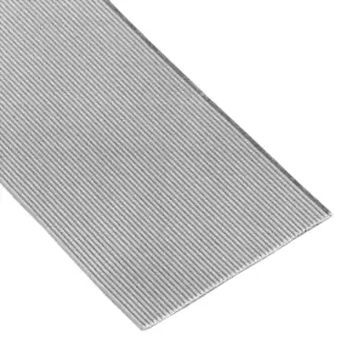

8 TM 3M 7 6 5 4 3 2 1 NOTES ROUND CONDUCTOR FLAT CABLE, 3756 SERIES 1. REGULATORY INFORMATION: FOR REGULATORY INFORMATION ABOUT THIS PRODUCT, VISIT 3m.com/regs OR CONTACT YOUR 3M REPRESENTATIVE. .025" 30 AWG STRANDED, TPE UL FILE NO: E42769. STYLE NO: 20297 D 2. .025 INCH WIRE SPACING INCREASES SIGNAL DENSITY DIM A DIM B .013 0.33 .005 .025 D 3. TPE INSULATION PROVIDES EXCELLENT TRANSMISSION PROPERTIES. 4. 30 AWG STRANDED CONDUCTORS ON .025 INCH WIRE SPACING IS DESIGNED FOR MASS TERMINATION AND FLEXIBILITY. .002 TYP 0.64 5. MEETS THE SCSI-3 CHARACTERISTIC IMPEDANCE REQUIREMENTS. .025 ORDERING INFORMATION 3756/XX XX BLANK = STANDARD C = CANADIAN CERTIFIED VERSION .003 6 BLUE MARKING ON ONE EDGE OF CABLE DESIGNATES WIRE #1. 0.64 6 30 AWG, 7 X 38 AWG [7 X 0.102] TINNED STRANDED COPPER CONDUCTORS BLANK = STANDARD SF = SPLICE FREE TPE INSULATION NUMBER OF CONDUCTORS (SEE TABLE) C C NOTE: AVAILABLE IN STANDARD 100 FT OR 300 FT ROLLS. PLEASE SPECIFY WHEN ORDERING. CONTACT 3M FOR AVAILABILITY OF ADDITIONAL CONDUCTOR COUNTS AND/OR CUSTOM ROLL LENGTHS. PHYSICAL: INSULATION MATERIAL: COLOR: MARKING STANDARD: CANADIAN: THERMOPLASTIC ELASTOMER, TPE (TPO TYPE) GRAY NONE SEE "PRINTING ILLUSTRATION" VIEW TABLE 1 0.225 0.275 0.325 0.375 0.475 0.625 0.725 0.825 0.875 0.975 1.225 1.475 1.675 1.975 2.475 .004 [5.72] .004 [6.99] .004 [8.26] .004 [9.53] .004 [12.07] .004 [15.88] .006 [18.42] .006 [20.96] .006 [22.23] .006 [24.77] .006 [31.12] .009 [37.47] .009 [42.55] .011 [50.17] .012 [62.87] ELECTRICAL: VOLTAGE RATING: USA 150V CANADIAN 150V 10 INSULATION RESISTANCE: >1 X 10 /10ft. [3m] CHARACTERISTIC IMPEDANCE: CAPACITANCE: INDUCTANCE: PROPAGATION DELAY: VELOCITY OF PROPAGATION: UNBALANCED 82 17.3 pF/ft [56.8 pF/m] 0.12 H/ft [0.38 H/m] 1.42 ns/ft [4.66 ns/m] 72% EU:

物料型号:3M公司生产的电缆型号包括3756/10至3756/100,以及3758/20和3758/68,具体型号取决于导体数量。
器件简介:该电缆由30 AWG、7股38 AWG(7股0.102mm)镀锡软铜导体构成,绝缘材料为热塑性弹性体TPE(TPO类型),颜色为灰色。
引脚分配:文档中没有提供具体的引脚分配信息。
参数特性:电缆的尺寸和公差详细列出,例如尺寸A和尺寸B的典型值和公差。电学特性包括未平衡电压等级150V,绝缘电阻大于10^10欧姆/10英尺,特性阻抗82欧姆,电容17.3pF/英尺,电感0.12H/英尺,传播延迟1.42ns/英尺,传播速度72%。
功能详解:电缆设计用于满足SCSI-3特性阻抗要求,具有高信号密度和优秀的传输特性。30 AWG绞合导体在0.025英寸线间距上设计,适用于大量端接和灵活性。
应用信息:适用于需要高信号密度和灵活性的应用场合。
封装信息:电缆的标准卷长为100英尺或300英尺,可根据需要定制其他导体数量或卷长。
