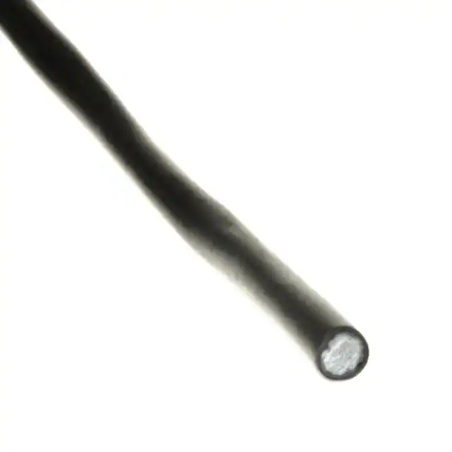

3M™ Round, Jacketed, Flat Cable .050" 28 AWG Stranded, Mass-Term, PVC/PVC 3759 Series • Round construction permits easier routing • 28 AWG wire on .050 inch centers permits mass termination to broad line of IDC connectors • Continuous bond and continuous split/bond allows for mass termination of IDC connectors • Available in continuous bond (non–split) wire for ease of cable fabrication • Meets external wiring requirements of National Electrical Code, Article 725 (CL2) • Primary cable is zippable for branching or discrete terminations • UL recognized for USA and Canadian markets • Visit 3M.com/regs or contact your 3M representative to find the RoHS compliance status of the 3M part you are interested in. Date Modified: April , 201  TS-0070-F Sheet 1 of 2 Physical Jacket Material: Polyvinyl Chloride (PVC); Color: Black Primary Material:: PVC; Color: Gray Marking Standard: (UL) CL2 75C 28 AWG OR AWM 20267 3M NU C AWM II A/B 80C 300V FT1 EU 1 x 1010Ω /10 ft [3 m] Characteristic Impedance: Unbalanced Balanced 90 Ω Capacitance: 16.7 pF/ft [ 54.8 pF/m ] Inductance: 0.13 μH/ft [ 0.44 μH/m ] EU:

物料型号:3M™ 3759系列 器件简介:这种电缆设计为圆形结构,便于布线,使用28 AWG导线,间距为0.050英寸,适用于大量IDC连接器的集体端接。 引脚分配:文档中未明确列出引脚分配,但提到电缆适用于多种导体数量,从9到64不等。 参数特性:电缆的电气特性包括300V的电压等级,绝缘电阻大于1x10^10Ω/10英尺,特性阻抗为不平衡90Ω和平衡133Ω,电容为16.7pF/ft,传播延迟为1.50ns/ft,传播速度为68%。 功能详解:电缆设计允许集体端接IDC连接器,符合美国国家电气代码725(CL2)的外部布线要求,并且主电缆可以拉链式分支或单独端接。 应用信息:适用于美国和加拿大市场,UL认可,有关RoHS合规性状态可访问3M.com/regs或联系3M代表查询。 封装信息:电缆的物理特性包括聚氯乙烯(PVC)护套,颜色为黑色,主要材料为灰色PVC,标记标准为UL CL2 75C 28 AWG等。
