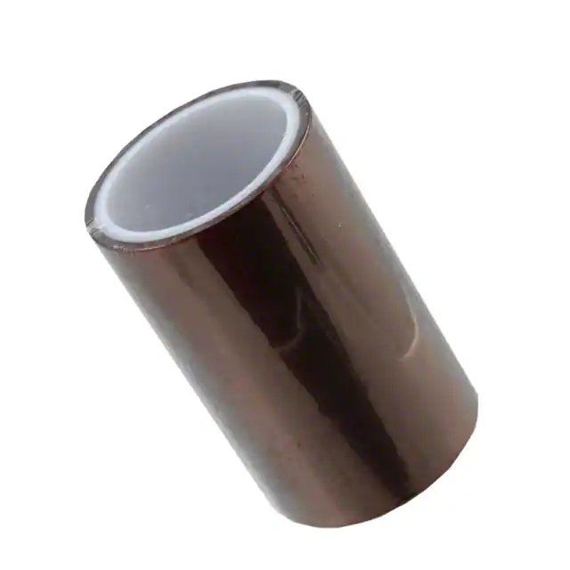

Technical Data | July 2021 3M™ Low Static Polyimide Film Tape 5419 Product Description 3M™ Low Static Polyimide Film Tape 5419 is a translucent, polyimide film-backed silicone adhesive tape with unique and extremely low electrostatic discharge properties. Features • • • • • Employs a proprietary technology that results in extremely low electrostatic discharge at unwind and removal from the PWB. Conventional polyimide tapes can typically generate over 10,000 volts during use which can damage board mounted electronic components. 3M Low Static Polyimide Film tape 5419 overcomes this problem without any of the typical drawbacks of conventional “anti-static” or “static-free” tapes (e.g. variable adhesion and opaqueness). At room temperature the properties of polyimide and polyester film are similar. However, as the temperature increases or decreases, the properties of the polyimide film are less affected than polyester. Polyimide film does not soften at elevated temperatures, thus, the film provides an excellent release surface at elevated temperatures Gold tab protection during wave solder of printed circuit boards. RoHS compliant. Product Construction/Material Description Note: The following technical information and data should be considered representative or typical only and should not be used for specification purposes. Backing Polyimide Adhesive Silicone Color Gold Standard Roll Length 36 yds (33 m) Typical Physical Properties and Performance Characteristics Note: The following technical information and data should be considered representative or typical only and should not be used for specification purposes. Final product specifications and testing methods will be outlined in the products Certificate of Analysis (COA) that is shipped with the commercialized product. 3M™ Low Static Polyimide Film Tape 5419 Property Value Method* Adhesion to Steel: Tensile Strength at Break: 20 oz./in. width (22 N/100 mm) 33 lbs./in. width (578 N/100 mm) D-3330 D-3759 Elongation at Break: Backing Thickness: Total Tape Thickness: Temperature Use Range: Dielectric Strength: Insulating Resistance: Static Charge: (measured at 50% RH, 70°F(21°C ) in an ESD controlled environment) Outgassing: 60% 1.0 mil (0.03 mm) 2.7 mil (0.07 mm) -73° to 260°C (-100° to 500°F) 7000 volts >1*106 ohms Removal from roll:

物料型号:3M™ Low Static Polyimide Film Tape 5419
器件简介:这是一种半透明的聚酰亚胺薄膜胶带,背面涂有硅酮粘合剂,具有独特的极低静电放电特性。
引脚分配:文档中未提及引脚分配信息。
参数特性: - 粘合力:20盎司/英寸宽度 - 断裂时的拉伸强度:33磅/英寸宽度 - 断裂时的伸长率:60% - 基材厚度:1.0密耳 - 胶带总厚度:2.7密耳 - 使用温度范围:-73°至260°C - 介电强度:7000伏特 - 绝缘电阻:大于10^12欧姆 - 静电电荷:卷取时<150伏特,从PWB移除时<50伏特 - 放气性:TLM=0.58%,CVM=0.24%
功能详解: - 该胶带在解卷和从印刷电路板(PWB)移除时具有极低的静电放电,克服了传统聚酰亚胺胶带可能对电子元件造成的损害。 - 聚酰亚胺薄膜在高温下不会软化,提供了优异的高温释放表面。 - 符合RoHS标准。
应用信息: - 作为印刷电路板在波峰焊或浸焊过程中的掩膜。 - 作为在高温下固化部件的制造过程中的释放表面。
封装信息:文档中未提及封装信息,但提供了标准卷长度为36码(33米)。
存储和保质期:在原始包装材料中存储,存储在16至27°C(60°至80°F)和40-50%相对湿度下,保质期为3年。
安全数据表和法规信息:在使用前请咨询安全数据表,并联系3M代表获取法规信息。
