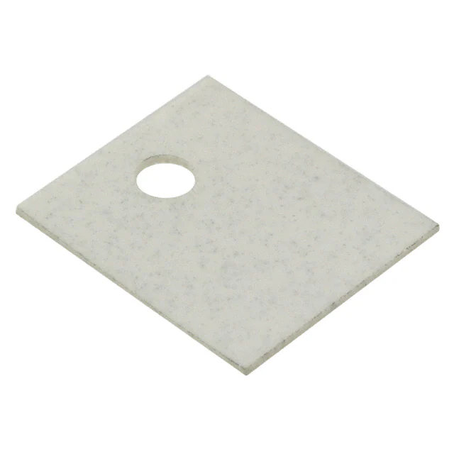

Technical Data | July 2020 3M™ Thermally Conductive Acrylic Interface Pad 5590H Product Description 3M™ Thermally Conductive Acrylic Interface Pad 5590H is designed to provide a preferential heat transfer path between heat generating components, such as IC Chip or Electric Vehicle (EV) battery, and heat sink or spreader. It consists of highly conformable, slightly tacky acrylic elastomer sheets filled with thermally conductive ceramic particles. These highperforming thermal pads have the following features: Key Features • • • • • • • • • Easy handling and soft pad High conformability even for non-flat IC surfaces and automotive EV batteries Incorporates a thin, firm acrylic layer for good handling Highly thermally conductive while electrically insulating Slight tack allows pre-assembly Good wettability for better thermal conductivity Non-silicone acrylic elastomer Excellent durability UL94 V-0 listed (File No. E176845) Product Construction/Material Description Thermally conductive conformable layer Thermally conductive firm layer (less tack) permanent PET liner (outside of roll) Note: The following technical information and data should be considered representative or typical only and should not be used for specification purposes. 3M™ Thermally Conductive Acrylic Interface Pad 5590H Property Value Color Base resin Thickness Filler type Very low tack layer Low tack layer White/Gray Acrylic 0.5, 1.0mm, 1.5 mm, 2.0 mm (thicker pads available upon request) Ceramic Good for re-workability and handling, light gray color-permanent layer Soft, good thermal conductivity, white color 3M™ Thermally Conductive Acrylic Interface Pad 5590H Applications • Heat transfer in consumer electronics and automotive electronic products • Decrease of compression stress to electronic parts by thermal pad conformability Examples: o Heat transfer between PCB and heat sink o Thermal management in automotive EV batteries o Power electronics component thermal management o Chip on film (COF) heat conduction o Automotive electronics o LED thermal management o General gap filling in electronic devices Typical Physical Properties and Performance Characteristics Note: The following technical information and data should be considered representative or typical only and should not be used for specification purposes. Final product specifications and testing methods will be outlined in the product’s Certificate of Analysis (COA) that is shipped with the commercialized product. This value is a measured value, not a guaranteed value. 3M™ Thermally Conductive Acrylic Interface Pad 5590H Property Method Thermal conductivity Thermal conductivity Hardness Value Volume Resistivity 3M Method ASTM D5470 Asker C Shore 00 ASTM D257 2.8 W/mK 2.0 W/mK *1 55*2 70 6 X 10 11 (Ω-cm) Dielectric strength ASTM D149 12 (kV/mm) Density Flammability Operating Temperature Range ASTM D6111 UL94 Short Term (Hours-Days) Long Term (Weeks-Months) 2.1 (g/cm3) V-0 -40°C to 130°C -40°C to 110°C Methods listed as ASTM are tested in accordance with the ASTM method noted. Sample thickness are 2-8mm. Sample size is 33mmφ. Pressure condition is fixed at 200kPa, with thickness control. *2 Test results are based on a 6mm thickness sample. Sample tested to soft layer side of sample pad. *1 3M™ Thermally Conductive Acrylic Interface Pad 5590H Heat Resistance * Note: The following technical information and data should be considered representative or typical only and should not be used for specification purposes. Final product specifications and testing methods will be outlined in the product’s Certificate of Analysis (COA) that is shipped with the commercialized product. This value is a measured value, not a guaranteed value. As tested on 3M™ Thermally Conductive Acrylic Interface Pad 5590H Duration (hrs) Thermal conductivity (W/m-K) Hardness (Asker C) Appearance Initial 3.0 30 - 1000 3.0 33 No effect 2000 3.0 34 No effect *Note1: Aged by dwelling at 110℃ in high temperature chamber. *Note2: Thermal conductivity for aging tested using the 3M Method. Storage and Shelf Life The shelf life of 3M™ Thermally Conductive Acrylic Interface Pad 5590H is 24 months from the date of manufacture when stored in the original packaging materials and stored at 21°C (70°F) and 50% relative humidity. Certificate of Analysis (COA) The 3M Certificate of Analysis (COA) for this product is established when the product is manufactured and deemed commercially available from 3M. The COA contains the 3M test methods, specifications limits and test results for the product’s performance attributes that the product will be supplied against. Contact your local 3M representative for this product’s COA. 3M™ Thermally Conductive Acrylic Interface Pad 5590H Regulatory: For regulatory information about this product, contact your 3M representative. Technical Information: The technical information, recommendations and other statements contained in this document are based upon tests or experience that 3M believes are reliable, but the accuracy or completeness of such information is not guaranteed. Product Use: Many factors beyond 3M’s control and uniquely within user’s control can affect the use and performance of a 3M product in a particular application. Given the variety of factors that can affect the use and performance of a 3M product, user is solely responsible for evaluating the 3M product and determining whether it is fit for a particular purpose and suitable for user’s method of application. Warranty, Limited Remedy, and Disclaimer: Unless an additional warranty is specifically stated on the applicable 3M product packaging or product literature, 3M warrants that each 3M product meets the applicable 3M product specification at the time 3M ships the product. 3M MAKES NO OTHER WARRANTIES OR CONDITIONS, EXPRESS OR IMPLIED, INCLUDING, BUT NOT LIMITED TO, ANY IMPLIED WARRANTY OR CONDITION OF MERCHANTABILITY OR FITNESS FOR A PARTICULAR PURPOSE OR ANY IMPLIED WARRANTY OR CONDITION ARISING OUT OF A COURSE OF DEALING, CUSTOM OR USAGE OR TRADE. If the 3M product does not conform to this warranty, then the sole and exclusive remedy is, at 3M’s option, replacement of the 3M product or refund of the purchase price. Limitation of Liability: Except where prohibited by law, 3M will not be liable for any loss or damage arising from the 3M product, whether direct, indirect, special, incidental or consequential, regardless of the legal theory asserted, including warranty, contract, negligence or strict liability. Electronics Materials Solutions Division 3M Center, Building 224-3N-11 St. Paul, MN 55144-1000 1-800-251-8634 phone 651-778-4244 fax www.3M.com/electronics 3M is a trademark of 3M Company. Please recycle. ©3M 2020. All rights reserved. 60-5005-0122-0

物料型号:3M™ Thermally Conductive Acrylic Interface Pad 5590H
器件简介:该产品旨在为发热组件(如集成电路芯片或电动汽车(EV)电池)与散热器或扩散器之间提供优先的热传导路径。它由高度可塑、轻微粘性的丙烯酸弹性体片组成,内含热导性陶瓷颗粒。
引脚分配:文档中未提及引脚分配,因为这是一个热界面材料,而不是电子元件。
参数特性: - 颜色:白/灰 - 基材:丙烯酸 - 厚度:0.5mm, 1.0mm, 1.5mm, 2.0mm(可按需提供更厚的垫片) - 填充类型:陶瓷 - 热导性:2.8 W/mK (3M方法) / 2.0W/mK (ASTM D5470) - 硬度:Asker C 552 / Shore 00 70 - 体积电阻率:6X10^-5 Ω·cm - 介电强度:12 kV/mm - 密度:2.1 g/cm³ - 阻燃性:UL94 V-0 - 工作温度范围:短期 -40°C至130°C / 长期 -40°C至110°C
功能详解:该产品具有易于处理、高可塑性、轻微粘性、良好的热湿性、非硅酮丙烯酸弹性体、优异的耐用性等特点。
应用信息: - 消费电子和汽车电子产品中的热传递 - 通过热垫的可塑性减少对电子部件的压缩应力 - 应用实例包括PCB与散热器之间的热传递、汽车EV电池的热管理、功率电子组件的热管理、芯片上膜(COF)的热传导、汽车电子、LED热管理、电子设备中的一般间隙填充。
封装信息:文档中未提供封装信息,因为这是一个热界面材料,通常以卷装形式提供。
存储和保质期:在原始包装材料中存储,存储在21°C (70°F)和50%相对湿度下,保质期为24个月。
