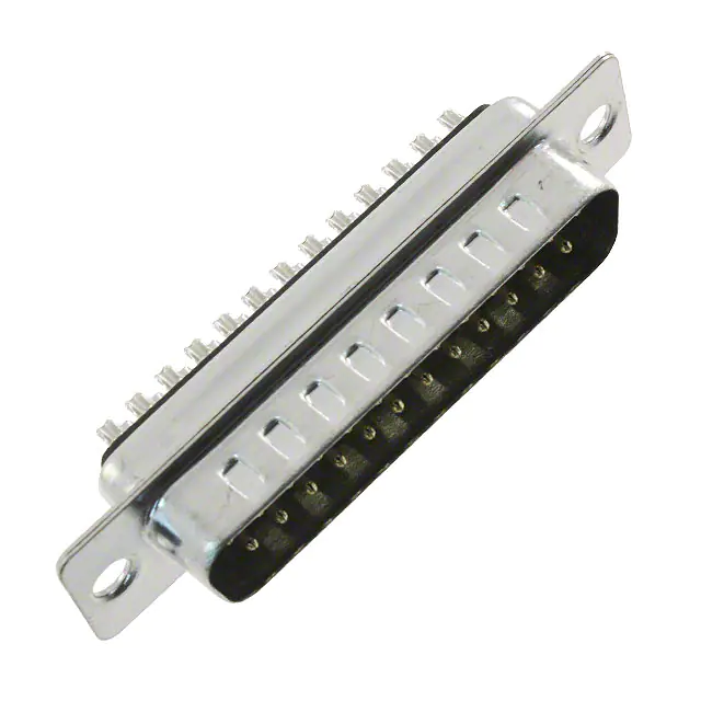

    25 位 D-Sub 插头,公引脚 连接器, 面板安装 焊杯
8P25-N001 数据手册
8 TM 3M 7 6 5 4 3 2 1 NOTES Solder Cup D Sub Plug, 8000 Series 1 MATERIAL: THERMAL PLASTIC UL94V-0 CONTACTS: COPPER ALLOY SHELL: G3141 SPCC OR EQUIVALENT 2 PLATING: 50 " NICKEL UNDERPLATE 1 " AU WIPING AREA 30 " AU WIPING AREA 100-200 " TIN(BRIGHT TIN)SOLDERTAIL D POSITION A B C 09 [.67] 16.92 [.98] 25.0 [1.21] 30.8 15 [.99] 25.25 [1.31] 33.3 [1.54] 39.2 25 [1.53] 38.96 [1.85] 47.1 [2.09] 53.1 37 [2.18] 55.42 [2.50] 63.5 [2.73] 69.4 50* [2.08] 52.8 [2.4] 61.0 [2.64] 67.0 STANDARD C B D [.76] 19.2 [1.09] 27.7 [1.62] 41.1 [2.26] 57.3 [2.17] 55.1 PERFORMANCE OPERATION VOLTAGE: 250VAX MAX. CURRENT: 3A MAX. INSULATION RESISTANCE: 3000 MOhm MIN @ 500VDC WITHSTANDING VOLTAGE: 1000 VAC/ MIN TEMPERATURE RATING:. -55 C to + 105 C CONTACT RESISTANCE: 15 mOhms MAX *50 POSITION AVAILABLE IN STANDARD ONLY A D 3 MATES WITH: 8RXX-X00X 4 SEE THE REGULATORY INFORMATION APPENDIX (RIA) IN "RoHS COMPLIANCE" SECTION OF WWW.3MCONNECTOR.COM FOR COMPLIANCE INFORMATION (RIA E1&C1 APPLY) .492 12.50 1 .327 8.30 .122 3.10 .112 2.84 .109 2.77 EMI C .236 6.00 B C C A .327 8.30 .492 12.50 .051 1.30 D .112 2.84 .109 2.77 C 78-5100-2357-1 .236 6.00 50 POSITION C B .122 3.10 A .112 2.84 D B DRAWING NUMBER .303 7.70 REVISION .122 3.10 B .602 15.30 .445 11.30 8PXX-X00X C 46292 MAR 28,2013 SJS ARM CORRECT SHELL MATL .236 6.00 B PLATING 1 - AU FLASH 2 - 30 " AU NUMBER OF CONTACTS (SEE TABLE) A .224 5.68 EMI N - STANDARD E - EMI NEXT ASSEMBLY DIVISION Unless otherwise noted, references to industry specifications are intended to indicate substantial compliance to the material elements of the specification. Such references should not be construed as a guarantee of compliance to all requirements in a given specification. 3M IS A TRADEMARK OF 3M COMPANY. FOR TECHNICAL, SALES OR ORDERING INFORMATION, CALL 800-225-5373 7 6 34511 MAY 17,2011 REV ECO SJS ARM ISSUE DATE AND DESCRIPTION DRFT DATE SJS MAY 17,2011 CHKD DATE ARM MAY 17,2011 DIVISION CODE C 3M Center 3M ELECTRONIC SOLUTIONS DIVISION INTERCONNET SOLUTIONS http://www.3mconnectors.com 8 SJS ARM MAY 17, 2011 ACCESS CODES D AUG 29,2011 CHANGE MOHMS TO mOHMS, UPDATE ROHS DESIGN REFERENCE A 35416 5 4 3 DO NOT SCALE DRAWING 1 1 THIRD ANGLE PROJECTION INTERPRET PER ASME Y14.5 - 1994 MAX SURFACE ROUGHNESS 125 St. Paul, TOLERANCES EXCEPT AS NOTED SCALE ALL SURFACES MARKED ONLY 2 INCHES .0 .00 .000 .0000 MILLIMETERS 0 1 .0 .5 .00 .05 .000 .005 ANGLES 1 MN 55144 DRFT MFG DATE APPVL DATE CHKD A 3M COPYRIGHT 2013 This document and the information it contains are 3M property and may not be reproduced or further distributed without 3M permission, or used or disclosed other than for 3M authorized purposes. All rights reserved. TITLE 8PXX-X00X D-SUB SOLDER CUP PLUG TS-2357 CAGE SIZE NUMBER MODEL 8P DRAWING NO. REV. 78-5100-2357-1 DET. LISTS 1 YES NO C SHT 1 OF 2 8 POSITION 9 D 15 25 37 50 7 MOUNTING METHOD FRONT REAR FRONT REAR FRONT REAR FRONT REAR FRONT REAR 6 5 4 A B C D E F G H J .874[22.2] .806[20.5] 1.202[30.5] 1.134[28.8] 1.743[44.3] 1.674[42.5] 2.391[60.7] 2.326[59.1] 2.297[58.3] 2.218[56.3] .437[11.1] .403[10.2] .601[15.3] .567[14.4] .872[22.2] .837[21.3] 1.196[30.4] 1.163[29.5] 1.149[29.2] 1.109[28.2] .984[25.0] .984[25.0] 1.312[33.3] 1.312[33.3] 1.852[47.0] 1.852[47.0] 2.500[63.5] 2.500[63.5] 2.406[61.1] 2.406[61.1] .492[12.5] .492[12.5] .656[16.7] .656[16.7] .926[23.5] .926[23.5] 1.250[31.8] 1.250[31.8] 1.203[30.6] 1.203[30.6] .513[13.0] .449[11.4] .513[13.0] .449[11.4] .513[13.0] .449[11.4] .513[13.0] .449[11.4] .623[15.8] .555[14.1] .257[6.5] .225[5.7] .257[6.5] .225[5.7] .257[6.5] .225[5.7] .257[6.5] .225[5.7] .312[7.9] .278[7.1] .120[3.1] .120[3.1] .120[3.1] .120[3.1] .120[3.1] .120[3.1] .120[3.1] .120[3.1] .120[3.1] .120[3.1] .060[1.5] .060[1.5] .060[1.5] .060[1.5] .060[1.5] .060[1.5] .060[1.5] .060[1.5] .060[1.5] .060[1.5] .083[2.1] .132[3.4] .083[2.1] .132[3.4] .083[2.1] .132[3.4] .083[2.1] .132[3.4] .083[2.1] .132[3.4] 3 2 1 D A R0.81 MAX TYP J RADIUS TYP B C H C F E G C 78-5100-2357-1 C CUTOUT FOR FRONT MOUNT DRAWING NUMBER FULL RADIUS REVISION 10 D G B B D C CUTOUT FOR REAR MOUNT C 46292 MAR 28,2013 SJS ARM CORRECT SHELL MATL B 35416 AUG 29,2011 SJS ARM CHANGE MOHMS TO mOHMS, UPDATE ROHS A 34511 MAY 17,2011 SJS ARM MAY 17, 2011 DESIGN REFERENCE NEXT ASSEMBLY ACCESS CODES A DIVISION REV ECO ISSUE DATE AND DESCRIPTION DRFT DATE SJS MAY 17,2011 CHKD DATE ARM MAY 17,2011 DIVISION CODE C 3M Center DO NOT SCALE DRAWING 1 1 THIRD ANGLE PROJECTION INTERPRET PER ASME Y14.5 - 1994 MAX SURFACE ROUGHNESS 125 ALL SURFACES MARKED ONLY 8 7 6 5 4 3 St. Paul, TOLERANCES EXCEPT AS NOTED SCALE 2 INCHES .0 .00 .000 .0000 MILLIMETERS 0 1 .0 .5 .00 .05 .000 .005 ANGLES 1 MN 55144 DRFT MFG DATE APPVL DATE CHKD A 3M COPYRIGHT 2013 This document and the information it contains are 3M property and may not be reproduced or further distributed without 3M permission, or used or disclosed other than for 3M authorized purposes. All rights reserved. TITLE 8PXX-X00X D-SUB SOLDER CUP PLUG TS-2357 CAGE SIZE NUMBER MODEL 8P DRAWING NO. REV. 78-5100-2357-1 DET. LISTS 1 YES NO C SHT 2 OF 2
8P25-N001
物料型号: 8000 Series D-SUB SOLDER CUP PLUG 器件简介: 3M品牌的电子解决方案部门生产的SOLDER CUP PLUG连接器,使用在8RXX-X00X型号上。 引脚分配: 文档中提供了引脚的详细分配,但具体数值被省略。 参数特性: - 操作电压: 250V AC MAX - 最大电流: 3A - 电阻: 最小3000 MOhm @ 500VDC 和最大15 mOhms - 电压额定: 1000 VAC/ MIN - 工作温度范围: -55°C 至 +105°C 功能详解: 该连接器具备EMI防护功能,具体数值未提供。 应用信息: 该连接器与8RXX-X00X型号相匹配使用。 封装信息: 提供了两种封装尺寸,50位和8位,50位的封装仅在标准配置中提供。
