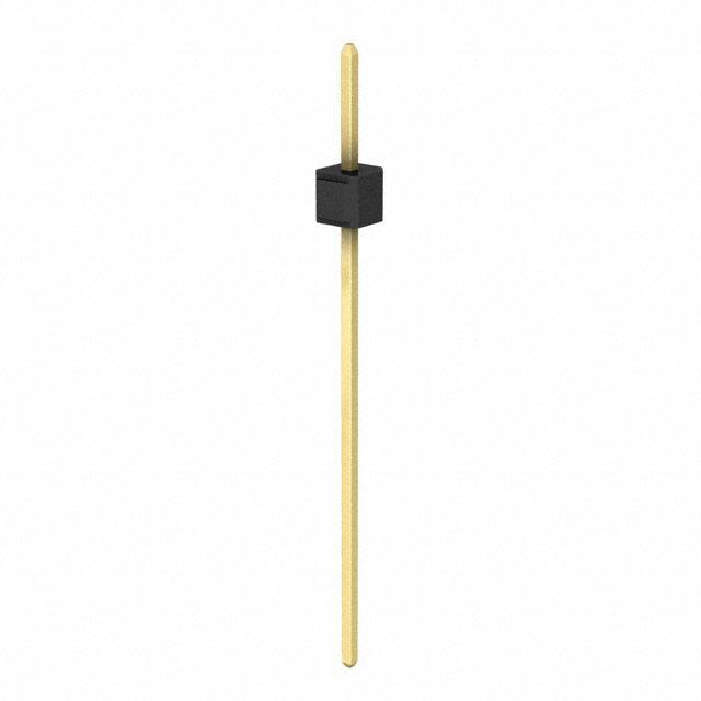

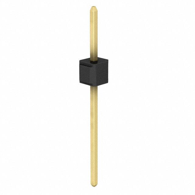

    排针 1x1P 直插
929647-07-01-I 数据手册
3M™ Pin Strip Header Single and Dual Row .100”, .235”/.318” Mating Length, Straight & Right Angle, Solder Tails 929 Series • Stackable • Gold, Matte Sn, or Tin-Lead plating options • High Temperature (PCT) plastic for Wave or IR soldering • Solder stand-off for wave soldering • Board pin retention feature option • See Regulatory Information Appendix (RIA) for chemical compliance information Date Modified: November 6, 2008 TS-0769-E Sheet 1 of 4 Physical Insulation: Material: Glass Filled Polyester (PBT) or High Temperature (PCT) Flammability: UL 94V-0 Color: Black Contact: Material: Copper Alloy Plating: Underplating: 50 µ” [1.27 µm] Nickel Wiping Area and Solder Tails: See ordering information (Gold, Matte Tin, Tin-Lead options) Marking: None Electrical Current Rating: 2.5 A Insulation Resistance: > 5 × 109 Ω at 500 VDC Withstanding Voltage: 1500 VRMS at Sea Level Environmental Temperature Rating: -40°C to +105°C Process Rating: 260°C (per J-STD-020C) for PCT parts only (PBT insulator version), maximum insulator temperature 191°C (Solder Wave Process Only) Moisture Sensitivity Level: Level 1 (per J-STD-020C) for PCT parts UL File No.: E68080 3 Electronic Solutions Division Interconnect Solutions http://www.3M.com/interconnects/ 3M is a trademark of 3M Company. For technical, sales or ordering information call 800-225-5373 3M™ Pin Strip Header Single and Dual Row .100”, .235”/.318” Mating Length, Straight & Right Angle, Solder Tails C 929 Series PCB Edge 2x .050 Max [1.27] "B" ±.015 0.075±.005 [1.91] 0.100±0.003 [2.54] 0.040±0.003 [1.02] AFTER PLATING 0.115 [2.92] 0.170 Min [4.32] "C" RIGHT ANGLE SOLDER WRAP TAILS .070±.010 [1.78] "B"±.015 0.100 [2.54] TYP 0.100±.003 [2.54] 0.060 [1.52] "A"±.008 0.100 [2.54] 0.040±.003 [1.02] AFTER PLATING STRAIGHT SOLDER WRAP TAILS 0.025±0.001 SQ. TYP. [0.64] RECOMMENDED HOLE PATTERN 0.100 [2.54] "B" ±.015 0.075±0.005 [1.91] .215 [5.46] 0.100 [2.54] 0.100 [2.54] 0.070±0.005 [1.78] "C" 0.170 0.060 [1.52] "A"±.008 "B"±.015 0.025±0.001 SQ. TYP. [0.640] 0.100 TYP. [2.54] 0.100 [2.54] 0.100 [2.54] 0.100 PCB EDGE 0.040±.003 [1.02] AFTER PLATING 0.100 [2.54] 2x .050 Max. [1.27] 0.100±.003 [2.54] 0.100±.003 [2.54] 0.040±.003 [1.02] AFTER PLATING STRAIGHT WIREWRAP TAILS RECOMMENDED HOLE PATTERN Inch [mm] Tolerance Unless Noted inch .0 .00 .000 ±.1 ±.01 ±.005 [ ] Dimensions for Reference only Notes: 1. Dimension C is a maximum when the pin strip is cut to length, not when the strip is broken to length. 2. Board pin retention feature available: change from ‘‘9X9’’ to ‘‘9R9’’ when ordering. 3. Breaking of dual row parts is not recommended. 3 Electronic Solutions Division Interconnect Solutions http://www.3M.com/interconnects/ TS-0769-E Sheet 2 of 4 3M is a trademark of 3M Company. For technical, sales or ordering information call 800-225-5373 3M™ Pin Strip Header Single and Dual Row .100”, .235”/.318” Mating Length, Straight & Right Angle, Solder Tails Single Row Tail Length Code Table 2 Table 1 Plating 3M Part Number 929647 Straight Gold 929648 Right Angle 929705 Straight 929834 Straight Tin 929835 Right Angle 929700 Straight 929730 Right Angle Tail Length Code Dimensions A B 01 0.110 [2.79] 09 0.145 [3.68] 02 0.210 [5.33] 03 0.235 [5.97] 0.510 [12.95] 05 0.610 [15.49] 07 0.910 [23.11] Pin Quantity Per Row Dimension C (see note 1) 01 0.10 [2.5] 02 03 06 0.60 [15.2] 07 08 09 10 11 12 01 0.110 [2.79] 11 0.125 [3.18] 14 09 0.318 [8.08] 06 0.710 [18.03] 01 0.110 [2.79] 02 0.210 [5.33] 03 0.410 [10.41] 04 0.235 [5.97] 0.610 [15.49] 07 0.910 [23.11] 0.235 [5.97] 01 11 16 17 18 19 20 21 22 23 24 25 26 0.110 [2.79] 27 28 0.110 [2.79] 0.318 [8.08] 06 01 15 0.510 [12.95] 05 01 13 0.145 [3.68] 29 0.125 [3.18] 30 0.710 [18.03] 0.318 [8.08] 31 32 0.110 [2.79] 0.30 [7.6] 0.40 [10.2] 0.110 [2.79] 0.235 [5.97] 0.20 [5.1] 04 05 0.410 [10.41] 04 01 929 Series 33 34 35 36 0.50 [12.7] 0.70 [17.8] 0.80 [20.3] 0.90 [22.9] 1.00 [25.4] 1.10 [27.9] 1.20 [30.5] 1.30 [33.0] 1.40 [35.6] 1.50 [38.1] 1.60 [40.6] 1.70 [43.2] 1.80 [45.7] 1.90 [48.3] 2.00 [50.8] 2.10 [53.3] 2.20 [55.9] 2.30 [58.4] 2.40 [61.0] 2.50 [63.5] 2.60 [66.0] 2.70 [68.6] 2.80 [71.1] 2.90 [73.7] 3.00 [76.2] 3.10 [78.7] 3.20 [81.3] 3.30 [83.8] 3.40 [86.4] 3.50 [88.9] 3.60 [91.4] Gold Single Row Ordering Information 9X9XXX-XX-XX-XX 2 = No Pin Retention R = Pin Retention 3M Part Number (select from Table 1 based on Dim A and plating) (see table1) Tail Length Code (see table 1) 2 = No Pin Retention R = Pin Retention Electronic Solutions Division Interconnect Solutions http://www.3M.com/interconnects/ Tin 9X9XXX-XX-XX-XX 3M Part Number (select from Table 1 based on Dim A and plating) (see table1) Tail Length Code (see table 1) 3 Gold Plating Suffix Location & Thickness (see table 1) I = 10 μ” [0.25 μm] all over, PBT insulator (RIA E1 & C1 apply) Pin Quantity Per Row EU = 10 μ” [0.25 μm] all over, PCT insulator (see table 2) (RIA E1 & C1 apply) Pin Quantity Per Row (see table 2) Plating Suffix: blank = 100 μ” [2.54 μm] tin-lead, PBT insulator (RIA E3 & C2 apply) RK = 200 μ” [5 µm] matte tin, PCT insulator (RIA E1 & C1 apply) TS-0769-E Sheet 3 of 4 3M is a trademark of 3M Company. For technical, sales or ordering information call 800-225-5373 3M™ Pin Strip Header Single and Dual Row .100”, .235”/.318” Mating Length, Straight & Right Angle, Solder Tails Dual Row Tail Length Code Table 4 Table 3 Plating 3M Part Number Dimensions Tail Length Code A B 01 0.145 [3.68] 02 08 0.235 [5.97] 03 04 Gold 929715 Straight 11 10 0.318 [8.08] 03 04 0.235 [5.97] 02 01 929745 Right 0.318 [8.08] 02 01 929836 Straight 02 08 0.235 [5.97] 03 11 929710 Straight 0.318 [8.08] 10 03 06 929838 Right Angle 01 0.235 [5.97] 04 02 06 10 0.125 [3.18] 11 0.175 [4.45] 12 0.410 [10.41] 13 14 0.110 [2.79] 15 0.145 [3.68] 16 0.405 [10.29] 17 0.110 [2.79] 18 0.405 [10.29] 19 20 21 0.210 [5.33] 22 0.310 [7.87] 23 0.410 [10.41] 24 25 26 0.110 [2.79] 09 03 09 0.610 [15.49] 01 0.10 [2.5] 08 0.510 [12.95] 05 02 07 0.145 [3.68] 04 Tin 0.410 [10.41] 0.110 [2.79] 09 01 06 0.710 [18.03] 01 Dimension C (see note 1) 05 0.310 [7.87] 0.110 [2.79] 06 929667 Right Angle 0.210 [5.33] 0.610 [15.49] 01 Pin Quantity Total Dual Row 04 0.510 [12.95] 05 Pin Quantity Per Row 02 0.110 [2.79] 09 929665 Straight 0.125 [3.18] 27 0.175 [4.45] 29 0.710 [18.03] 31 0.145 [3.68] 28 0.410 [10.41] 30 32 0.110 [2.79] 33 0.145 [3.68] 34 0.405 [10.29] 35 36 Dual Row Ordering Information 0.30 [7.6] 08 0.40 [10.2] 12 0.60 [15.2] 10 14 16 18 20 22 24 26 28 30 32 34 36 38 40 42 44 46 48 50 52 54 56 58 60 62 64 66 68 70 72 0.50 [12.7] 0.70 [17.8] 0.80 [20.3] 0.90 [22.9] 1.00 [25.4] 1.10 [27.9] 1.20 [30.5] 1.30 [33.0] 1.40 [35.6] 1.50 [38.1] 1.60 [40.6] 1.70 [43.2] 1.80 [45.7] 1.90 [48.3] 2.00 [50.8] 2.10 [53.3] 2.20 [55.9] 2.30 [58.4] 2.40 [61.0] 2.50 [63.5] 2.60 [66.0] 2.70 [68.6] 2.80 [71.1] 2.90 [73.7] 3.00 [76.2] 3.10 [78.7] 3.20 [81.3] 3.30 [83.8] 3.40 [86.4] 3.50 [88.9] 3.60 [91.4] Pin Quantity Per Row (see table 4) Tin Gold Plating Suffix Location & Thickness (see table 1) I = 10 μ” [0.25 μm] all over, PBT insulator (RIA E1 & C1 apply) EU = 10 μ” [0.25 μm] all over, PCT insulator (RIA E1 & C1 apply) 9X9XXX-XX-XX-XX 3M Part Number (select from Table 3 based on Dim A and plating) (see table 3) Tail Length Code (see table 3) Electronic Solutions Division Interconnect Solutions http://www.3M.com/interconnects/ 0.20 [5.1] Gold 3M Part Number (select from Table 3 based on Dim A and plating) (see table 3) Tail Length Code (see table 3) 3 04 9X9XXX-XX-XX-XX 2 = No Pin Retention R = Pin Retention 2 = No Pin Retention R = Pin Retention 929 Series Plating Suffix: blank = 100 μ” [2.54 μm] tin-lead, PBT insulator (RIA E3 & C2 apply) Pin Quantity Per Row RK = 200 μ” [5 μm] matte tin, PCT insulator (RIA E1 & C1 apply) (see table 4) TS-0769-E Sheet 4 of 4 3M is a trademark of 3M Company. For technical, sales or ordering information call 800-225-5373 Regulatory Information Appendix 3M Electronic Solutions Division/Interconnect EUROPE Appendix E1: European Union RoHS Directive 2002/95/EC, Restriction of the Use of Certain Hazardous Substances in Electrical & Electronic Equipment, as amended by EU Commission Decision 2005/618/EC. This product is RoHS Compliant 2005/95/EC. “RoHS Compliant 2005/95/EC” means that the product or part (“Product”) does not contain any of the substances in excess of the maximum concentration values in EU Directive 2002/95/EC, as amended by Commission Decision 2005/618/EC, unless the substance is in an application that is exempt under EU RoHS. Unless otherwise stated by 3M in writing, this information represents 3M’s best knowledge and belief based upon information provided by third party suppliers to 3M. In the event any product is proven not to conform with 3M’s Regulatory Information Appendix, then 3M’s entire liability and Buyer’s exclusive remedy will be in accordance with the Warranty stated below. Appendix E2: European Union RoHS Directive 2002/95/EC, Restriction of the Use of Certain Hazardous Substances in Electrical & Electronic Equipment, as amended by EU Commission Decision 2005/618/EC. This product contains lead in the compliant pin area in excess of the maximum concentration value allowed but is compliant by exemption under EU Commission Decision 2005/747/EC. “RoHS Compliant 2005/95/EC” means that the product or part (“Product”) does not contain any of the substances in excess of the maximum concentration values in EU Directive 2002/95/EC, as amended by Commission Decision 2005/618/EC, unless the substance is in an application that is exempt under EU RoHS. Unless otherwise stated by 3M in writing, this information represents 3M’s best knowledge and belief based upon information provided by third party suppliers to 3M. In the event any product is proven not to conform with 3M’s Regulatory Information Appendix, then 3M’s entire liability and Buyer’s exclusive remedy will be in accordance with the Warranty stated below. Appendix E3: European Union RoHS Directive 2002/95/EC, Restriction of the Use of Certain Hazardous Substances in Electrical & Electronic Equipment as amended by Commission Decision 2005/618/EC. This product contains lead in the solder tail area in excess of the maximum concentration value allowed. Unless otherwise stated by 3M in writing, this information represents 3M’s best knowledge and belief based upon information provided by third party suppliers to 3M. In the event any product is proven not to conform with 3M’s Regulatory Information Appendix, then 3M’s entire liability and Buyer’s exclusive remedy will be in accordance with the Warranty stated below. Appendix E4: European Union RoHS Directive 2002/95/EC, Restriction of the Use of Certain Hazardous Substances in Electrical & Electronic Equipment, as amended by EU Commission Decision 2005/618/EC, as amended by EU Commission Decision 2005/717/EC, as amended by EU Court of Justice Decision 2008/C 116/04 This product contains decaBDE in the insulating material in excess of the maximum concentration allowed for finished products subject to EU RoHS that are placed on the EU market after June 30, 2008. Unless otherwise stated by 3M in writing, this information represents 3M’s best knowledge and belief based upon information provided by third party suppliers to 3M. In the event any product is proven not to conform with 3M’s Regulatory Information Appendix, then 3M’s entire liability and Buyer’s exclusive remedy will be in accordance with the Warranty stated below.product Warranty stated below. RIA-2217A-E Appendix E5: European Union RoHS Directive 2002/95/EC, Restriction of the Use of Certain Hazardous Substances in Electrical and Electronic Equipment, as amended by EU Commission Decision 2005/618/EC. This product contains lead in excess of the maximum concentration value allowed but is compliant by exemption under Item 6 of the Annex to the Directive. “RoHS Compliant 2005/95/EC” means that the product or part (“Product”) does not contain any of the substances in excess of the maximum concentration values in EU Directive 2002/95/EC, as amended by Commission Decision 2005/618/EC, unless the substance is in an application that is exempt under EU RoHS. Unless otherwise stated by 3M in writing, this information represents 3M’s best knowledge and belief based upon information provided by third party suppliers to 3M. In the event any product is proven not to conform with 3M’s Regulatory Information Appendix, then 3M’s entire liability and Buyer’s exclusive remedy will be in accordance with the Warranty stated below. CHINA Appendix C1: China RoHS Electronic Industry Standard of the People’s Republic of China, SJ/T11363-2006, Requirements for Concentration Limits for Certain Hazardous Substances in Electronic Information Products. This symbol, per Marking for the Control of Pollution Caused by Electronic Information Products, SJ/T11364-2006, means that the product or part does not contain any of the following substances in excess of the following maximum concentration values in any homogeneous material: (a) 0.1% (by weight) for lead, mercury, hexavalent chromium, polybrominated biphenyls or polybrominated diphenyl ethers (excluding decaBDE); or (b) 0.01% (by weight) for cadmium. Unless otherwise stated by 3M in writing, this information represents 3M’s best knowledge and belief based upon information provided by third party suppliers to 3M. In the event any product is proven not to conform with 3M’s Regulatory Information Appendix, then 3M’s entire liability and Buyer’s exclusive remedy will be in accordance with the Warranty stated below. Appendix C2: China RoHS Electronic Industry Standard of the People’s Republic of China, SJ/T11363-2006, Requirements for Concentration Limits for Certain Hazardous Substances in Electronic Information Products. This symbol, per Marking for the Control of Pollution Caused by Electronic Information Products, SJ/T11364-2006, means that the product or part does contain a substance, as detailed in the chart below, in excess of the following maximum concentration values in any homogeneous material: (a) 0.1% (by weight) for lead, mercury, hexavalent chromium, polybrominated biphenyls or polybrominated diphenyl ethers (excluding decaBDE); or (b) 0.01% (by weight) for cadmium. Unless otherwise stated by 3M in writing, this information represents 3M’s best knowledge and belief based upon information provided by third party suppliers to 3M. The numerical reference in the symbol above should not be construed as a representation regarding the product’s life or an extension of a product warranty. The product warranty is stated below. In the event any product is proven not to conform with 3M’s Regulatory Information Appendix, then 3M’s entire liability and Buyer’s exclusive remedy will be in accordance with the product Warranty stated below. RIA-2217A-E Appendix C3: China RoHS Electronic Industry Standard of the People’s Republic of China, SJ/T11363-2006, Requirements for Concentration Limits for Certain Hazardous Substances in Electronic Information Products. This symbol, per Marking for the Control of Pollution Caused by Electronic Information Products, SJ/T11364-2006, means that the product or part does contain a substance, as detailed in the chart below, in excess of the following maximum concentration values in any homogeneous material: (a) 0.1% (by weight) for lead, mercury, hexavalent chromium, polybrominated biphenyls or polybrominated diphenyl ethers (excluding decaBDE); or (b) 0.01% (by weight) for cadmium. Unless otherwise stated by 3M in writing, this information represents 3M’s best knowledge and belief based upon information provided by third party suppliers to 3M. The numerical reference in the symbol above should not be construed as a representation regarding the product’s life or an extension of a product warranty. The product warranty is stated below. In the event any product is proven not to conform with 3M’s Regulatory Information Appendix, then 3M’s entire liability and Buyer’s exclusive remedy will be in accordance with the product Warranty stated below. Important Notice All statements, technical information, and recommendations related to 3M’s products are based on information believed to be reliable, but the accuracy or completeness is not guaranteed. Before using this product, you must evaluate it and determine if it is suitable for your intended application. You assume all risks and liability associated with such use. Any statements related to the product which are not contained in 3M’s current publications, or any contrary statements contained on your purchase order shall have no force or effect unless expressly agreed upon, in writing, by an authorized officer of 3M. Warranty; Limited Remedy; Limited Liability. This product will be free from defects in material and manufacture for a period of 90 days from the time of purchase. 3M MAKES NO OTHER WARRANTIES INCLUDING, BUT NOT LIMITED TO, ANY IMPLIED WARRANTY OF MERCHANTABILITY OR FITNESS FOR A PARTICULAR PURPOSE. If this product is defective within the warranty period stated above, your exclusive remedy shall be, at 3M’s option, to replace or repair the 3M product or refund the purchase price of the 3M product. Except where prohibited by law, 3M will not be liable for any indirect, special, incidental or consequential loss or damage arising from this 3M product, regardless of the legal theory asserted. 3 3M Electronics Solutions Division 6801 River Place Blvd. Austin, TX 78726-9000 U.S.A. 1-800-225-5373 www.3m.com/interconnects Please recycle. Printed in USA. © 3M 2008. All rights reserved. RIA-2217A-E 3M is a trademark of 3M Company.
929647-07-01-I
1. 物料型号:3M™ Pin Strip Header 929 Series,有单行和双行,直插和直角,焊尾型。 2. 器件简介:该系列提供堆叠式设计,有金、亚锡或锡铅电镀选项,使用高温(PCT)塑料,适用于波峰焊或IR焊接,有焊尾间隙以适应波峰焊接,可选择板针保持功能,符合化学合规性信息。 3. 引脚分配:文档提供了详细的引脚分配信息,包括单行和双行的尾长代码、尺寸和3M部件编号。 4. 参数特性:绝缘材料为玻璃填充聚酯(PBT)或高温(PCT),UL 94V-0阻燃等级,黑色。接触材料为铜合金,镀层包括底层50微英寸镍和焊尾区域的金、亚锡或锡铅选项。电气特性包括2.5A的电流等级、大于5×10^9Ω的绝缘电阻(500VDC)和1500VRMS的耐压等级。环境温度等级为-40°C至+105°C,PCT部件的工艺等级为260°C,PBT绝缘材料的波峰焊最大温度为191°C。 5. 功能详解:文档中未明确提供“功能详解”部分,但从参数特性可以推断,该器件适用于需要高电流和耐压的电子应用,同时具有较好的温度耐受性和化学稳定性。 6. 应用信息:文档提到了产品符合欧洲RoHS指令2002/95/EC,表明产品不含某些有害物质或在特定应用中获得豁免。 7. 封装信息:提供了详细的物理尺寸和公差,以及推荐的孔径模式。
