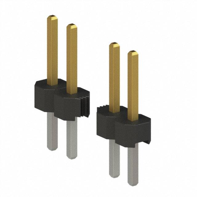

    3M
    插件,P=2mm
    排针 间距:2mm 1x38P 直插
951138-8622-AR 数据手册
3M™ Pin Strip Header 2 mm and 2 mm x 2 mm Straight and Right Angle, Solder Tail 951 Series • High temperature dielectric • ³1o lead´ ZaYe and reÀoZ solder compatiEle • Maximi]es use oI P& Eoard space • (nd stacNaEle Ieature • Mates Zith Eoardmount and Ziremount products • RoHS Compliant. See the Regulatory Information Appendix (RIA) in the RoHS compliance section of www.3Mconnectors.com for compliance information (RIA E1 & C1 apply) Date Modi¿ed: 1oYemEer 19, 21 TS-2156-E Sheet 1 of 2 Physical Insulation Material: )lammaEility: Color: Contact Material: Plating 8nderplating: Wiping Area: Solder Tail Area: High Temperature Thermoplastic 8/ 99 Black Copper Alloy 1.25±2.5 —m >1 —@ 1ickel Flash Gold 1±3 —m >±11 —@ Matte Tin Electrical Current Rating: Insulation Resistance: Withstanding Voltage: Transition Resistance: 1A ! 5 x 1 2hm at 1 9DC 1 9DC ≤ 2 m2hm Environmental Temperature Range:  ƒC to 15 ƒC Processing Temperature: max. 2 ƒC (Pro¿le per -STD2C) Moisture Sensitivity Level: 1 (per -STD2C) 8/ File 1o.: E Electronic Materials Solutions Division http://www.3Mconnectors.com 3M is a trademark of the 3M Company For technical, sales or ordering information call your Local 3M Service Center 3M™ Pin Strip Header 2 mm and 2 mm x 2 mm Straight and Right Angle, Solder Tail 951 Series n = No. of Contacts Tolerance Unless Noted [mm] Nominal Size .5±3 3± ±3 Linear Dim  .1  .1  .2 Radii  .2  .5  1 3±12  .3  1 Ordering Information 951XXX Rows: 1 = 1 Row 2 = 2 Row Contact Quantity: 02-40 Pins / 1 Row 04-80 Pins / 2 Row XX22 AR (RIA E1 & C1 Apply) Mating Pin Length Dimension B: 6 = 4.4 mm 7 = 7.5 mm (for Right Angle only) Mounting Style: 8 = Vertical, Solder Tail 7 = Right Angle, Solder Tail TS-2156-E Sheet 2 of 2 Electronic Materials Solutions Division http://www.3Mconnectors.com 3M is a trademark of the 3M Company For technical, sales or ordering information call your Local 3M Service Center Important Notice All statements, technical information, and recommendations related to 3M’s products are based on information believed to be reliable, but the accuracy or completeness is not guaranteed. Before using this product, you must evaluate it and determine if it is suitable for your intended application. You assume all risks and liability associated with such use. Any statements related to the product which are not contained in 3M’s current publications, or any contrary statements contained on your purchase order shall have no force or effect unless expressly agreed upon, in writing, by an authorized officer of 3M. Warranty; Limited Remedy; Limited Liability. This product will be free from defects in material and manufacture for a period of one (1) year from the time of purchase. 3M MAKES NO OTHER WARRANTIES INCLUDING, BUT NOT LIMITED TO, ANY IMPLIED WARRANTY OF MERCHANTABILITY OR FITNESS FOR A PARTICULAR PURPOSE. If this product is defective within the warranty period stated above, your exclusive remedy shall be, at 3M’s option, to replace or repair the 3M product or refund the purchase price of the 3M product. Except where prohibited by law, 3M will not be liable for any indirect, special, incidental or consequential loss or damage arising from this 3M product, regardless of the legal theory asserted. 1 Electronic Materials Solutions Division 6801 River Place Blvd. Austin, TX 78726-9000 U.S.A. 1-800-225-5373 www.3Mconnectors.com 3M is a trademark of 3M Company. Please recycle. Printed in USA. © 3M 2014. All rights reserved. RIA-2217A-E
951138-8622-AR
物料型号:3M™ Pin Strip Header 951系列
器件简介:该系列端子具有高温绝缘材料,符合RoHS标准,并且有3M公司的商标。
引脚分配:文档提供了单排和双排端子的引脚布局,包括不同排数和引脚数量的配置。
参数特性: - 绝缘材料:高温热塑性塑料,颜色为黑色 - 接触材料:铜合金,镀层为闪金 - 焊接尾区:40-118微英寸的亚光锡 - 电流额定值:1A - 绝缘电阻和耐受电压等电气特性
功能详解:文档提供了端子的物理特性、电气特性和环境特性,包括加工温度和湿度敏感度等级。
应用信息:适用于需要高温绝缘和RoHS合规的电子应用。
封装信息:文档提供了订购信息,包括行数、引脚长度、引脚数量和安装方式的选项。
