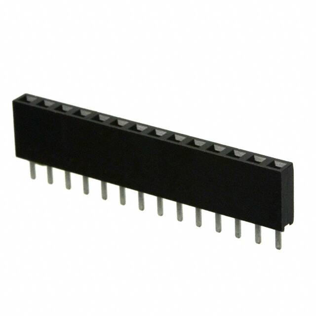

    14 位 插座 连接器 0.100"(2.54mm) 通孔 金
960114-6202-AR 数据手册
3M™ Boardmount Socket 2.54 mm and 2.54 mm x 2.54 mm, Straight, Solder Tail 960 Series • High temperature dielectric • “No lead” wave and reflow solder compatible • Single- and dual row design, 2–36 pins or 4–72 pins • Housing height options: 8.5 mm and 7.1 mm • Mates with pin-strip header products • RoHS Compliant. See the Regulatory Information Appendix (RIA) in the “RoHS compliance” section of www.3Mconnectors.com for compliance information (RIA E1 & C1 apply) Date Modified: November 19, 2012 TS-2187-B Sheet 1 of 2 Physical Insulation Material: High Temperature Thermo­plastic Flammability: UL 94V-0 Color: Black Contact Material: Copper Alloy Plating Underplating: 1.25–2.5 µm [50–100 µ’’] Nickel Wiping Area: Flash Gold Solder Tail Area: 1–3 µm [40–118 µ’’] Matte Tin Electrical Current Rating: 2 A Insulation Resistance: > 5 x 108 Ohm at 100 VDC Withstanding Voltage: 1000 VDC Environmental Temperature Range: -25 °C to +105 °C Processing Temperature: max. 260 °C (Profile per J-STD-020C) Moisture Sensitivity Level: 1 (per J-STD-020C) UL File No.: E68080 Interconnect Solutions www.3Mconnectors.com 3M is a trademark of the 3M Company For technical, sales or ordering ­information call your Local 3M Service Center 3M™ Boardmount Socket 2.54 mm and 2.54 mm x 2.54 mm, Straight, Solder Tail Height: 7.1 mm (.28) 960 Series Height: 8.5 mm (.33) PCB Layout PCB Layout n = No. of Contacts Tolerance Unless Noted [mm] Nominal Size 0.5–3 3–6 6–30 Linear Dim +/- 0.1 +/- 0.1 +/- 0.2 Radii +/- 0.2 +/- 0.5 +/- 1 30–120 +/- 0.3 +/- 1 Ordering Information 960XXX 6X0X AR (RIA E1 & C1 Apply) Rows: 1 = 1 Row 2 = 2 Row Contact Quantity: 02–36 Pins / 1 Row 04–72 Pins / 2 Row Solder Tail Length: 2 = 3.0 mm [.12 ] / Body Height 7.1 mm [.28 ] 3 = 3.5 mm [.14 ] / Body Height 8.5 mm [.33 ] Body Height: 2 = 7.1 mm [.28] / Solder Tail Length 3.0 mm [.12 ] 3 = 8.5 mm [.33 ] / Solder Tail Length 3.5 mm [.14 ] TS-2187-B Sheet 2 of 2 Interconnect Solutions www.3Mconnectors.com 3M is a trademark of the 3M Company For technical, sales or ordering ­information call your Local 3M Service Center Important Notice All statements, technical information, and recommendations related to 3M’s products are based on information believed to be reliable, but the accuracy or completeness is not guaranteed. Before using this product, you must evaluate it and determine if it is suitable for your intended application. You assume all risks and liability associated with such use. Any statements related to the product which are not contained in 3M’s current publications, or any contrary statements contained on your purchase order shall have no force or effect unless expressly agreed upon, in writing, by an authorized officer of 3M. Warranty; Limited Remedy; Limited Liability. This product will be free from defects in material and manufacture for a period of ninety (90) days from the time of purchase. 3M MAKES NO OTHER WARRANTIES INCLUDING, BUT NOT LIMITED TO, ANY IMPLIED WARRANTY OF MERCHANTABILITY OR FITNESS FOR A PARTICULAR PURPOSE. If this product is defective within the warranty period stated above, your exclusive remedy shall be, at 3M’s option, to replace or repair the 3M product or refund the purchase price of the 3M product. Except where prohibited by law, 3M will not be liable for any indirect, special, incidental or consequential loss or damage arising from this 3M product, regardless of the legal theory asserted. 3 3M Electronics Solutions Division 6801 River Place Blvd. Austin, TX 78726-9000 U.S.A. 1-800-225-5373 www.3Mconnectors.com Please recycle. Printed in USA. © 3M 2012. All rights reserved. RIA-2217B-E 3M is a trademark of 3M Company.

物料型号:3M™ Boardmount Socket 960系列
器件简介: - 高温绝缘材料 - 无铅波峰焊和回流焊兼容 - 单排和双排设计,2-36针或4-72针 - 外壳高度选项:8.5 mm和7.1 mm - 与针式头产品兼容 - 符合RoHS标准
引脚分配:文档中未明确提供引脚分配图,但提到了单排和双排设计,以及针脚数量范围。
参数特性: - 绝缘材料:高温热塑性塑料,UL 94V-0阻燃等级,颜色为黑色 - 接触材料:铜合金 - 镀层:1.25-2.5微米镍底层,擦金区域为闪金 - 焊尾区域:1-3微米亚光锡 - 电流额定值:2A - 绝缘电阻:> 5 x 10^8欧姆(100V直流电) - 耐压:1000V直流电
功能详解:文档中未提供详细的功能解释,但提到了产品与针式头产品兼容,并且有多种高度和针脚数量选项。
应用信息:文档中未明确提供应用信息,但根据产品描述,可能适用于需要高温绝缘和无铅焊接兼容的电子设备。
封装信息: - 环境温度范围:-25°C至+105°C - 加工温度:最高260°C(根据J-STD-020C标准) - 湿度敏感等级:1(根据J-STD-020C标准) - UL文件编号:E68080
订购信息: - 型号:960XXX 6X0X AR(符合RoHS RIA E1 & C1) - 行数:1行或2行 - 接触数量:1行2-36针,2行4-72针 - 焊尾长度:2 = 3.0 mm(适用于7.1 mm高度)或3 = 3.5 mm(适用于8.5 mm高度)
